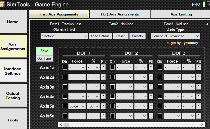

    You'll find below my settings. As you can see they are very simple for the purpose of focusing on my horizontal actuator's behavior.

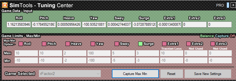

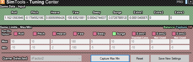

    The only force I'm using is Surge - no filter at all - and it's sent to my horizontal surge actuator. In the control center I used 2 different settings for Surge max/min, +3/-3 and +10/-10.
    With these very simple settings I'm getting the same odd behavior, of course with different intensity for different max/min levels (no video, sorry, since I don't have a Youtube account I could use):
    - when just releasing the throttle the tray goes backwards whereas if you think about it it should not since I'm not actually braking, i.e. not generating negative surge, I'm just letting surge go back to 0.
    - likewise, when just releasing the brake the tray goes forwards whereas I'm not accelerating, i.e. not generating positive surge, I'm just letting it go back to 0.
    Getting for instance such move forward when you are just releasing the brake and not accelerating is very disturbing. When you just release the brake the car should continue on its track at constant speed and you should therefore not be pushed forward by a surge actuator.

    To help with tuning advice can I please confirm my understanding of your motion profile aims.
    What I understand you want is significant surge effect on acceleration, with the surge axis moving forward, and to simulate sustained surge in a return to light throttle, in other words there is not an abrupt return of the surge axis, but rather a gradual reduction. Under braking your expectation is that the surge table will have a significant surge effect moving backward, but you want a softer response when braking is released.
    If my understanding is correct filters may come into it later for refinement, but initially what you want to find is the best compromise where the horizontal surge axis has 100% Axis Allocation, and you want fast acceleration but slower deceleration responses. You can initially start by differentiating the Max/Min values in the Tuning Center. In the Tuning Center the check boxes are Green by default, which means the Min and Max values will default to the same value, Blue is to capture values and uncheck them to Pink (Off) to manually enter values. So change yours to Pink and manually fine tune the horizontal surge actuator by differentiating the Max/Min values to the point of the fastest deceleration return you can live with. The larger the value the softer the response over a greater axis range, so you want larger values to slow the effect for lighter throttle and getting off the brakes. I suggest the fastest deceleration you can live with in anticipation of what you may do with other actuators.
