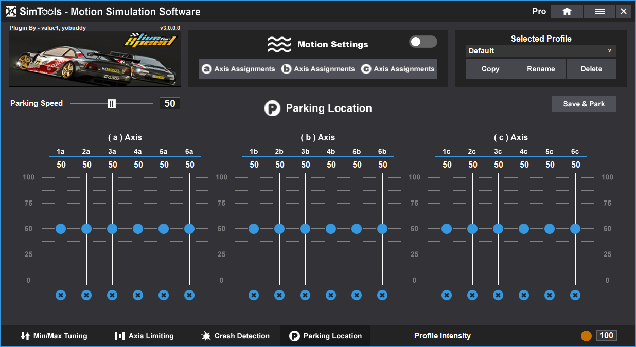

    I would like to have a setting menu of neutral/starting potision of the Actuator. SCN and the family always stop at middle after calibration right now but want to have actuator start at fully extended position by some reason. Is it possible?

    Do you mean a parking location?

    Yes! Where can I get if it is already existing.

    Hi @Shige Tanaka,
    It's in the v3 alpha that's not quite released yet I'm afraid, but it is there when released.
    We need to figure out what the output data for game dash is going to look like in v3.
    As I believe its the last major thing to be finalized before a v3 alpha release. :thumbs

    That's a great feature. I declare to be the tester. hug:
