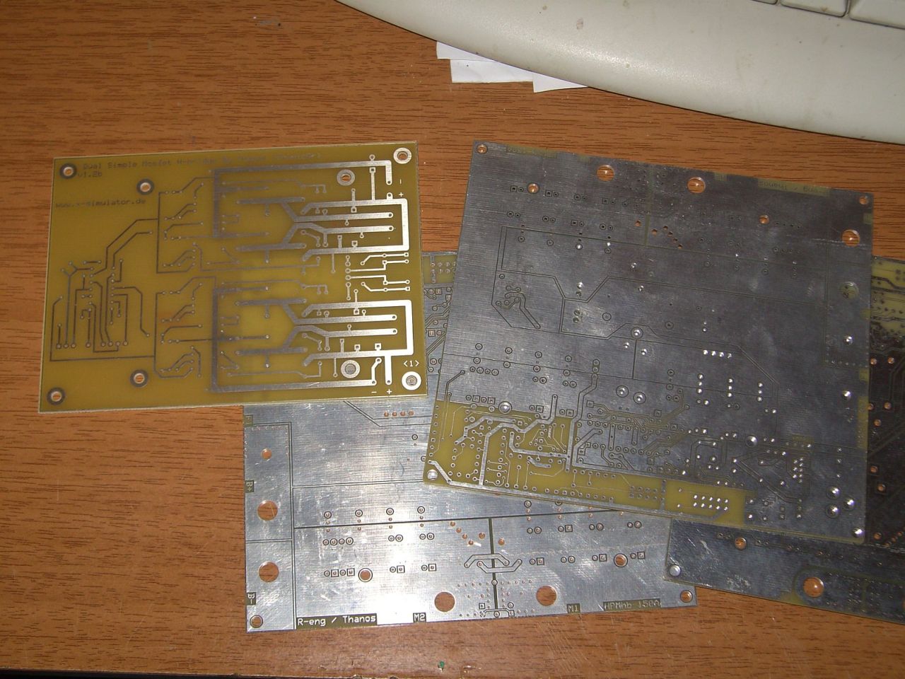

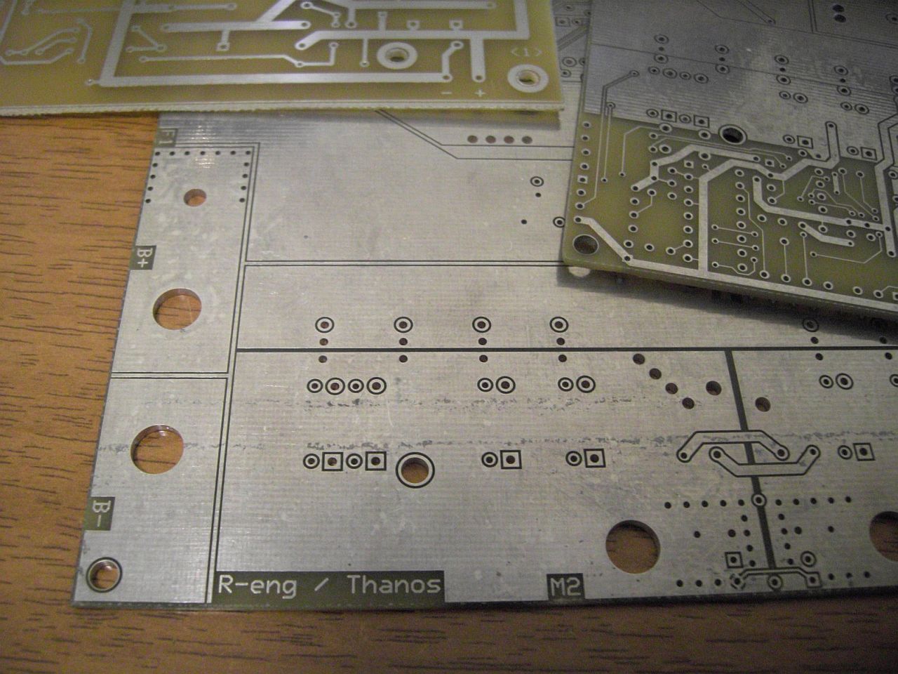

    No need to send me anything. I have ordered the PCB boards from etching services (Heinz and ExpressPCB). Below is a photo of my DSMhb1.2b beside some boards of the latest gem of DIY motor controllers, the HPMhb-150A !!!!!
    The HPMHb-150A is the successor of the old DSMhb1.2b, that will support motors up to 150Ampere rated and true 49V capability, plus it has extra current and temperature watchdog circuit. This was designed mostly by R-eng with my guidance.
    Be aware that the commercial motor drivers that are compatible with my AMC1.5 are NOT capable of driving 24V motors!!!! BTW can you give more information for your 24V motors? What Watt / Ampere are rated?
