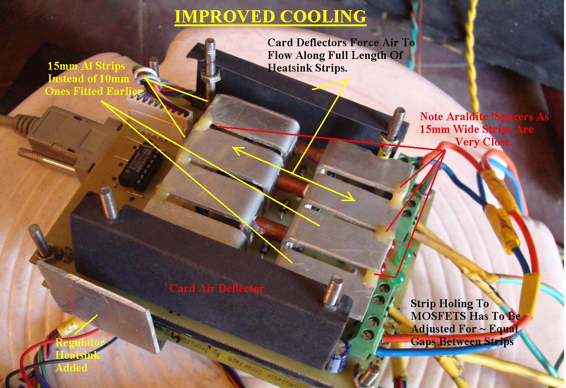

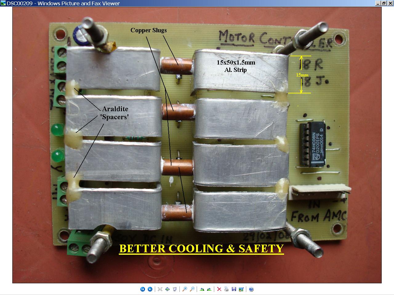

    The DSMhb IMHO is great, and I am determined with a few small physical changes to enable it to handle 2 WW motors per axis. Thanks to you I haven't blown any further MOSFETs (yet!!) A few of the things I've done/ intend to do are:- Use wider heatsinks. Already done. Increased width from 10mm to 15mm bringing them dangerously close together. Used Araldite 'spacers' to prevent accidental contact. (See pic). Much time was spent ensuring the sink strips in direct contact with the MOSFET's metal pad were absolutely flat (fine flat file and finish off with 0 grade emery paper) for good heat transfer. This seemingly small change gives an ~30% surface area increase! These will be replaced by 14/15mm copper strips as soon as I can get hold of them. A lot of the air blown by the fan escapes at right angles to the strips without doing much work. Two cardboard guides were added to force the air to do more work by flowing along the strips before escaping. The air velocity from the open ends is now much greater. Two fan support bars were cut away to remove some obstruction to the airflow. Hopefully better cooling allround. While changing MOSFETs in the NO TC model, one casualty was the PCB stripes at the gates.(Maybe bad quality PCB material!) My new PCB will have these wider, as also the width of the solder-thickened tracks for increased current capacity and lower inductance. The long wires from the two motors (totally 14' long!) to the DSMhb were tightly twisted to reduce inductance effects (thanks to info on Pg 1 of the 4QD website). Tha attached pics will say all this much better.
    I hope some of the above points will have some relevance while designing the new motor controller.

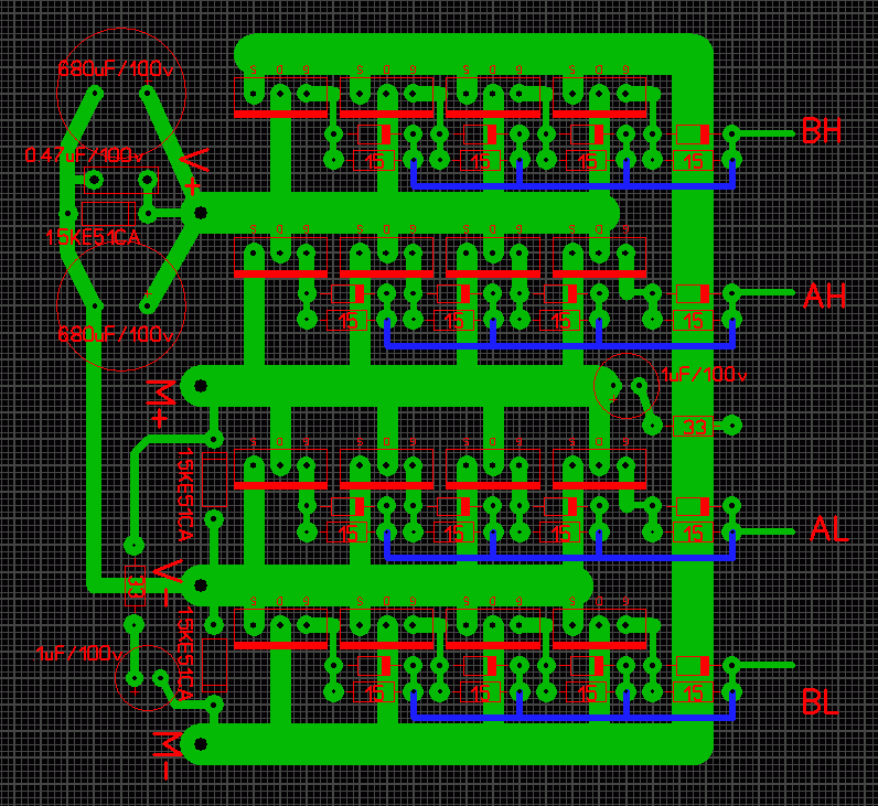

  4. tronicgr
    tronicgr
    I decided to upgrade my existing DSMhb boards, using the IRF3205 mosfets. I already ordered some very cheap from ebay:
    http://cgi.ebay.com/ws/eBayISAPI.dll?Vi ... 0070728987
    25 parts are enough for all my DSMhb's and will have spare parts too!
    -The design of the new stronger h-bridge is going well. Here is a small teaser view of it (not complete yet!!!!)
    Best Regards, Thanos

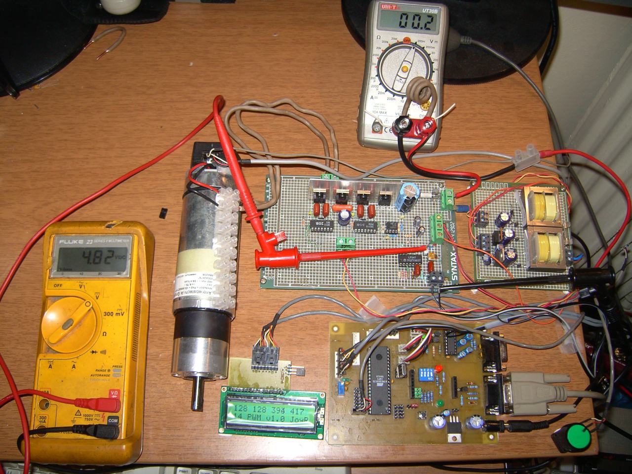

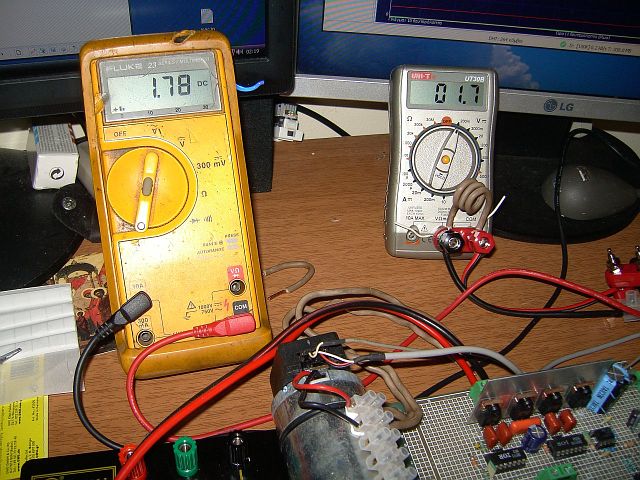

  14. tronicgr
    tronicgr
    As you know there is always the possibility of something to go wrong while powering up a motion simulator especially in start, where the motor limits aren't yet known or the direction is opposite or maybe a design flaw blocks the motor and make it stall. A stalling motor have big possibilities of burning down its coils or the h-bridge that drives it.
    The best way to monitor and prevent such situations is to add an ammeter (perhaps a digital meter) in series to the motors and watch for the rising of the amperes having your hand on the kill switch for the power source. But what happens if we cannot have our attention on the amp readings, if we sit on the simulator on example and using it. We must somehow automatically monitor the current and have the motion controller cut the power when a current limit is reached that is defined by the h-bridge used and the ampere rate of the motor.
    In this case we can use a current sensor. There are several solutions that I'd like to present here, hoping that more cheap ones may be found from others too. Some of them are commercial and others completely DIY.

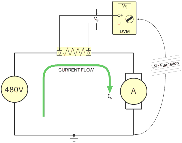

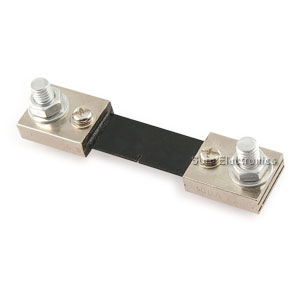

    1.Shunt current sensor: Its a piece of wire that we let the all the current pass trough and measure the fraction of the voltage that produces on its two ends, some mVolts, that is increasing as the current increasing in linear manner. The simplest way is to use a piece of 10AWG wire as described on this link: <a class=postlink href=http://www.rcgroups.com/forums/showthread.php?t=393591 target=_blank>http://www.rcgroups.com/forums/showthread.php?t=393591</a>
    I already made such shunt and tested it successfully:
    This method requires some effort since I had to calibrate the readings on the gray DVM, by putting in series my accurate Fluke meter connected as ammeter, and slowly cut the shunt piece smaller until it gets close. Its a cheap way, not more that a 1-2 euros for the cable. Also some additional circuit is needed to interface is to my AMC1.5 ADC ports.
    Another solution that is more accurate is to use a commercial shunt current as this one:
    <a class=postlink href=http://cgi.ebay.com/ws/eBayISAPI.dll?ViewItem&ssPageName=STRK:MEWAX:IT&item=350153196811 target=_blank>http://cgi.ebay.com/ws/eBayISAPI.dll?Vi ... 0153196811</a>
    Here how the current shunt working principle:
