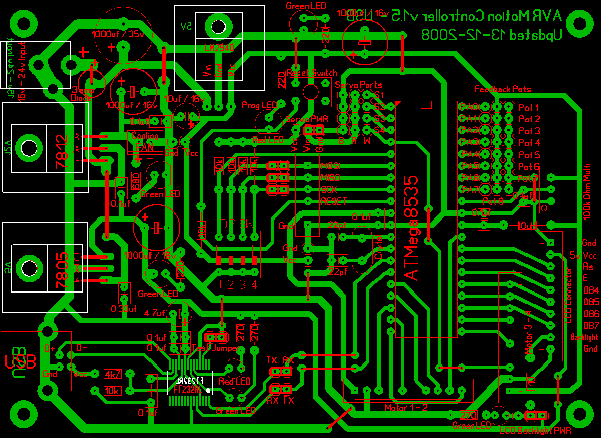

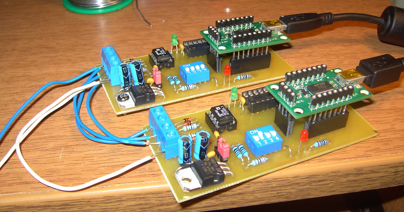

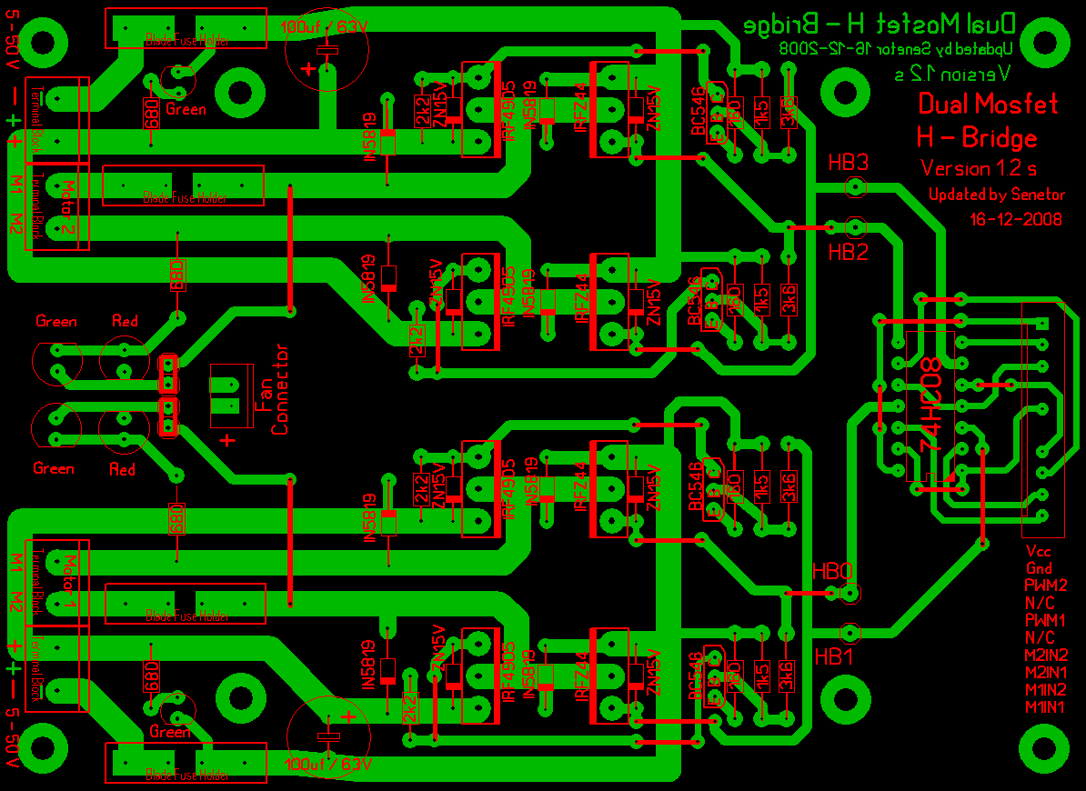

    Here,s a Rehash of the H Bridge.
    Haven't checked properly for errors yet. Mosfets moved closer together so can use one large heat sink, back to back aluminium angle with slots cut in it to try to stabilize the heat from Mosfets. Mosfets insulated with silicon insulating washers, Sockets removed so legs are soldered directly into board ( no dry joints between leg and socket to create extra heat on Mosfet legs)
    Mosfets centred to middle of board. Socket for fan gets power from AMC board which is mounted below.
    AMC board with onboard regulators for Controller, USB Cooling Fan and LCD Display. FT232RL chip onboard, mounted under board on copper.
    Senetor.
