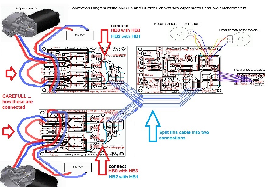

    Abdo, can you tell me which method you used to tie the two sides of the h-bridge together and the channel out of the amc. I would like to try your idea as well to try to get my motors to work. I have low resistance on my wiper motors and can't get them to run on my h-bridge.
  11. speedy
    speedy Well-Known Member
    Feb 1, 2012
    1,193
    Alexandria , Egypt
    7,918Coins
    +1,285 / 10 / -0
    There are still some modifications I want to make to the board output to handle large motors connection like : 6mm wires ,fuses ,... etc.
    the layout now looks very bad but I'm working on it .
    I don't want to miss up things with you guys ... BIG Warning ... You could SHORT the tow sides together if not connected properly ... Be careful . :nofinger:
    I have used method 2 of my previous post ... I have connected the [ HB1 with HB2] , and [ HB0 with HB3] .... that would make the two outputs for both motors M2's & M1's are at the same polarity for both directions ... If you understand the concept then give it a try . :bulboff:
    For channel out [driving data bus] of the AMC as you say .... Split the cable coming from the AMC into two long end connections labeling them DSMhb-M1 and DSMhb-M2
    For each end connection do the following :
    -[DSMhb-M1] end connection ... as original just disconnect anything that says M2 coming from the AMC and keep the Vcc and Gnd .
    -[DSMhb-M2] end connection ... as original just disconnect anything that says M1 coming from the AMC and keep the Vcc and Gnd .
    Sorry for no quality image ... but you will get what I mean .
    Keep in mind that connections on are reversed .[ AMC board is controlling Motor2 via M1in1 ,M1in2 ,PWM1 ,feed back pot1 ].
    :cheers:

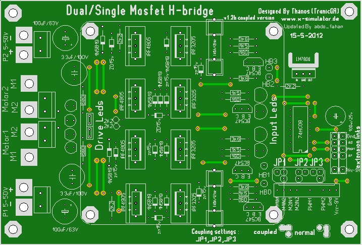

    I've finished the coupling version modification ... :toohot:... tested it my self ... any help needed for building or assembling it , just ask !! :yes: )
    see next files ...
    sprint_5_DSMHB_Coupled Enabled_C2_Copper side_2 boards.pdf sprint_5_DSMHB_Coupled Enabled_C2_silkscreen side_2 boards.pdf sprint_5_DSMHB_Coupled Enabled_side1 C1_S1.JPG
    DSMHB-coupling instructions.txt
    Careful ... for new members ... First read and understand carefully all assembling instructions for this board previous versions in wiki section ...
    [Thanos did a great job on this point ] :clap: ...and it is on first page of this thread ...
    happy weekend for all of you :barbeque: ...you're gonna love it :brows:
    Best Regards and more :brows: ... going to you Thanos ...
    abdo_tahan

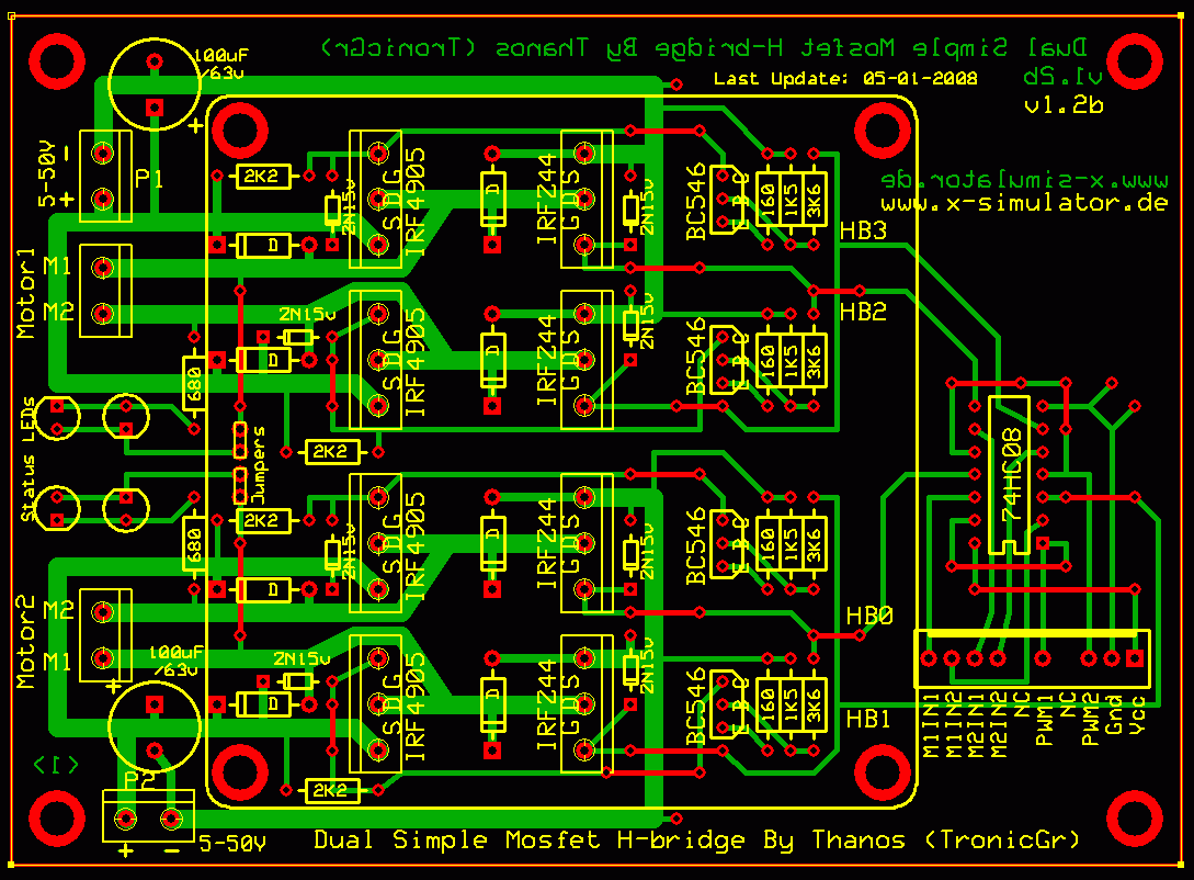

    I used IRF3205 instead of IRFZ44N on many of my h-bridges and could get full saturation even with +5v logic level only!
