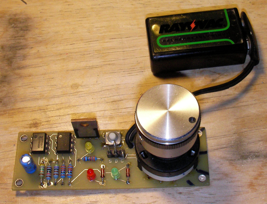

    @ Erich,
    I built this circuit about a month ago and also encountered problems. I was thinking of replacing the 555 chips when today I saw your solution. I rotated the LED and diode and everything worked perfectly...a big thanks!
    The explanation of the LED sequence is a bit untidy, so here is what may be a clearer one.
    BTW, I am methodical bench testing the prototype of the HPMhb-150A at this time. There are some hiccups, so it will take a bit more time before it powers up some motors. But it's not far off!
    R-eng

    Regarding the resistors for the LED's, it really depends on their mcd outputs. The original values proved perfect for me. Experimentation between 220 and 1k is needed to normalize the outputs.

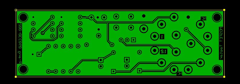

    Here is my board.
    R-eng
  4. tronicgr
    tronicgr
    Hey, nice little board! Any PCB layout of it that we can use to make it? :clap:
    I have all the parts, but was too busy to actual make the board on protoboard...
    Regards, Thanos

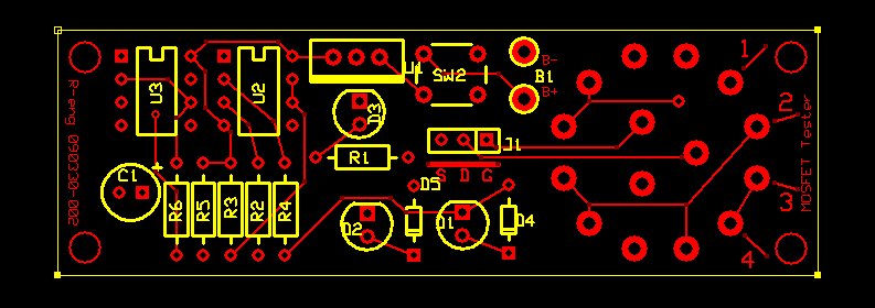

    Dual sided expresspcb layout.
    R-eng

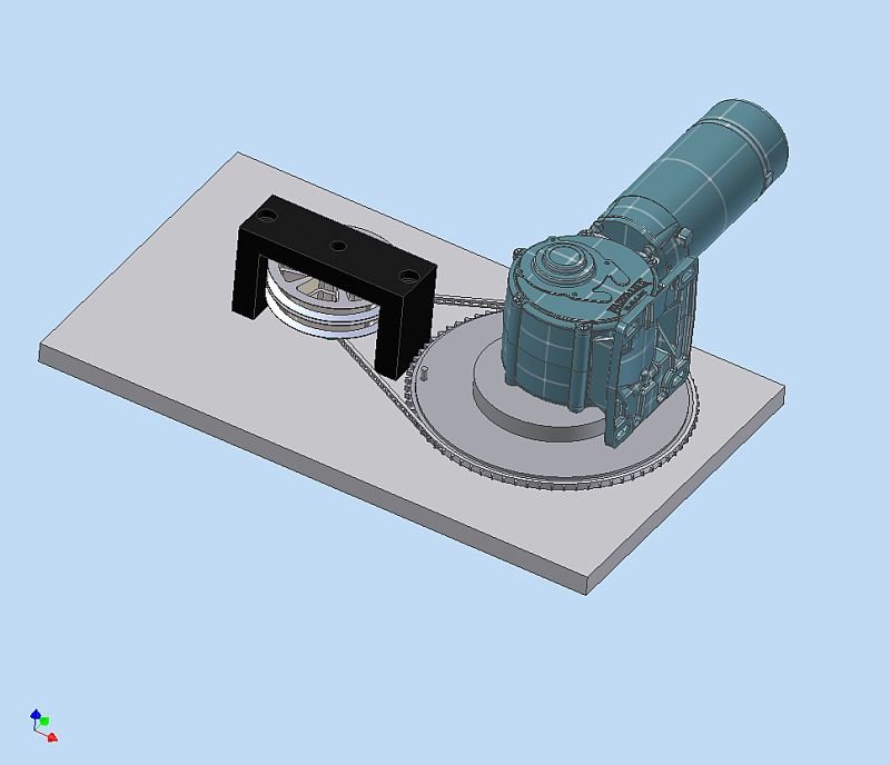

    Hi Thanos just wanted to ask your advice again regarding my Motors and the Spped issue.. have designed a Geared pulley driven system which will be linked to my Motion platform using 6mm Steel cable, becuse my Motor/Gearbox combination is so slow i have thought about using 3/8 pitch chain and sprokets to get the output spped up to 64RPM ( well in theory at least :lol: ) all the main element will rotate in bearings and the Pulleys will be 100-150mm diameter . have a look at the cad drawings i did to see what you think of this option .. if you guys can see any problems with this method i would appreciate tihe feedback before i start making the bits ... on the question of out put torque i had to loose a lot to get the speed but am waiting for a answer from parvalux about how easy it may be to change the Motor to PM60 which spins at a faster speed so i wont have to double up the supply voltage , or cause the unit to wear out quicker by my dodgy calculations i figure that with an input speed of 8 rpm @24V i should get 64 RPM with the gearing set at 8:1 the torrque of 51Nm will be in excess of 500Nm at arround 100mm from shaft which would give me +/- 200mm of cable travel and easily allow me to achieve 15-20Degrees Pitch and roll ??? What do you guys think.. Thanos if this is in the wrong place i'll move it to Actuator designs section :cheers: sorry about the large second PDF could not get infraview to make it smaller :-(

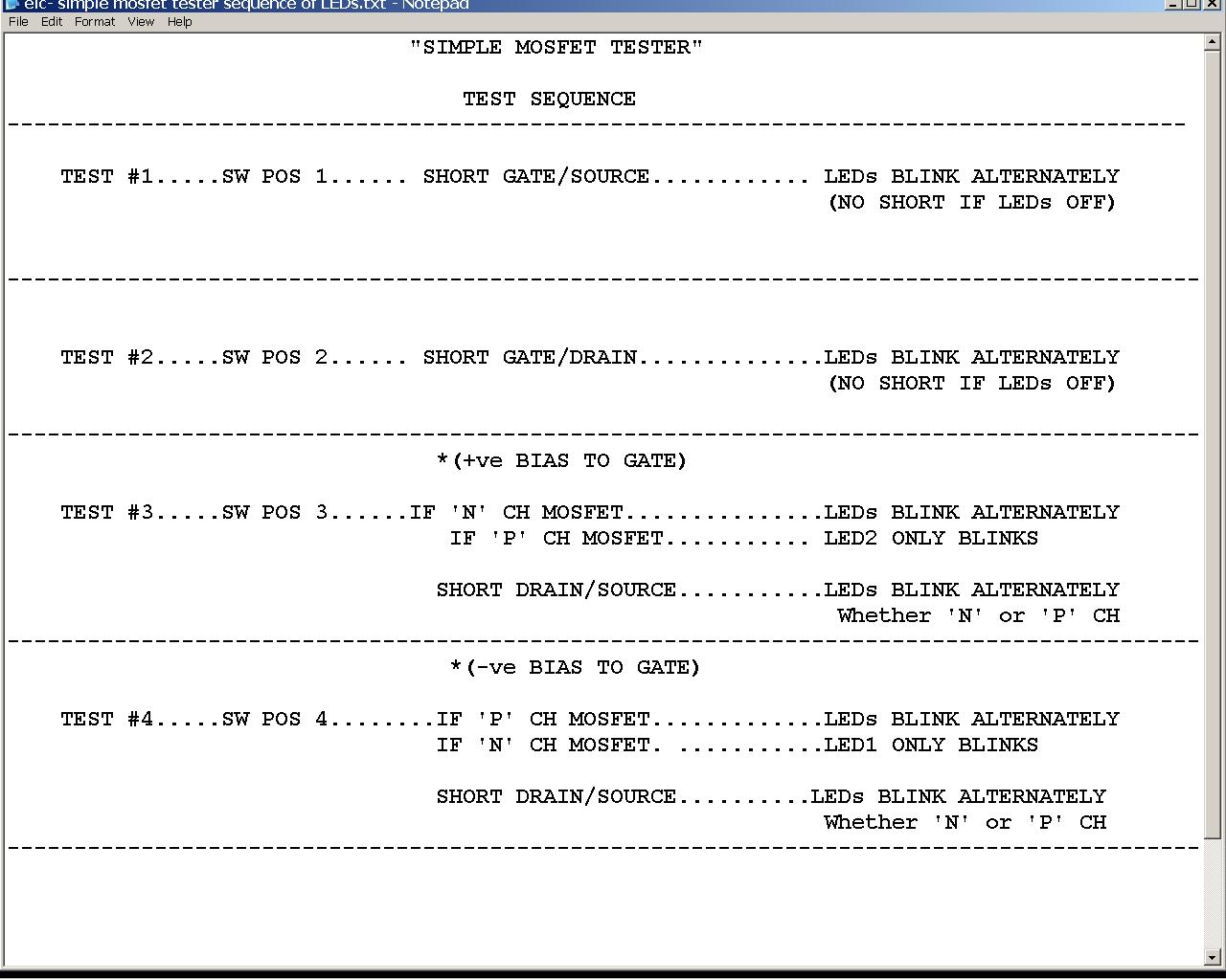

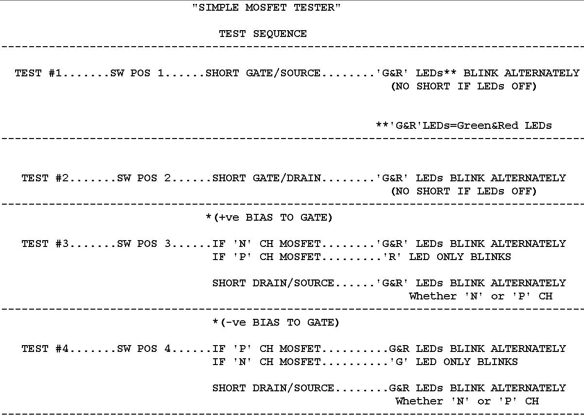

    As a follow up to the Simple Mosfet Tester fix on this page, and for the sake of completeness, I tabled the 4 tests from the text in the original PDF. There are two versions here, one for those who will/or have used LEDs exactly as per the circuit, or for those who might have used green and red LEDs for LED1 and LED2 respectively.
    R-eng, thanks for checking these out.
    Regards, Erich

    The way you have designed, it might work. But I don't know if the steel cable will leave you with much movement of the output shaft, as the tension fittings will hit each pulley disk, if you don't limit the rotation. I'd suggest to measure the length of the pulley cable and use an engine belt near to your size calculations. If not possible to find exact size, make the small pulley adjastable to tension it later.

    Just an update i am planning to buy pulley wheels with size circumferance which is going to be equal to or bigger than the required travel and would then allow for 4/5th of the circumferance to hold the cable ... by this is mean that at least half a turn each pulley would wind/unwind at least 200mm of 6mm diameter cable ( ONe pully for each cable so they cant get tangled ) :cheers: Thanks again Thanos

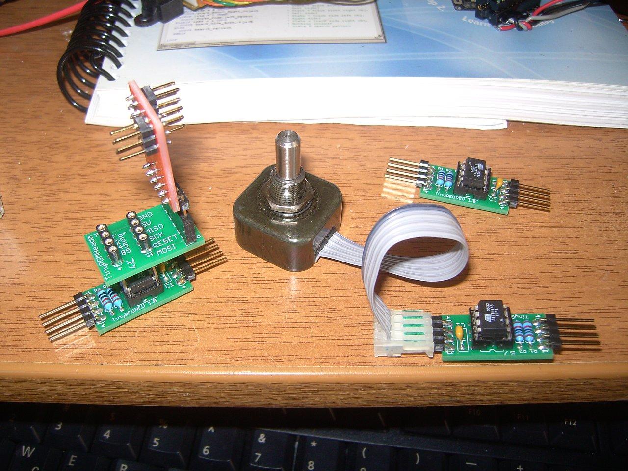

    In meantime I already have ready a 3DOF firmware (probably will call it 2.0) that is used in combined axis motion platforms (like EvanF's chair of torture if you remember it). I'm trying to develop additional code for it so it can use quadrature optical encoders for position feedback. I found a really cheap solution in quadrature encoding that will present to the public soon I hope. Just imagine paying $15 for an 128CPR encoder with 16-bit onboard decoder microcontroller, and best of all, ready to buy off the shelve...!!!
