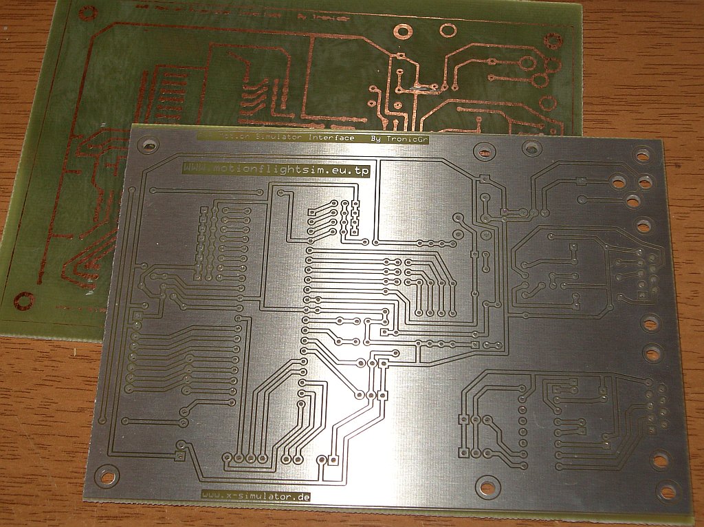

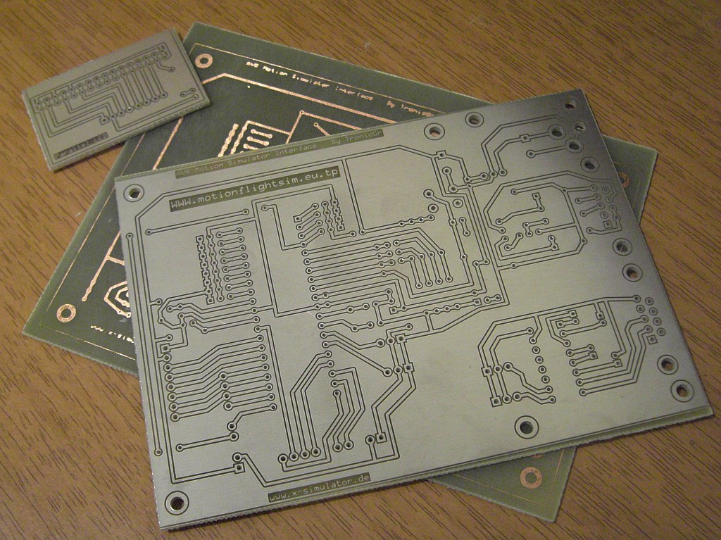

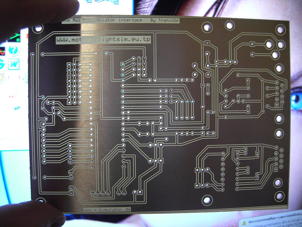

    When I returned home yesterday, a nice surprise waited me. I found outside my door two parcels. One with my AVR controler PCB and the other was the order with the extra parts from RobotikHardware.
    I was very surprised too by the quality of the PCB (tin-plated) as well the fact that was already drilled too!! WOW!!! Thanks Ego!!!!
    In the photos you can compare the quality of the ordered PCB vS the homemade that I have build some months ago. Ok the homemade PCB is a little rusty now but you can compare the detail level!!! Incredible!
    I quickly placed some of the parts on it show you what is going to look! I hope to have it soldered and tested this weekend!

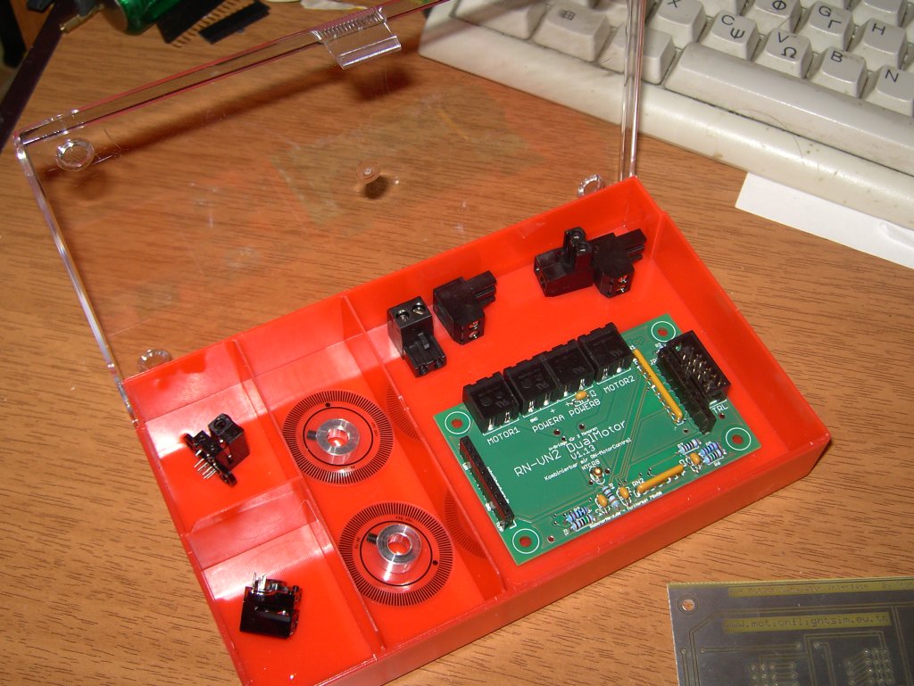

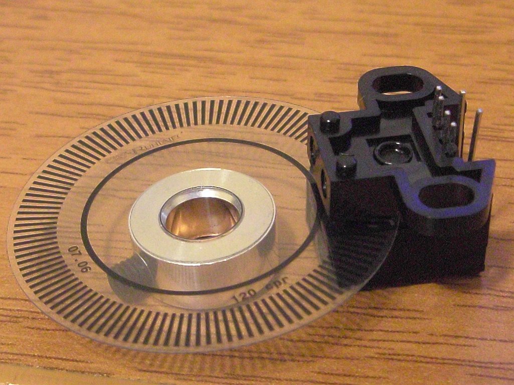

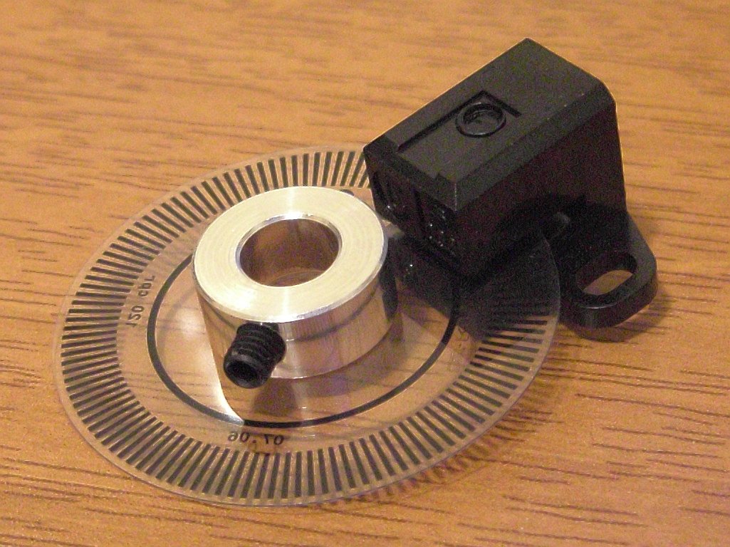

    The second parcel had the second RV-VN2 controller I needed, as well a set of optical encoders (120 CPR) to experiment with.
    I hope to have the new controller soon installed on my joyrider for some true motion tests!!!
    Regards, Thanos

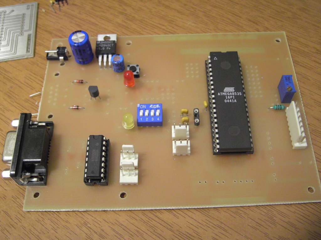

    CRITICAL AVR controller PCB FIXES
    I started the soldering of the parts and noticed two critical design errors I made.
    First is the orientation of the ALPS button that used for reset. I made wrong placement and if placed as diplayed in the silk layer it will cause constant reset, meaning the AVR will never boot to the code... I show on the next photos how to cut two of its legs and bend the other two to fit in to the board. I will fix this in the next version of the PCB design.
    Second issue is that I mistaken the power line for the potetiometers and its connected in the ground instead. In result the pots will not read values at all!! I fixed that by cutting the wrong line on the PCB and jump wiring to the proper power line as seen in the photos below.
    I haven't much time to solder all the compoments (Resistors and capacitors) but I soldered most of them. I had a little trouble though to mount the pin headers for the pots (with black bottom) as the pins was a little bigger than the holes on the PCB. I managed to insert the with little force using a flat screwdriver. And mounting the molex pinheaders (white base) neede also a trick. I bended its legs that doesn't have assigned holes on the PCB as seen in the photo below.
