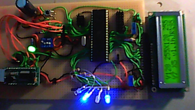

    Hello all,
    my AMC 1.6 works for 2 Days , now it maks some Problems :
    1) with and without Pots the Position from the Xand Y-Achses goest to the max ?
    With every Firmware ;(
    Witch Problem is this i can flash the AMC 1.6 and all Axes goes to max ; what make it wrong ?
    Please help me, i found any answer :sos: :eek:
    Thanks for each help!!!
    ps: sorry for the bad qualy
    gears
    Christian

    Oh, my AMC 1.6 Works
    My Atmega 644 was not correct in his socket :lol:
    gears
    Chris

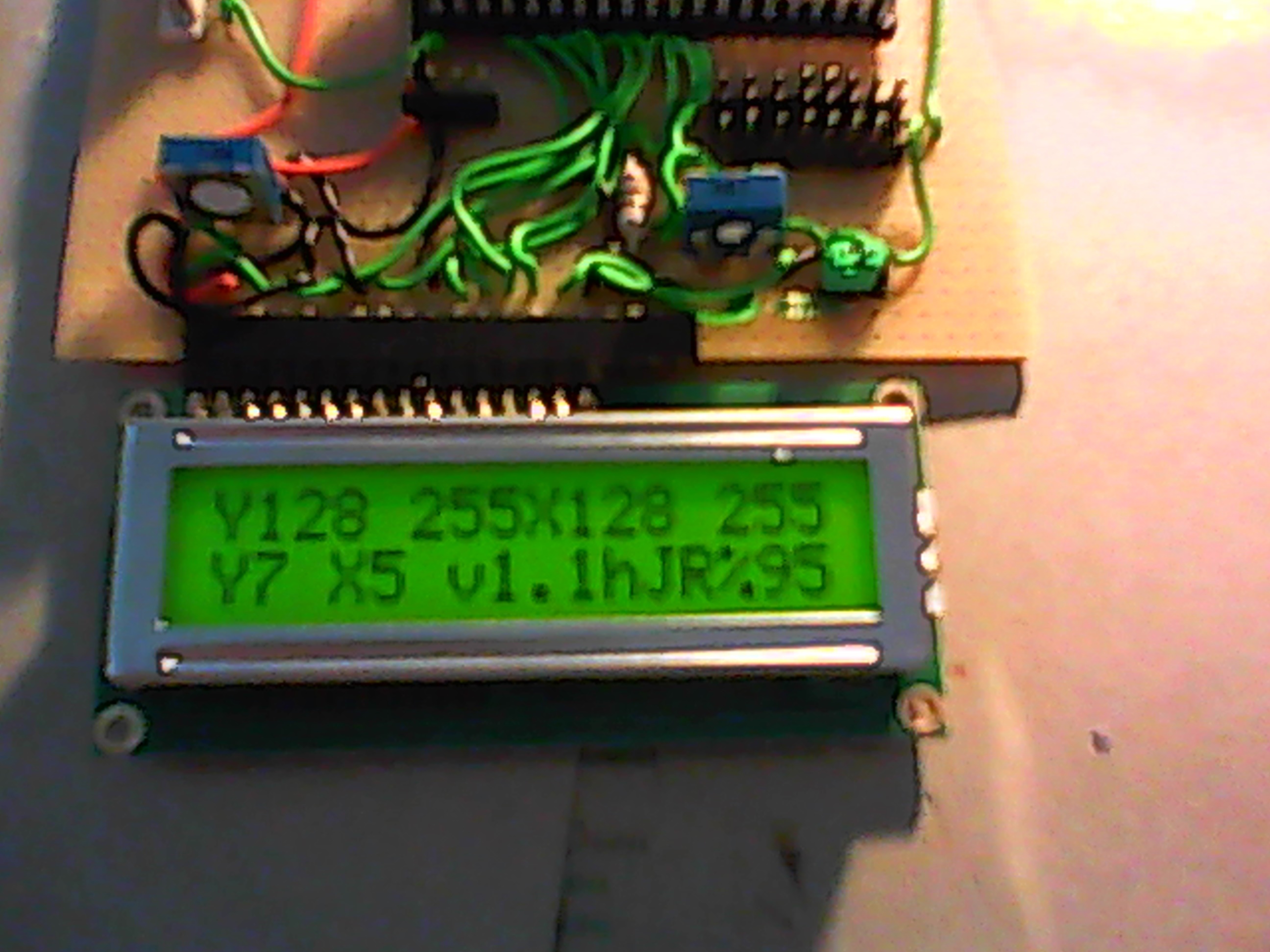

    Hello all i´,
    I need our help !
    Every time I connect the AMC 1.6 with X-Sim3 plus a game (R-Factor 1) Create the controller resets and a new function of the 2DOF system is impossible!
    Does anyone know of what could be the problem, if so please contact my.
    Here is a little video of my problem
    Youtube Link : http://www.youtube.com/watch?v=cxsVEJgK ... e=youtu.be
    greetings
    Christian

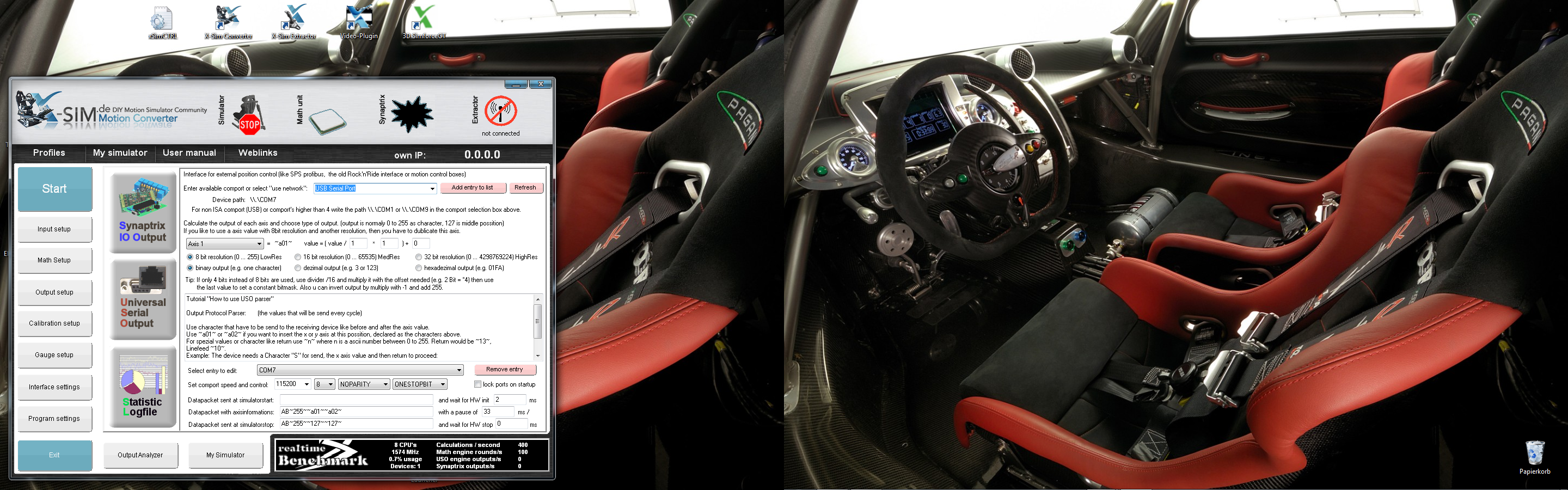

    Here my Setting , can anyone check this I use Firmware 1.1d :

    Hey all ,
    i solved the Problem with a big help from Bruno ( X-Sim.de) :cheers: :thbup: :thbup: :thbup: :thbup: :thbup: :cheers:
    I chanched the Crystal ( Quarz ) from 22.1184 to 18.432MHz an all work well/ fine :yippiee:
    Thank all peopels were supportet my :highfive:
    best regards
    Christian
