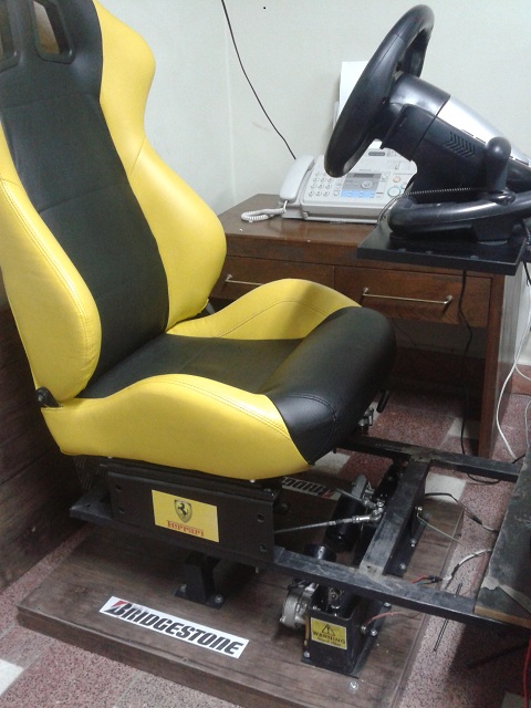

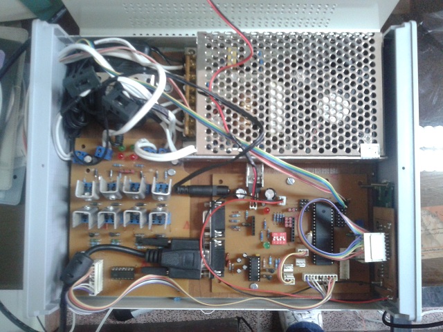

    hello freinds
    i've made Tronic AMC 1.5controller after a few problems and fix them all, it just work very well now and then for second time i tried again and also the second one was very smooth and work well too(thank you Tronic),but about DSMhb 1,2 ,i've done 6 or 7 time but every each time i ve had different problems mostly overheat the mosfet and burnd out, however i ve read most of the procedure and guides and lots of related posts but ive still problem of having it(may it is not as quality as Tronics AMC1.5),as i live in a place which i dont have access to the boards like rn vn2 or' Pololu VNH2SP30 instead so i have no alternative,please help after a lot of work what should i do for better quality,here is pics of my sim motion. 2011-11-30 20.52.31a.jpg
    sorry for poor english
    regards
    Hooshang
