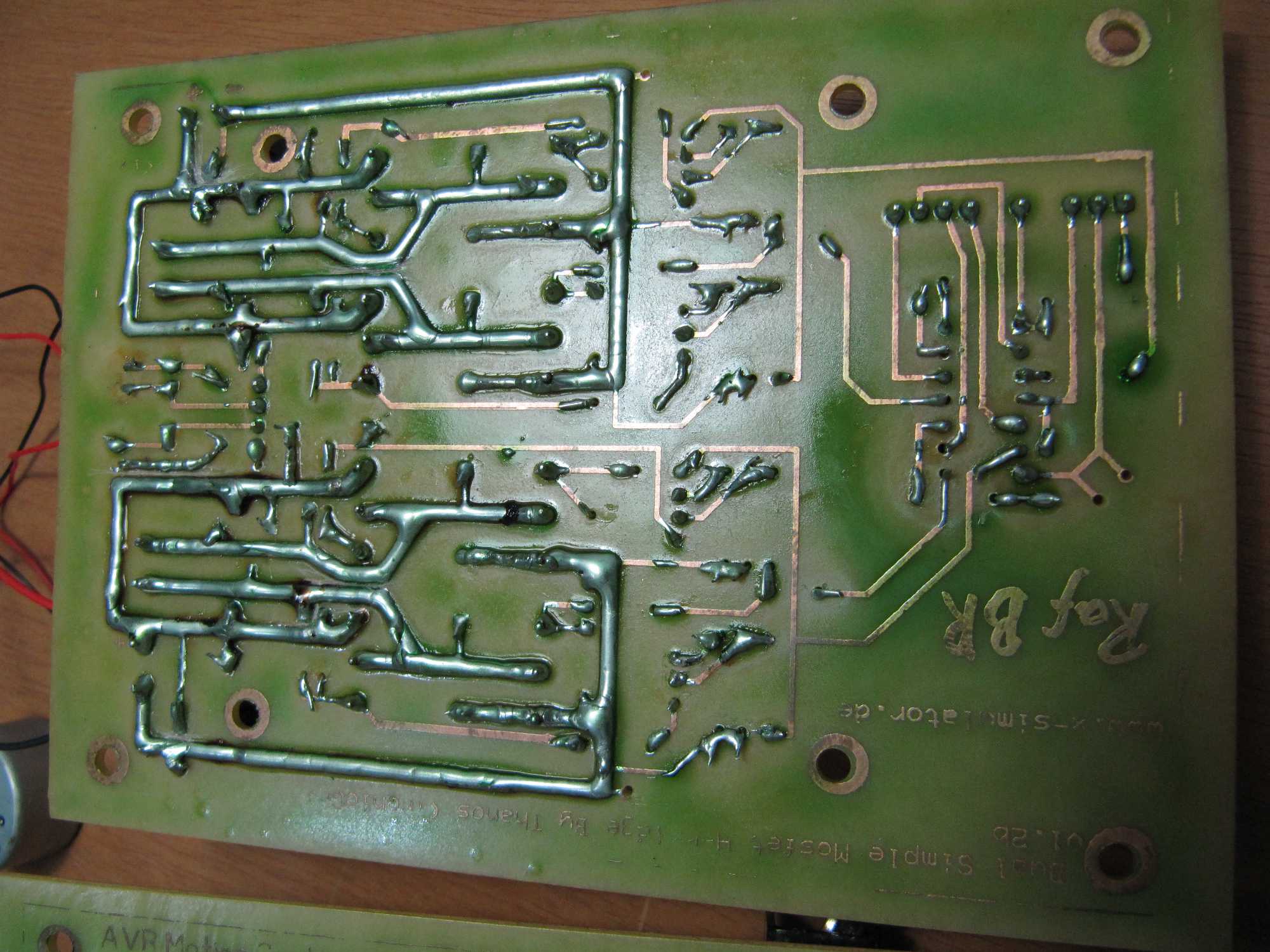

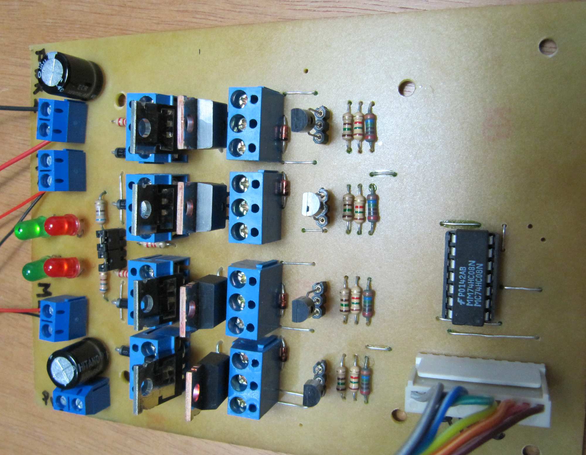

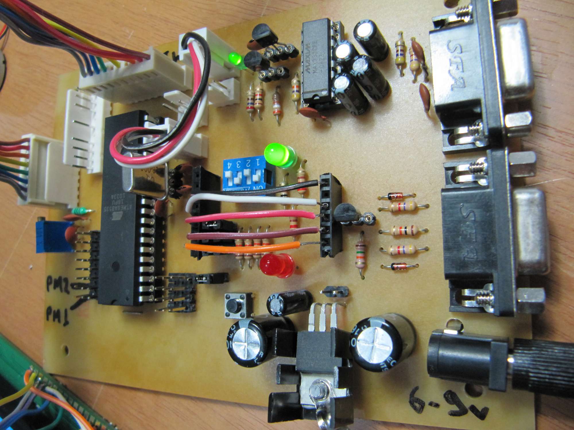

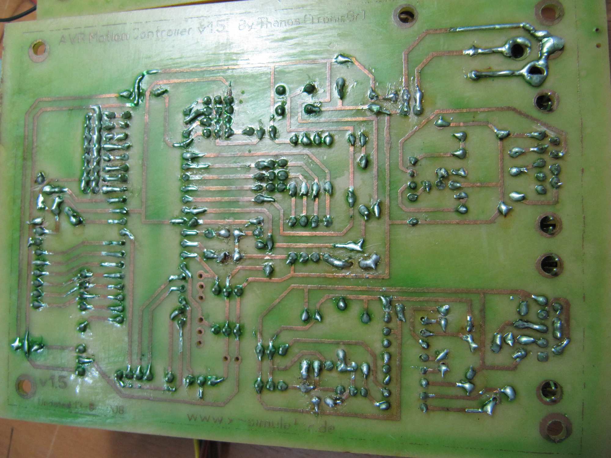

    Here a few hi-res pics to show:
    :sos:

    I've found the problem. H-bridge board doesn't give ground to the motors. I have to bypass it with the wire?

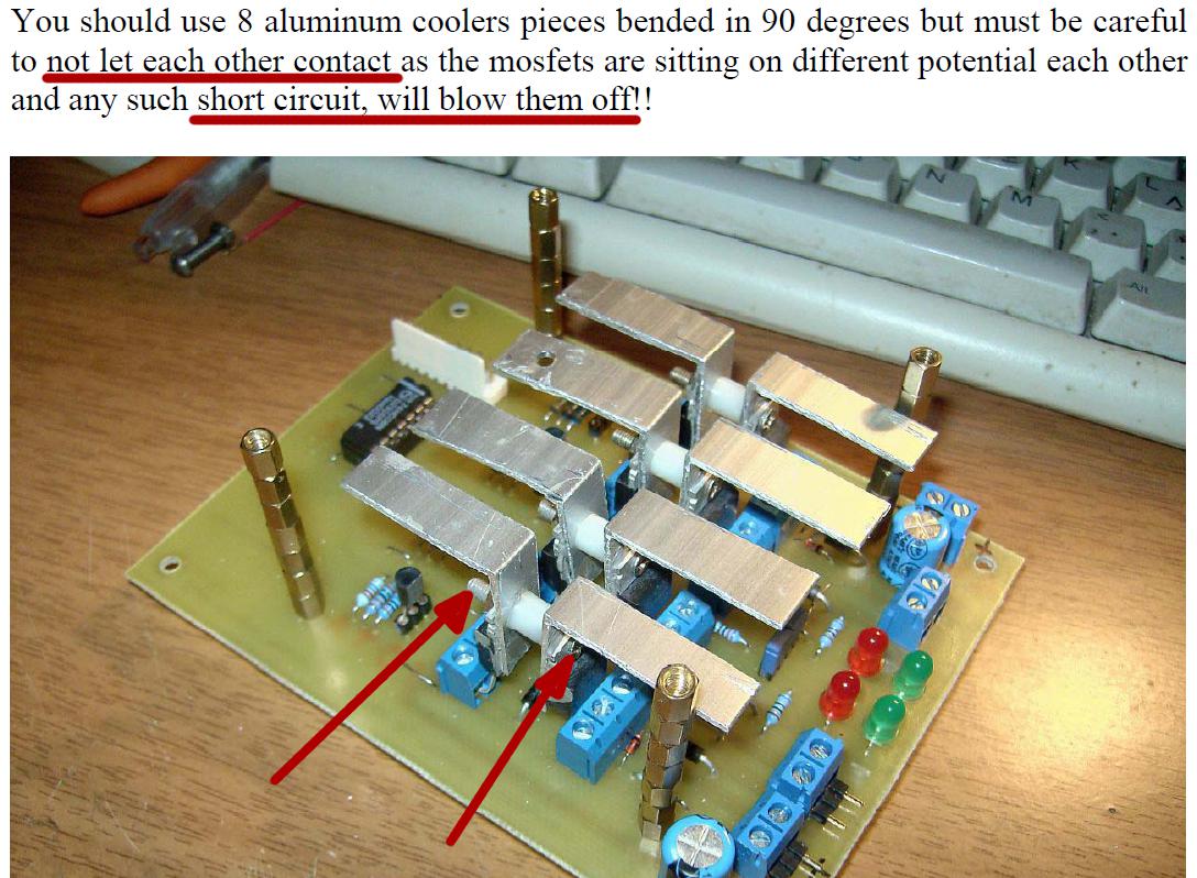

    In this picture from the DSMhb_1_2b_solder_guide i got confused when Tronic say to not let each other contact but the image shows iron bolts conecting the mosfets.
    The bolt is contacting the mosfets, right?

    I found the answer on the Tronic's DIY dual Mosfet H-bridge topic.
    Sorry for I posted in the wrong topic.

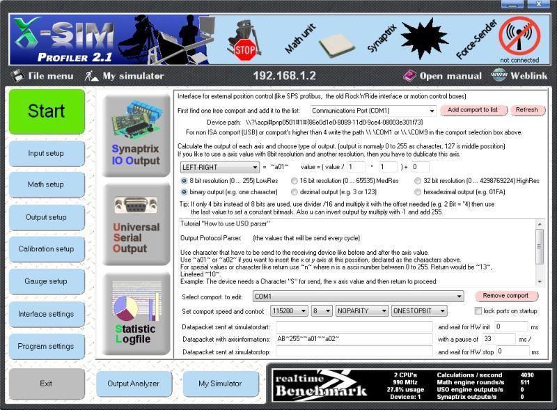

    I am not sure if am I on the right topic. I need help! I 'm trying to test AMC and H-bridge in X-sim for the first time. I have effect 25,26,27 in my game profile. When I move slider to left and right of calibration offset of axis motors are moving well(both axis are working good), but when I start the game nothing happens, and wiper motors doesn't move at all. Why? When I move sliders of effects in test plugin in force-sender, values are changing in force-profiler as well, but motors doesn't move.

    I have installed game plugins(LFS, rFactor, GTR2) properly. As you can see in video values in force profiler are changing while playing game, but motors are not moving, and in the plugin test as well. In the calibration offset of axis motors are moving. So problem is in the AMC for sure. Did anybody have the same problem? Please help!

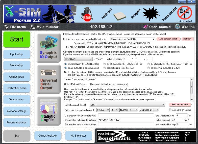

  17. gzezelj
    gzezelj Member
    Oct 21, 2010
    30
    Sombor, Serbia
    - 84Coins
    Hi Sirnoname
    a.) I saw that blue line is not moving, but I don't know why?
    b.) Here is photos of USO setup:
  18. gzezelj
    gzezelj Member
    Oct 21, 2010
    30
    Sombor, Serbia
    - 84Coins
    Thank you Sirnoname
    I made my own profile with 25,26,27,30 effects, and now it works great, except 27(Acceleration & Braking), both motors should work simultaneously, but one is inverted.
    Regards
