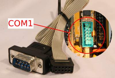

    I'm crafting my plate this week AMC's enough of the rest
    missing components, I am so anxious to finish, this additional
    weeks I found that my PC does not output serial: (, can someone give me a
    clue what I do? I use a USB adapter to program and use
    or some other way?
  4. wimpo`
    wimpo` Member
    Jul 27, 2008
    89
    metselaar
    nederland, twente, vroomshoop
    178Coins
    there is a page somewhere in this topic about usb to serial converter or else you could buy something like this http://www.perle.com/products/multiport-serial-card.shtml
    But are you sure that you're computer doesn't have a COM port on the motherboard.
    it looks like this [​IMG] and often the name COM1 or COM is written there.
    I have to mother boards who are just 3 months and 1 month old and they still have at least 1 COM port.
  5. Frakk
    Frakk Active Member
    Apr 15, 2009
    1,144
    328Coins
    If you don't have a COM port at all you can use a USB-Serial converter. Look for one that is based on an FTDI FT232xx chip.
    I use this one: http://cgi.ebay.com/PC-USB-RS232-Module ... 2730wt_981
    It is great because you can directly connect it to the microcontroller, there is no need for a MAX232 level converter circuit, so you can completely take it off from the AMC board. You can also use the USB port as your power supply, so you won't need the 6V+ supply and the regulator with the connector. All in all you are saving about 30% of the components.
