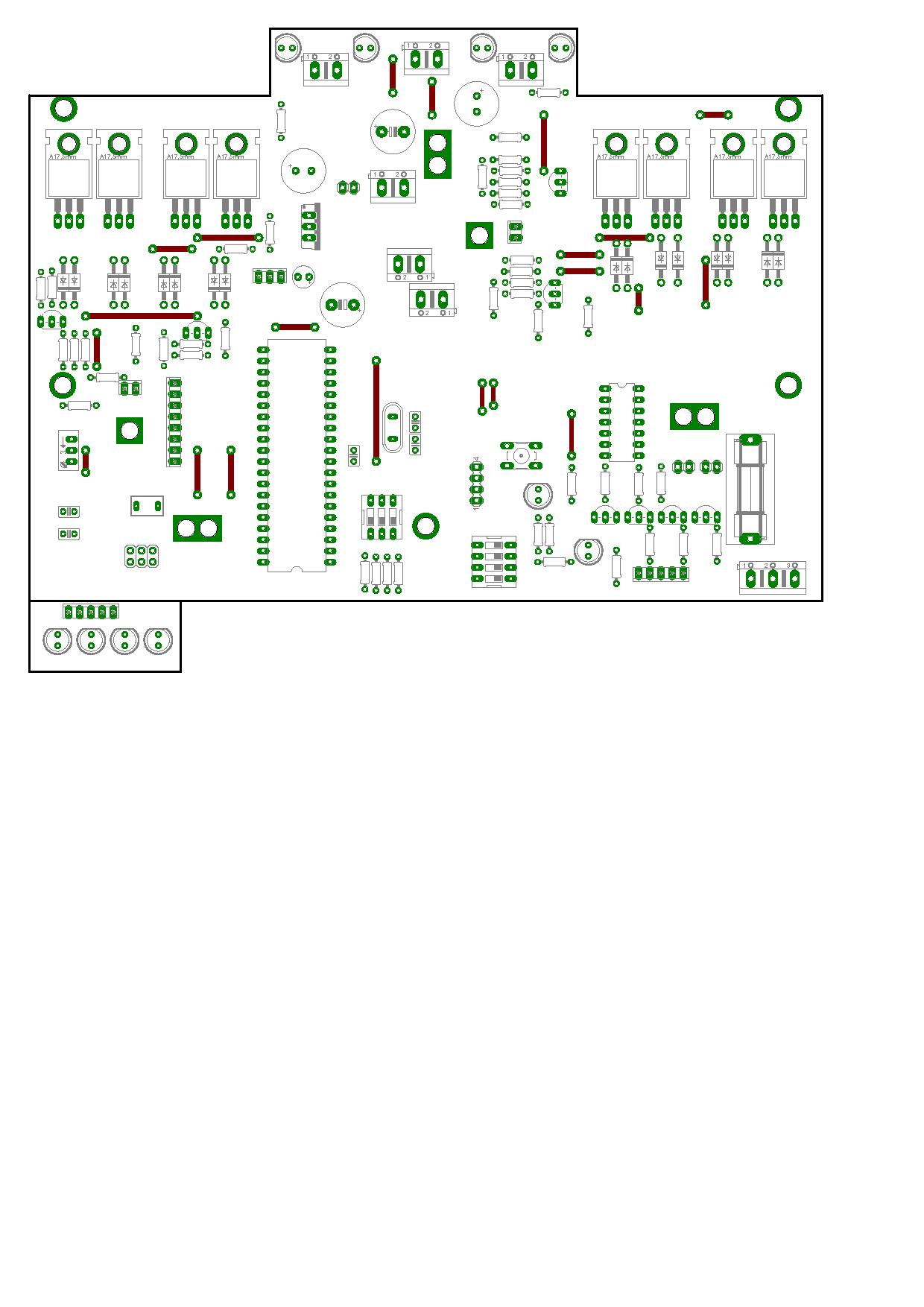

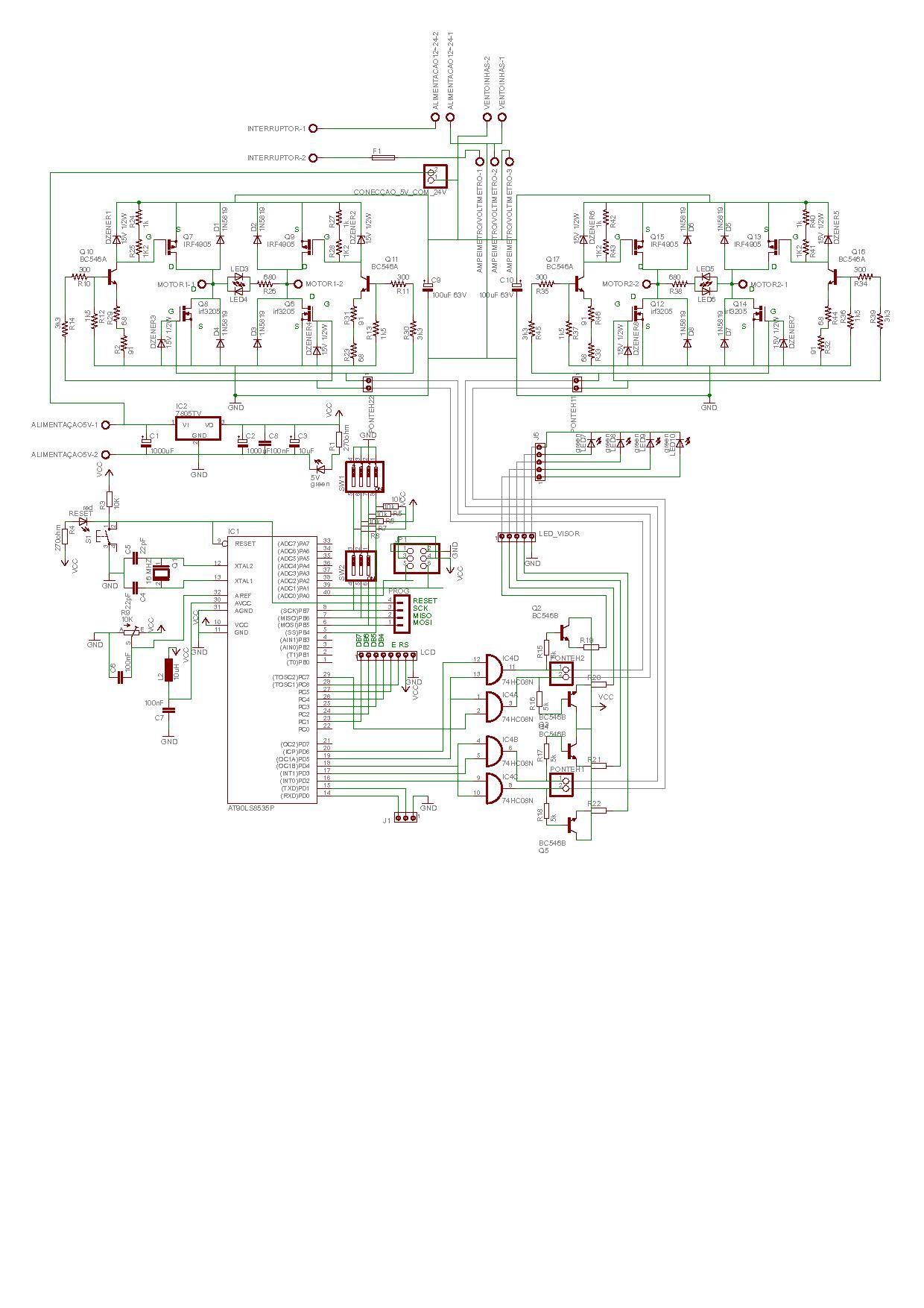

    hello!
    I want to build this board with exactly the same components but change the form, which is to fit in a box that I built.
    any difference between the LM2940 and LM7805? I've seen both datasheet and not find any.
    thanks
    Rappa

  8. rappa
    rappa New Member
    Jun 9, 2009
    15
    Portugal
    0Coins
    hello!
    R-eng can i put the lm7805 instead of lm2940?
    thanks
    Rappa

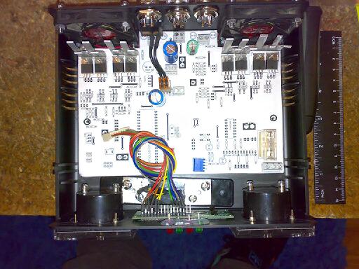

  13. rappa
    rappa New Member
    Jun 9, 2009
    15
    Portugal
    0Coins
    but I want the same energy source for engines and electronics ..
    the regulator will be hot but I have a good cooling :)

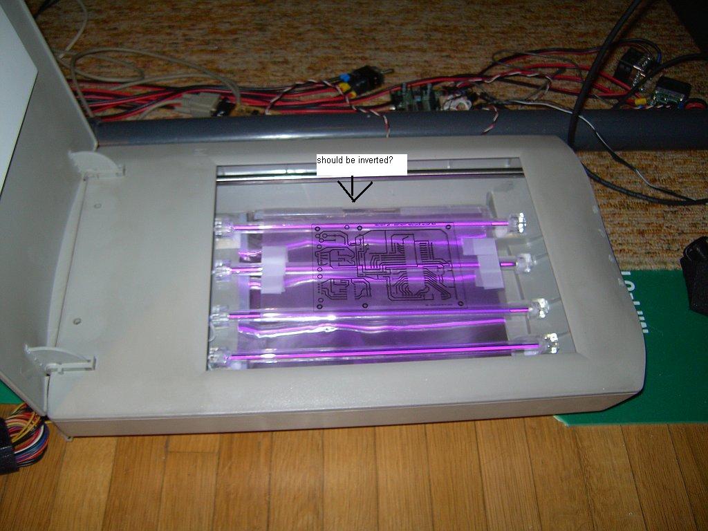

  18. stowaway
    stowaway New Member
    Mar 16, 2009
    213
    Gold Coast - Australia
    1Coins
    Hi Tronic thanks for your awesome instructions. Ive just started back on this project and made the perfect PCB board via the light sensitive boards. (following your instrucitons making one out of a scanner)
    I just need to know. (After stuffing it up myself first time around doing it this way) Why did you show a picture of an inverted PCB board diagram and then show a picture an uninverted PCB diagram on the scanner?
    as it needs to be inverted right?

  20. ne02005
    ne02005 Member
    Sep 19, 2009
    124
    Argentina
    105Coins
    +29 / 1 / -0
    Rappa, excelent work!!!
    you took all the unnecessary parts that are useless!!! like 8 Pots, servo (never working), programmer, etc
    Board is very small!!!
