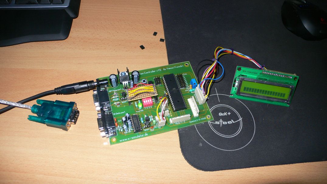

    I have my first problem with programming the controller.
    When i connect the usb/com adapter, the red led lights, (ponyprog cannot read the sec.bits, in the I/O setup window SI prog API test on com3 work fine)
    There is a trouble with the assembly unambiguously, or the usb/com adapter problem? (maybe not FT232R chip, i cant see)
    Another remark, the small green led not lights. ???
    Regards
    Pointer

    no estoy utilizando adaptador usb. Estoy usando puerto serie, el led rojo se ilumina cuando introduzco el firmware en el microcontrolador, El pequeño LED verde se ilumina.
    El fichero betaLcd24 no tengo problema con ponyprog. El problema es que la pantalla LCD no muestra ninguna información. Igual que la foto que se ve en pointer4.
    inglés traducido:
    I'm not using usb adapter. I'm using serial port, the red LED lights when you enter the firmware in the microcontroller, the small green LED lights.
    The file betaLcd24 I have no problem with PonyProg. The problem is that the LCD does not display any information. Like the picture you see on pointer4.

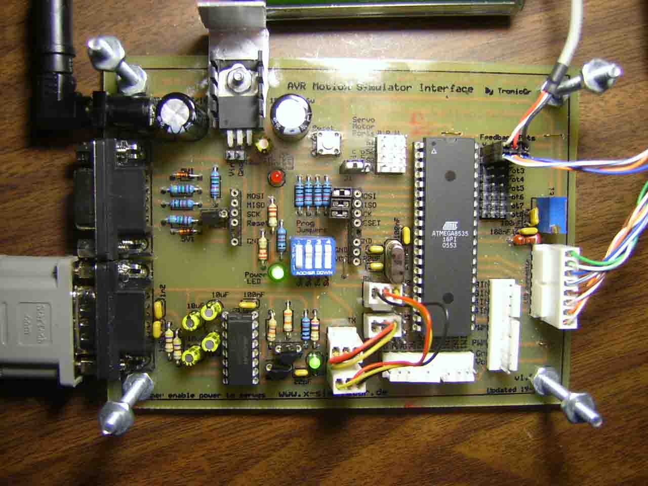

    I too am having programming issues. When I go into PonyProg and do the calibration it gives me an OK. However, when I proceed to the Interface Setup and click the Probe I get a test failed. I selected the AVR micro using the ATMega644 setup. I'm using a 9V 1200ma power supply, I'm using an ATMega644-2PU with the 24Mhz Crystal and the 18pF Capacitor. I went into Device Manager to verify the com port (Com 1 was the only one listed and the only one I have on the back of my laptop), I triple checked that the serial cable was properly connected and I'm runnning the latest version of PonyProg (2000). Any ideas?

    tmod: the firmware and fuse bits would be different for the 664, try it with the 8535.
    I would use the simple parallel port programmer: http://www.qsl.net/ba1fb/avrisp.gif
    There is less room for error, and it works just as well. At least for me :)

    Thanks Frakk. Forgive my anxiety but as I have the boards ready I am even more excited about finishing. I just got the com port working. I had to uninstall and then re-install it through the device manager. Everything went as expected. I loaded the following firmware version PWMBETA002LCD_OP24.HEX. It was able to read and write successfully however nothing is displayed on the LCD. Any ideas?

    Are you using the mega664? as I said it is probably not compatible. The firmware has to be adjusted, registers, inputs/outputs and such to make it work on other AVRs. If i'm wrong and everything is the same between the 8535 and the 664, maybe there are problems with the lcd connection, initialization or the controls. I really can't tell whats wrong as I haven't built it, but it is probably that you are using the wrong uC.

    After reading through all the forums I found that many have upgraded to the new ATMega644 chip using Thanos's updated firmware. At the time I could not find the 8535 unless I bought 25 of them. I did find the 644 along with 90% of the parts I needed for both the AMC and the DHBridge from just one site saving me dollars on shipping charges. So I went with the 644. Since my last post I changed to the 22.1184Mhz crystal with 22pf Caps. The LCD at the time was displaying just the top line with just solid blocks. Upon completion of the programming the LCD displayed both lines but both were solid blocks. I will try to post some pics. I read from the memory successfully which is leading me to think the problem is with the LCD as you suggested. I will do more investigating. Thanks a bunch for your time and promptness. It IS GREATLY appreciated!!

    The lcd controller is compatible. Check the pin connections and make sure they match whats coming from the controller. Enable, RS, data bits (check for least significant and most significant bits) and such.

    Thanks for your quick reply's. Today I discovered one of my jumpers on the back of the LCD was not seating properly. Replaced it with a new one and all is good except for one MINOR detail. I can view the LCD from a slight angle but looking at it straight on it is solid blocks. Is there anyway of adjusting the contrast? I have read on other posts where they were using the blue backlit LCD's and used a pot.

    If you look at the datasheet it shows you the diagram. The pin Vo is your contrast. Use a 10k-20k pot between Vcc and Gnd and connect the wiper to Vo, or just use 2 resistors, maybe a 5k and 5-10k.

    OK. I've got the LCD thing fixed using a 3K resistor across the Vo pins. I assembled everything including wiper motor very carefully I might add making sure nothing was shorted etc. I fired it up and had a SERIOUS current draw somewhere and fried a couple MOSFETS. Just to recap, I switched to the ATMega8535 and using 18 crystal with 22pF Caps and replaced all the IRFZ44's. Now when I fire it up it seems the only time the motor attempts to turn is when I reach a reading of 400 on the LCD. When it does reach this point the motor tries to start but seems it doesn't have enough juice so it just clicks and the green LED barely comes on. I noticed I had +12V on each leg of the motor connector on the DSMhb and none of the MOSFETS even warm up. That doesn't seem right? I am using an old 350 watt power supply from years ago and never used for the DSMhb. It has a 12A rating so I figured this would be OK for no load testing. Any ideas?
