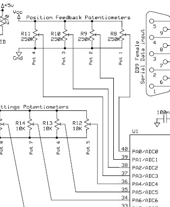

    Hi Tony,
    What schematics are you referring to? There are no 250Kohm resistors on the AMC1.5 ...!!
    Perhaps you are talking about the potentiometers? Yes you can use any potentiometer in the range of 10Kohm to 250Kohm you want. Just be sure to use shielded audio cable for their connection to avoid EMF interferences from the motors.
    Regards, Thanos
  2. goodman
    goodman New Member
    Mar 3, 2009
    0Coins
    Dear Thanos,
    So many thanks for your reply.
    yah, I am talking about the potentiometers.
    Pls see the schematic as follow.
    Thanks again,
    Best regards,
    Tony

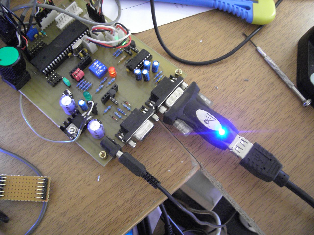

    Still having problems with the avr. Can't get into hyperterminal. I use the converter that
    Thanos mentioned.
    What should I test on the board? Something must be wrong there.
    gr. Jeroen
  5. egoexpress
    egoexpress Active Member
    Dec 13, 2006
    3,839
    Germany - Frankfurt/M
    421Coins
    +10 / 1 / -0
    How did you made the wiring for the RX and TX cables (3pin Molex)? Did you wire the connectors straight or crossed? If you would post a good res pic which would taken with some care (lighnting, cleaned up the cable mess) that everything is visable, I wouldnt have to ask you the same questions again...
    Try to borrow a cam, and make some good pics of your interface...
    Or scan the interface with a scanner...
    regards
  6. Jeroen
    Jeroen DoctorXeno
    Oct 3, 2007
    121
    Holland
    - 79Coins
    The cables are connected correctly. I'm sure about that. I will make a clear
    picture and post it.
    Is it a problem that I am using a max232n instead of a max232cpe?
    gr. Jeroen

  10. tronicgr
    tronicgr
    Nope, They function the same. You could try using 1uF capacitors next the the MAX232 chip.
    Except the problem with hyperterminal, are you able to sent values to the AMC from USO profiler??
    As Egoexpress said Photos or video can help us understand better whats wrong with your board...
    I trying to upload a video that shows the procedure of using the hyperterminal interface on the AMC1.5 , connected through a FTDI based USB-2-serial adapter (digitus). It works fine for me on my WindowsXP. I don't have Vista to also test this.
    Best Regards, Thanos

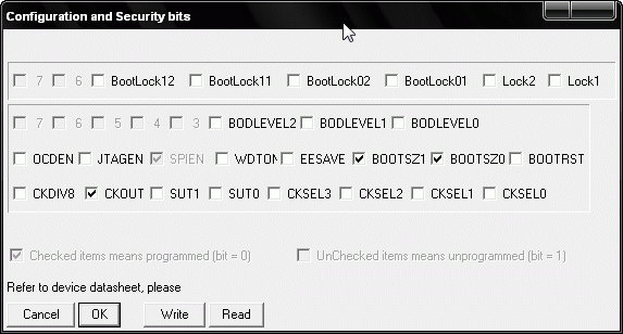

    Hi to all,
    If you need to switch to a better Atmega644 chip (instead of the Atmega8535) you have to be careful with the fuses in Ponyprog.
    Set them exactly like in the next photo otherwise you may not be able see any messages on the LCD or even result in inaccessible chip by the programmer.
    These fuse settings are valid for use with crystals of 18.xxxMhz up to 24Mhz. The problem was that by factory the Atmega644 has enabled its JTAG and On-chip Debugger, that prevented the LCD data lines to work as supposed.

  16. tronicgr
    tronicgr
    I prepared a short tutorial video that shows how to setup the connection with hyperterminal and the procedure of configuring the KP setting for the motors. For this tutorial I used an FTDI based USB-2-Serial adapter (from Digitus) to show that it actually works!!
    I have put the video unedited on Rapidshare link so it does not loose any image quality! Please be a little patience to download it and watch it.
    http://rapidshare.com/files/207931453/AMC_KP_Setting_Hyperterminal_tutorial.AVI
    Here is the USB-2-Serial adapter I used:
    Regards, Thanos
