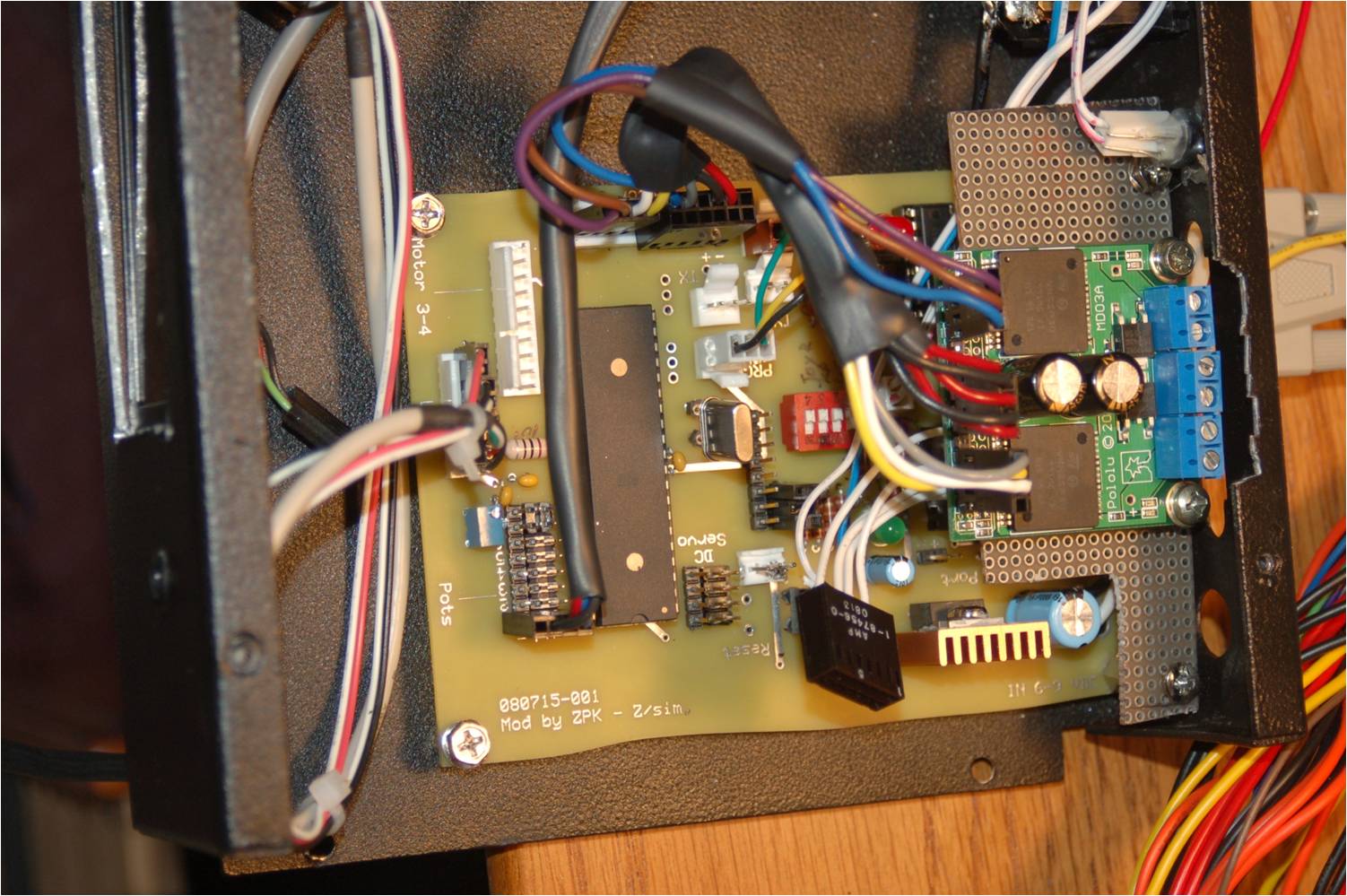

    All was going well. I replaced my Atmega8535L with the correct one and it fixed my problem. I probed OK, sent firmware, and made it all the way through Thanos video guides succesfully. The LCD display behaved exactly like it should have when I moved the pots, or moved the slider in profiler. All lights were on.
    I decided to use Pololu board, while I am still working on the H-Bridge. I used a 300W computer power supply to see if everything was functioning. I plugged in my wiper motors, double checked all connections, and turned power on. The result was my motor did about a 1/4 revolution and then everything stopped working. My LCD went blank and lights turned off. I quickly unplugged my power supply and was suprised to see the power supply fan still on! when I unplug the 9V AMC the power supply fan stopped. Still, lights are off and LCD is blank. Not sure what to do now. Any ideas?
    I took the best picture I could, but need more light in my office. If there's anything anyone would recomend I'm eagerly awaiting.
    Very discouraged,
    Dave
  18. tronicgr
    tronicgr
    Hi Dave,
    Check your potentiometer connections. If you had it connected wrong on the AMC, and connected it on motors rotation path for feedback, It would cause short circuit after rotating...
    Also try to have separated the AMC and Pololu Motor ground's and check if your motor has its ground connected to its housing!
    In your photo the pololu ground seems to be directly connected to the AMC through the mountings. Place them apart to see if this is happening again.
    Can you power on the AMC with all cables unconnected? If not you should change the LM2940 Regulator.
    BTW. where you made your board? ExpressPCB or other company?
    Regards, Thanos
  19. adochoa
    adochoa New Member
    Jan 28, 2009
    22
    1Coins
    my board is from Express PCB.
    The pololu ground is isolated from that of AMC and the potentiometers, I believe, are hooked up correctly.
    I cannot power up my AMC any longer so will change the regulator.
    thanks,
    Dave
