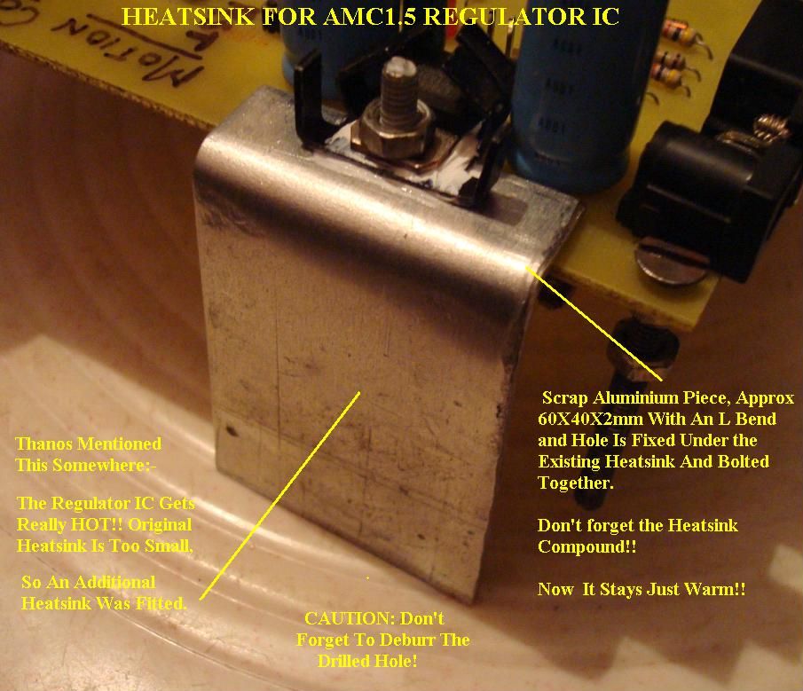

    Just a small thing I did for my AMC I happened to feel it yesterday. And it was really HOT!
    Regards, Erich......

    3. With the LCD connected you should see a message on it informing you that the AMC entered in hyperterminal KP setting mode...
    4. About Ian's BFF driver, my AMC works with all versions, even the latest 1.6.5 that its on his site right now. I tested it right after it was released about a week before. I don't setup the BFF driver as HEX or HEX2 or MEM... I set it as BIN mode with speed 115200 !!!
    5. Thanks for the regulator cooler tip. It can be handy for those that want to have their LCD with backlight ON!!!. With backlight off it wont even get warm!!

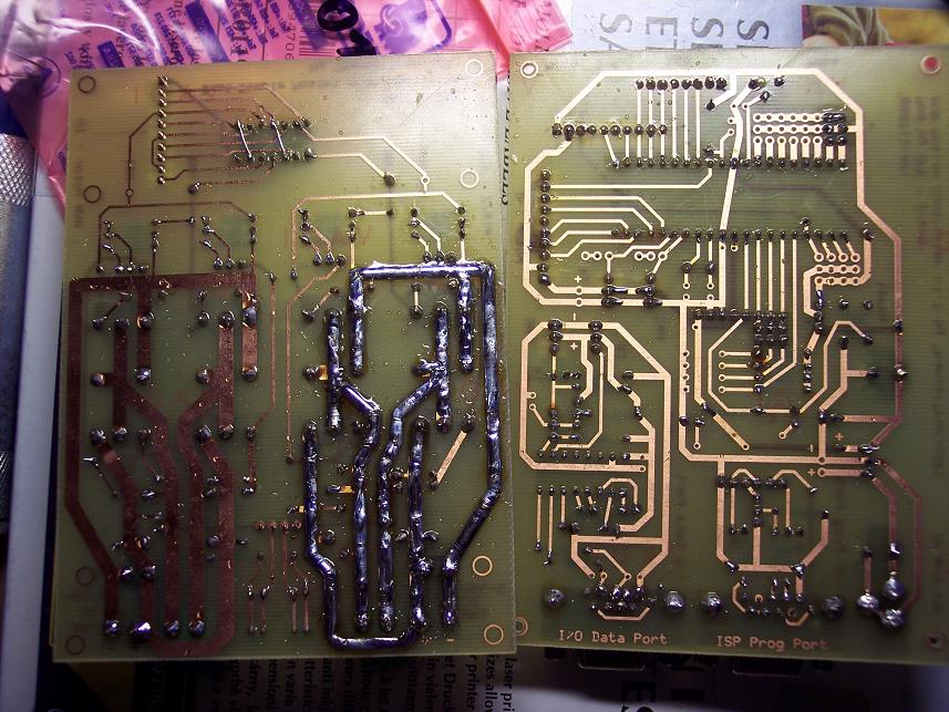

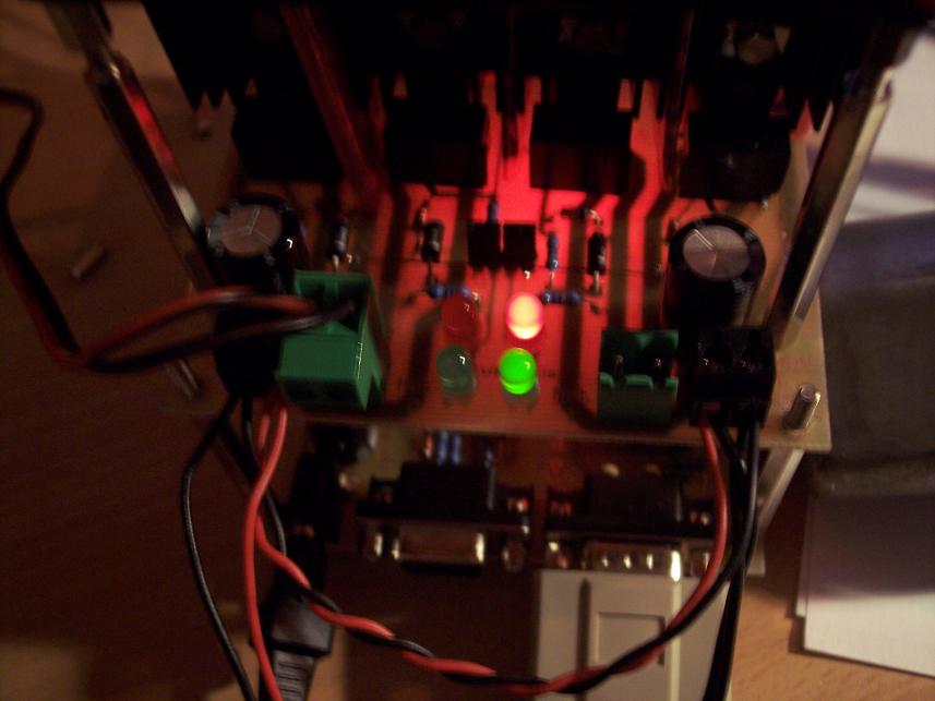

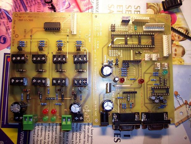

    hi so iam sending my fotos of h.bridge and avr motion controller. but i have someproblems one output on h-bridge have still few volts and motor is moving alittle bit.. and diods are lightning in zero position.. on pots iahve selected 500 on lcd on both pots any help? is not able that any mosfet is bad and leak out any voltage. any help? also i dont know which source you are using for giving 12v for motors?(what about battery of car?)my avr controller is working with 22Mhz crystal only.[

    i send a video of my problem my potentiometers are in center but motors still give the voltage.. WHY? when i ttry h-bridge alone only like was written tocconnect +5v on input and M1N1 and M1N2 to GND it works fine i think there is some problem with atmel? isn it able can anybody make agauge of outputs from atmel? on M1N1 and M2N2? i dont know anymore what todo today itis 5th day when i am reparing problem

    Hi Mila,
    did you measured the outcoming voltage. How much is it?. What happened with the voltage (measure it) if you turn the pots left or right to its end position?.
    I`m using a 12V Car Battery. Which source are you using? and do you use a fuse (+12V wiring)?.
    Are you sure that the mosfets are still OK?. Ckeck them with a multimeter, Checking Mosfet.
    For example, i have burned my mosfet with my selfmade Power Supply :whistle: , now i`m using a car battery.
