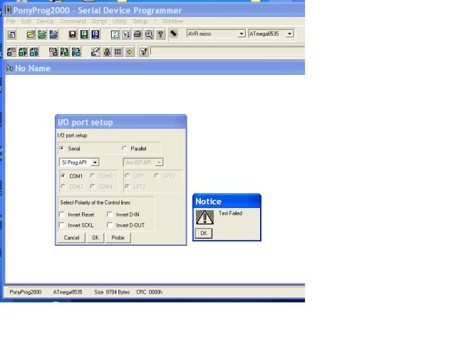

    I finished building you amc 1.5 and dsmh 1.2.
    but now i have a problem, i can't program the atmega8535 pu.
    I checked everything but it seems good to me.
    I diy'ed the programmer cable from spare parts and checked it with multimeter, also this looks fine.
    The ponyprog2000 still keeps saying Device missing or unknown device (-24), and when i press ignore it will say the same with any variable setting you gave us (api i/o).
    what could this be?
    regards wim post.
  14. tronicgr
    tronicgr
    -What crystal do you use?
    -Are you using USB2Serial converter?
    -Did you alter the Ponyprog ini settings (like Erich suggested)?
    Any photo of the board? Closeup is better... :yes:
    Regards, Thanos

    i'm using the 22 mhz kristal.
    i'm not using any converter just seriele port.
    did,nt try the INI setting I will do this right now.
    And i will se about that photo!!

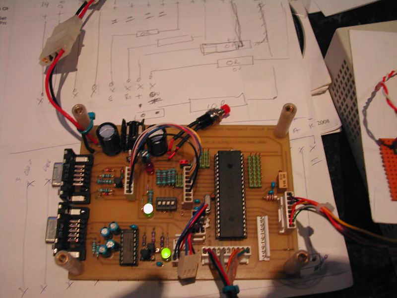

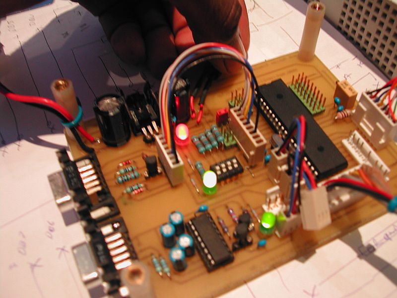

    Hi Thanos, pick your brains time :blush: have completed my AMC Controller PCB and have powered it up ( No Smoke 8) so far ) and checked the 5v supply at all the key points in the circuit and everything seems to be where it should be ... Both Green LED light up as they should and the RED Reset LED lights up when i press the reset switch ( all fine so far ) fitted both the ATmega and the rs232 chips and tried to flash the controller :blush: :blush: pony prog calibration ok but test failed error message comes up when i try the PROBE test :sos: i am using a staight through serial cable for the PC to AMC 9 pin female ISP connector and have tried other cables all with the same error message ...... you may have been down this road with other users and i appologize if im asking a FAQ ...could noot find the relevant post with this answer but if anyone knows the number i would read it :blush: sorry if im wasting your time guys im hoping it will be something i missed.. by the way should the three jumpers be removed for programming or can they be left in ( i ask because the help video seems to show them left in and also various pictures i have seen of completed pcb's also seem to show them in place whilst the programming bridge is fitted ( BUT the Pony Prog 2000 guide clearly says remove MOS1,M1S0,SCK, also shows the ground connection of ISP not linked to the Atmega side of the Bridge Connector ?? having fun guys and loving it :yippiee: soory for the shaky hands pictures in advance excited :highfive:
