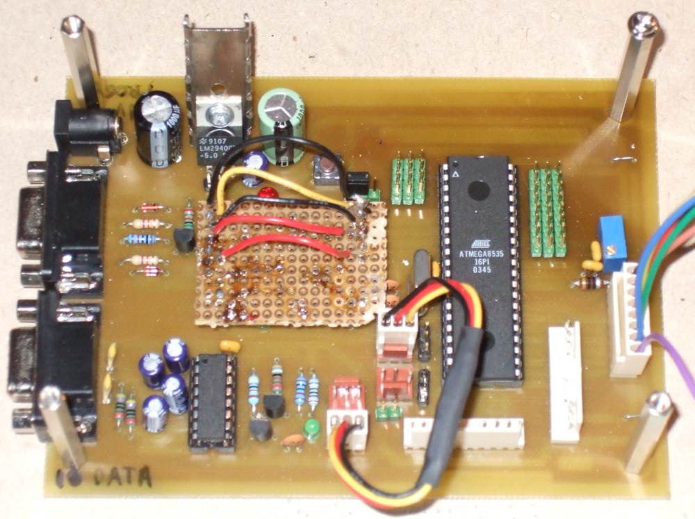

  12. promy
    promy New Member
    Jun 29, 2008
    14
    engineer
    Belgium
    250Coins
    I tried programming the atmega, and it worked perfect!
    I used the hex for 18MHz crystal with 22pF as stated in the part list.
    The lcd attached is a 2x16 (DEM16216)
    Thanks thanos for the nice layout
    now for the H bridges...and the seat ;-) looks like i know what to do during the holiday in 2 weeks!
    below a picture of my board
    (ps i had a problem with the lcd, but seems it was missing one connection(bad solder))

    I still have one (well for now :D ) question...
    When i put power on the board, the multiturn resistor, gets really hot, and i do not get any response from the pots.
    Does anyone have any idea why this is so?
    the switches are set to (1-4) on-off-on-off
    the display shows on the first line: 128 128 10231023 and it does not change when turning the pot
    The pot is a 100KA linear pot, slider and +2 / gnd is connected correct
  15. tronicgr
    tronicgr
    Hi Promy,
    It seems to me as short circuit or something. Perhaps you have not connected the legs of your feedback potentiometers on the correct pins on the ADC ports.
    Starting from the pin that is towards to the ATmega8535 chip the ACD port pin-out is:
    __
    __| - wiper input , +5V , Gnd
    Another simple test you can do, is to un-connect all the pots and touch the wiper inputs with your finger. You should see random values appear on the LCD instead 1023. If you still see 1023 values after you disconnected the pots then its because of short circuit!!! Normally with unconnected pots you should see ADC values of around 500 - 600 appear on the LCD.
    Also try to screw the 10K multiturn pot to the other end cause maybe its blocking entirely the ADC range with its current position value! This multiturn pot is used to limit the range of the ADC to lower values than 5volts.
    Regards, Thanos

    Hey Thanos, found my problem... i seem to have misread and soldered a 10ohm multiturn resistor instead of a 10K, changed them and it all worked.
    I'm just waiting for the rest of the components for the H bridge now...
    Thanks for the help!!

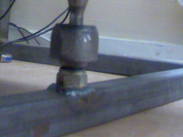

    @Jeroen: what did you use for the pivot point? Can you post some pics? (or drawings :) ) Thanks!!

    @Promy
    I dont wanto to go OT in Thanos thread, but to answer your question regarding the pivot. You could use such a rubber machine foot / silent block.
    They are quite cheap. Try to grab a M10/M12 one for approx 300-400kg.
    Regards
    Christian
  20. Jeroen
    Jeroen DoctorXeno
    Oct 3, 2007
    124
    Holland
    - 71Coins
    +7 / 0 / -0
    I used used the following...
