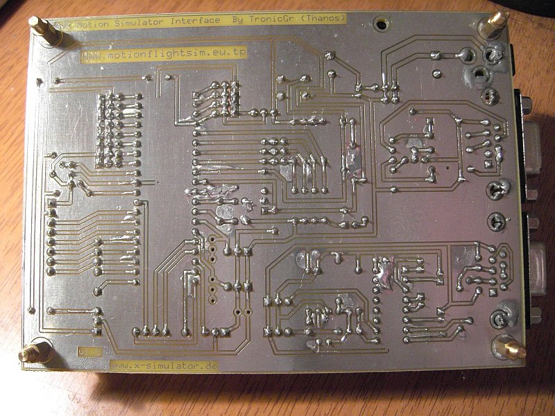

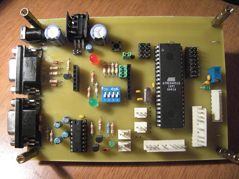

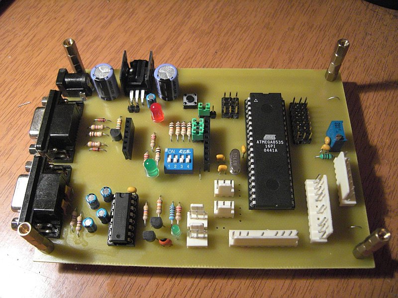

  15. tronicgr
    tronicgr
    Another AVR motion controller board (1.5v) is ready!
    There are some holes with no compoments on them near the TX-RX connectors. I placed them in case someone wants to simply solder some wire pieces to do the connections permantly instead of using molex.
    Its ready to accept the dual H-bridge board on it! :)
    Regards, Thanos

  17. RoVoR
    RoVoR New Member
    Sep 12, 2007
    19
    0Coins
    Hi all,
    I've allmost finished my 1.5 board.
    The etching worked out fine as did the soldering. I must say i was a little scared to start this project (this is my first project ever), but i'm pleased with the results.
    Here some pictures.
    I've ordered the parts for the Hbridge and want to start building as soon as they arrive. But i think i have to be a little patient and wait for Thanos to complete his work with the H-bridge.
