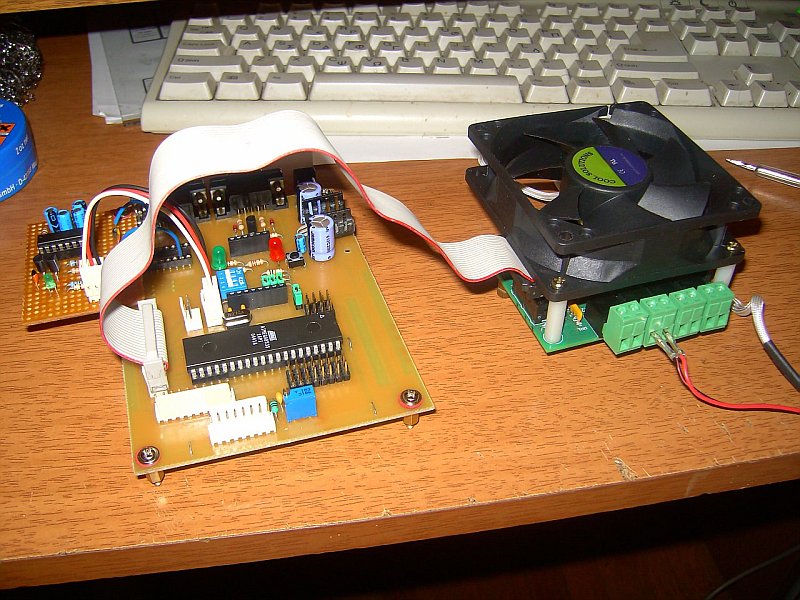

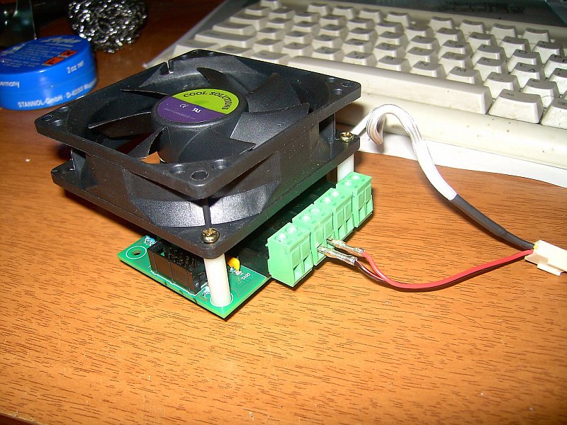

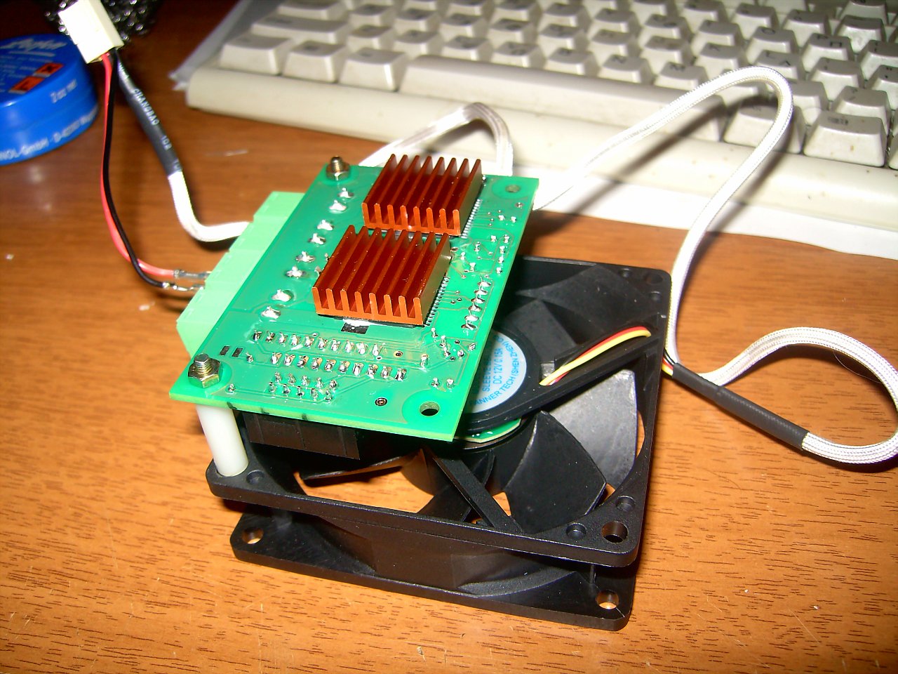

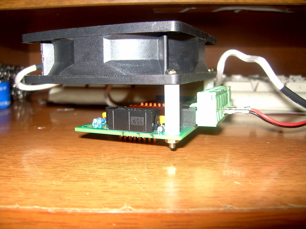

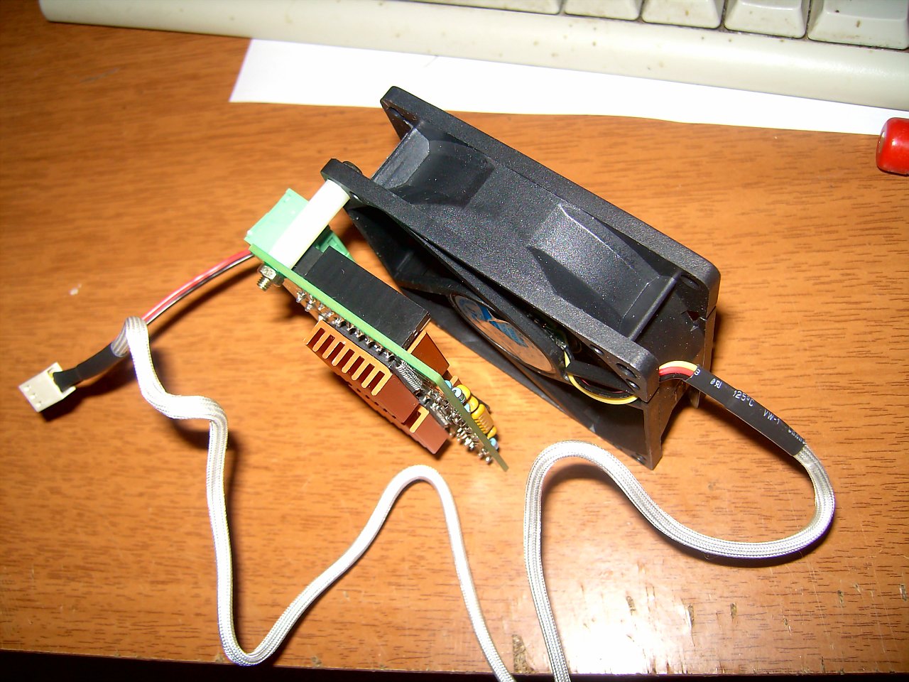

    As a precaution I attached a 80mm computer case fan on the RN-VN2 controller to blow air on the alluminium coolers that I placed on the chip heat dissipation path. I assume that the RN-vN2 chips will heat up when having to deliver the 15amp that wiper motors draw in load.
    The nice part is that you can use the second pair of power connector that exists on the RN-VN2 to power the fan with the 12v it needs!!
    And from what I've seen during a short circuit of the test table motor leads it can reach fast up to 100 degrees of Celsius. Luckily when this was happened the RN-VN2 has shut itself down. I was working on 6volt battery/motor conbination then. But now I want to move to 12volt 100Ah car battery, and I fear that a stall of the motor will pass to the motors lots of current that can burn up the motor or kill the RN-VN2 if high temperature is reached. Anyway it better to take measures before something bad happens. I will attach an thermometer with LCD display on the RN-VN2 to see how it heats up during play and I suggest to do the same if you have one.
    I tried to unsolder the black clip connectors for the motors connections and place other connectors with screw lead but it was impossible to do so. They seem to have solder on the upper side too! Damn... So I atleast changed the screw clip part with a better quality green ones that I found localy. I hope that will have better contact behavior than the old ones...
    Regards, Thanos

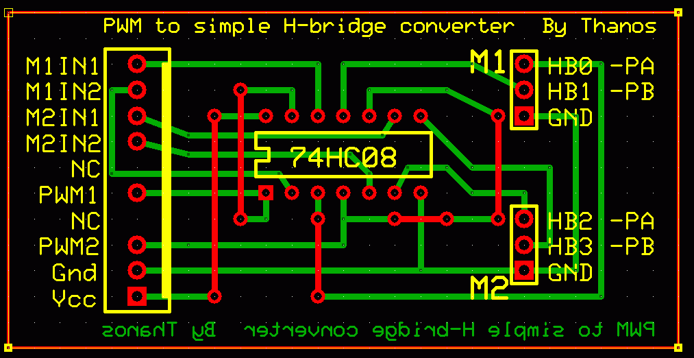

    I have another good news!
    I figured a very simple way to switch the PWM signal to any h-bridge circuit!! I used a single chip in this design and will test it the next days to see how it behaves.
    So there is hope to use simple h-bridge motor controllers as EvanF does or even design and use your own h-bridge circuit to the motor amp/voltage needs!!

    The credits in this case goes to Erich Leonhard (from http://www.mycockpit.org) for motivating me into this!
    He sended me some usefull info on h-bridges that I used to find the solution!
    BTW the chip I use between the AVR controller and the h-bridge is a simple 74HC08 !!! :D

  12. tronicgr
    tronicgr
    Hi again,

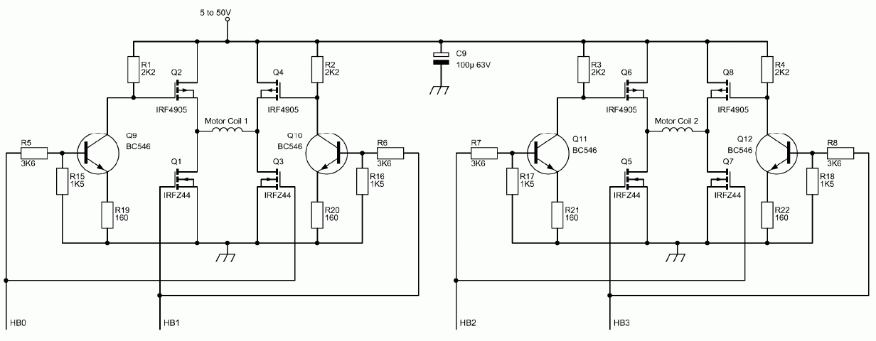

    I confirmed the concept and prepared a small PCB layout that you can use to connect any simple h-bridge motor driver. This small board connects in the same ports that you connect RN-VN2!
    [​IMG]PWM_to_simple_hbridge.pdf (116.97 KB)
    And here is the schematics of an simple H-bridge you can use with it. I hope to make a PCB layout for this later.
    If you wonder, this is the h-bridge section of the KT-5198!!!
    @EvanF: I added the PA and PB markings of your simple h-bridge on the PCB silk layer, for you to see how to connect it.
    I don't think is nessasary to connect toggether the grounds of the avr motion controller and yours simple h-bridge but I added ground pins as well! The way I see it when PA is PWM the PB is Ground, and the the same for opposite.
    I double checked everything and it should work like a charm! If you can't solder a PCB you can place the 74HC08 on a breadboard and follow the schematic to do the wiring for the first tests.

    Awesome news! PCB of H-Bridge good too, the circuit is a simple one and the IRFZ44 has been reliable for me, with fans even more reliable, they are cheap too!
