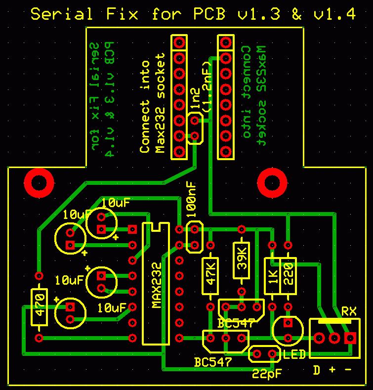

  10. tronicgr
    tronicgr
    I prepared a layout of the small PCB board that replaces the existing max232 circuitry. I designed it in such way to be able to use the existing 9-pin serial connector, in case you want to solder it on a pre-drilled protoboard instead of eching it.
    [​IMG]serialcommfixPCB_bottom.pdf (24.87 KB)
    [​IMG]serialcommfixPCB_silk.pdf (22.23 KB)
    You can mount some legs on bottom of the this board on the 16pin connector and place it on the existing ic header of the original max232 circuit on the AVR controller.
    To be able to place it on the old max232 ic header, you must desolder the existing RX - TX molex headers on the max232 circuit side. Then solder one of them on the PCB fix board so they won't go wasted.
    To secure the PCB fix board into place, you can use the existing two large holes on the avr controller with some distance holders.
    I haven't found the time to solder this board yet but you can see it working on the testing breadboard!

  14. tronicgr
    tronicgr
    Its easier for me to solder a fix board as I don't want to solder a new board yet. I will later to host the second version of the AVR controller that will use the ATmega644!!
    In the place of molex headers you can use simple SIP headers or just wires. I will add the jumpers you wanted, in the final design, in case you want to use simple wires for the connection, so you un-jumper them and use other external circuit in place of max232 (if needed).
    Thanos
  15. tronicgr
    tronicgr
    The STK500 development board does use all these extra compoments! Except from the led! The simple circuit I made on the earlier 1.3 & 1.4 versions was a simplified one that can be found all around the internet in relative applications. Just didn't worked for me and tried to copy to complicated circuit of the STK500.
    After seeing that either this didn't worked I started to search the differences in the output signal. And added the led to see whether the output was on or off. It somehow made it a little more stable so I decided to reverse it so it can sink the signal. This did the trick! I was getting a clean serial signal after that.
    I couldn't find why there is such difference between the two circuits but I guess they must have implemented some trick not mentioned on their manuals!
    I changed the 1uF capacitors with 10uF capacitors and you must solder them on the fix PCB board instead on their original place on the AVR controller PCB. As you can see I only retrieve the signal line and the ground from the old max232 socket.
    Regards, Thanos

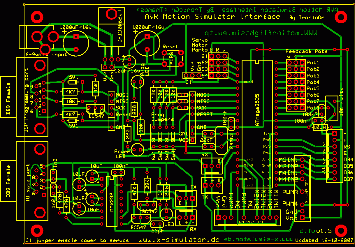

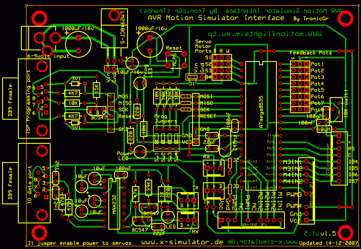

  16. tronicgr
    tronicgr
    Here is the AVR Motion Controller v1.5 !!
    [​IMG]AVRmotionsimulatorcontroller1_5.pdf (408.8 KB)
    And here is only the bottom side layout:
    [​IMG]avrmotionsimPCBbottom_only_1_5.pdf (99.49 KB)
    I fixed all issues on it including larger holes for easier insertion of some compoments along with various other minor designing issues. Serial communication should work fine in this version.
    Regards, Thanos

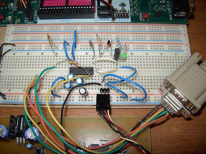

  20. tronicgr
    tronicgr
    I prepared the small fix board that solves the lack of reliable serial communication for the old versions of the avr controller (v1.3 & v1.4).
    I placed the compoments on a protoboard, following the layout that I given before. I used the long legs of some of the compoments to create the lines. As I was building it, I decided to cut the upper part the of layout and to use some wires to connect the signal from the serial port and the ground because I couldn't find proper distance holders, only some short ones. But is still it looks cool, and most important, it works fine now!
    [​IMG][​IMG][​IMG]
    [​IMG][​IMG]
    Can't wait to solder the new AVR motion controller v1.5 PCB that is perfect in all aspects!
    As all hardware problems seems to be solved its time to have some progress on the programming side too! Many features are waiting to be added on the AVR controller so please give me some feedback on the effectiveness of the first two beta firmwares, I've given, to set some standards and build over them. For now I'm adding HB-25 servo motor control (and all R/C compatible motor controllers, like i.e. the KT-5198), for uncoupled and coupled SimforceGt motion style.
    Regards, Thanos
