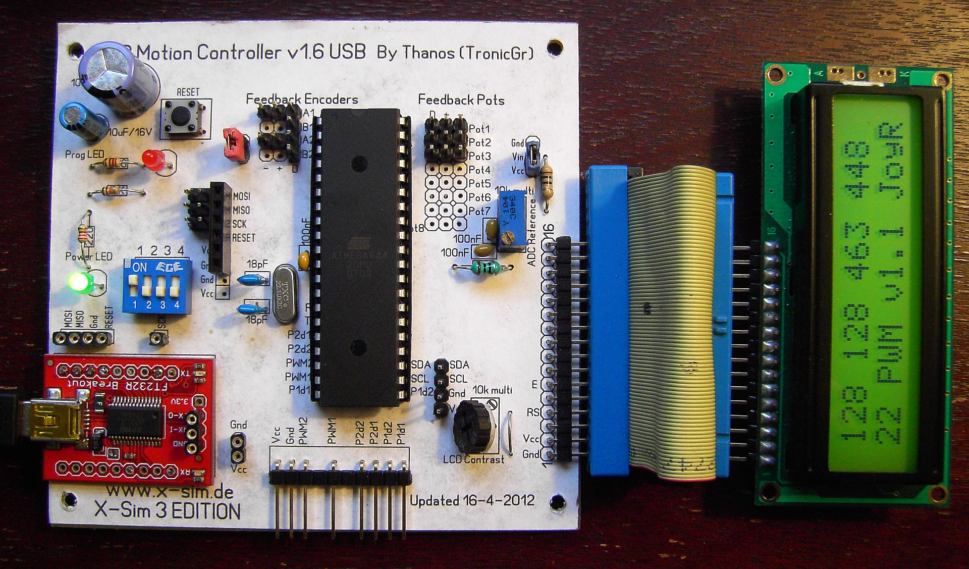

    BEWARE: This 1.5 version is obsolete now! You can find the new version, the AMC1.6USB on the following link:
    Thanos AMC1.6 USB Motion Controller.

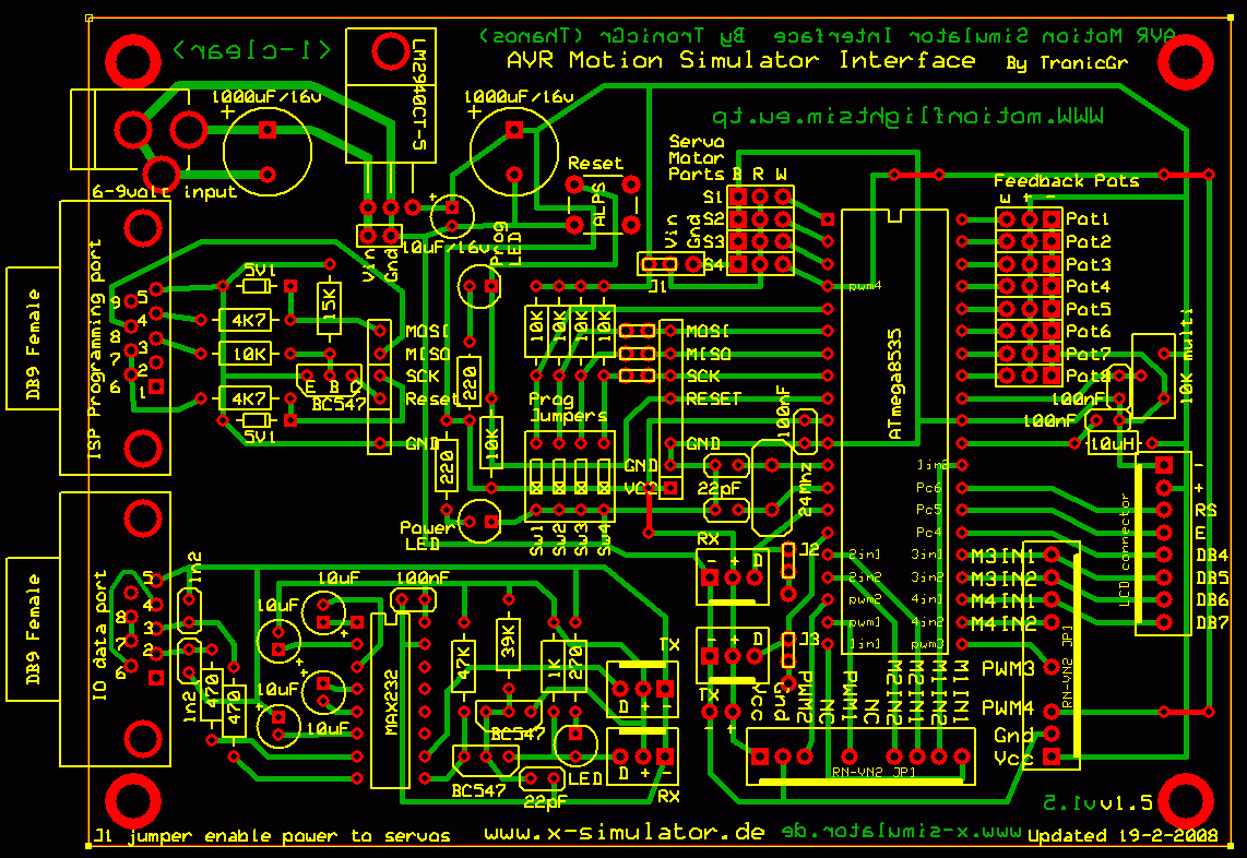

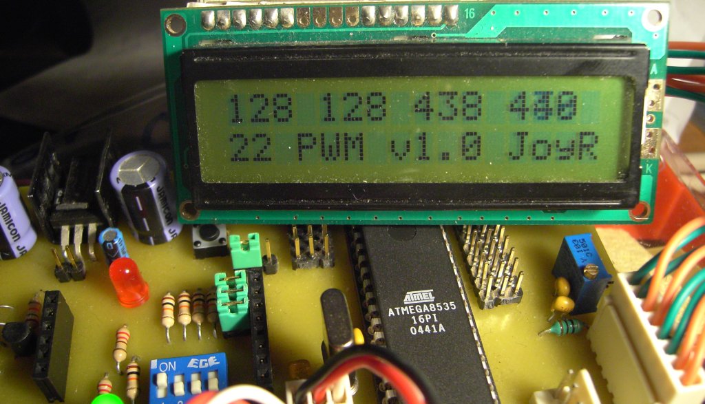

    The AMC1.5 AVR controller supports 2 full H-bridge PWM channels to drive the motors. The connections will be made in the same ports and its function will be selectable by dip switches.
    The major features are:
    - 10bit (1024) motor speed resolution
    -2 actuators/motors support (in latest firmware 1.0)
    -2 full PWM channels, 2 - 8bit pwm channels (Not implemented yet the extra channels lack of timers).
    -4 potentiometer inputs (that sets the max travel angle and the proportional speed.)
    -LCD support

    Below you can see the layout I made to be able to follow the RN-VN2 connection standards. PCB plans are included to built this board if you want. Over this layout I’ll add the rest software features to make it able to fit to every type of motion simulator. Other PWM motor controller can be used too since they use the same basic connections (PWM, Enable1, Enable2) just different layout of the connection stripe.
    AVRmotionsimulatorcontroller1_5_aa.pdf
    And here is only the bottom side layout:
    [​IMG]avrmotionsimPCBbottom_only_1_5_a.pdf (100.25 KB)

    Some technical details about the AVR motion controller:
    Motor 1,2 run on 9bit PWM on 23,47Khz (9bit = 512)
    Motor 3,4 run on 8bit PWM on 23,47Khz (8bit =256) (not implemented)
    Has 8 ADC channels with 10bit resolution (10bit=1024)
    Actually I drive the motor on 10-bit resolution! 0-511 for one direction of the motor and 512-1023 for the other direction!!! Same double resolution is used for motors 3,4 (9-bit)!

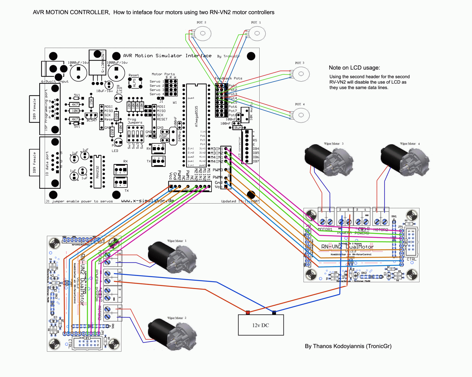

    Here is a schematic on how to do wirings for two RN-VN2 controllers to support 4 motors in the future... Only the first header in used for now.

    You can connect two dual h-bridge motor controllers on it and control four motors but with a small restriction. The last two motor channels will run on 8bit PWM. This is a restriction of the Atmega8535, as it has only one 16bit timer that is shared on the channels for the two first motors. Anyway 8bit PWM isn’t that bad and can be used in heave or rotation that precision isn’t so critical.

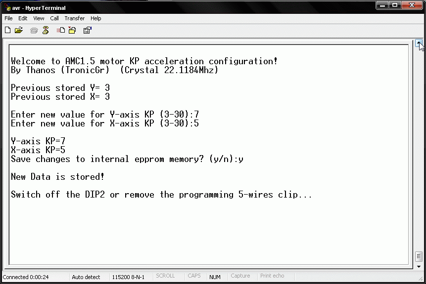

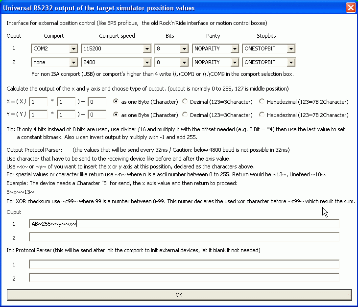

    -It runs on serial speed of 115200 and you have to enter the setting of the following photo in the profiler USO to get it connected right:
    The format of the output string is “AB~255~~y~~x~”
    The ~255~ is there for compatibility reasons to be able to also test with Ian’s BFF 3DOF driver!!

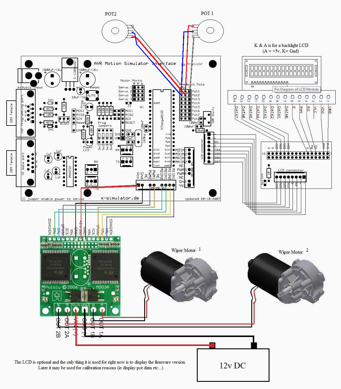

    And here is a schematic of the wirings you need to do to use the Polulu motor driver:
    Its Yobuddy's design with a minor fixes on the pots connection.

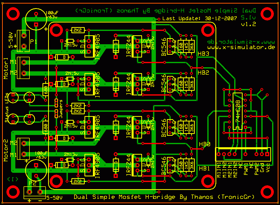

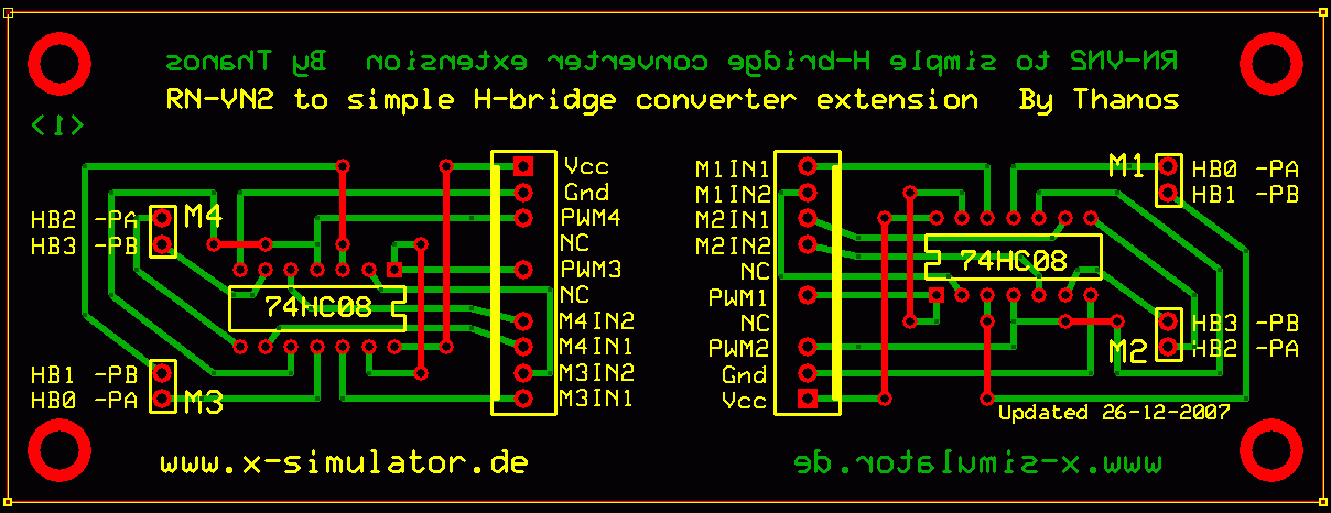

    Another solution instead of buying a ready commercial motor controller is to make yourself the H-bridges to fit them on the amp/voltage rate of your motors. Then you can build this DIY Dual simple H-bridge motor controller!
    You can learn more about it here:
    http://www.x-simulator.de/forum/tronic-s-diy-dual-mosfet-h-bridge-t820.html

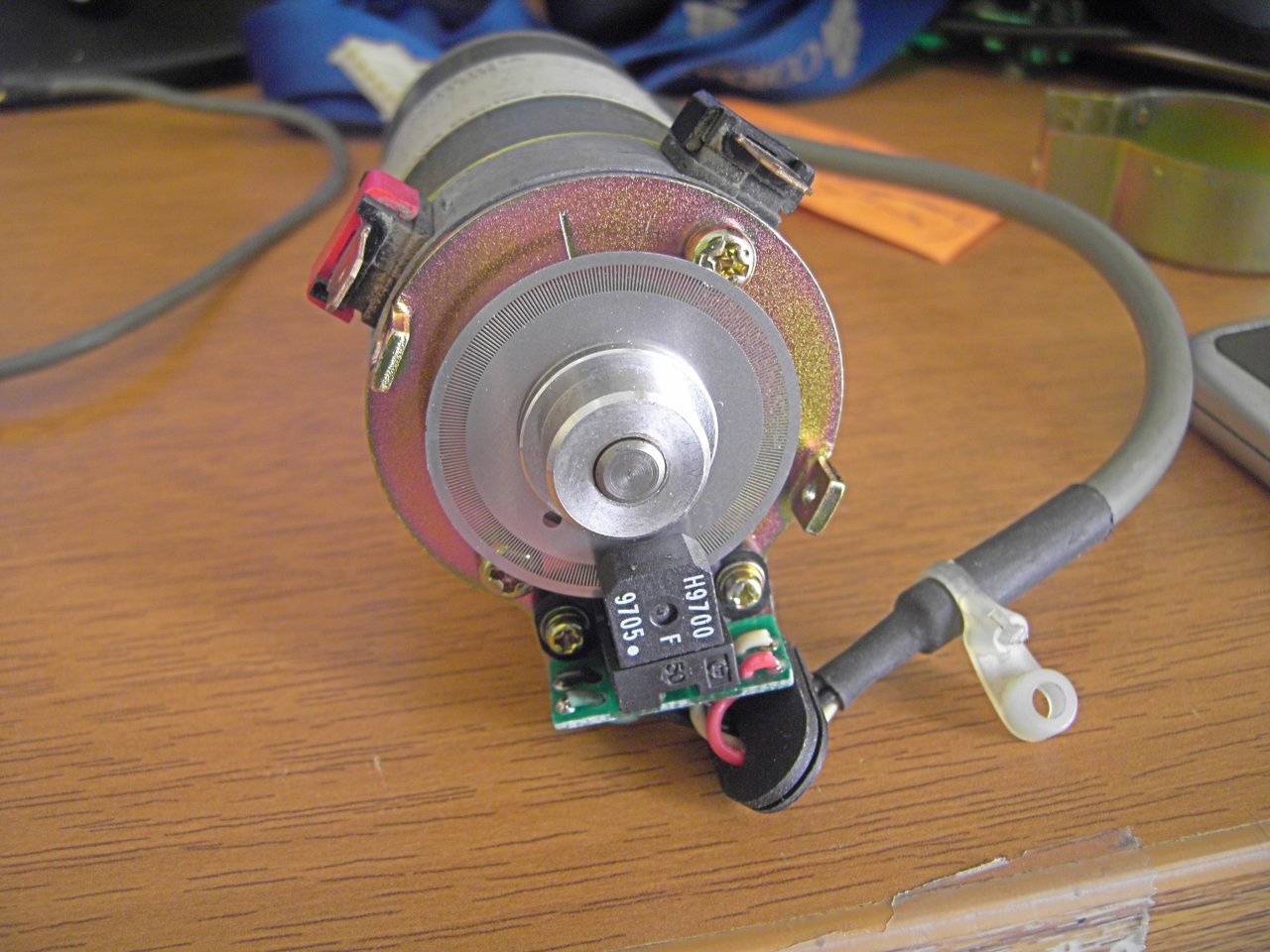

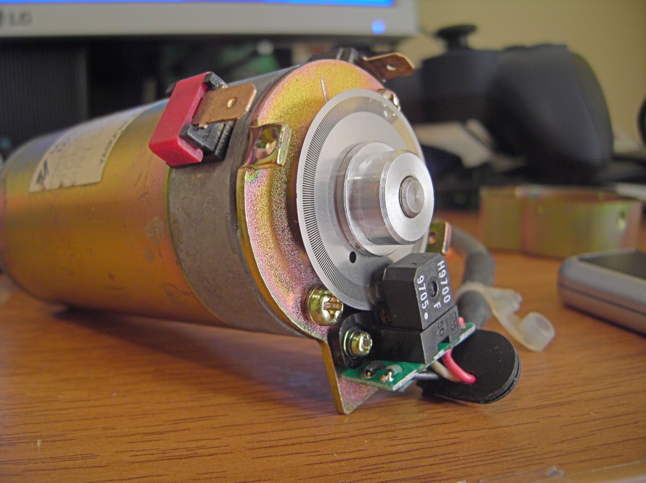

    It happens to have some quadrature encoders at home and one of them is fixed on a DC motor:
    The disk looks like 256 cpr or more!!!
    The only thing that troubles me though, is the centering of the motors, while using quadrature encoders, that has to be done during power-on with full travel of the frames until limit switches are reached... Any suggestions?
    In my oppinion I now find the limit switch idea unnesessary... I could program it in such way that it will do some training by itself about the limits in all axis, the first time it power up. Then if re-training is required I could program it to detect if you pressed two or three times the reset button to start over again. To detect the limit of its travel I could program it to monitor the encoders during slow moving the motor. As the motor will be physically limited it will forced to stop by itself and the controller can see this stop because the encoder is stop moving too and this will be marked as limit. And the center will be between the two forced stops of the motor.
    I could even detect how many motors are connected on it this way too!
    Any comments on this are welcome.

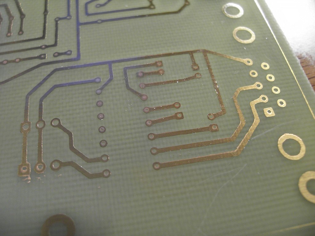

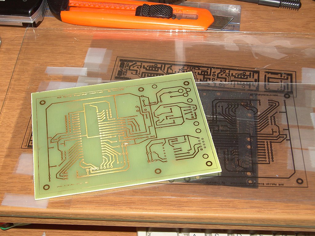

    Update:
    Just finished making the homemade PCB!!!
    Next is soldering the parts to start programming it...

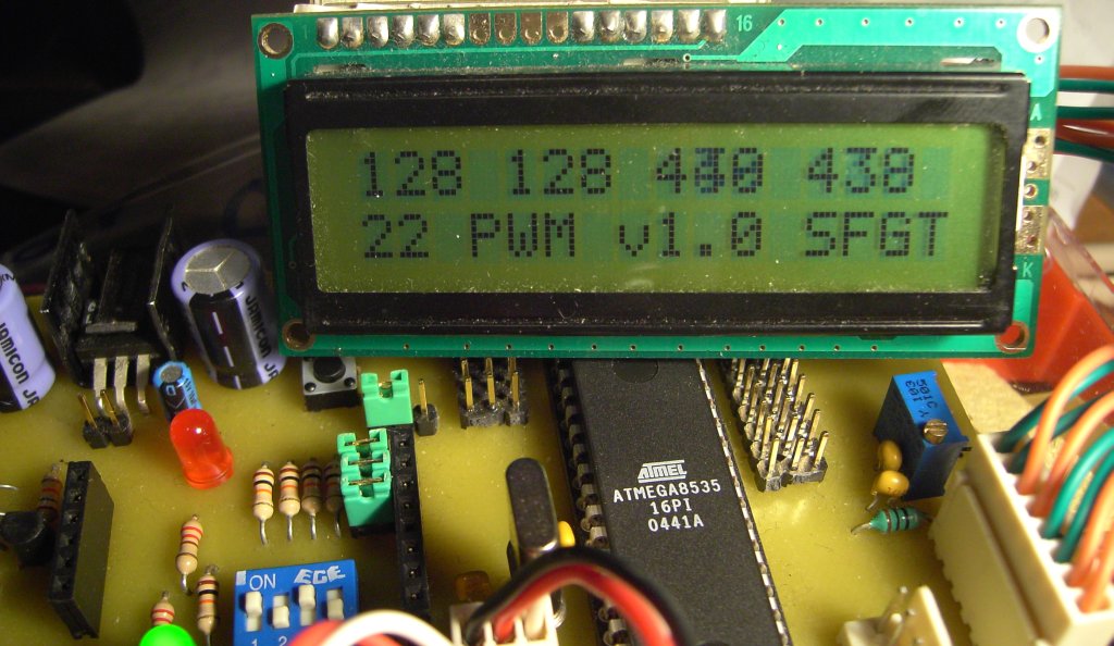

    The LCD will be there for debugging reasons (for start) and will be fully supported only after I finished with the servo motor driving features...
    the same apllies for the IR receiver...

    Hi Rene,
    This motor controller is awesome... in fact it uses the same chip (VNH2SP30) as the HB-25 are using! And costs the half money with two VNH2SP30 chips on the same board! I have bought the two HB-25 for 150euro last year. I want one of these RN-VN2 DualMotor!!
    Can you check if they can sent to Greece cause I can't translate all their pages... If they not, I would be very obligee if you ordered it for me (I could sent you the money for the board and the shipment costs to your Bank account or something...).
    Regards, Thanos

    @Thanos
    Would it be possible to provide a PWM frequency above 16kHz?
    Afaik, motors drive more quiet, when driven in these high frequencies, because humans cannot hear above 16kHz.
    The RNV2-Dual driver supports up to 20kHz PWM.
    And a high Encoder resolution would be important as well. Would 16bit be possible?

    @ Ego
    I must research more to see about the PWM speeds supported on the Atmega8535. I have seen otherAVR that support high-speed PWM like the ATtiny26 but it has limited ports and no hardware Uart support.
    I don't either want to hear the high pitch sounds from the motors too but when low PWM pulses sended I think it will produce some noise. My HB-25 does produce noice during low PWM signals...
    As for the encoders resolution I was thinking something like 10bit resolution (0 to 1024) unless more resolution needed.

    Which PWM frequency do you use currently?
    1024 steps is borderlined.
    In the datasheet of the Atmega8535, I found these specs:
    – Two 8-bit Timer/Counters with Separate Prescalers and Compare Modes
    – One 16-bit Timer/Counter with Separate Prescaler, Compare Mode, and Capture
    How to get 4 Encoder inputs with 10bit resolution?
    Perhaps an external decoder IC could be a solution?
    10bit is not enough for sure :(

    Thanos,
    I would like to use this motor controller board with your upcoming design. I will get 2 of these to control 3 axis.
    KT-5198 Dual Bidirectional DC Motor Speed Controller.
    Could you let me know if it will be compatible with your design.
    Factors why is because supply is close to me, just being in Australia, and it is affordable.
    http://www.oceancontrols.com.au/motor_c ... ollers.htm
    PWM freq of this controller up to 10khz. Is it possible that your new design is not limited to too high a freq else problems with motor type compatibility may arise. Perhaps some frequency dividers in the firmware set to dip switches so that different users can select PWM freq suitable for them?
    Just some thoughts before I go out and buy more toys!

    BTW. On PWM freq,
    I tested 4khz PWM last night on 12V/3A and ripple was a bit 'gravelly'. Hopefully tonight I will find time to test on 24V and 'feel/hear' what happens. But first I must wire up the 4xSLA cells (4x12V/9A) and floating 24V charger. Remember this is with Tripod platform design and not Cradle motion.

    like the idea, i imagine a dynamic PWM frequency, setable via poti and the frequency can be seen at a little matrix lcd.
    That should be suitable for every possible combination of motor and motordriver ;-)
    I understand that you prefer to buy near of you. The voltage and Current of the driver are higher than from our RNV2-Dual, too and price is nearly the same, without shippingcosts.
    I think Thanos is on the right way to make a universal X-Sim interface.
