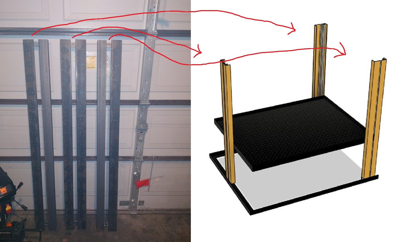

    Wow, I haven't posted here in longer than I thought!
    My brain has still be going crazy with various different ideas I've had for possible G-seat innovations. I've got something I'm going to be experimenting with. =) So the G-seat design is still up in the air after all.

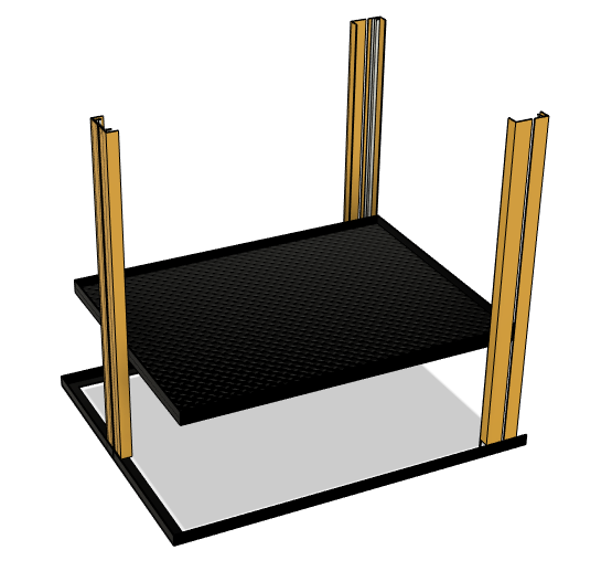

    In the meantime, construction of the elevator is underway!
    I decided that it was just a bad idea to try to operate the elevator with only two actuators in an effort to free up one additional actuator for the G-seat. I'm going back to the original plan of using three ballscrews for the heave motion. If I feel I need more independent axes for the G-seat after some testing I can deal with it then.
    Since I'm going back to three actuators I decided I could really clean up the looks of the elevator. I'll attach a drawing, though it's incomplete and I broke part of it. =P
    Design Progress:
    I've got the design and dimensions for the elevator finalized. (image attached)

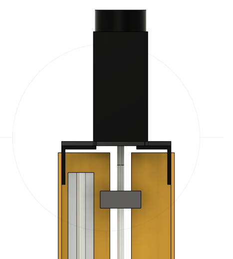

    Today I took several hours of time working everything out to tackle the motor mount problem, and found that there was no problem! It was such a simple design it makes me nervous that I missed something! A couple pieces of angle, and a laser cut 1/4" acrylic motor mount that bolts to the angles. (image attached)
    Physical Build Progress:
    The moving platform frame is cut and some of the holes are drilled for the SBR12 bearings. I'm holding off welding it until I can use the finished front actuator to make absolutely sure that I'm making the holes for the linear guide blocks the correct distance apart.
    Yesterday I pilot drilled and final drilled the 120(!) mounting holes in the towers for the SBR12 guide rails. They are all done.
    Next comes welding the tower halves together. I probably won't get to work on that until Wednesday but things should progress quickly from there. Once they are welded I can drill the mount holes for the ballscrews and then use the finished unit to check drilling dimensions on the lift platform frame. Drill those holes, weld the frame, and then set everything up and finalize dimensions for the lift tower support frame (now made of angle on the floor) Finally weld the lift towers to their frame and then it's time for finish work and paint.

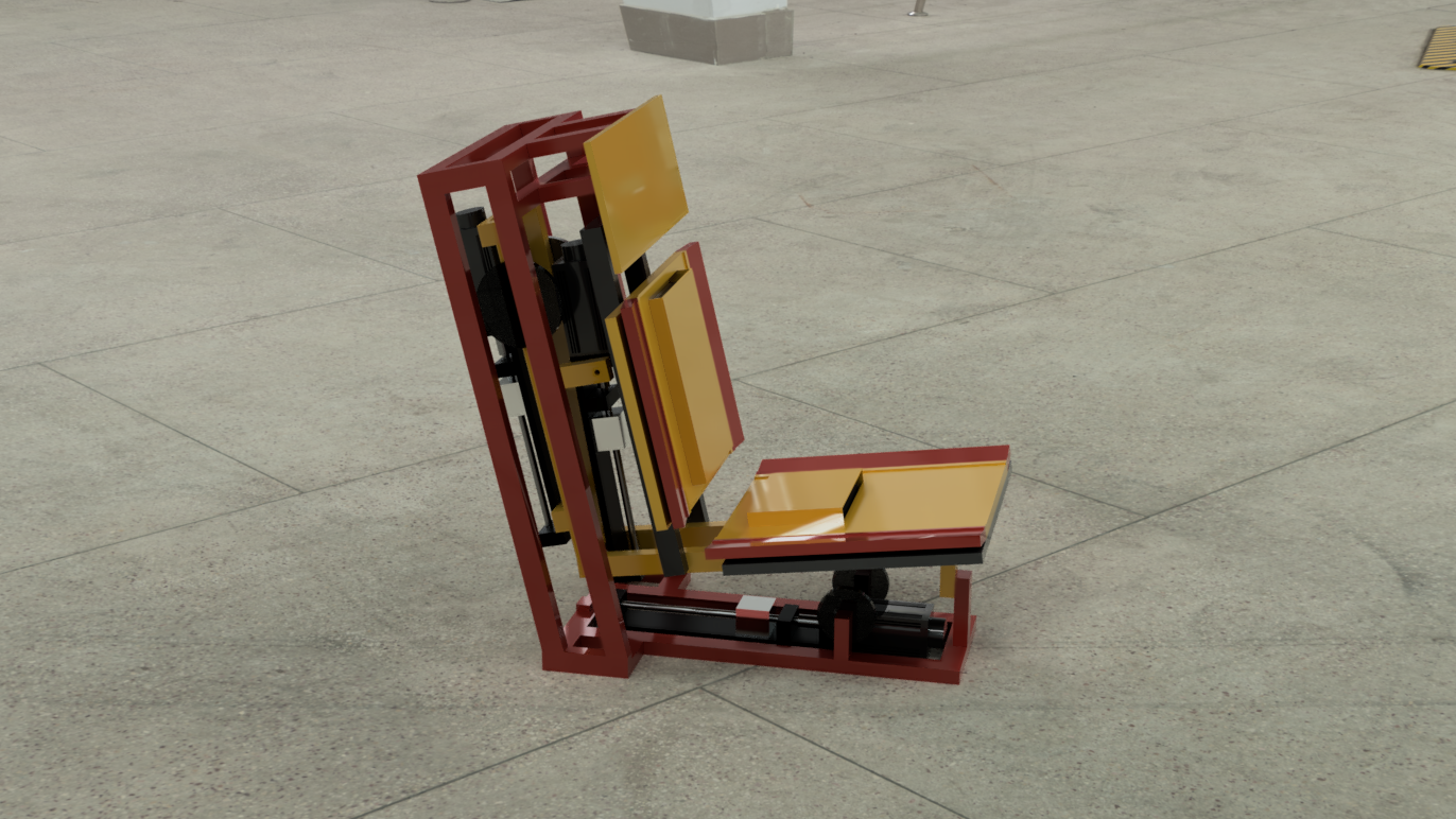

    Alright, so this is hopefully the final design (for v.1 anyway) for the G-seat. Dimensions are not yet final and there are bits missing. Not set up for animation, just a still shot.
    The yellow frame moves in the roll axis. The red frame is stationary. This frame is what I'll mount adjustable side bolsters (a la SeatTime) onto and also supports the upper seat back which doesn't move to hopefully provide friction on my upper back to make the lateral G cues more convincing. If that doesn't really work out I can just extend the moving part of the seat back all the way up. I'll make that frame bolt on, so it can easily be removed.
    I'm not sure yet how I want to mount adjustable/removable side bolsters for the seat bottom. I also might just make those wings on the bottom get pushed all the way vertical when the seat rolls, but that still requires adding a non-moving frame extension of some sort. No big deal, but I'd like it to look decent.
    The fancy paint job is just to make it easier to see the various components.
