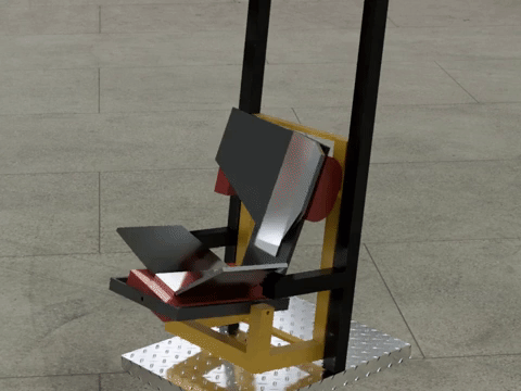

    Well, I think I've finally got the design nailed down. A bit less elaborate than I had planned.
    The actuators will be mounted vertically behind the seat, attached to the inner frame that goes up and down.
    I've got a pretty good idea of the linkages I'm going to use but won't know for sure that I've got it sorted until I draw it all. This drawing doesn't show the actuators, actuator linkage, belt tensioner, G-vest, or cosmetic/safety housings. The friction points for the paddles will almost certainly get rollers or some other solution. The different colored parts are there just to make it easier to see what's moving.
    The shape is a near copy of the ACME DMS G-seats, but there are quite a few major differences. Functionally it's more akin to Bergison's rig.
    I will probably take another look at actuating the paddles with actual linkages. I'd rather do it that way but it will add quite a lot of mechanical bits and I expect things will get crowded pretty fast. I think that will allow me a lot more control over the sway paddle movement vs. heave/surge paddle movement, and hopefully make it possible to actuate the paddles from nearer their load center of gravity.
    (I drew and animated this image with Fusion 360)

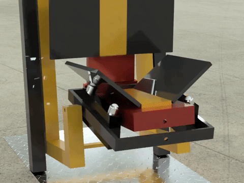

    New version. Added the ball transfer rollers that SeatTime posted about and made some changes all around.
    I've only got the bottom done so far, but the back will get a similar treatment. I think I've got it figured out in my head but a lot of times when I think that and draw it in 3D I find my idea is flawed.
    The roller assemblies are just floating in midair right now, I just have to run mounts straight up from the floor to them.

    Jun 30, 2015
    552
    4,215Coins
    +597 / 2 / -0
    Hi Trip,
    your 3D animations are a great way of illustrating what you have in mind.
    In your most recent animation, the backrest is not participating in the roll movement anymore, as it still was in the previous version. Is there a reason for that?
    And I notice that your heave travel is quite large. In a previous post you intended to have it 600-900 mm long. Is this still your plan?
    I am asking because both the Bergison as well as the ACME seats are seat movers, which means that your feet remain on the ground.
    This will probably increase the feeling of your body being lifted upwards or being pressed into the seat.
    However, if the heave travel distance is too large and causing your legs dangling above the ground, this may feel unnatural. What do you think?

    Hi Markus, RacingMat, and CFischer, thanks for your kind words and input. =) The tools I've gained this year (3D printer, K40 laser, and Fusion 360 which is free) have changed everything for me. I feel like I can build almost anything! Being able to create these designs and see how the parts interact is fantastic.
    Markus, it's not very obvious because the only part of the seat back you see is the bottom where it is very near the fulcrum but if you look very closely at the newest animation you will see that the seat back is actually moving in the roll axis, but at only 50% of the seat bottom roll rate. I can adjust this ratio, but the hope is that this will still move my body effectively and also provide that feeling of friction against the seat back as you move in the seat from the G-force. The G-vest will be used to also assist a little in pulling me over. Developing this seat has included some time spent yanking the steering wheel back and forth at around 20mph in the car to mentally analyze what I feel and that has lead to some of the ideas you are seeing me try out here. =D
    The 600-900mm travel is referring to the heave travel of the "elevator" a.k.a. "lift" platform that the whole cockpit and the G-seat will be put atop complete with all vehicle controls. That platform will be only heave, no other motion is planned. The elevator should have about 900mm of travel, but how much of that I can use is limited by ceiling height! When I move the simulator to it's future location I'm hoping to be able to use 100% of that, but where it will be upon initialconstruction I think it will be 600mm at most.
    I have been giving a lot of thought to the extents of the travel of the G-seat as well. My current thought is to build it with a little bit more travel than I think I could really use and then be able to adjust it down both with changes to bellcrank ratios etc. and software control of the actuators. Decreasing it should be far less work than increasing it.
    RacingMat, I think the fact that the animation is showing pitch and heave movement at the same time as the roll movement is greatly exaggerating the appearance of vertical movement on the roll/sway axis. The theory is that my body will only move in realistic distances and directions. This is based on SeatTime's work. For example in an upward heave movement the center panel goes down while the sides go up, with the intended result being the eyepoint moves down a bit but you feel increased pressure. Since I doubt I'll be able to achieve that perfectly, I should be able to mix a bit of heave movement into the maths to compensate. I think roll/sway is the place I'm most likely to need this. I expect to find that my eyepoint is dropping noticeably, so I will try to add a little positive G-seat heave to the roll cues just enough to put my eyepoint where I want it.
    More animations will be coming, hopefully 100% complete before too many more days. I'll also add animations showing individual DOF's. The focus up until this point has been coming up with a design where the various DOF's can all work at the same time. That's what the animations have been showing so far so the movement can be misleading.

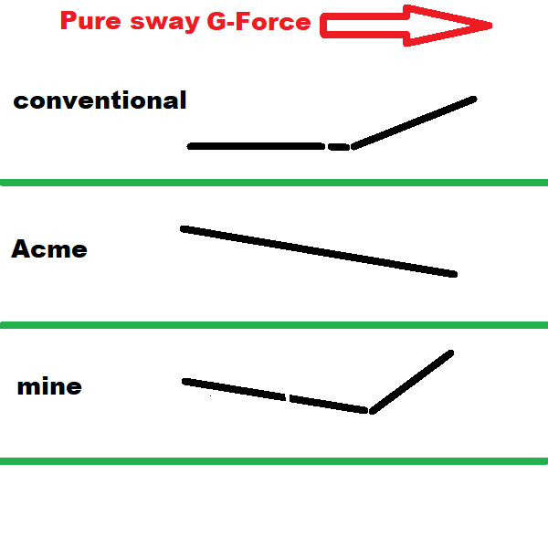

    I'm also getting to where I'm much more satisfied with the design being somewhat original now that I've started to get things sorted.
    I think is the most significant innovation (which may or may not work out!) is the roll/sway cue. The design is based on my findings using my car for testing, combined with the ACME roll/sway cue system and traditional G-paddle setups. Here is the difference:
    Other than that the only thing I think may be fairly original is the concept of rolling both the seat bottom, G-vest, harness, and seat back together all in the same direction but having the seat back and harness move slower (initial experiment will likely be 50%) than the bottom and vest. I'm doing this for two reasons. First for large roll DOF movements to have that sway cue feeling of sliding across the seat surface because the G-force is moving you but not the seat, and second to try to make fairly small and slow cues on this DOF feel more like roll cues than sway for helicopter pick-up and touchdown. Will it work? Opinions will likely vary because different people are more sensitive to different cues regardless of whether those cues are true or false. If I find it effective myself that's good enough. If not, I'll change it.
