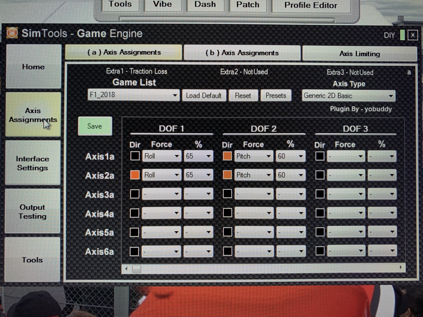

    Unfortunately today I tried to split the Roll axis (65) values between Roll and Sway (32 each) to produce more lateral motions.
    Not only did that not produce more motion, but now all the pitch is gone completely. I reverted back to the original settings (2 axes/ roll 65 / pitch 60). Still nothing. I tried selecting the orange/black boxes to reverse the pitch to see if that was the problem.
    Did not change anything.
    I did try to close the game engine and manager and restart them and also unpatch and repatch the game.

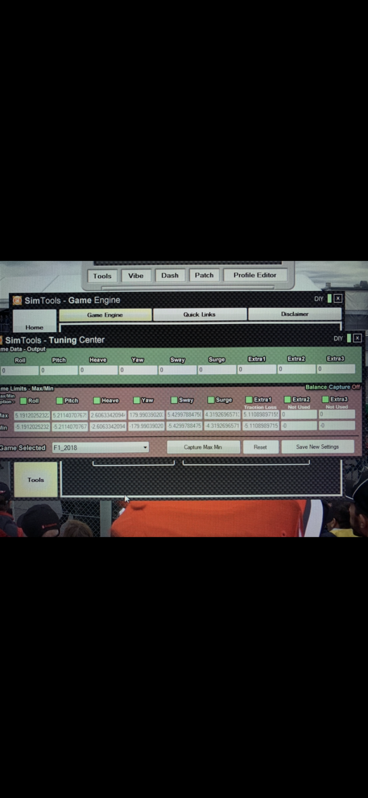

    I don’t know what else to do. I’ll include some pics.

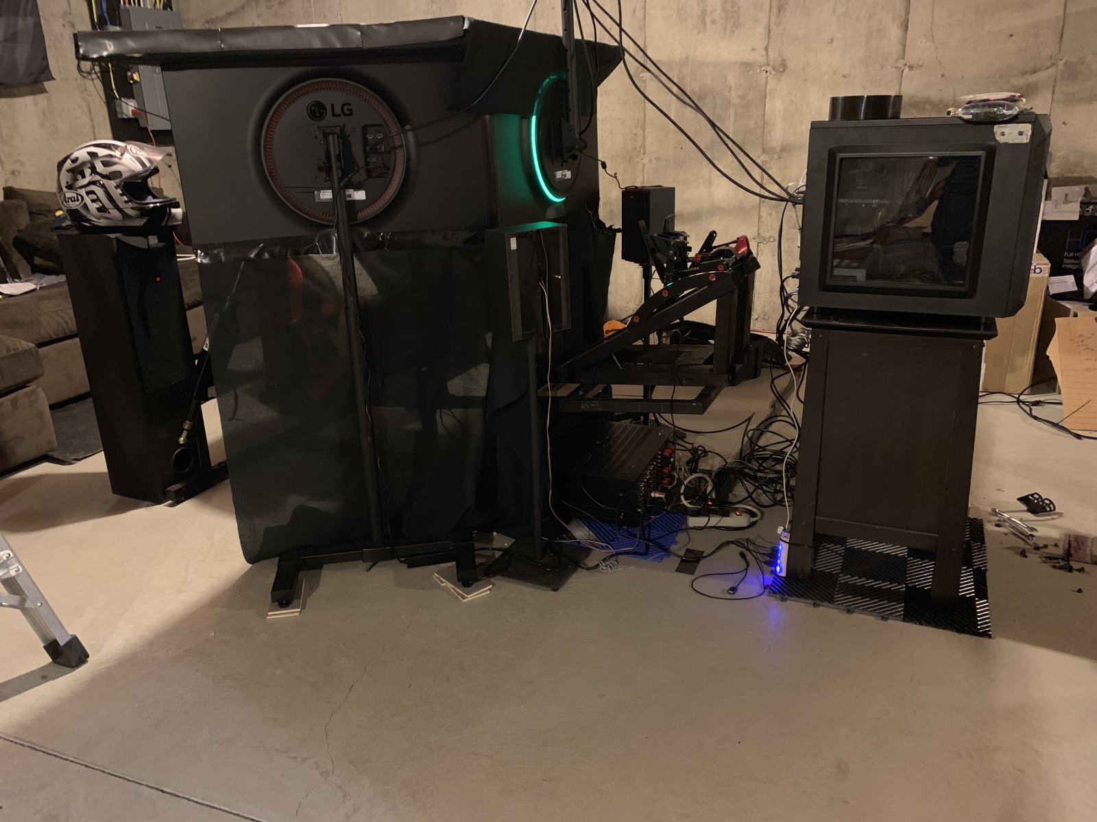

    Can we see a pic of your sim buddy?
  3. jaymac7
    jaymac7 New Member Gold Contributor
    Dec 17, 2018
    21
    303Coins
    2DOF, SCN5
    Not sure if this pic helps. Here are the details I posted in my earlier F1 2016/18 thread::

    The Axis Allocation is also related to other settings such as the Tuning Center values, you can't just play with one.
    Try following these steps to refine your motion profile, doing one axis at a time, surge, then do sway next, heave, then roll and pitch. Once you are happy with the individual axis turn them all on and tweak as needed: https://www.xsimulator.net/community/faq/steps-to-create-a-motion-profile.228/

    Please load the Axis Assignment Preset for a "SimForceGT".
    Click save and give it a run.

    THANK YOU THANK YOU THANK YOU for once again coming to the rescue.
    Worked perfectly!
