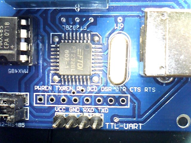

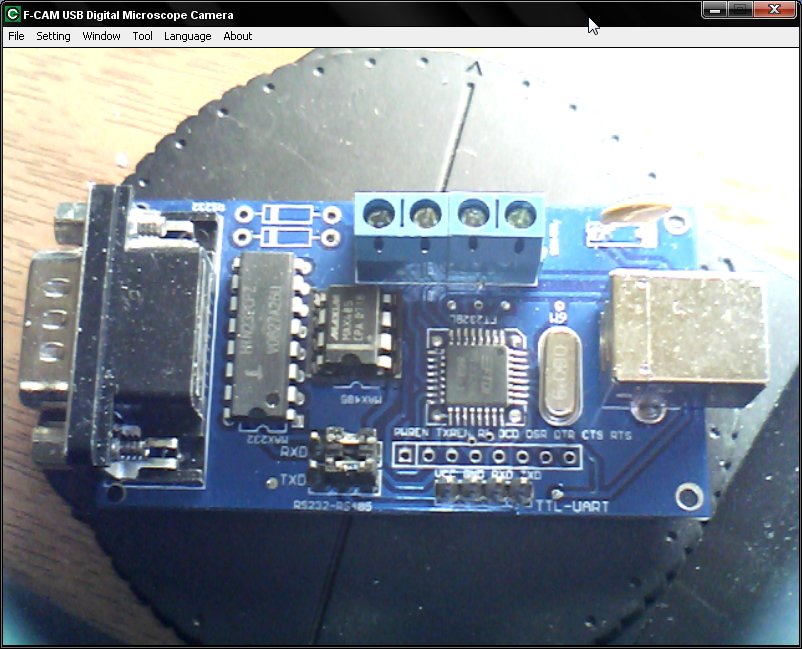

  10. tronicgr
    tronicgr
    Hi Tommy,
    I have compiled my new firmware 1.1 (not yet released until now) with large KP values from 25 to 30 just for you.
    tommy modified large kp.zip
    Use the speed that suits better you simulator.
    If you have problems with the Max232 section of the AMC1.5 , you can bypass it and connect directly the RX - TX - GND lines on a USB to TTL Serial adapter module like the following that is very cheap and tested by me!!
    http://cgi.ebay.co.uk/USB-A-to-Seri...14&_trkparms=72:1683|66:2|65:12|39:1|240:1318
    Best regards, Thanos :cheers:

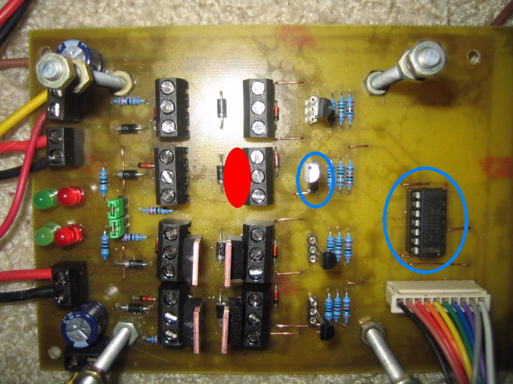

  13. Tommy
    Tommy New Member
    Feb 24, 2009
    48
    Finland, Vasa
    243Coins
    I tested with higher kp-value today and it seems to work much better. :thbup:
    I also compared the two motors and noticed that one of them took more amperes before moving, so I visited the junkyard and bought a new one. :) I also completely isolated the motors from the frame.
    Evereything seems to work fine now when i only connect one of the motors, but the problem is that if I connect both motors at the same time, the same mosfet as I marked earlier gets hot in a second and the amperemeter shows ~3A also when the motor is not moving.
    I guess it's a component that is broken but which can it be? Or can it be something else that is wrong?
    I hope thanos who have consturcted the board knows better. :cheers:
    Regards, Tommy
  14. tronicgr
    tronicgr
    Hi Tommy,
    You have to remove some parts from it and measure the resistors and the diodes on the Bad side h-bridge with a multimeter. Compare the diode values with the values you get on diodes on the good side of the h-bridge.
    Measure resistors with Ohm, and Diodes with proper diode tester that should exist on your multimeter (diode tester makes beeping sounds in most multimeters). For example when I measure the Zener diodes on my h-bridge I get .653, and Schottky diodes reads .168.
    The parts that you should remove are marked in blues circle in the next photo. Also disconnect all mosfets on that side, as well the motor and power connections!
    If your measurements shows no differences then you may need to change that BC546 circled in blue or even the 74HC08 chip in case it provides bad signals!
    Regards, Thanos
