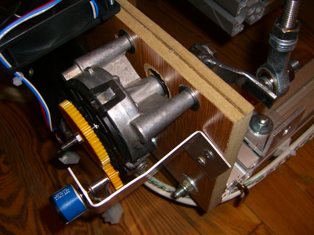

    Hi Tommy,
    have you already thought about, where to install the Potis?.

    Hi Michael!
    I think I could attach it to the back of the wipermotor by drilling a hole in the axle that the arm is attached to. But then I need some kind of gearing and I dont know where to find that. I have to search trough my RC stuff to se if I could find something there. Any other suggestions?
    Does anybody know what the gear ratio inside the wipermotor usually is?

    Hi Tommy
    the gearing are from Conrad

    Hi Christian!
    That's exactly were I was going to put my potis :highfive:
    What gear ratio do you use? I found some gears that should give a ratio of ~10:1 on a crashed RC helicopter I have got. Do you think that could work? The potis are 10-turn potis which means that only half of the potis's range will be used.
  11. christian
    christian Member
    Apr 5, 2008
    120
    Germany/München
    977Coins
    2DOF, SCN5, SimforceGT
    the big gear wheel 50
    the small gear wheel 20
  12. egoexpress
    egoexpress Active Member
    Dec 13, 2006
    3,839
    Germany - Frankfurt/M
    421Coins
    +10 / 1 / -0
    With 50:20 you would have not enough resolution IMO, as a half crank turn would just turn the pot 1,25 times.
    To nearly use the full range of 10turn pots I'd recommend something like 1:18 (half crank turn turns the pot 9 times)
    Of course these ratio are just if the gears are connected to the crank axis.
    If connected dirctly to the motor axis, it should be something like ~3:1

  13. Tommy
    Tommy New Member
    Feb 24, 2009
    48
    Finland, Vasa
    243Coins
    1:18 is pretty extreme. Maybe it is better to try connect the potetentiometers directly to the motors then, or do you think it will work good enough with 1:10? I guess it depends on the potentiometers precision.
  14. egoexpress
    Dec 13, 2006
    3,839
    421Coins
    +10 / 1 / -0
    with 1:10 you would just use 5 pot turns.
    Using full range would give you ~1000 positions, using just 5 revs just the half.
    The higher the resolution, the better the motion quality.
    Mounting the pots directly to the motor shaft is possible as well, but more difficult imho.
    So it is up to you...
    Regards

    Hi Tommy
    now i have 50:10 gearing, its much better
    have fun
    regards
    Christian

    Hi
    Are you using a 10-turns potetiometers too? That means you are only using 1/4 of the potentiometer range and it works good?
