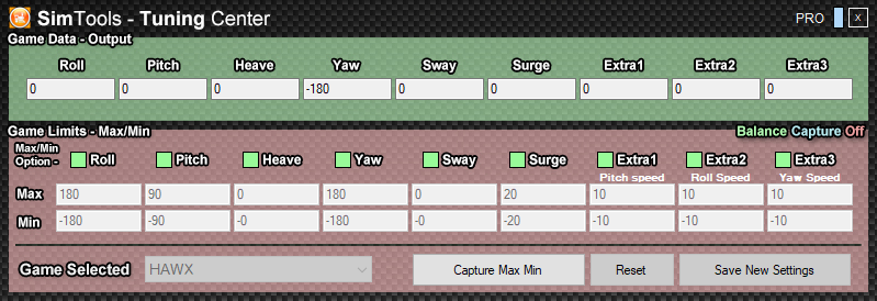

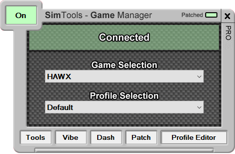

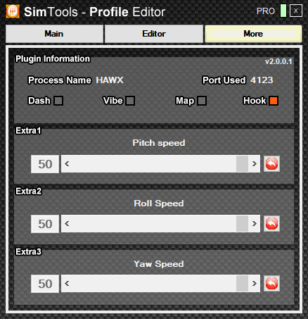

    My problem is not hardware for now the problem is when i run the game simTools recognize the game but i can not get telemetry data roll, pitch... on the Tuning Center, only Yaw goes to -180 and all others are 0.
    my game is Tom Clancy's H.A.W.X not the second edition.
    I am not sure where is the problem ,Is it from the plugin or me?

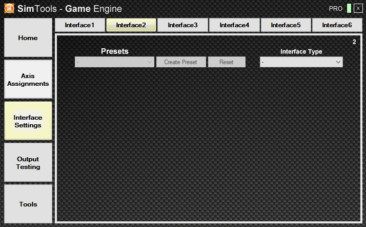

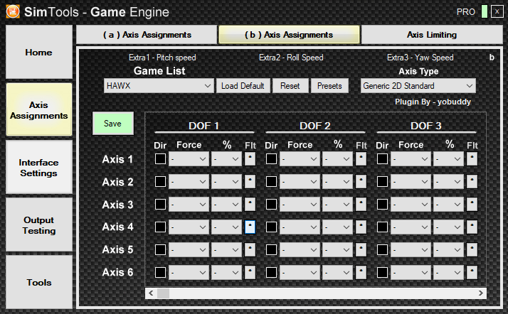

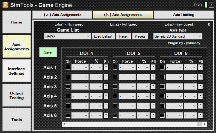

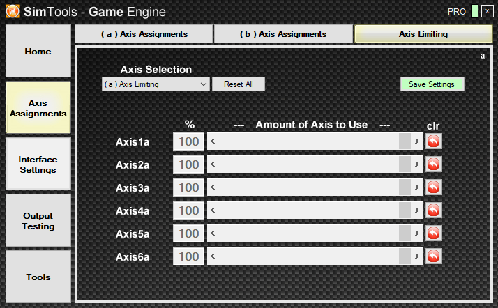

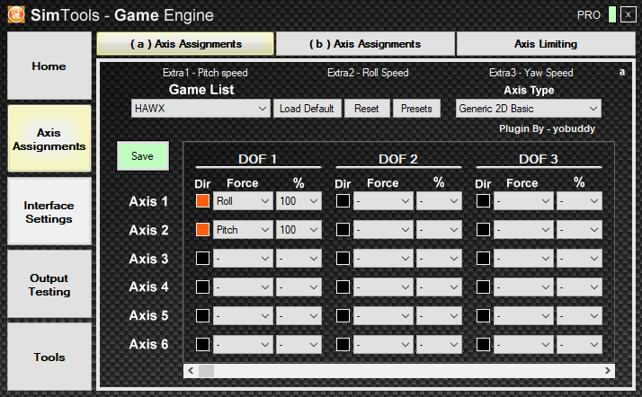

    OK this is all of my settings please check theme.
    I do not have any Hardware for now but in the next i will use a PLC which 2 AC motor connected to it.

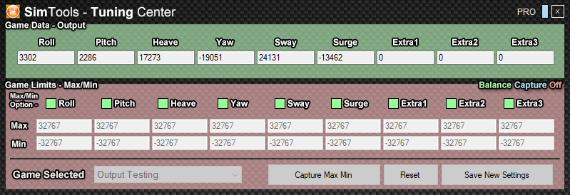

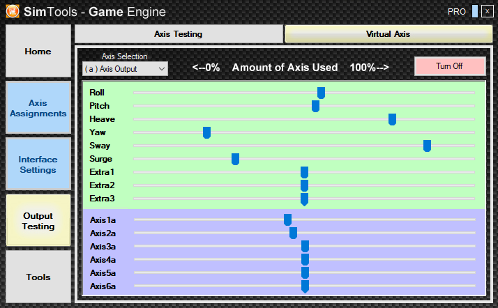

    My hardware interface is serial.
    GameManager Settings:
    GameEngine settings:
    Axis Assignments:
    Interface Settings:
    I test serial output on serial terminal, all thing work fine.
    Output Testing:
    works fin.
    And when i run game :
    nothing work and in serial terminal i see 127,127(for zero 8 bit data)
    Thank you for your time.

    do you test this plugin @noorbeast ? Or Is any body here who get telemetry data from this plugin?
    my problem is i can not get telemetry data and view theme on tuning center.

    Morteza,
    Did you found out what the problem is/was? I think I have the same issue. My setup works fine with Falcon BMS and NFS 2005. but when I start HAWX, I only get YAW at 0% in virtual axis, just like you.
    I use the original HAWX on Windows 10 (64bit). I does not ask for a path for patching.
