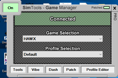

    Hello
    I had install SimTools in windows 10 64 bit and Tom Clancy's H.A.W.X. plugin but i cant capture any output data. i want to know this plugin is compatible with 64 bit windows and could you specify step by step how to use of this plugin like where to install game...
    thank you

    Can you explain a bit more of what you have done.
    First, does your simulator work in Output Testing with SimTools?
    Did you use the Plugin Installer app?
    What patch path did you use?

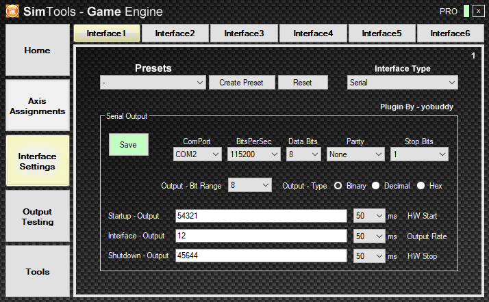

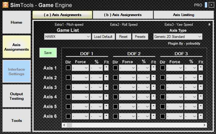

  18. morteza
    morteza New Member
    Jul 11, 2017
    9
    - 37Coins

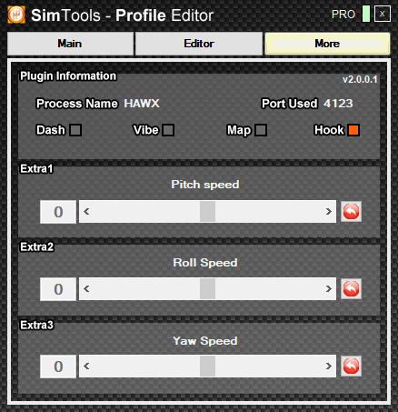

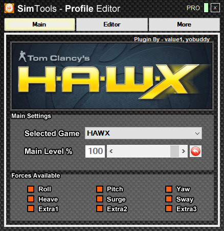

    Hello

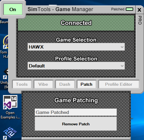

    Yes I installed plugin with Plugin Installer App but i did not patch it because it was patched at first and could not select any path for patch i think it knows game from it's process name.

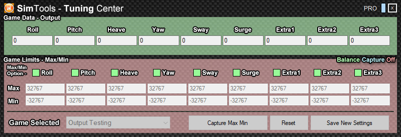

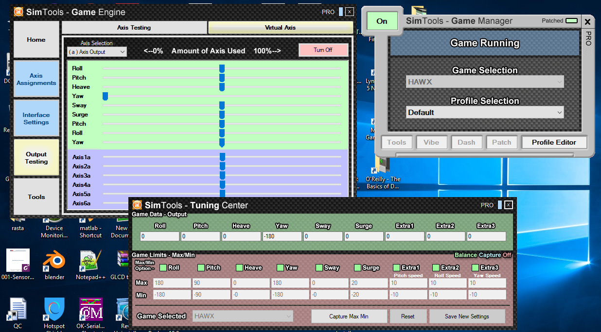

    but when i run game simtools recognize it but i cant any changes on Tuning center
    in the below picture when game is running i just -180 in yaw.
    thank you

  20. morteza
    morteza New Member
    Jul 11, 2017
    9
    - 37Coins
    Hello

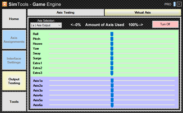

    this is Interface setting pictures and I checked output testing and it worked properly with tuning center.
    Thank you.
