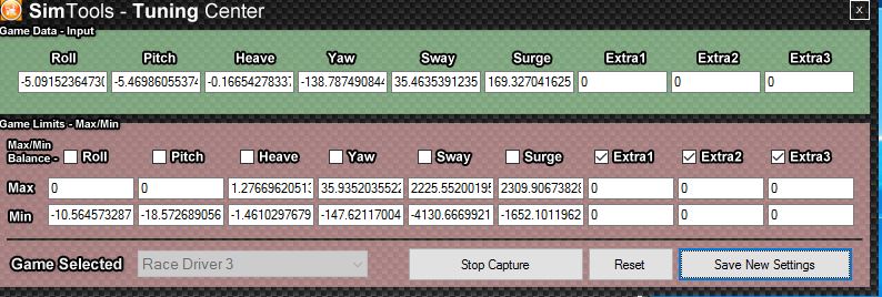

    @Boomslangnz - Hey mate, tried this tonight using a copy of V8 SuperCars 3 and I don't get any motion.
    Simtools connects and puts my Sim to centre, however I only get static values in the Tuning Engine.
    Even if I reset the variable (+/-) values to 0 and hit Capture, play the game, and come back to the tuning centre, everything is still Zero on the Axis values.
    Happy to help you troubleshoot the Plugin if you have time? I notice you have TOCA, so wondering if there might be some subtle difference?

    Hey @Boomslangnz - Managed to remote to my PC from work and installed the TOCA3 version of the RD3.exe and motion appears in Simtools.
    It looks like the rd3.exe for V8 Supercars is slightly different. The Cracked version of RD3.exe (RELOADED) does give out motion.
    I will upload the .exe files for you @Boomslangnz - and also share with the community for those that wan't to grab this decade old bundle of awesome :)
    Thanks for the plugin @Boomslangnz - I love the V8' supercars and they are missing from all the major racing titles :(

    Damn! I spoke too soon. I get motion but not on all sides. Nothing on opposite roll or pitch axis.
    See SS:
    Sway and Surge give crazy numbers... Not sure if that is what is expected. I stopped testing once Roll was broken.
    Anything I can do to help @Boomslangnz , let me know.
    Cheers....

    Never mind. Managed to sort it out. :thumbs
    The plugin seems to be "neutral" - dead on zero. What I mean by that is that some of the forces don't trigger on tracks that are very flat or have no slopes to trigger pitch.
    (as per post 13 above, where Roll and Pitch are 0.)
    Once I ran the Sim around bathurst and setup tuning, I was getting values.
    Most if not all of the plugins I've tried previous to this have some +/- value even when the car is stationary.
    However, you still do need a modified .exe if you are running V8 Supercars 3 and not TOCA Race Driver 3.
    The modified .exe is here (.rar file) Simply rename rd3.exe to rd3.old and away you go.
    Thank you @Boomslangnz - I loved this game back in the day, and motion just pops a cherry on it!
