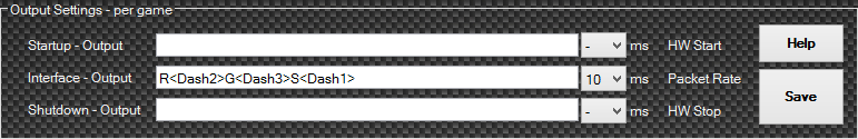

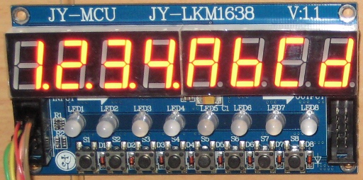

    Ok for a while now I have been playing with dashboards with simulators, about 1 1/2 years ago some one showed me the TM1638 from Dx.
    http://dx.com/p/jy-mcu-8x-red-light-digital-tube-8x-key-8x-double-color-led-module-104314
    This simple little led driver can be setup in GameDash and be set to show mutiply pages selectable by the buttons on the rear or by wiring them from a remote box to the back of the TM1638 board.
    This code uses Rpm , Speed and Gear for now but looking through the code it can be streached into a lot more.
    RpmGearSpeed_only___TM1638.zip

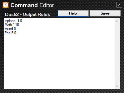

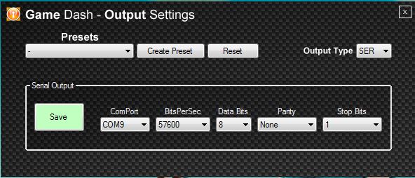

    Base code for this is as follows in this example of race07,
    This is fairly straight forwards to setup, once you have done one game, very easy to add more.
    Ok now I have taken this one step forwards and have included button control for the above code.
    Button one (far left) puts the Dash into Speed as it the 7segs display Gear and Speed.
    Button two puts the Dash into Rpm as in the 7 segs display Gear and Real Rpm Value.
    Button three Rev the car to the max rpm in the pits and press the button now the bottom 8 leds will max out when the max rpm is reached in game, this can be handy when changing from a slow diesel to a high speed F1.

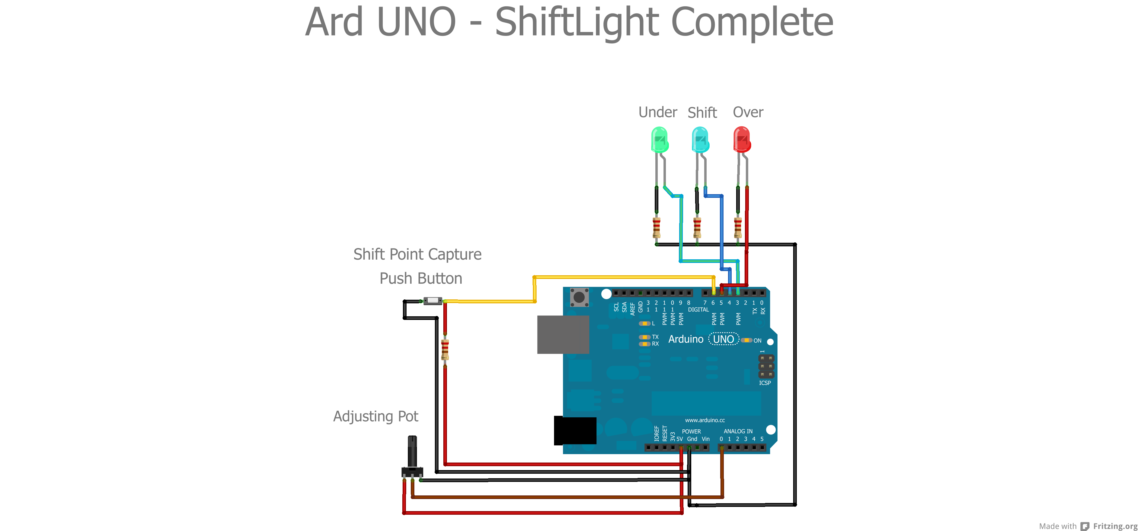

    Ok now I managed to mangle my Tm1638 code with the Shiftlight code in my previous tutorial and placed,
    RpmGearSpeed_ShiftLights___TM1638v3.zip
    Button four is used to select the desired Shift point that the Shift LED comes on.
    Note the buttton from this is removed.
    , more to come........

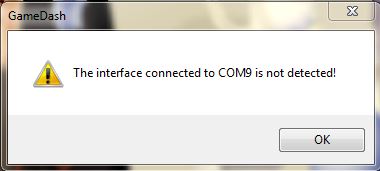

    3DOF, DC motor, SCN5, Arduino, JRK, SimforceGT
    I tried this solution with an arduino nano v3. Game dash settings always says" device on com port not found" .
    I tried to replace the ftdi driver of the nano which did not help.
    Will i need an ard uno or what am i doing wrong? Thanks for any hints

    Here some screenshots. Settings / code and Output rules are set like in the start post.

    Not sure what you have done wrong, works for several members as is.
    And one is using a nano.
    mmm will look into it, Why you not using the other software anymore, gives me a bell and we can sort SimTools out for you, motion is so much nicer.
    I would try to reinstall the Ard drivers again, the board should identify itself as a Nano, not a Usb serial port like ya picture above.
    Secondly make sure not Serial.print lines are not commented out, they are there for debugging in Ardunio Serial Monitor, which you should test before using SimTools.
