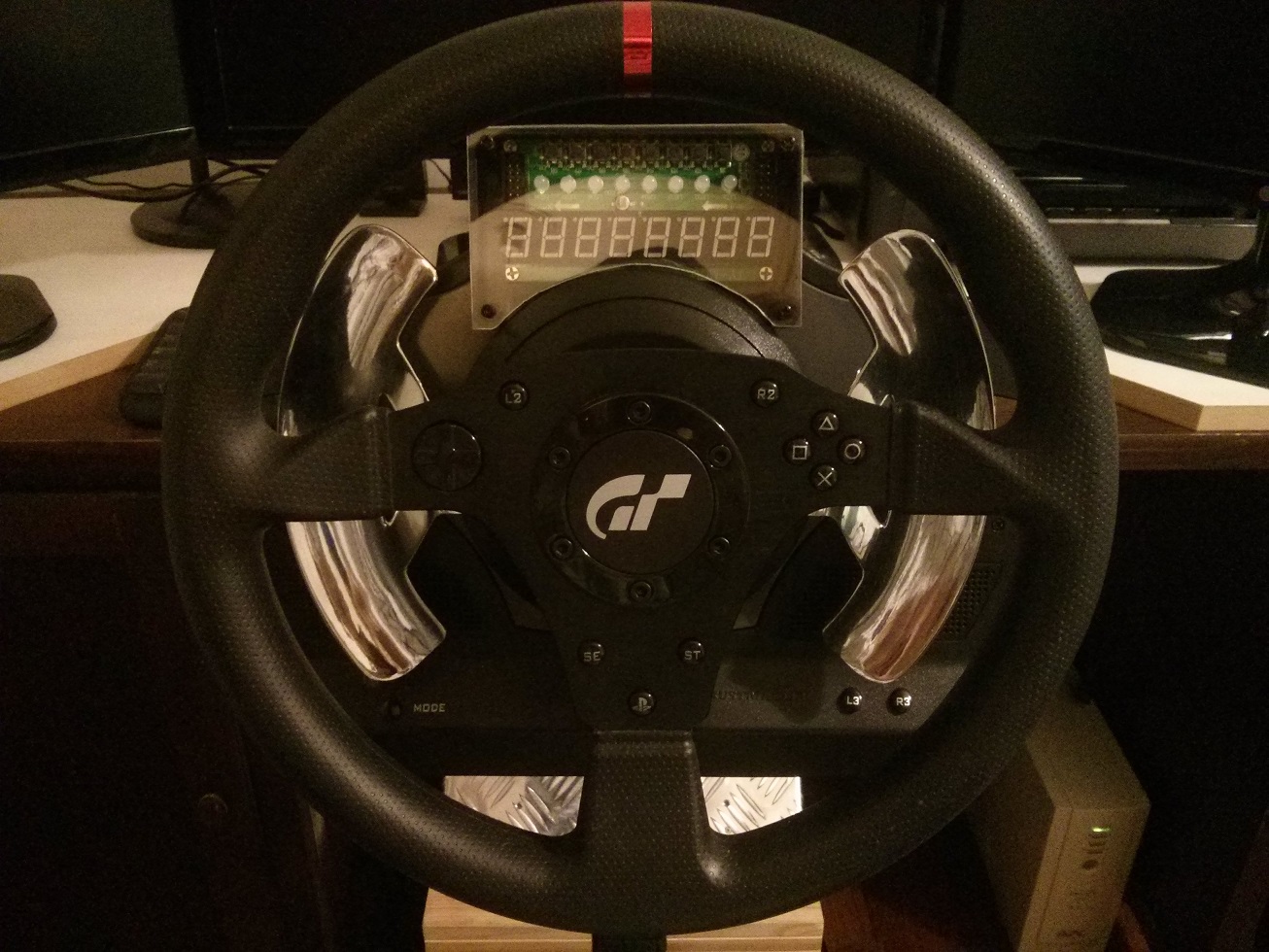

    Does anyone know if the TM 1638 LED display is common cathode or anode?
    I see I could "hack" a large segment display onto the back of the existing one. Id like a big gear indicator without extra coding.
    Does anyone know if the display is common cathode or anode ? I really cannot tell on my existing one...
    Dave.

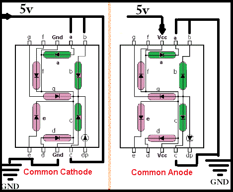

    Keep in mind that different (size or colour) elements have different voltage and current requirements (and maximum thresholds) to be able to work.
    So a larger (or different color) 7 segment digit might not work with the current provided from your board.
    I did not have succes trying to "steal" a signal and use it to power a blue comon cathode digit while i was able to succefully power a red comon cathode digit.
    Good luck.
    Here are some scems that might help.
  4. bsft
    Cheers, It looks like a nightmare to try to "hack" the back of the display to rewire a single large segment on at this stage. That and I am not really sure, but it looks like common cathode TM1638.
    I can put a 5v power supply on the ard if needed to give it extra juice.
    I do recall somewhere there was a large segment display setup with a TM 1638 and extra code as well. Buggered if I can find the thread. I will look again

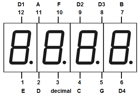

    Each segment (bar) inside the digit is named by a letter.
    Starting with "a" for the top "bar" and so on.
    So for number "2" for example you need to "light" segments:
    a, b, g, e, d.
    Depending on design there are two types of seven-segment digit types.
    Common anode and common cathode.
    The one uses common positive and the other common (for all segments) negative "wiring".
    The numbers on the four digit display represent the order of digits... with pin "D 1" being the cathode for the first digit (since its a common cathode display) and so on.

    questions:
    in case of a common cathode D1 goes to a 5v?
    what is dp ? how the added segment connects to D1 ? is it through dp on the added segment?

    hello I d like some more explanations
    a goes to A
    b goes to B
    c goes to C
    d to D
    e to E
    f to F
    g to G
    n case of combined cathode : do we have to perform a connection of the two ground pins (on large segmnt) to tm1638 ground ? (i suppose)
    where goes D1 (in case of D1 used ) ? does it go to dp on the large added segment?

    dp is the demical dot.
    d1 conects to gnd if your 4 digit and large digit are both common cathode).
    but the current will probably not be sufficient for the larger digit to work.
