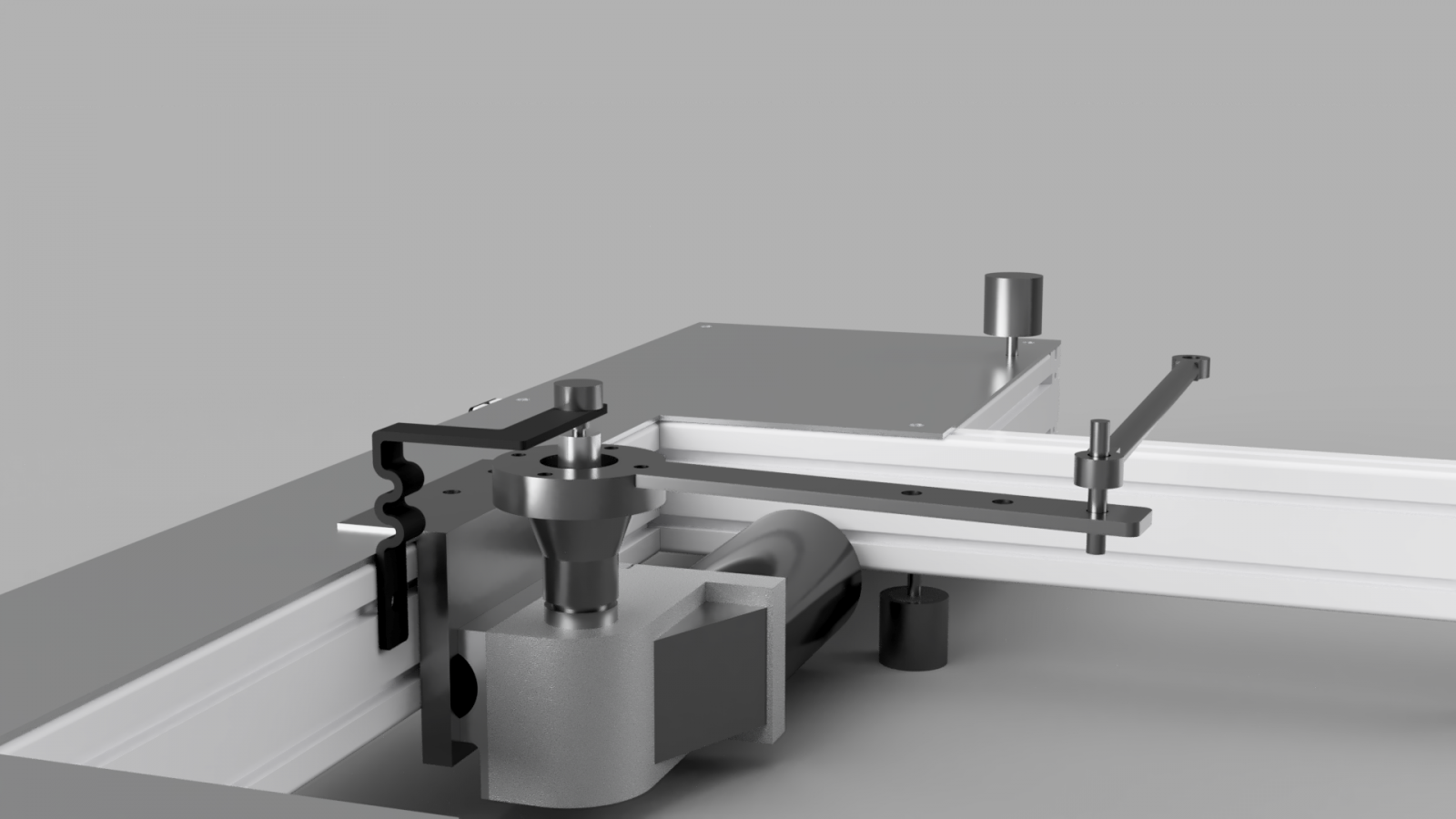

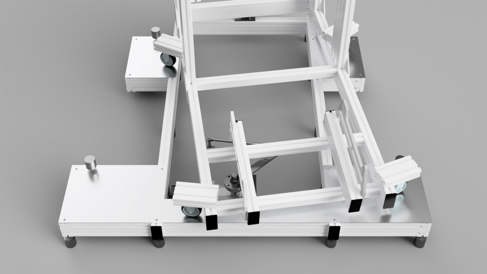

    I've been reading and planning for a while and thought it would be good to get some feedback before I set off with the saw / drill / soldering iron.

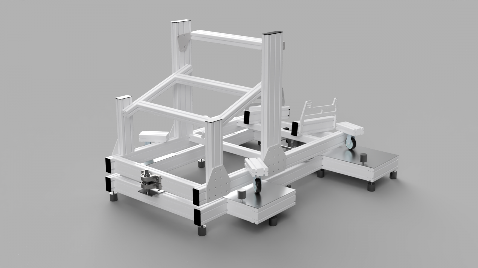

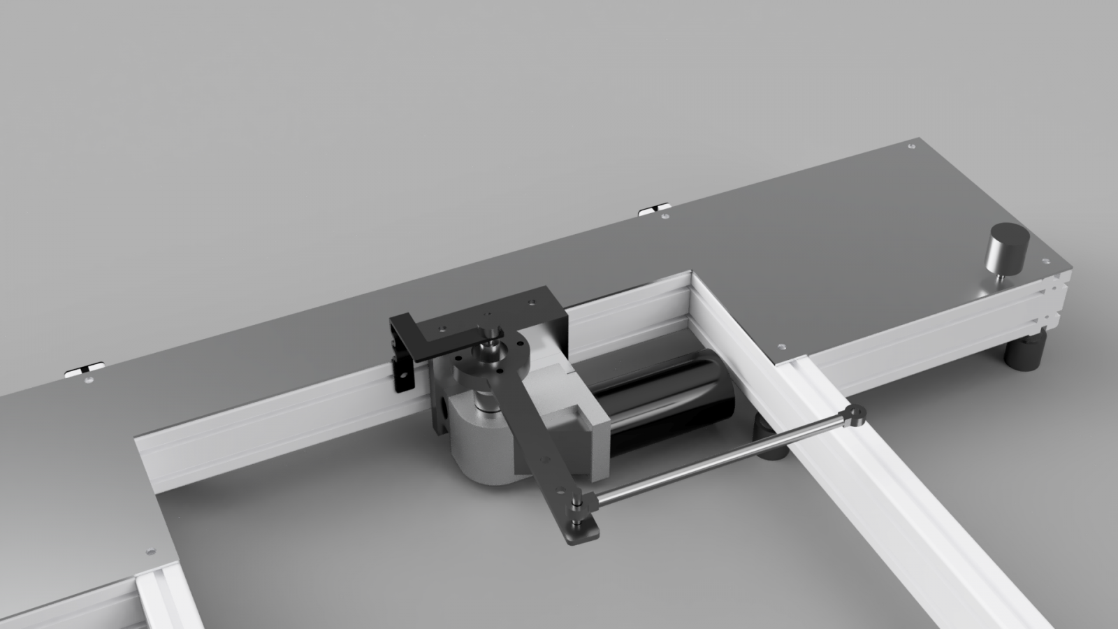

    I've attached some renders of my current design:
    Here are some of the details:

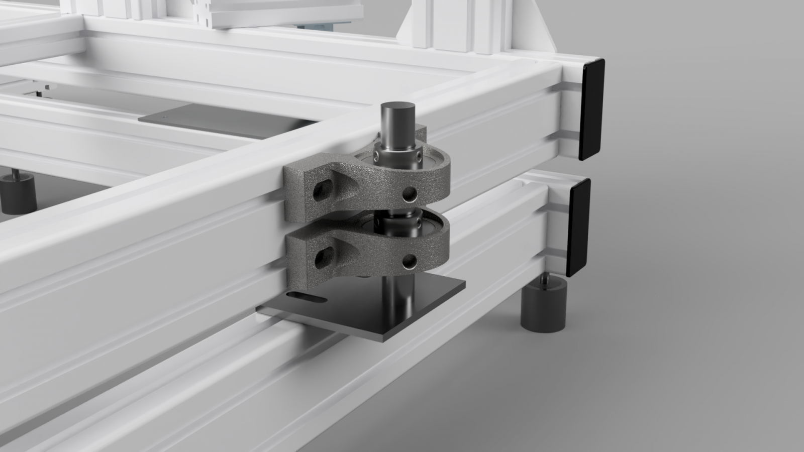

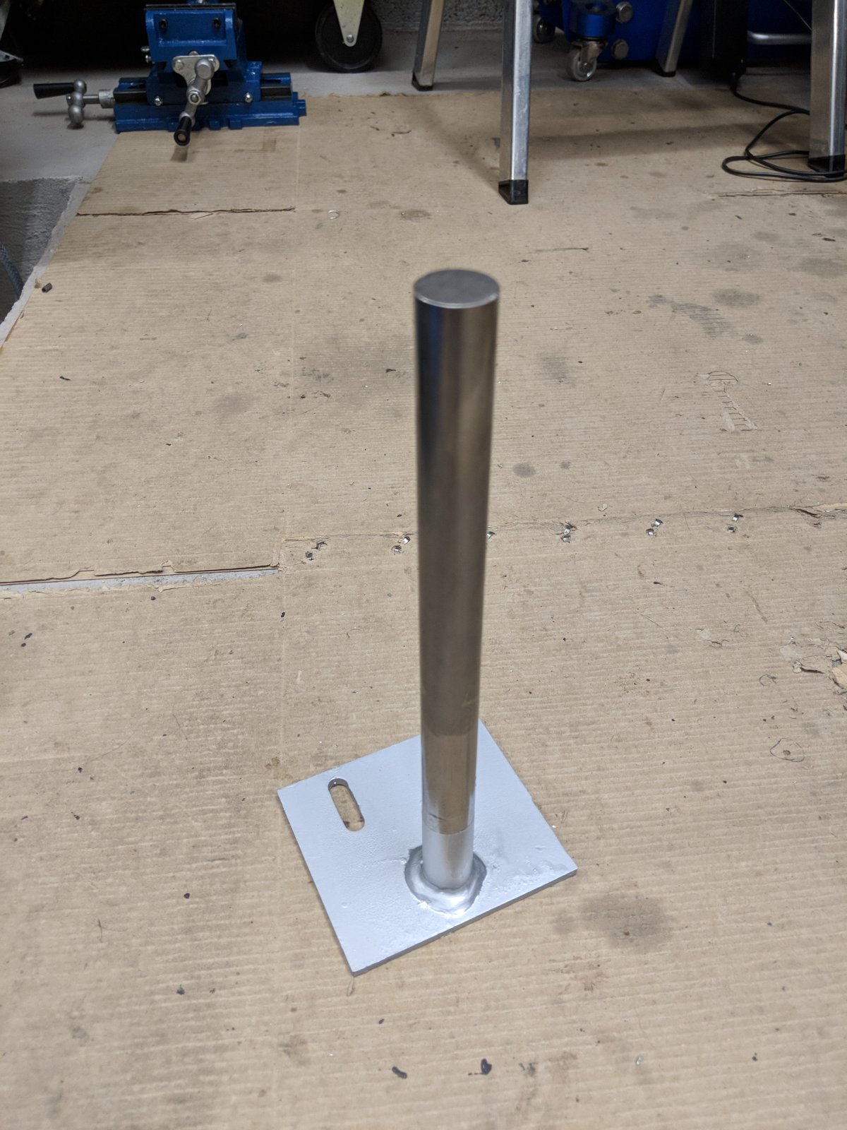

    Front pivot: pillow blocks on top frame, 20mm diameter steel rod welded to 5mm steel plate on bottom
    Casters: 75mm dia, fixed, ball bearing
    Base frame plates (for casters to run on): 5mm alu plate
    Motor mount, lever arm: 5mm mild steel
    Lever arm length: 300mm with CTC options at 160, 200 and 240mm
    Connecting rod: ~ 12mm dia steel, heim joints on high misalignment spacers at ends

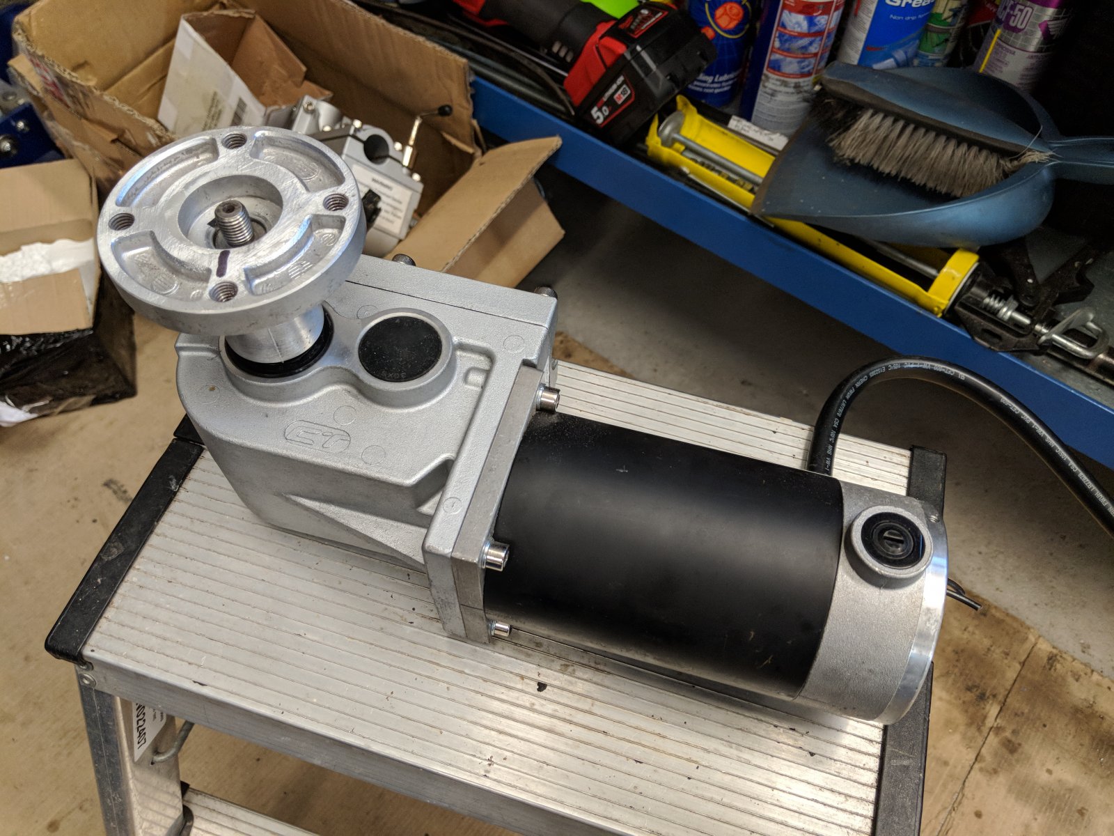

    Motor: 24v 300W wheelchair motor, 32:1 gearbox, ~ 150 rpm at shaft, keywayed hub adapter
    Pot: 120 degree hall, flex coupler to motor shaft, 3d printed support
    I drive in VR and plan on mounting the Rift camera to the top frame.

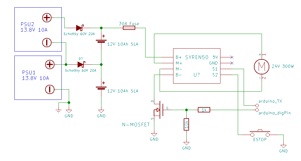

    I've also attached a schematic of the planned electronics:
    I intend to use a customised version of the SMC3 for Sabertooth (packet serial) sketch (thanks to authors!) on an arduino mega.
    I've taken inspiration and ideas from a number of threads so thank you all for that. Any comments / questions / dire warnings would be gratefully received... Thanks!

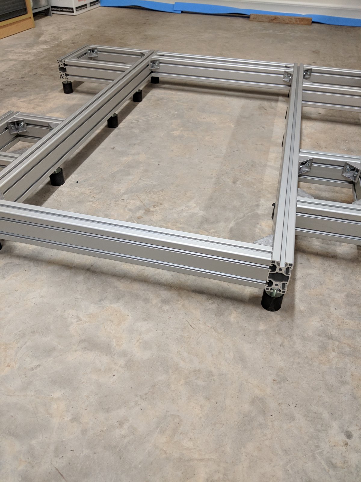

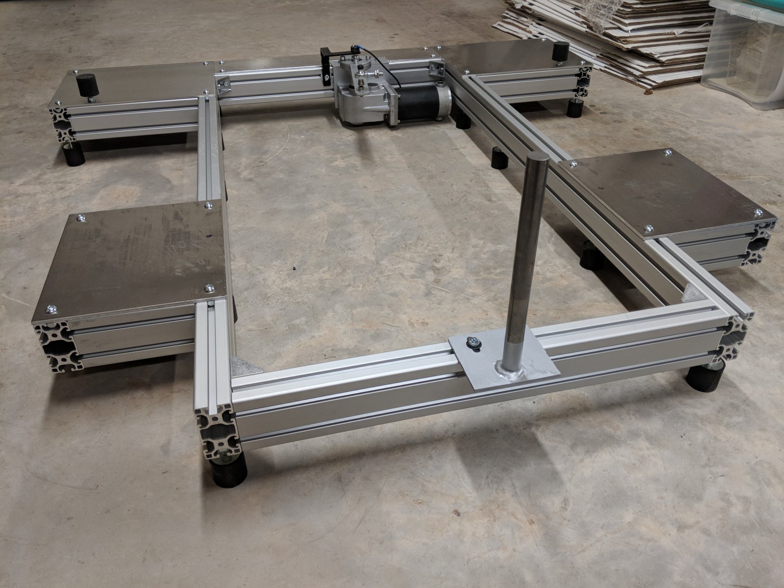

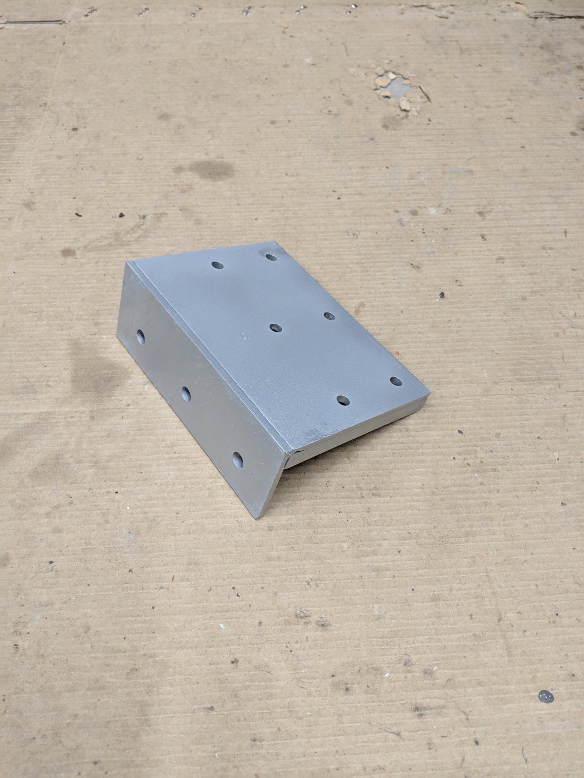

    The bottom frame is ready:
    and the alu panels are mostly cut and drilled.

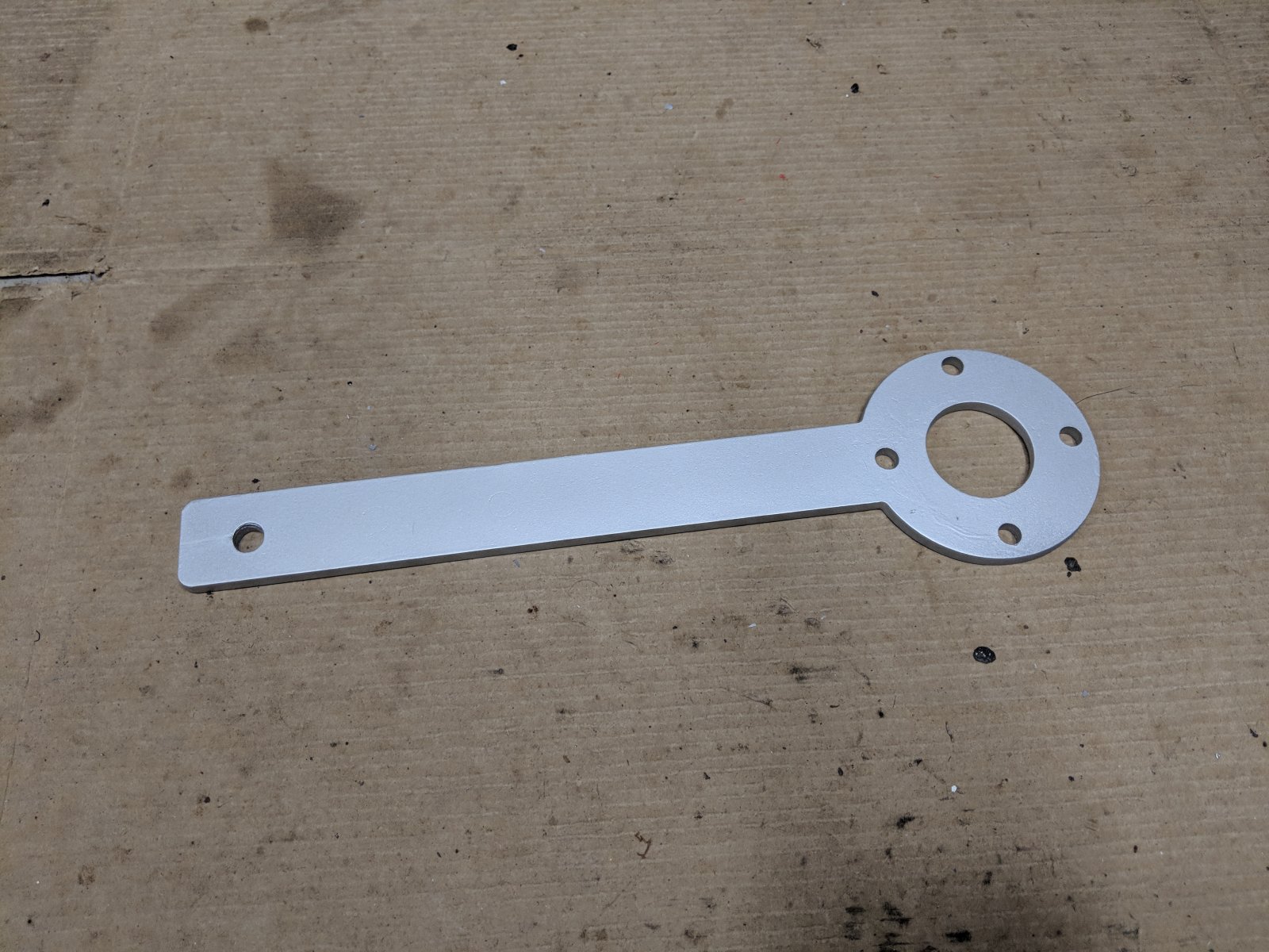

    The steel parts have been plasma cut, drilled, welded and painted (I'm not much good at any of the above!):

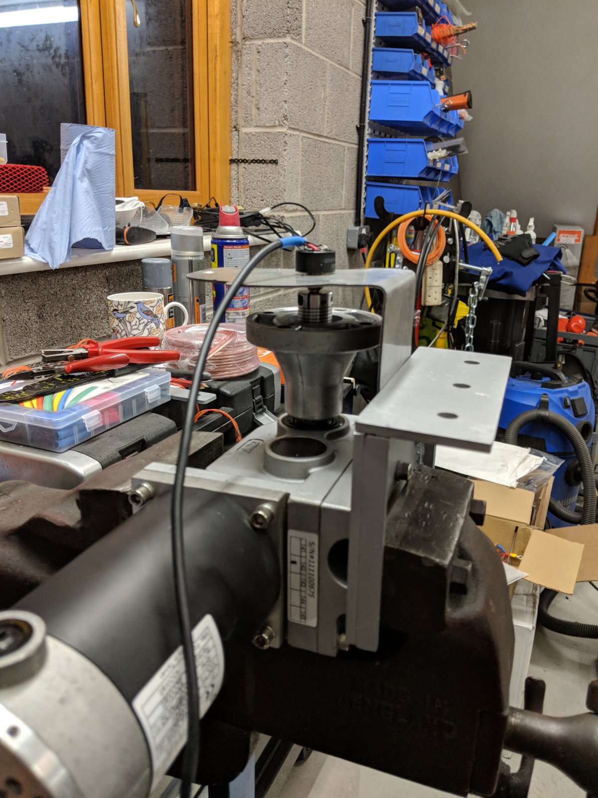

    I removed the brake and fitted the wheel hub to the motor:
    And then fitted the flex coupler and the hall pot with a temporary pot mount for testing:

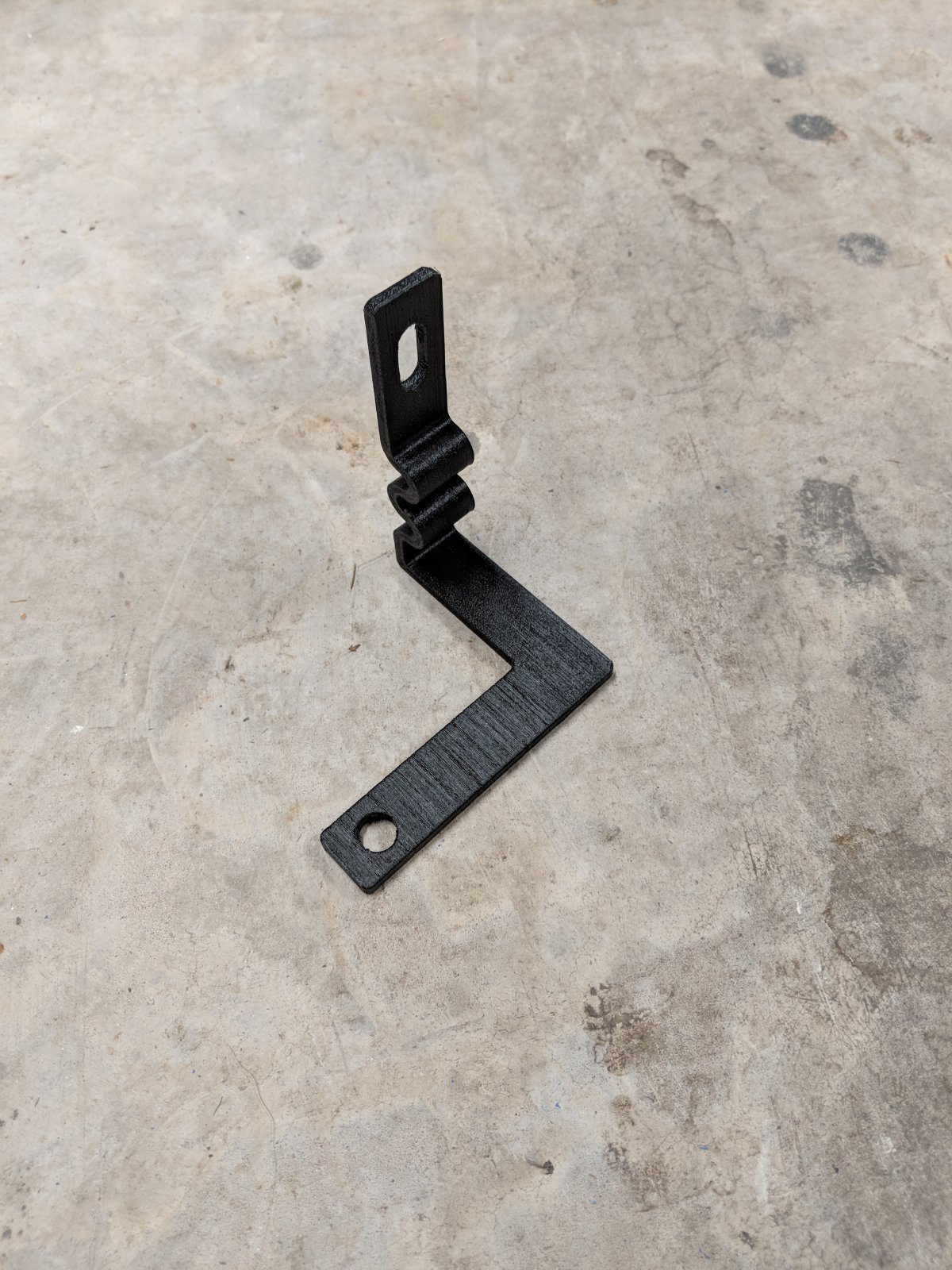

    Here's the 3d printed pot mount that I'll use when the motor is in place:

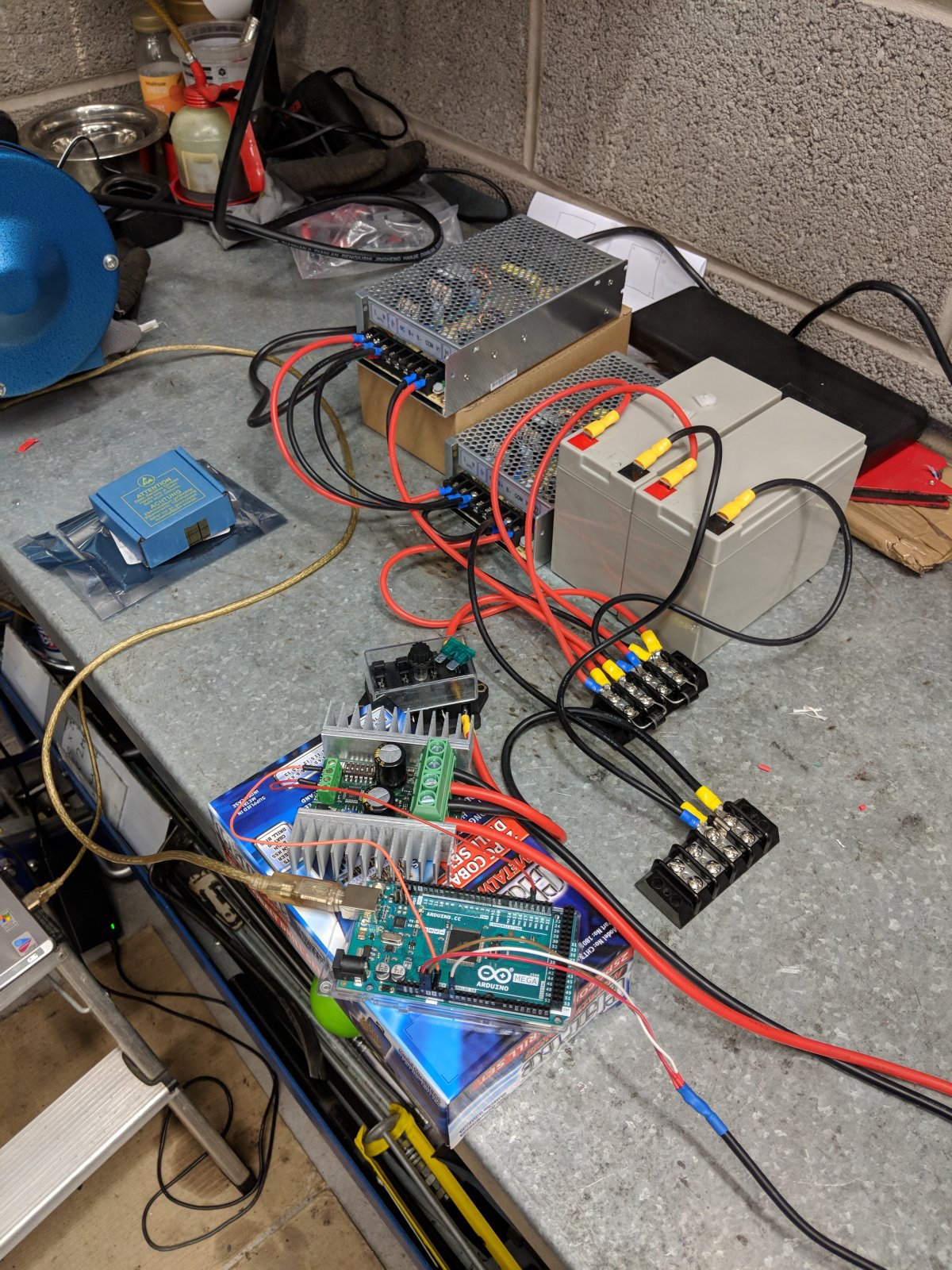

    Hooked up the electronics as per the diagram above (minus the MOSFET for now):
    and I can drive the motor from the SMC3 utils. I get a little bit of overshoot and a small reverse in response to step changes - I'm hoping that once the motor has some load on it this will improve...?

    A bit more progress..
    Bottom frame is ready:
    Motor and 3d printed pot mount in place:

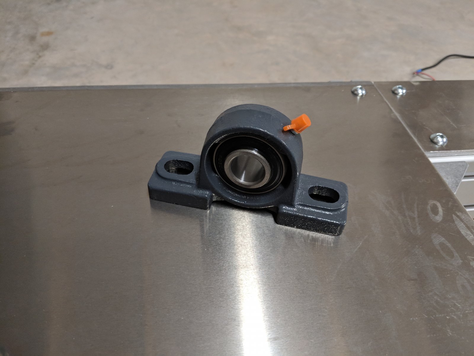

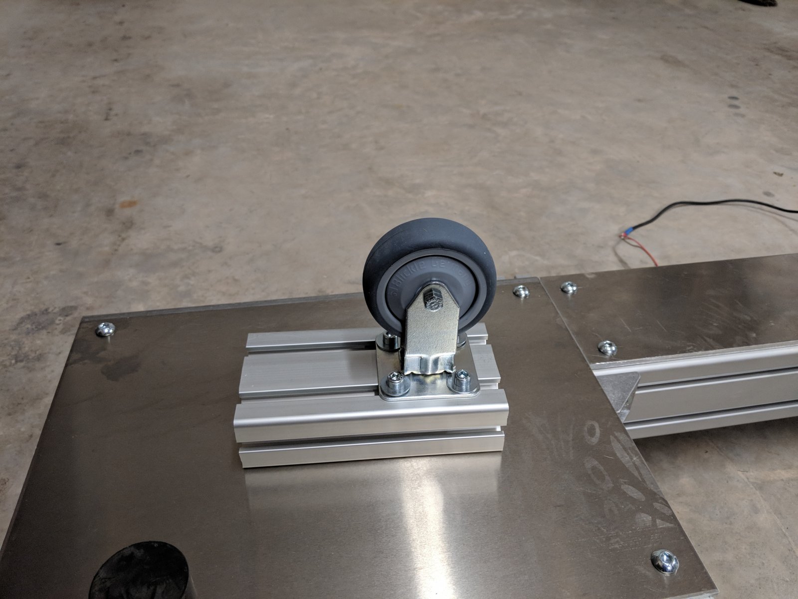

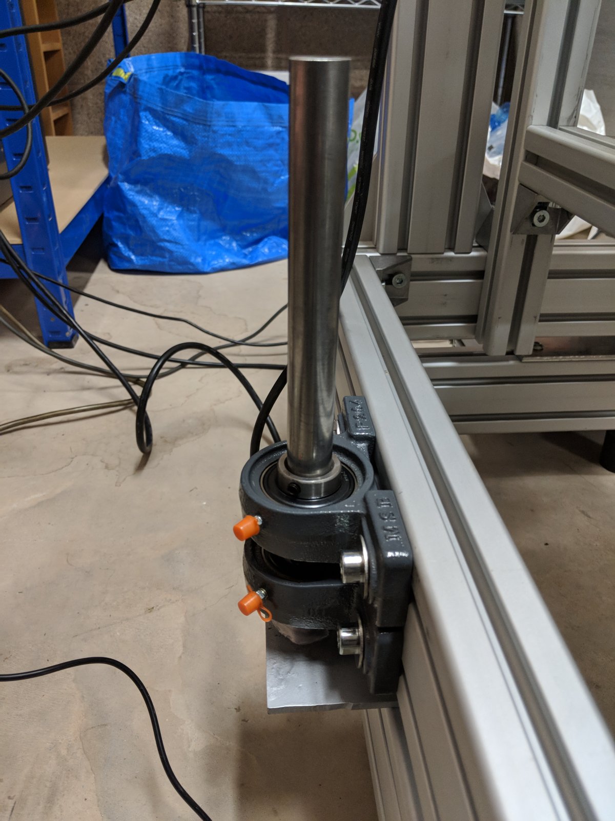

    Here's one of the casters I'll be using:
    .. and here's one of the pillow blocks:
    Almost there... Hopefully I'll have time to attach them to the top frame and get it up and running this weekend..

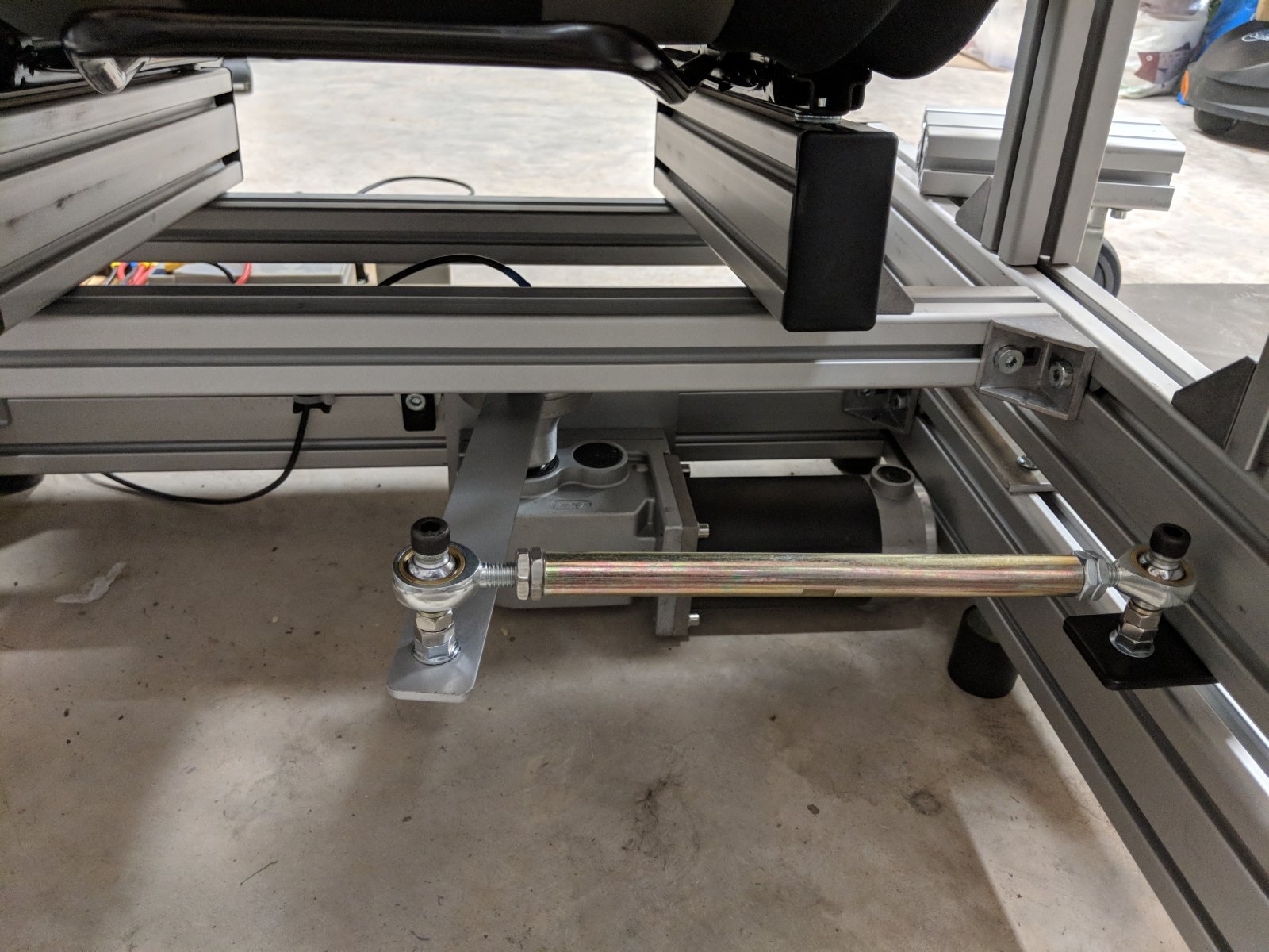

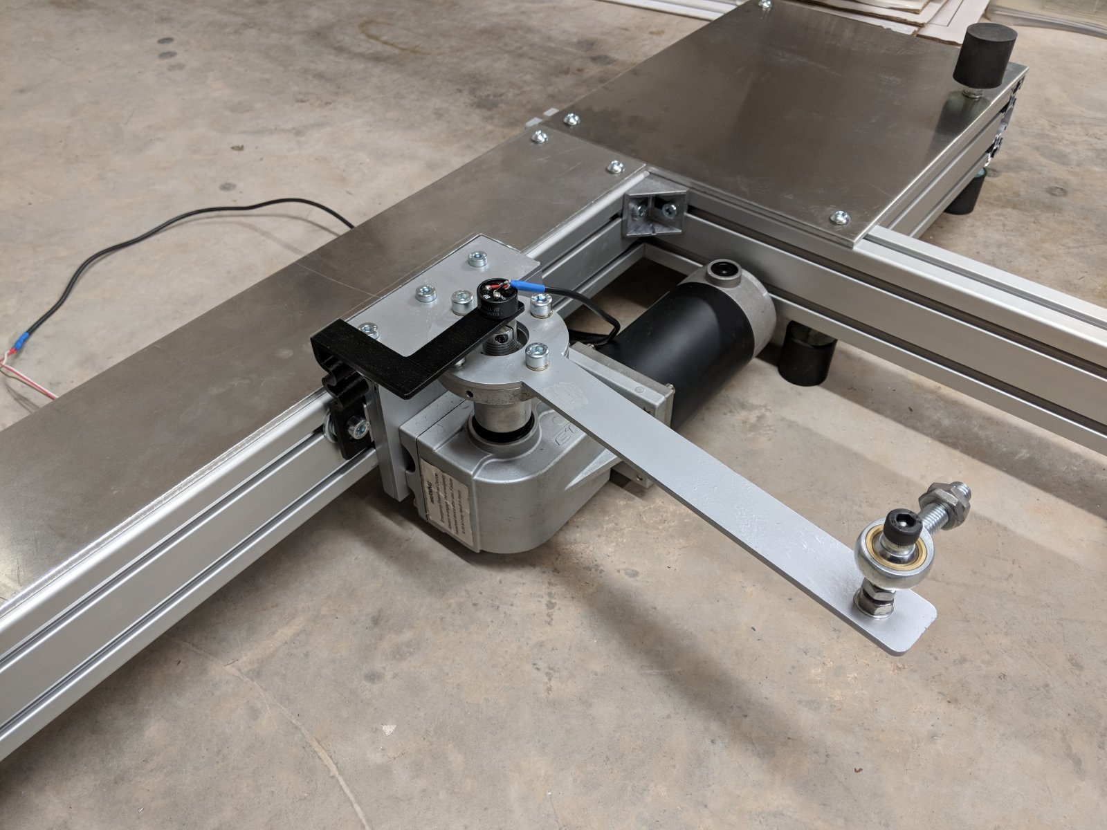

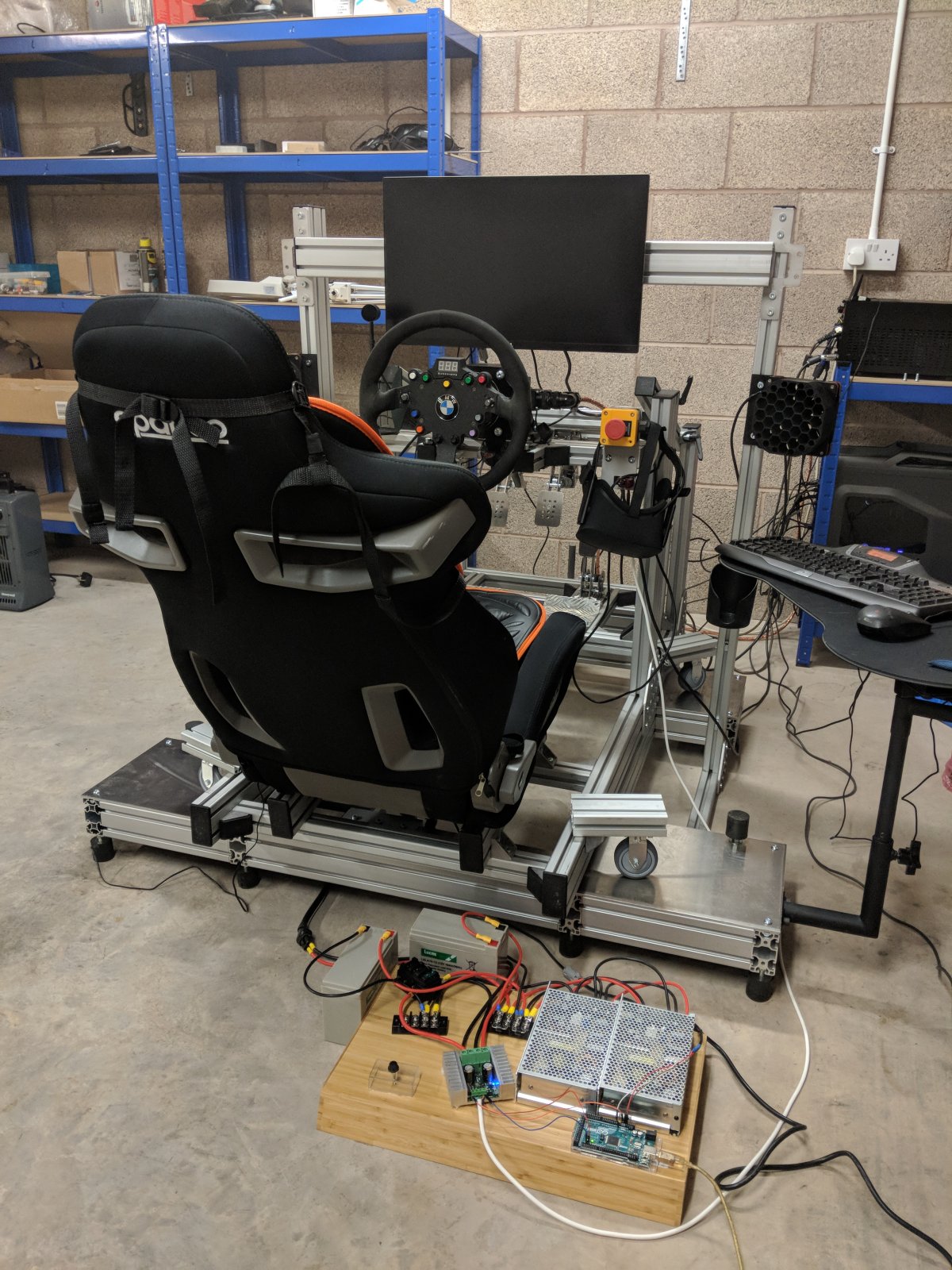

    There's still lots of tidying up to do but it's getting there..
    The front bearing(s) (I'll cut the rod to size eventually):

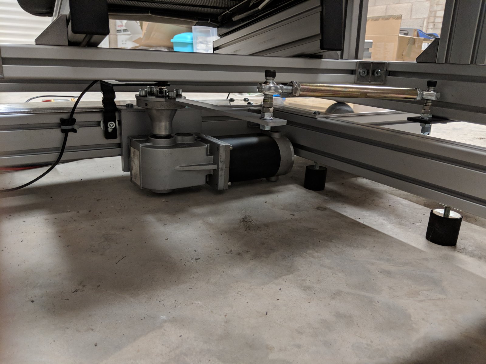

    Here's a look at the motor / lever arm / linkage:

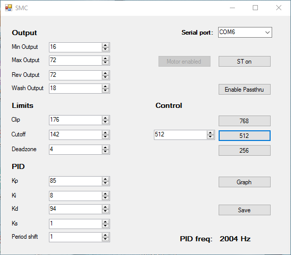

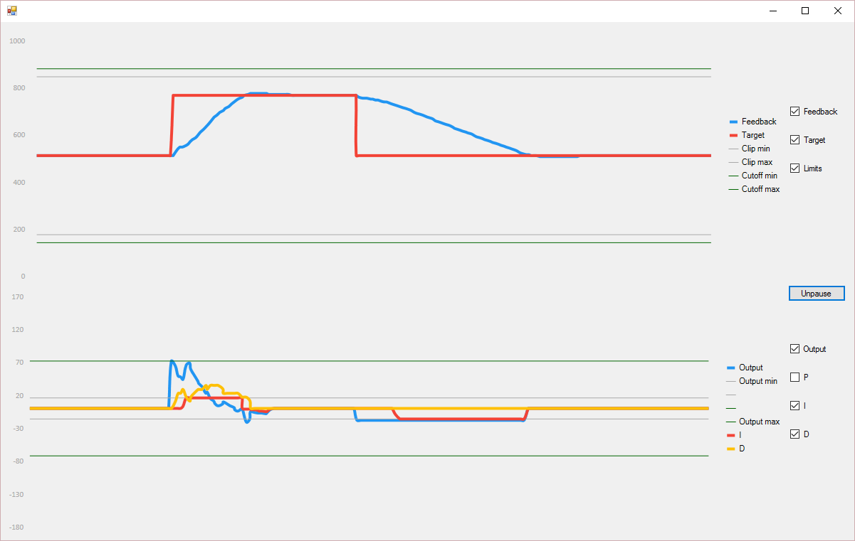

    This made things a lot better (the derivative noise was pretty bad) and easier to tune. I was using SMCUtils and stole some of motor 2's controls / commands to switch the MOSFET gate and enable/disable passthrough for DeScribe but it wasn't very neat and I wanted to visualise the contributions of each of the terms in the PID calculations...
    So I knocked together my own version:
