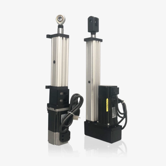

  14. incolor
    incolor New Member
    Jan 12, 2022
    7
    54Coins
    Hi Thanos
    Do you know if there are any compatible actuators with the design on the right side of the image. The racing lab seems to only offer the design on the left side?
    Thanks Johan
  15. Thanos
    Jul 6, 2017
    1,371
    Electronics Engineer
    United States
    2,854Coins
    +1,071 / 9 / -0
    PT-ACTUATOR offers foldback actuators, same as on the photo. Contact them with the dimensions you need (stroke size, leadscrew etc)
