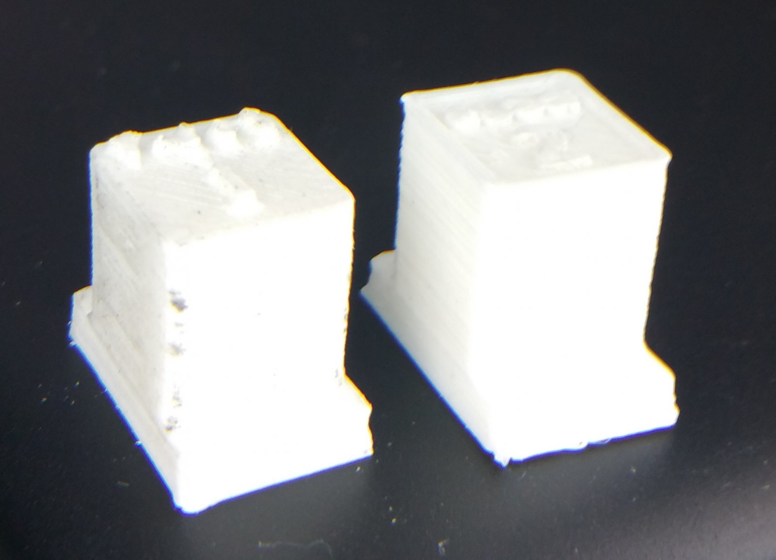

    These prototypes show that the 5mm text is good, but as I mention the smaller text is blurred.
    The 1 key is a very early attempt and the 2 key is the latest attempt. I have the buttons themselves coming out very well indeed with 37% fill and 1mm wall thickness. I also have a raised frame around the outside top like the full scale ICP buttons have. It looks really good other than the small text.
    Sorry for the poor picture, my phone does not do macro very well :)

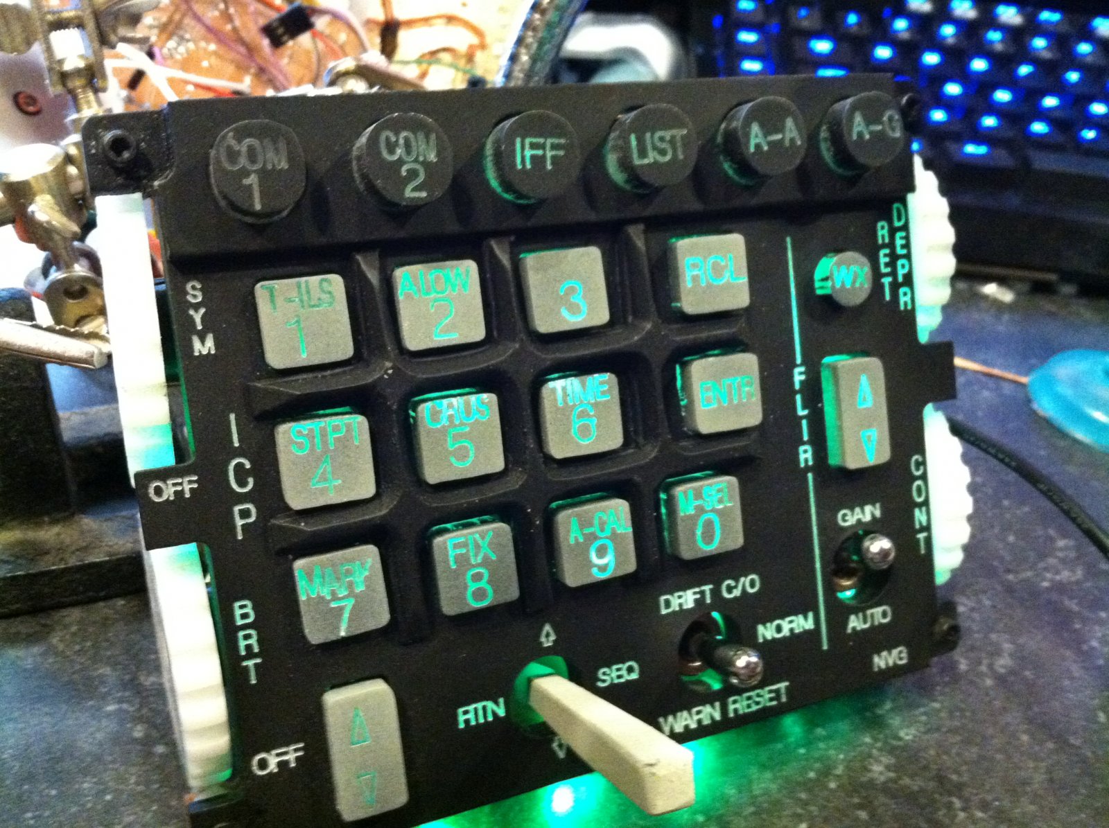

    And one of my ICP modules with the old buttons:

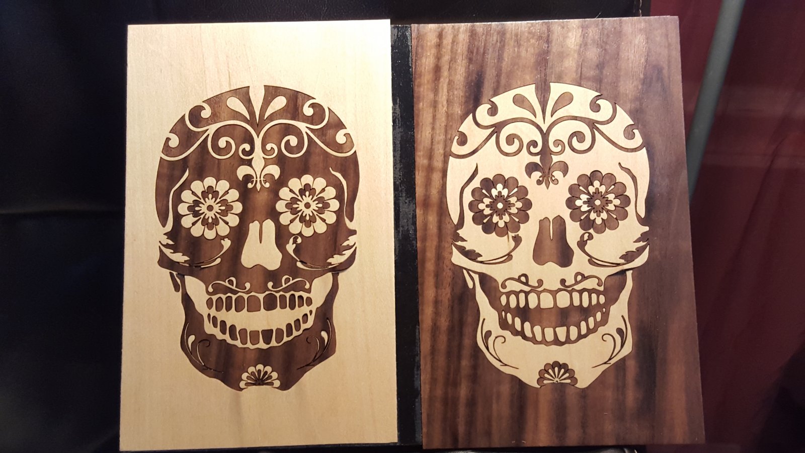

    My k40 Chinese lazer cost $100 more than my 3dprinter. It's not as useful but maybe for this application. If you do decide to get a lazer stay away from moshi crap. I'm contemplating replacing the control board in mine. I don't really use mine for for a lot but it works awesome for inlay work so this may be an option"

    Ok so youre printing at 0.4mm and the base size of your A for example is 0.6mm give or take...your printer has to do 2 passes at which it will do 0.8mm ....thats your issue...

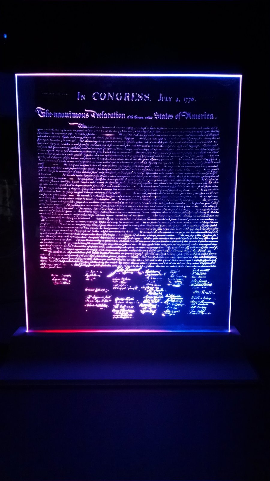

    I've cut .22" (~5.5mm) acrylic very often on the laser and it works well. The cut ends up with a little bit of a taper, but the edge is very smooth. For example of very fine text engraved in acrylic, here is the entire Declaration of Independence engraved on an 8" x 10" piece of acrylic. Need a magnifying glass to read it.
