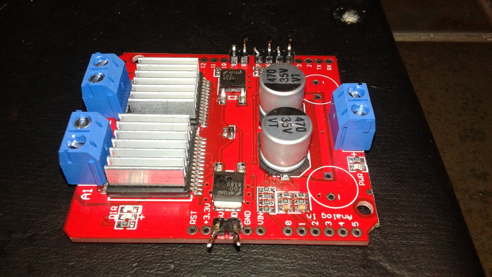

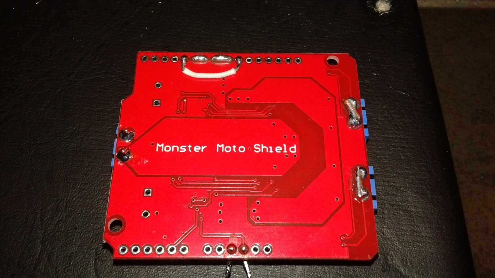

    Prepared the motos for wiring this morning and after testing them i realised they came hotter than i expected without much load, i had previously bought small heatsink because i didnt came accross the big ones i saw with fans i a thread, so i will surely have to buy fans (any sourcing is welcome) that i will mount directly over them and hope it will be enough. As you can see i shorted some connections directly underneath to save time for wiring :) 20160313_095310.jpg 20160313_095330.jpg
  16. Pit
    3,007
    30,516Coins
    +3,098 / 31 / -0
    Great idea to connect the pins as you did. Bad idea are the coolers, they are too small, due to the size and the kind of aluminium the cooler is not able to conduct the heat outside of the chips...

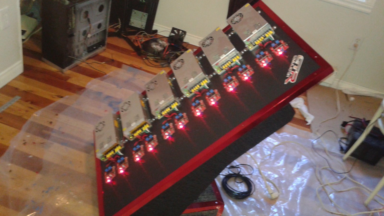

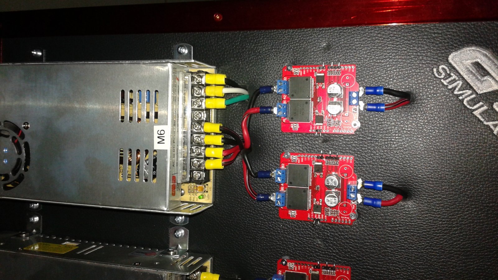

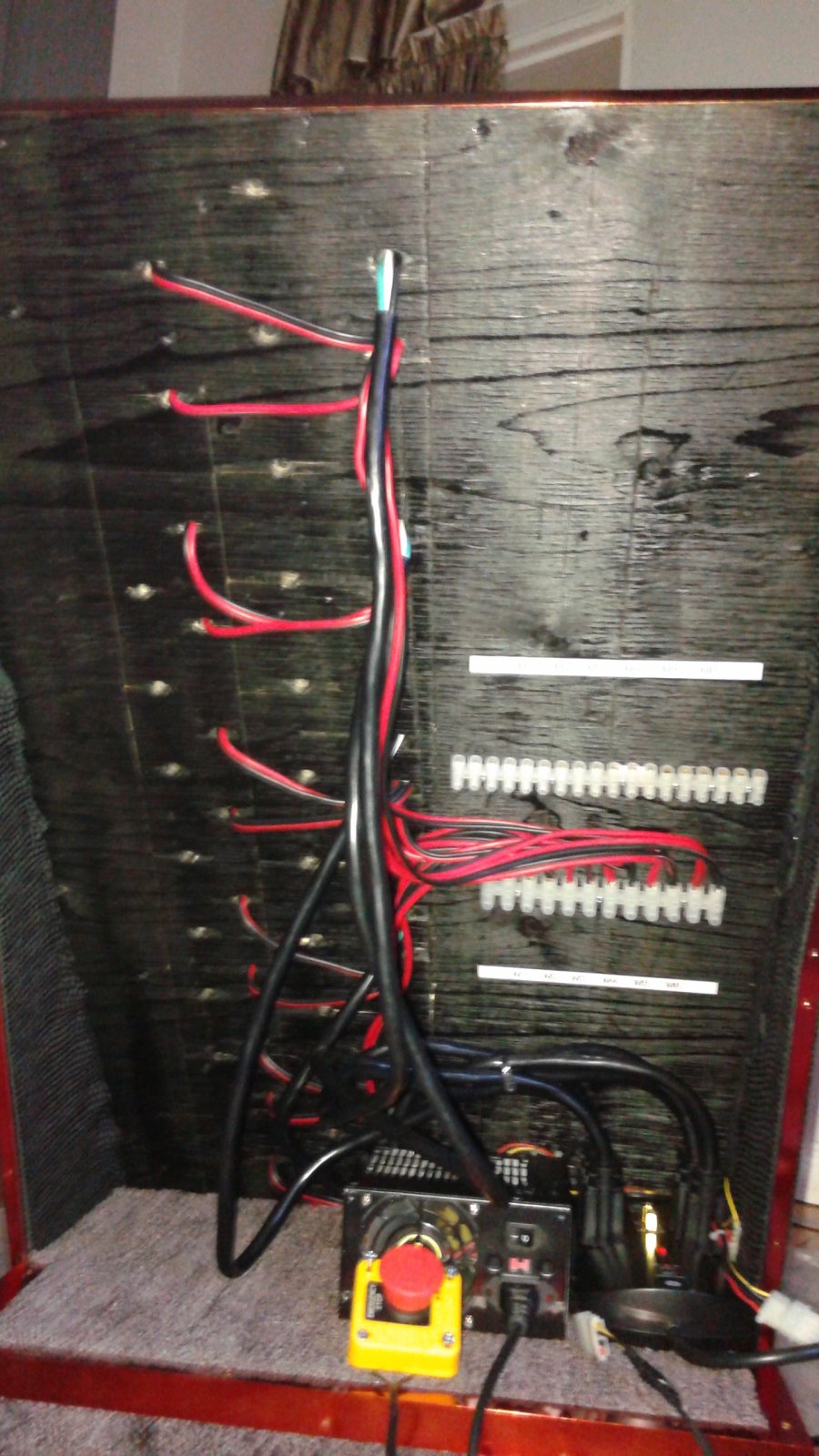

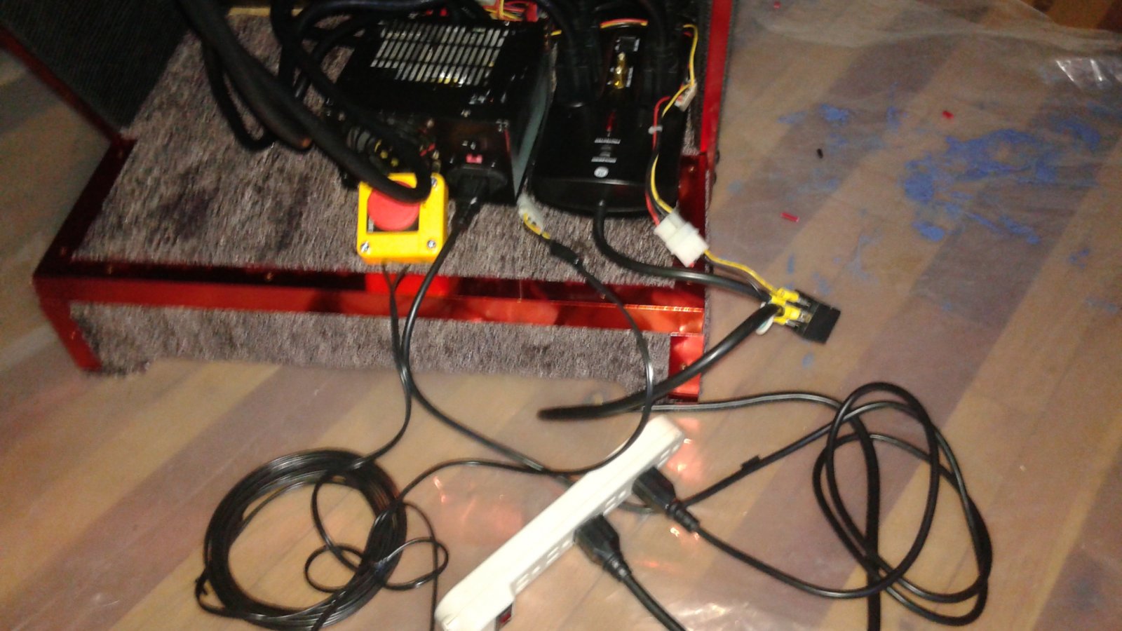

    Here is the update from this week-end progress...all the fork connector are soldered cause i forgot to bring the right crimper from work, it was more time consuming but on the other hand, i think that my power connections are going to be more reliable that way, the hard part of wiring is finished and working as you can see all the power leds are ON, now on to the signal wiring and arduinos next week-end.
    I also made the connections for the red panic button and came to a small problem, all the capacitors in the motos and my power supply are getting discharged before the voltage drops and they take about 3 sec, in case of emergency it will be scary to wait :), i had tought it would be wise to cut the 110v to the power supply to prevent electric damage...anybody have a better suggestion?
