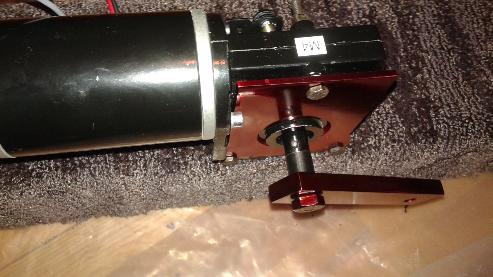

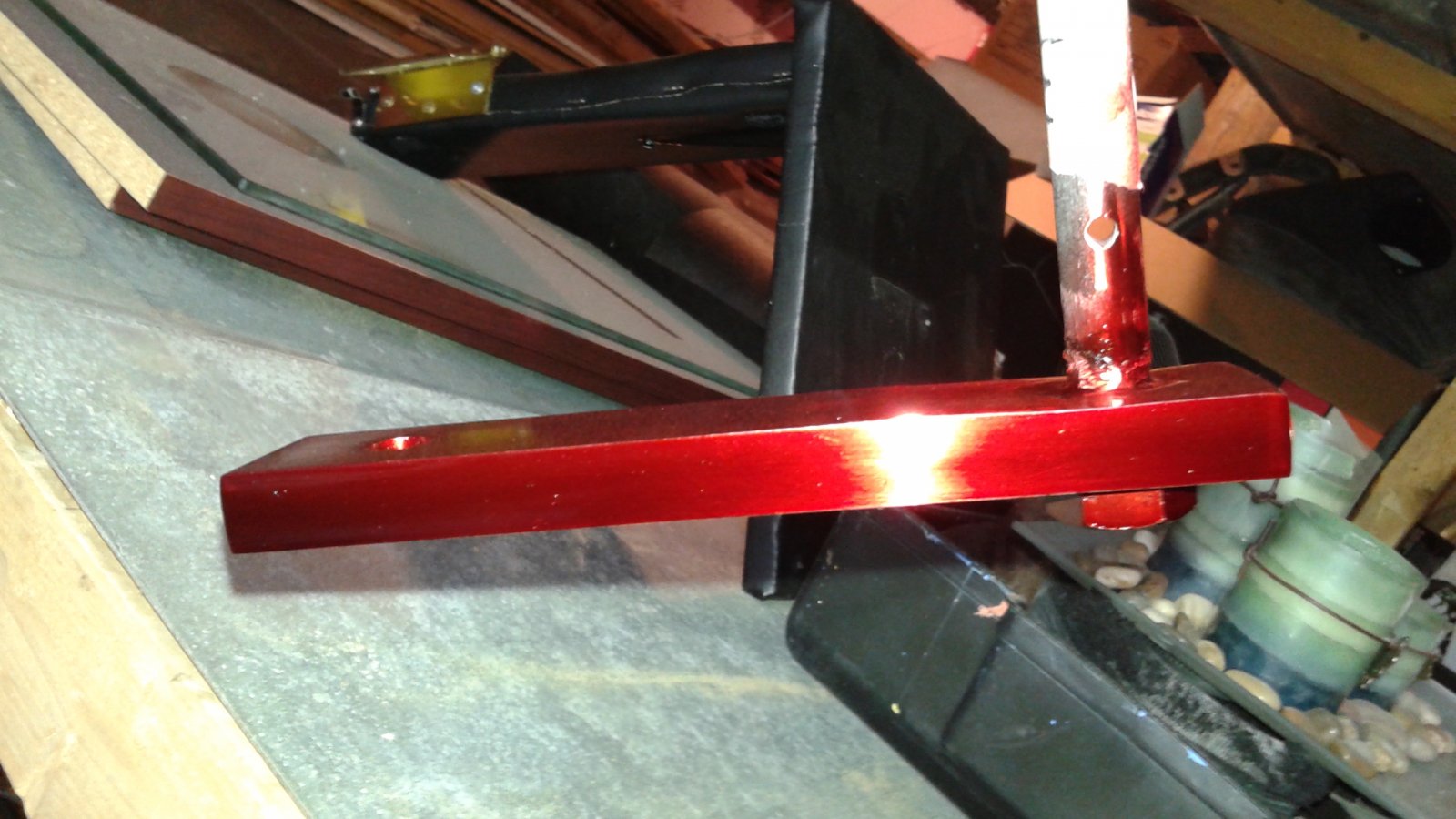

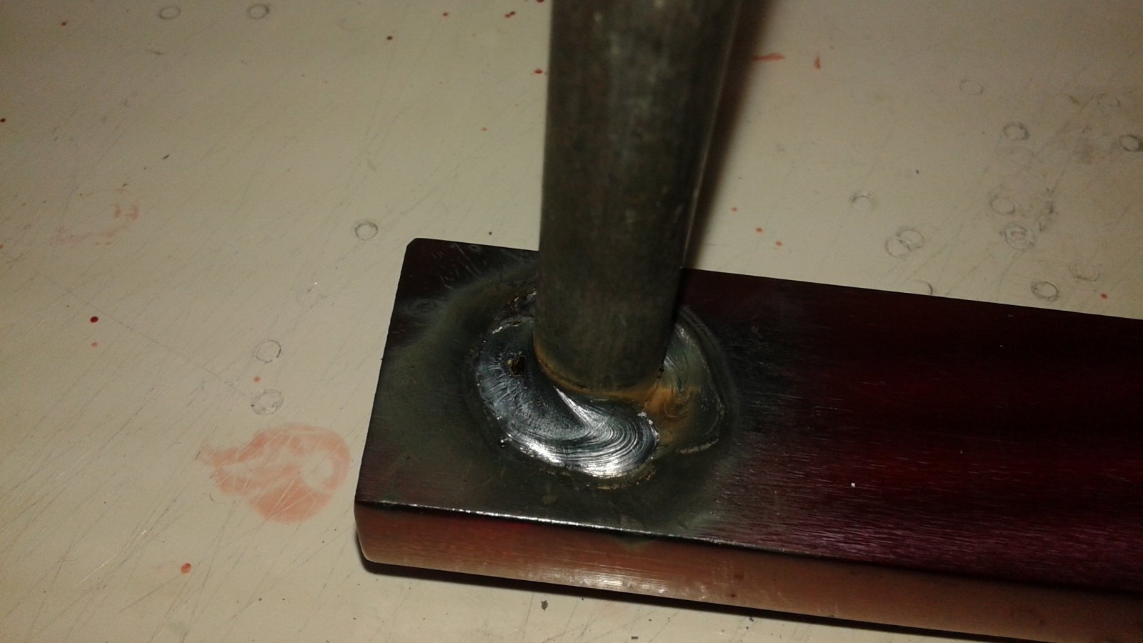

    Tks. Decided to solve the problem by having my arm and the M12 screw welded, left them at the local shop, will have to sand and repaint them afterwords, i will also make a hole in the same screw after all the adjustments are made, mean spacing to clear the motor body and all, and put a lock pin in there, didnt wanted to weaken the screw too much by having 2 holes, thats why one of them will be replaced by the welding.
    And can you believe that i completely forgot to order my arduinos !!!! LOL getting that done tonight and while im there, gonna order some heat sink for the motomonsters and that should cover the ordering for things i cant find around.

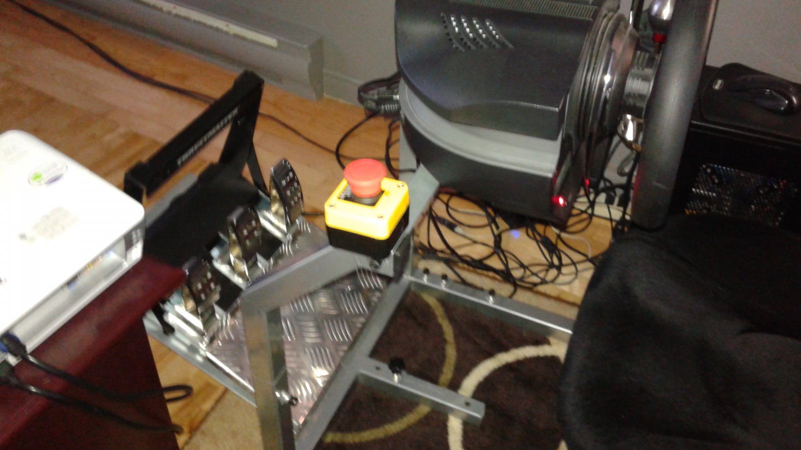

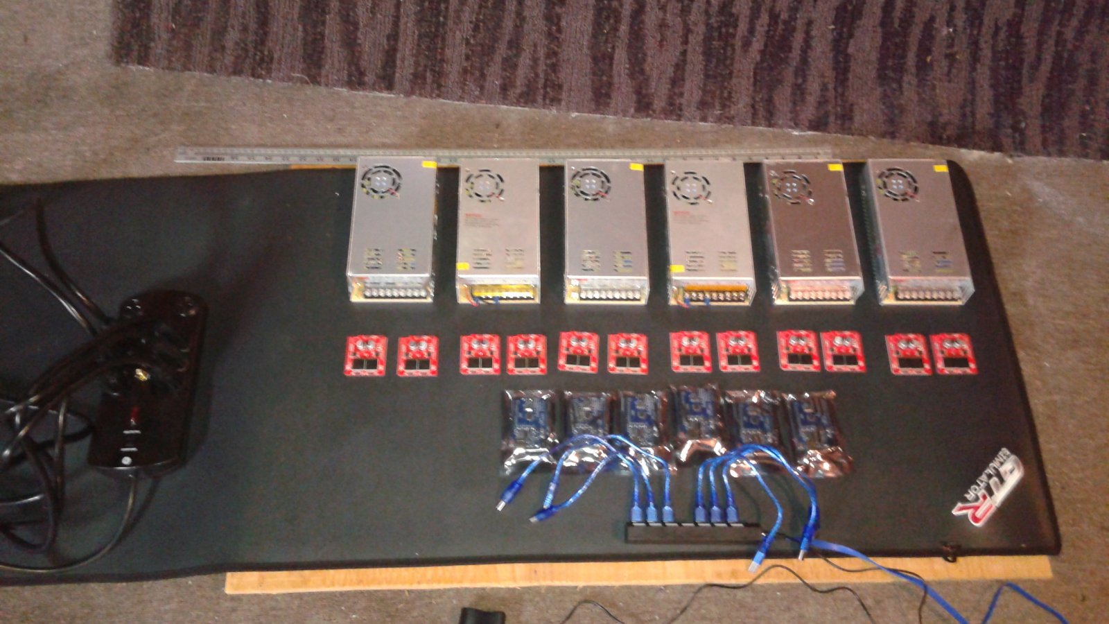

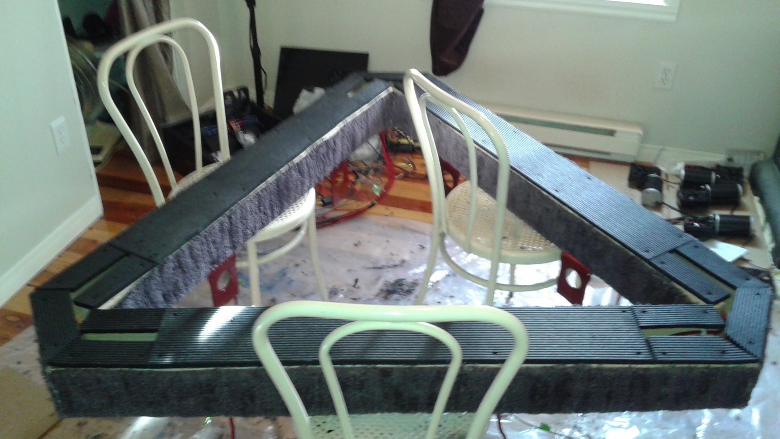

    So here is the latest advancement, my coworker and i were active yesterday to drill that dowell pin hole to keyway the axel, went in perfectly, all is mounted very solidly, little dissapointment on the motor side as the result of this assembly i found out there is a slack in the gearing that makes me hope it wont affect too much the quick direction change, crossing fingers...few wiring to make then test thoses motors, and at that point i will need to move the beast in the living room as it wont go through the door if i keep assembling the top receiving frame.
    I also received all the electronics and as you can see on the pics, i have 2 way to mount everything that will be visible on that free mat i got from GTR simulator with the nice stiching on top, i wouldnt mind any suggestions on that :) as i said previously, that board will be mounted upwards with a bit of an angle to ease cooling, will be framed on 2x3 studs with most wiring hidden behind.
    I also started looking at the arduino, read that it can be supplied through the USB port, as you can see, i bought a multiport USB 3.0 with its own power supply, you guys think it will be OK on that side or i need to plan wiring 12V through the big power supply?
    TKS ALL again for help !!! 20160213_160008.jpg 20160213_160127.jpg 20160213_160413.jpg 20160213_163323.jpg 20160214_124206.jpg 20160214_124225.jpg

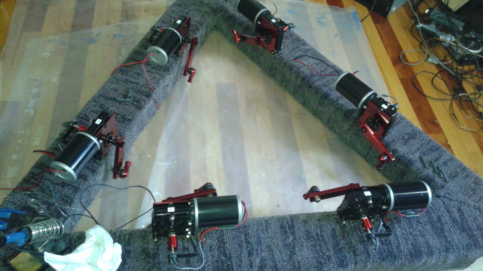

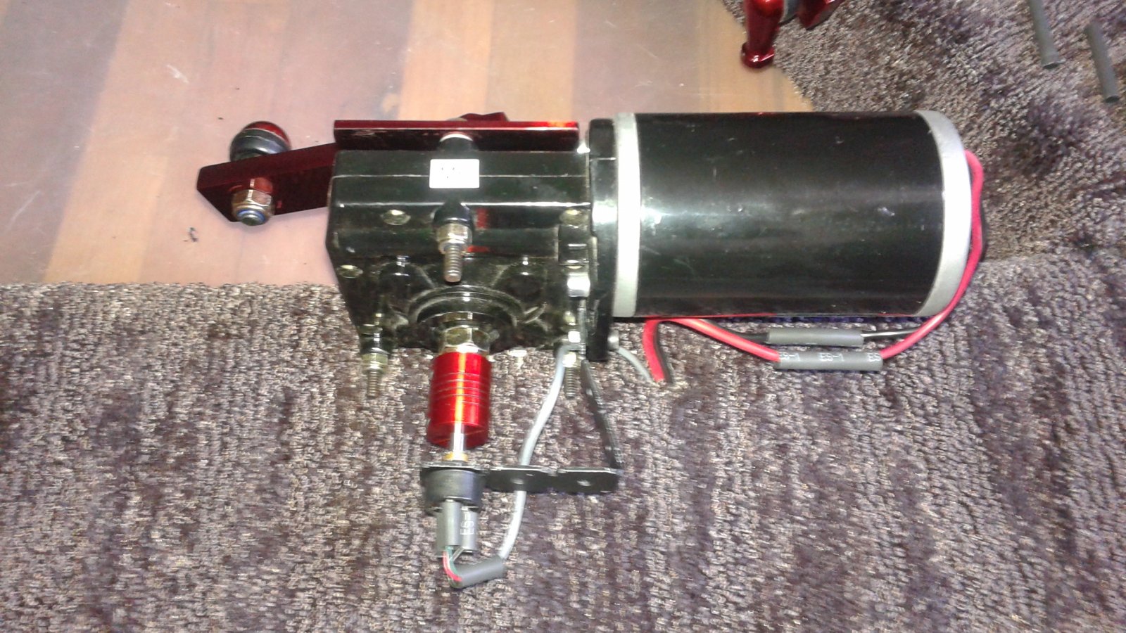

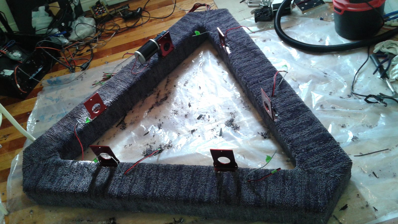

    Well, finished wiring motors and test power supply and motors are wired correctly, as i said in my previous post, one of them had a harder movement by hand, to my dissapointment, it is what is probably causing it to go slower, posted a vid of it, and i also have a bad power supply, cant complain too much as they refund me for coming late and a bit dented, as i am an electronic technician, i will open the darn thing and try to fix it myself b4 i order another one....ho well...we aint having quality theses days, just cheap price, then throw away and buy another!!! polution!!!
    Also @wannabeaflyer2 , just would like to know please what is the lenght of the rods i need to cut, i could figure it out approximatly from your drawing but i would prefer a more exact measure, tks a lot again :)
    So the left motor is the one who is harder to move.

    Hi @poman I just hit the workshop to measure the length of my Rods and they are 400mm Center to center, .. , this can be tweaked to suit your needs and typically seeing as how you have the rose joints at both ends then there is some fine tuning that can be done. I think I read somewhere that the distance between the motor actuator arms and the height of the platform aim to form an equilateral triangle ( something to do with the clever Kinematic maths involved ), but as were using Simtools I believe this may not be the same issue.. ....hey that man congratulations on reaching a great milestone ie , things wired up and spinning and NO BLUE SMOKE Lol always a good sign in my book,
    im not sure how to advise you regarding the slower motor but is it possible that they have sent you the wrong gearbox /Motor Combination ?
    Yo Might take a look inside the offending motor to see if the bt=rushes are mounted correctly , I say that because on one of my brand new straight out of un-opened box I had intermittent operation , only to find out the Brush tensioning spring had broken ... ( You know you gamble with stuff from china but thats the risk vs Price point we can afford )

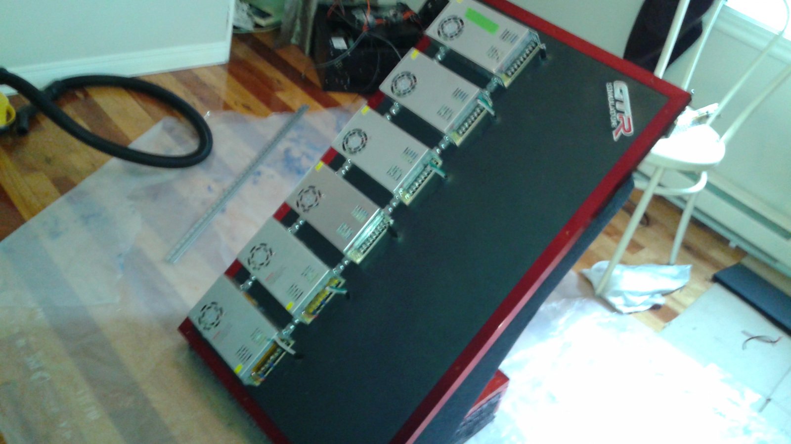

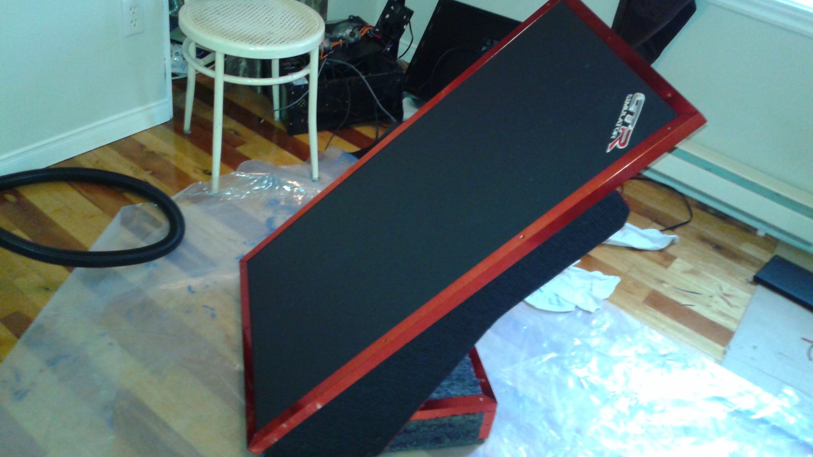

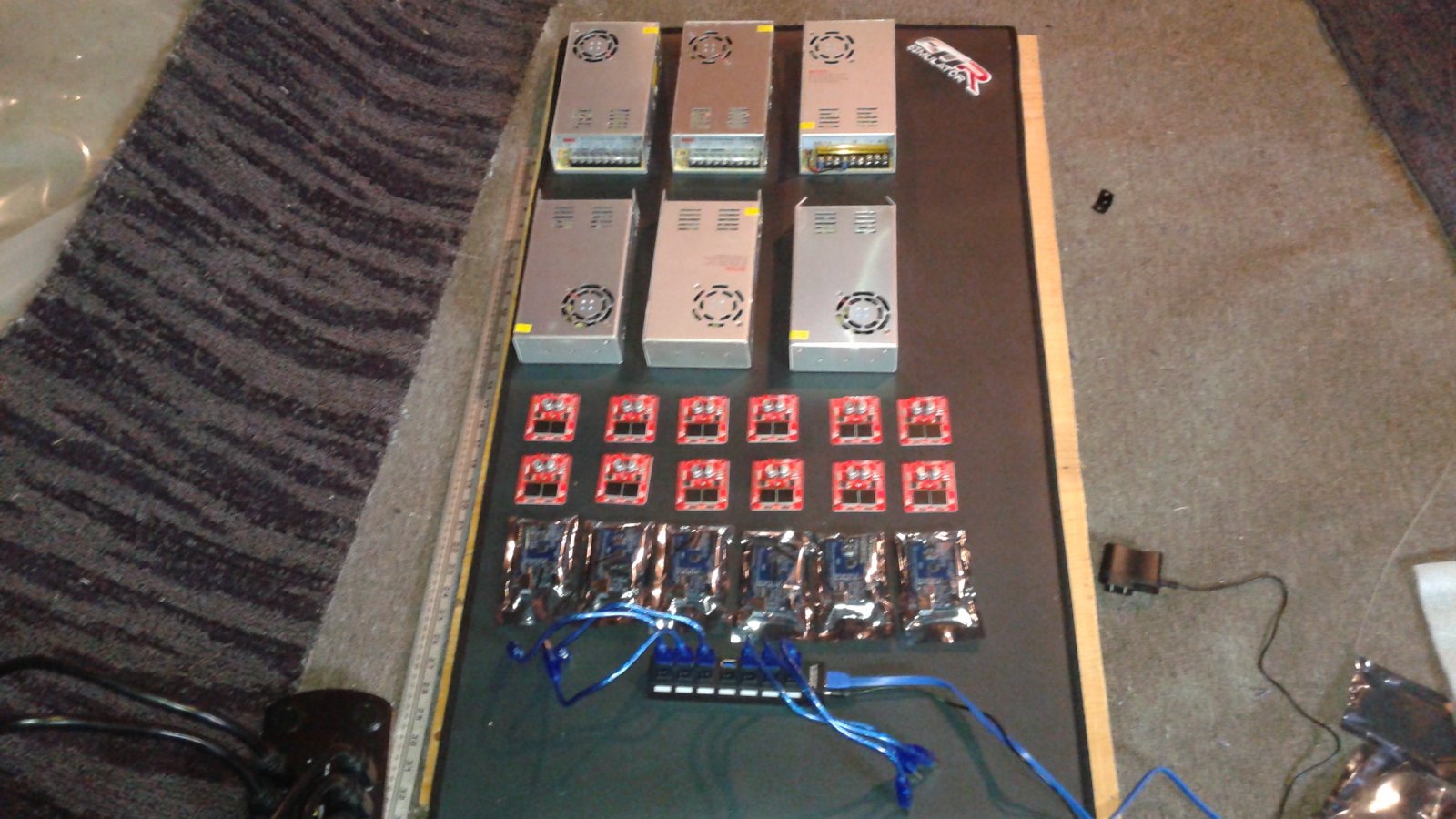

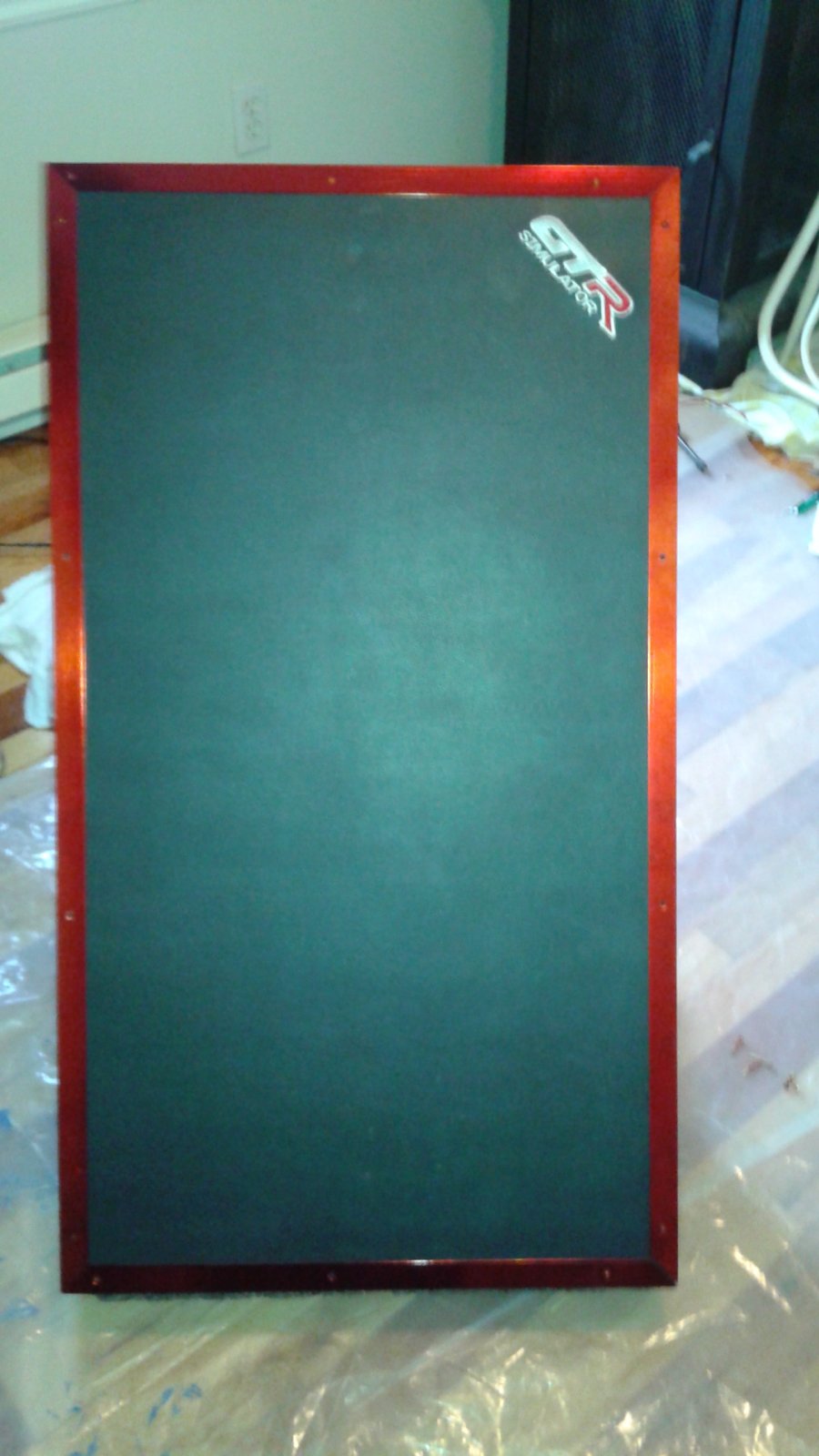

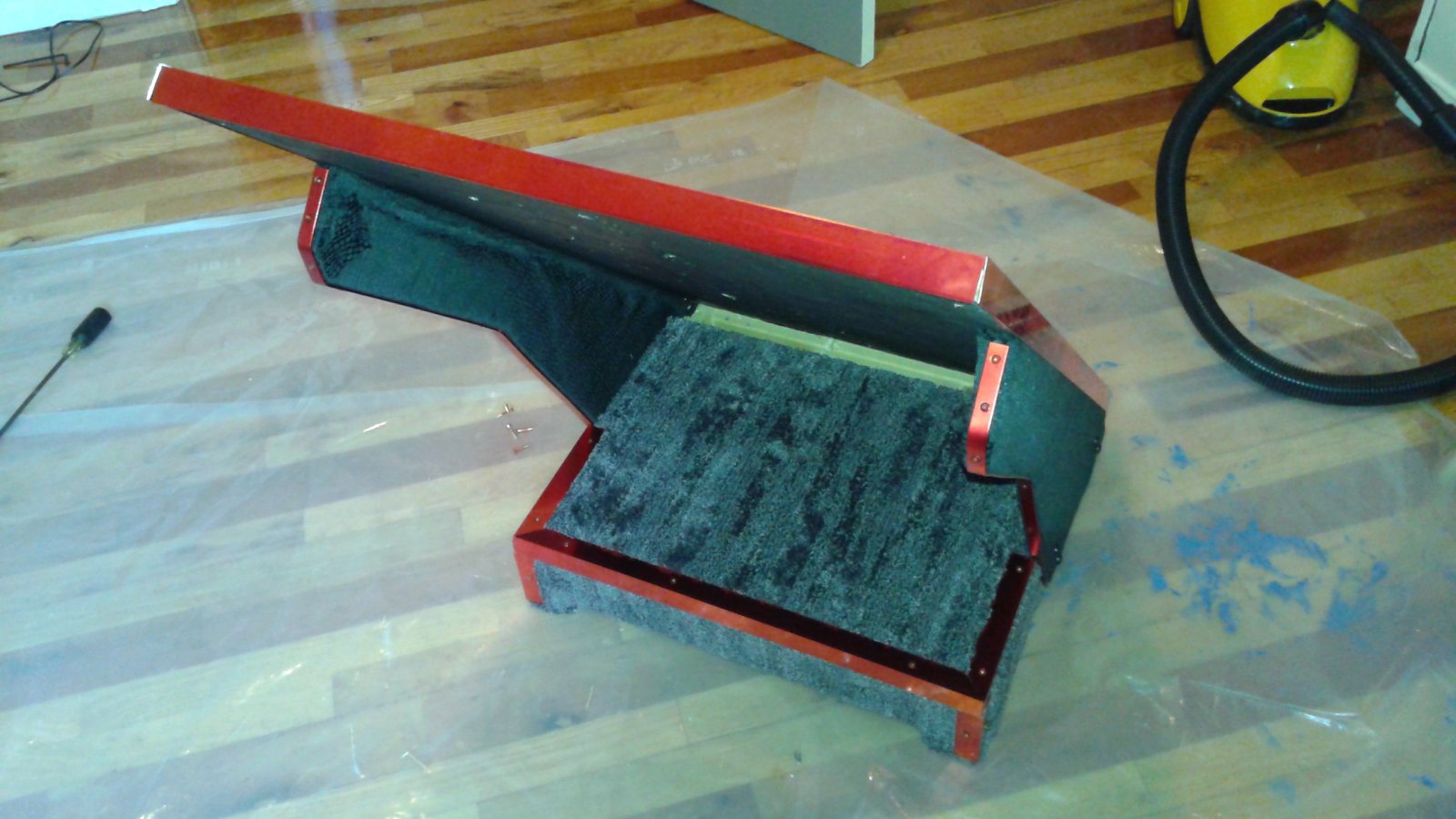

    Been hard at work to work on the electronics panel. I had new ideas during the process which gave me more work even if i reused stuff from my previous rig(see post 25) but it was worth the effort as you will see on the pictures.
    Also got news from the seller of my bad motor, i swapped the motor with the same gearbox and the problem is still there so it is the gearbox that is bad, he wanted me to send back the whole assy but i am trying to get him to send me one instead with the prepaid return paper and reuse his box...well see if he agrees (finger crossed). I also found out about my bad power supply(which has been refunded) that if you hear something banging while you shake an electronic part...there is something fishy bout it LOL, it appears that a coil is loose inside, just to tell you how transporters are very nice with our parts !!!
    Now on to testing motos which ....i hope will not end-up like @SilentChill being frustrated with bad ones, i especially ordered 3 more in case and hope it will be enough, had them from e-bay through a 5 stars seller. Now on to reading on UNO's software and stuff...
    Also decided to go with HTC vive for VR elmet even at that price, oculus would end-up bout the same price with their controllers and reviews says that HTC has more flexibility for future games etc...orders will open tomorrow at 10.00 ET and i will be ready :)
    Also just a quick tks to my long time best friend @r3df0x who tagged my post and became a new member

  20. r3df0x
    r3df0x n00by Racer Gold Contributor
    Jan 17, 2016
    55
    IT technician
    Canada
    236Coins
    +23 / 1 / -0
    2DOF, SCN6
    Hi poman, it's me, your long time best friend :)
    When I saw the first pictures, I thought you'd done a blackboard (to note your races and your results) :grin
    But in the last picture, I understand. Wow, very good idea the installation of PSU on some part of your old cockpit. It's great and clean! :thumbs
    Great work, don't let go ...
