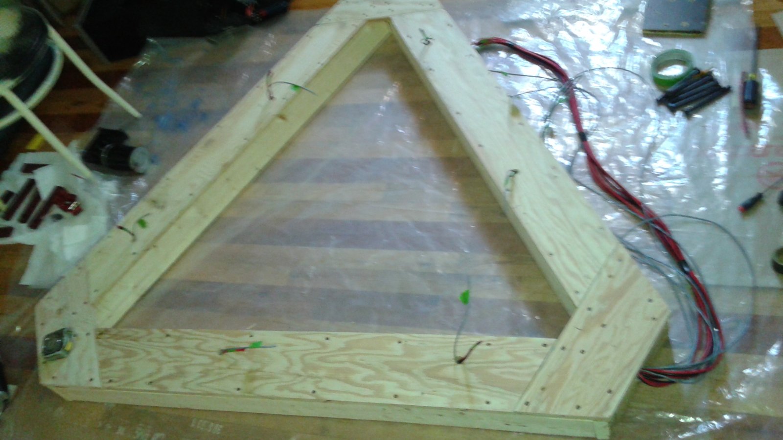

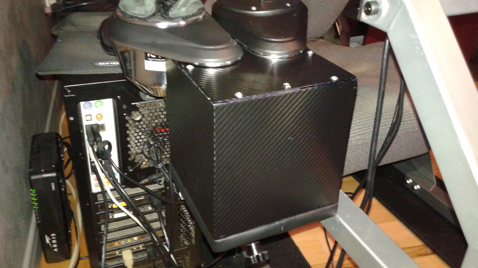

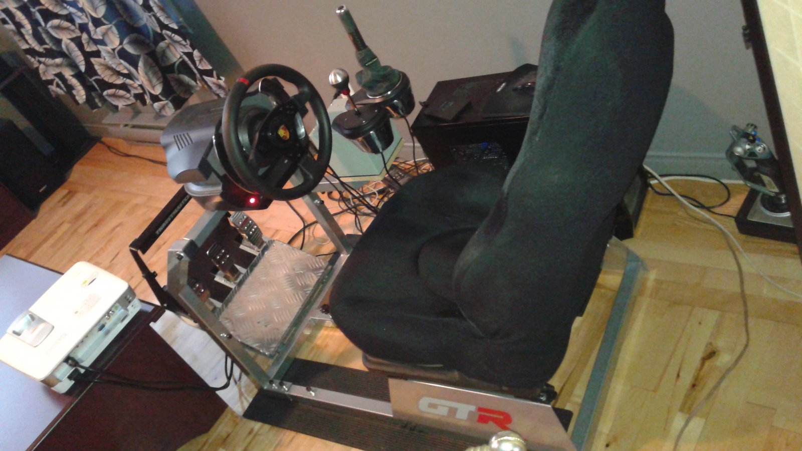

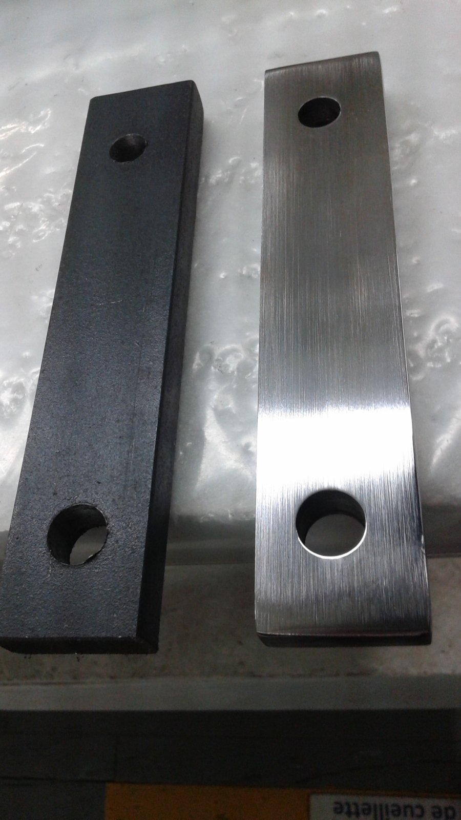

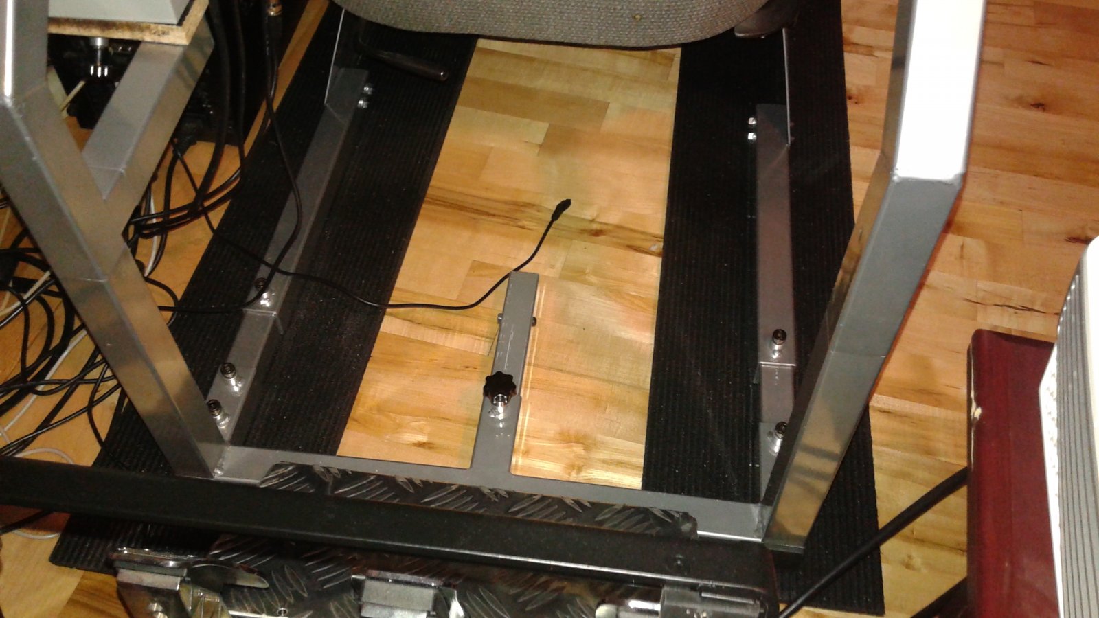

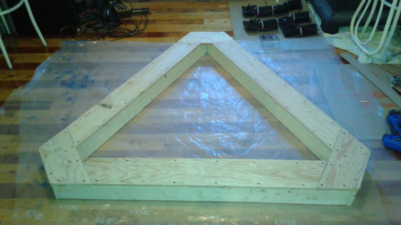

    Started to receive some goodies and had the welding shop in town to make my motor brackets, only a few bucks more than one in local woodstore and i wont have to drill a single hole. Made my base platform according to Wannabeaflyer's drawing, tks to him for the drawings. Also swapped all my peripherals from the 2DOF rig(picture of retirement) to the new metal base cockpit.

    Very nicely done , early days yet but already full of promise :)

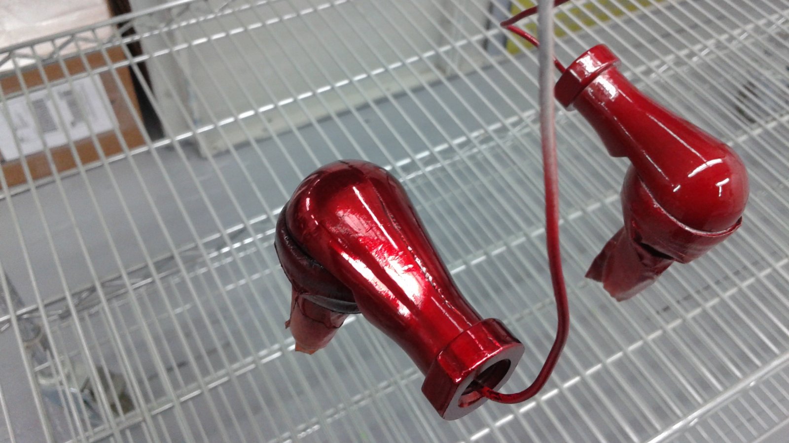

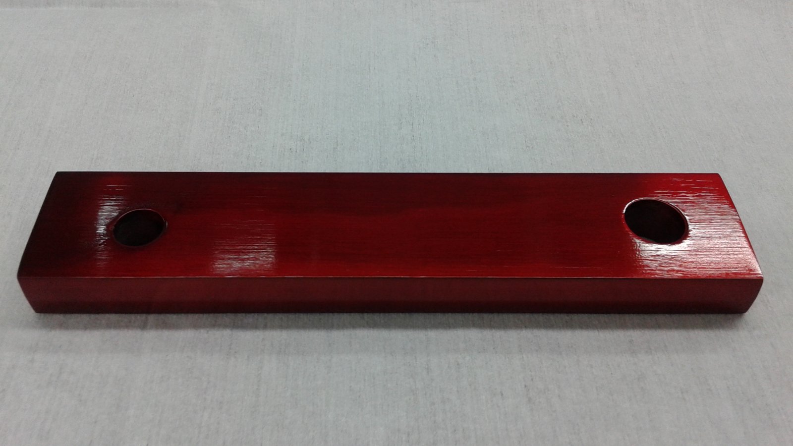

    Hi all,
    Here is an update, received some parts that needed paint, i will be having a paint theme with simili red anodized and grey to fit some accent on my wheel and new rig... still waiting on the carpet i ordered for the wooden base in order to assemble the mecanical parts, also waiting for electronics...spent quite some time to sand and polish thoses parts, should look good in my living room.

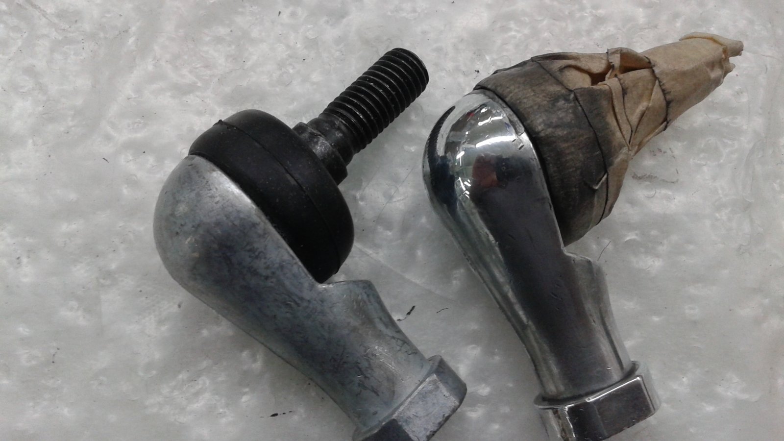

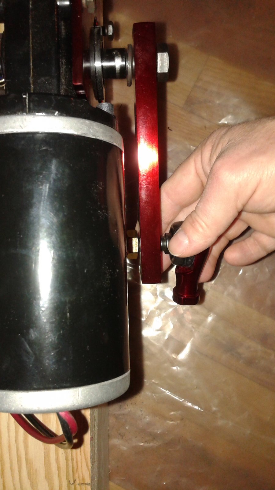

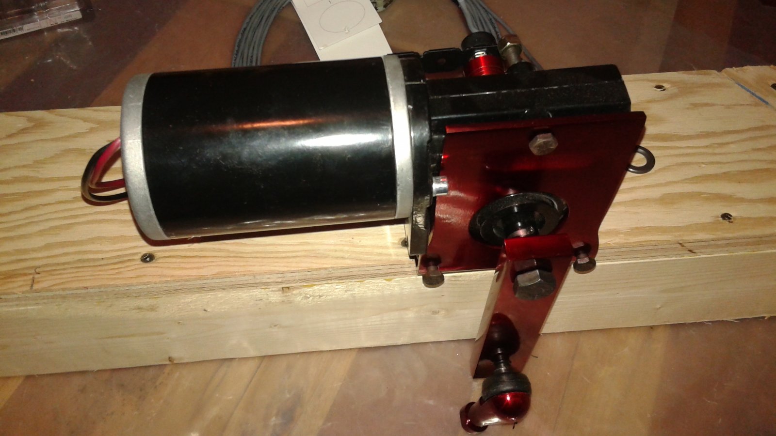

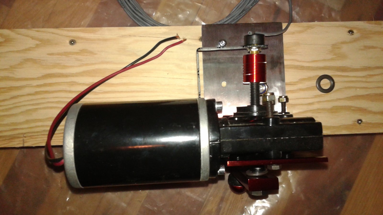

    Here is a preassembly, my question is: do i need to worry about arm crashing into my motor if it doesnt go the right way(on the bottom side of the pic), the ball joint nut is surely in the way...if needed, i could put 3-4 of the black washer between the arm and motor shaft???
    Tks

    HI @poman, if you think it'll be too close to the motor, then it is too close. Don't give yourself problems needlessly. You have plenty of spare length on the shaft to move the arm out another 1/4 - 1/2 inch.
    Mike

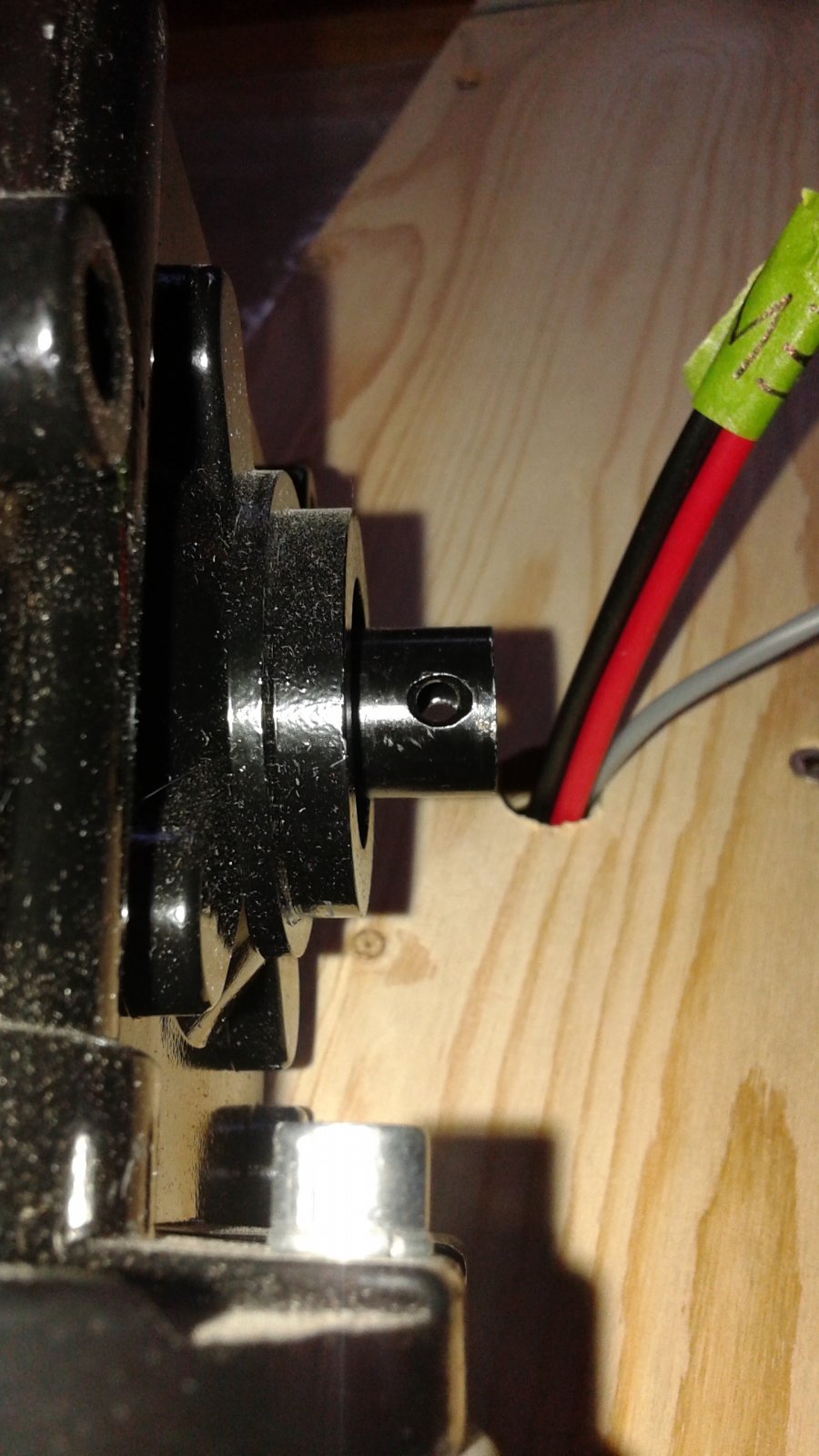

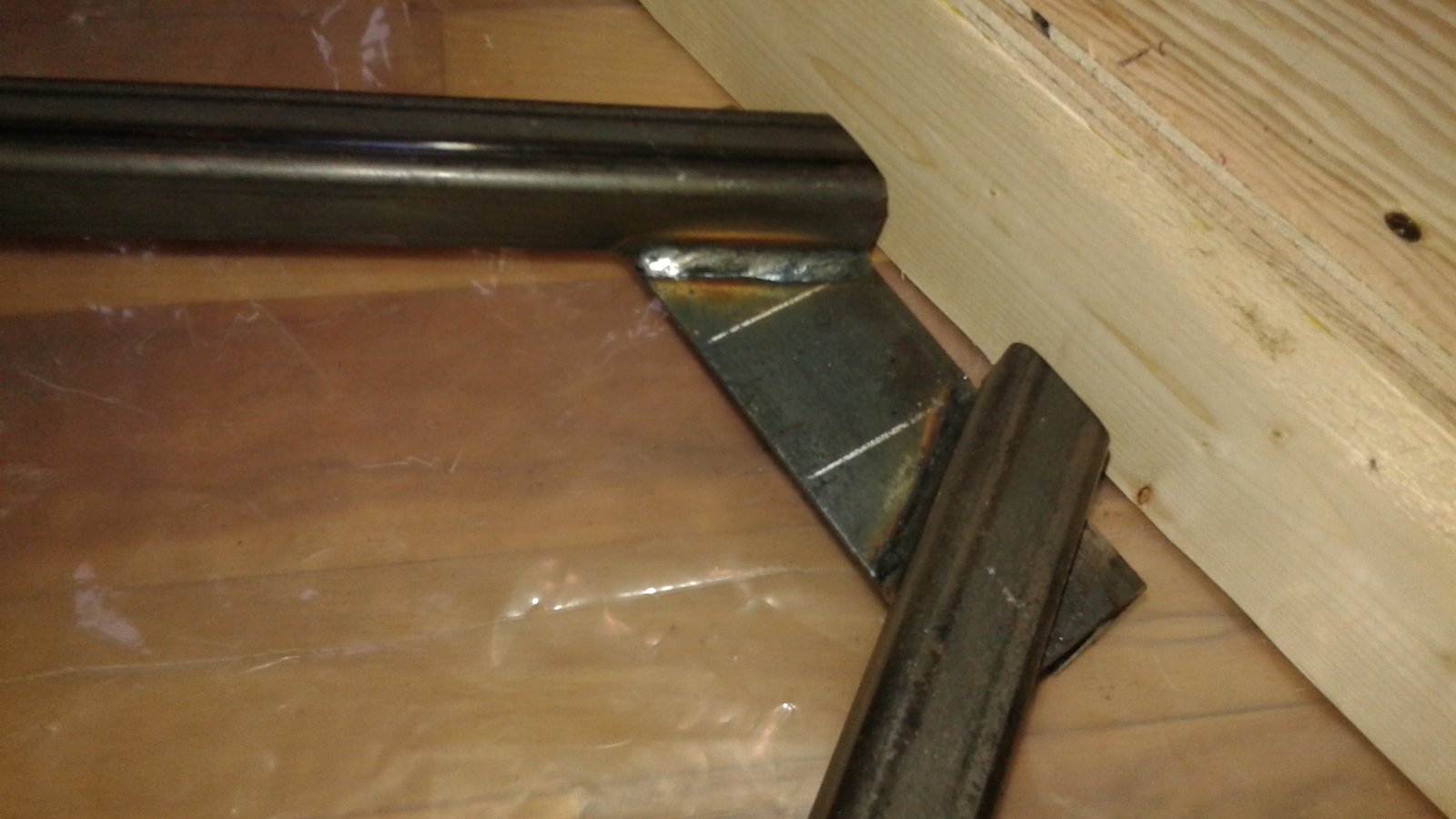

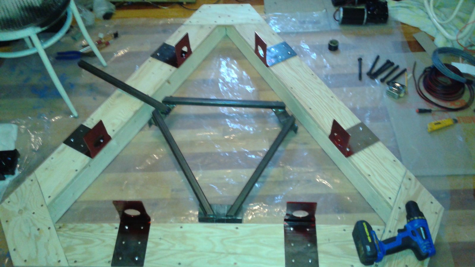

    all right, tks @AceOfSpies . It is surely better to be wiser and prevent stuff, but on my 1st rig with pololu jrk, you need to tell the motor the max and min rotation and with arduinos and motomonster, i am not sure how they works as far as traveling....so here is another pic of my upper frame i had made by a local shop, didnt thrust my welding ability LOL, i had the long rod added to @wannabeaflyer2 's drawing in order to attach the front of my rig as the side panels dont have square tubing, if anybody sees a design problem with that, it would be very appreciated to warn me !!

    in an arduino and motomonster(or chinese knockoff clone) configuration you define the min and max motor position with the sketch (code) that you upload to the arduino.
    in some cases there is a user interface that makes it more easy for you to make changes to a plethora of variables in the sketch.

    Hi Poman , Quality work indeed sir, when i said early days & shows Promise , im thinking understatement , with this level of detail already then this is shaping up to be a benchmark project in the making ,

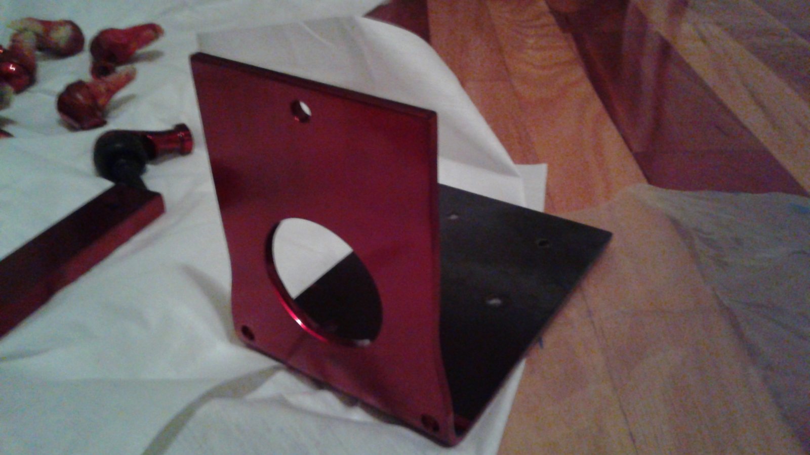

    I would only add to what the guys mentioned about the arm being close to the motor, from past expieriance , i can say its def best to have the clear of any obstructions , they pack a serious amount of torque and if you have a runaway condition during setting up motor / Feedback , they can do serious damage, so go with the spacer option and allow for some deflection clearance under full load as well :)
    You may look at beefing up the motor support brackets ,they look to be around 3 -5 mm thick so they may flex when your baby is throwing you around in the best possible way . just me 2 cents worth never a critisism ...

    @wannabeaflyer2 , tks a lot, and i am not finished yet, had an idea yesterday about the electronics panel inspired by @zigzag49 which is a upright standing style, gonna use the free mat i had from GTR simulator (where i bought my frame) as the background of the panel :)
    also my brackets are 3/16'', so 4.76mm...will see if they flex too much.

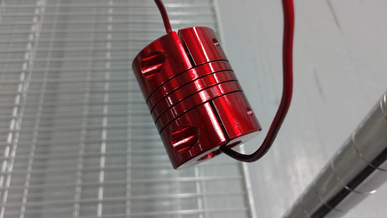

    just a thought and this comes from lesson learnt , please note this is not nit picking just trying to help in case its been noticed , i just thought you may have overlooked it based on the pics ... could not be sure but does your Red actuator arm have a keyway slot in it? to mate with the motor drive shaft. i only mention this because if your relying on the what looks like M8 -M10 set screw to hold the lever in place on the shaft , you may find it will come undone pretty quickly once the system is loaded and the actuator is moving back and forth. if you have this covered then ignore this suggestion .. Cheers Poman

    As for your concern, that is exactly what i want, comments, dont worry about critisism :) well for that manner as you can see on my motor shaft, there is a small hole i can use to block the big screw, i would need to drill the screw and put a pin in there, but as far as the arm, i had tought that a star washer on both sides and torque this like hell with a nylon insert in my nut would block it, bare in mind that i will be using gas strut to help the weight....am i a dreamer lol...or what i just said might work?

    You HAVE to have some sort of key way, If not you'll end up spinning the shaft and potentially damaging the gear output. Applying excessive torque on the main axle wont help either, The gear output can actually be "crushed" if your not careful.

    Aha now seen the last pictures and that makes sense LOL. i assumed wrongly that the bolt was threaded into the drive shaft . i now see the shaft is hollow and threaded internally so you'll possible drill through that hole all the way through the shaft put a Pin or Set screw & Nut to act as anti rotation lock .. loads of ways to skin a cat LOL just so long as you get to secure the actuator arm without and free play on the shaft ...Great stuff and excellent Progress ... Oh OH did i mention i'd be watching this post like a hawk LOL well now its bumped up to Eagle level :)
