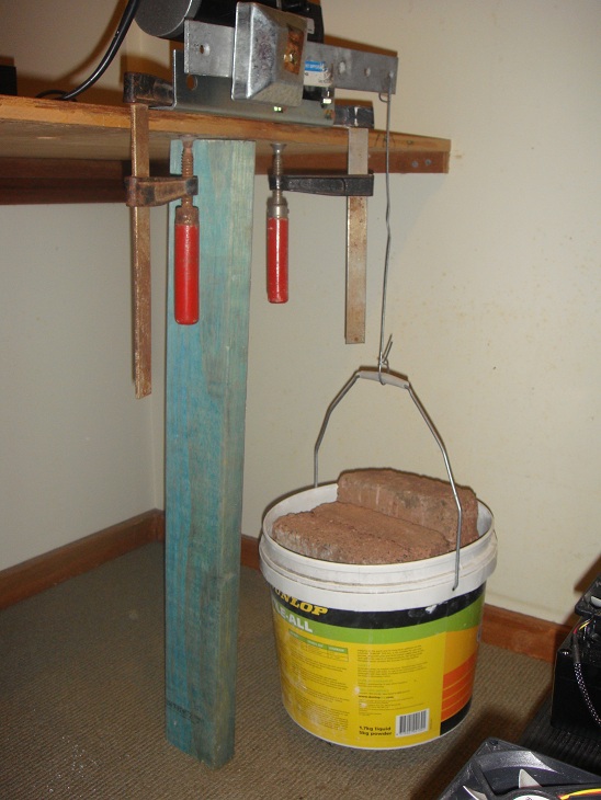

    I have not seen a working JRK based 6DOF/Stewart plateform. So I would recommend buying one motor and setting up a load test rig with the JRK that you already have. It is what I did and it saved me allot of money and time. Building a 6DOF is expensive enough (relative to other DIY Sims) as it is.

    @poman Just my recommendation, FYI extract from an old thread of mine.
    And an extract from my words at the time.
    Peaked out at 16kg with a 100mm arm, 19 kg with a 75mm arm. This is a 12vDC 200 watt motor with a 60:1 steel/brass gearbox.
    For lots of reasons including lack of travel, current limitation of JRKs, did not go down this route, ended up building my own actuators using 500mm ballscrews and in the end (had issues sourcing required motors) 12V 48amp motors with dual MM (basically 4 JRK driver chips) as drivers for each actuator.
    It is really your money/time, so your call, I just though that the JRK/200w motor setup may have worked, but would have been on the limits when you factor in weight of sim frame/steering wheel/friction/inertia etc. Not a risk in time/money I was prepared to take.
    Good luck with your build.
