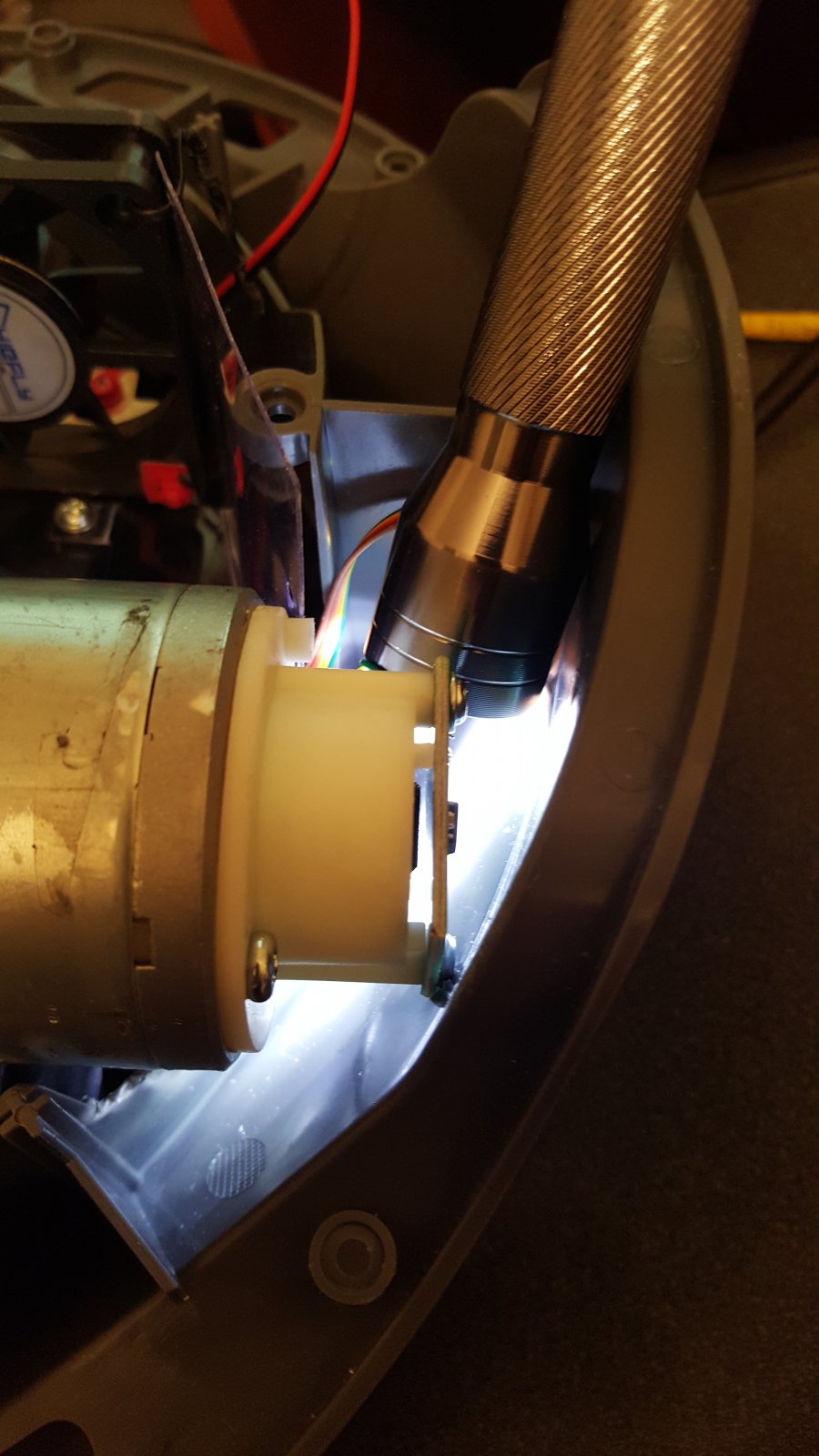

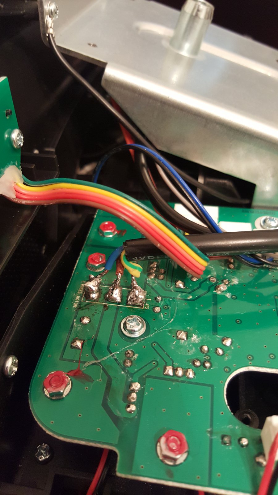

    Hello I have completed the mod every thing works but the wheel continues to go left to right no self centre what so ever just keeps going left to right on start up until I turn it off.
    Any suggestions ? thanks.

    Hi Chris. First thing that comes to mind is the (wrong?) polarity. Could you upload some HQ photos of your mod?

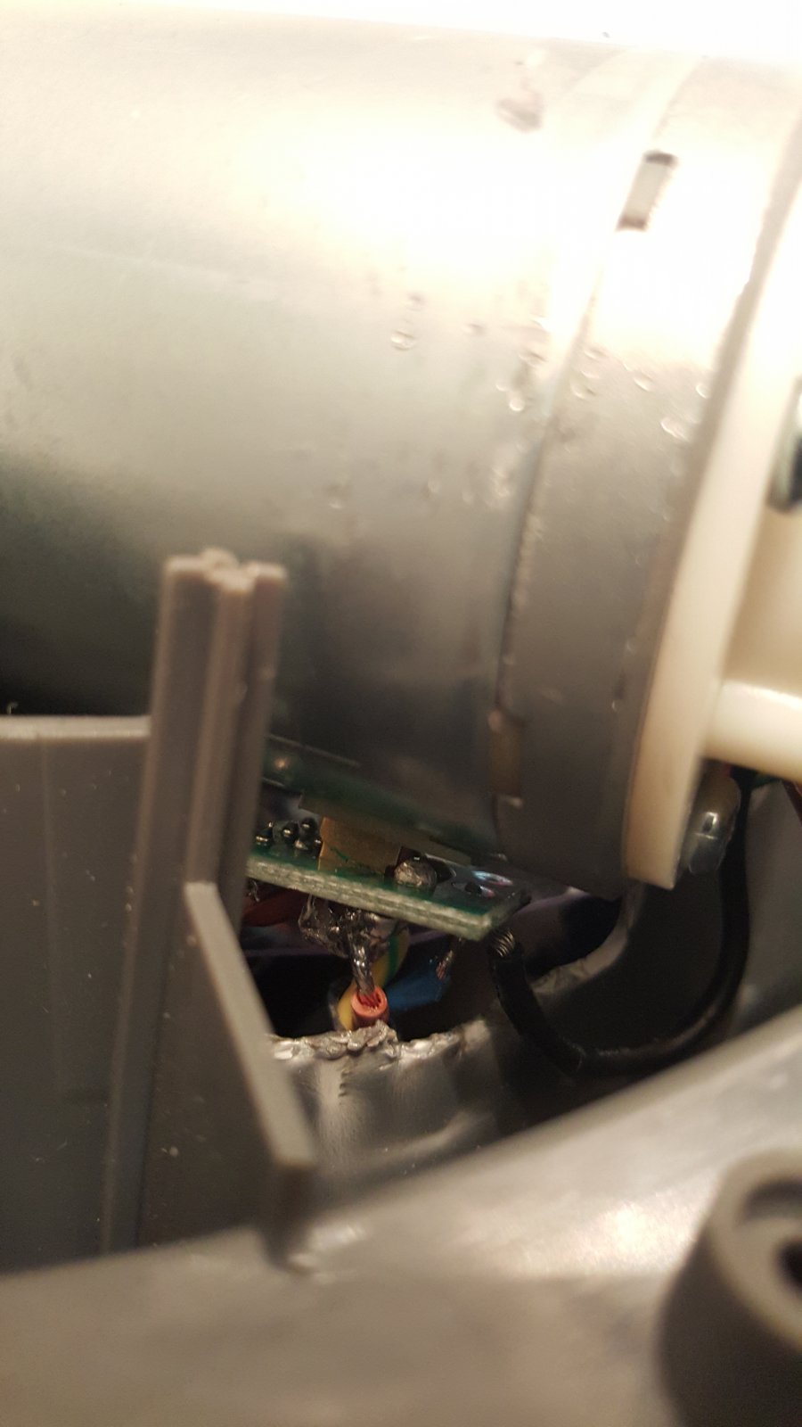

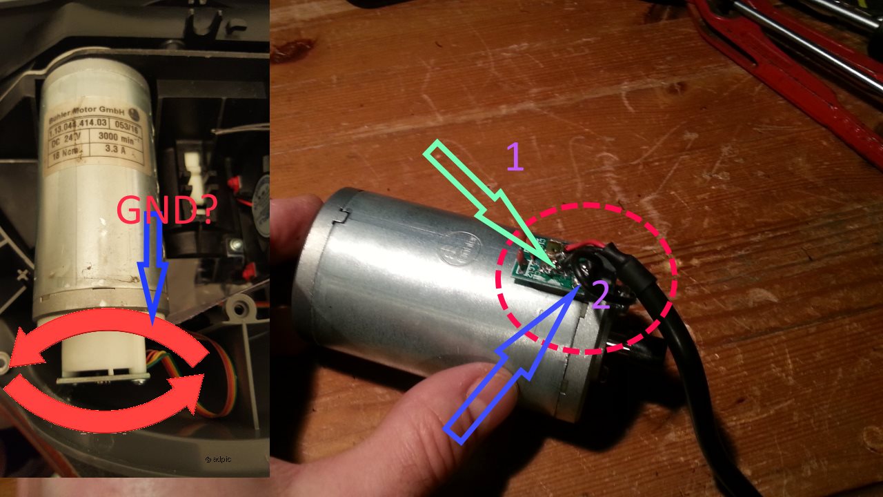

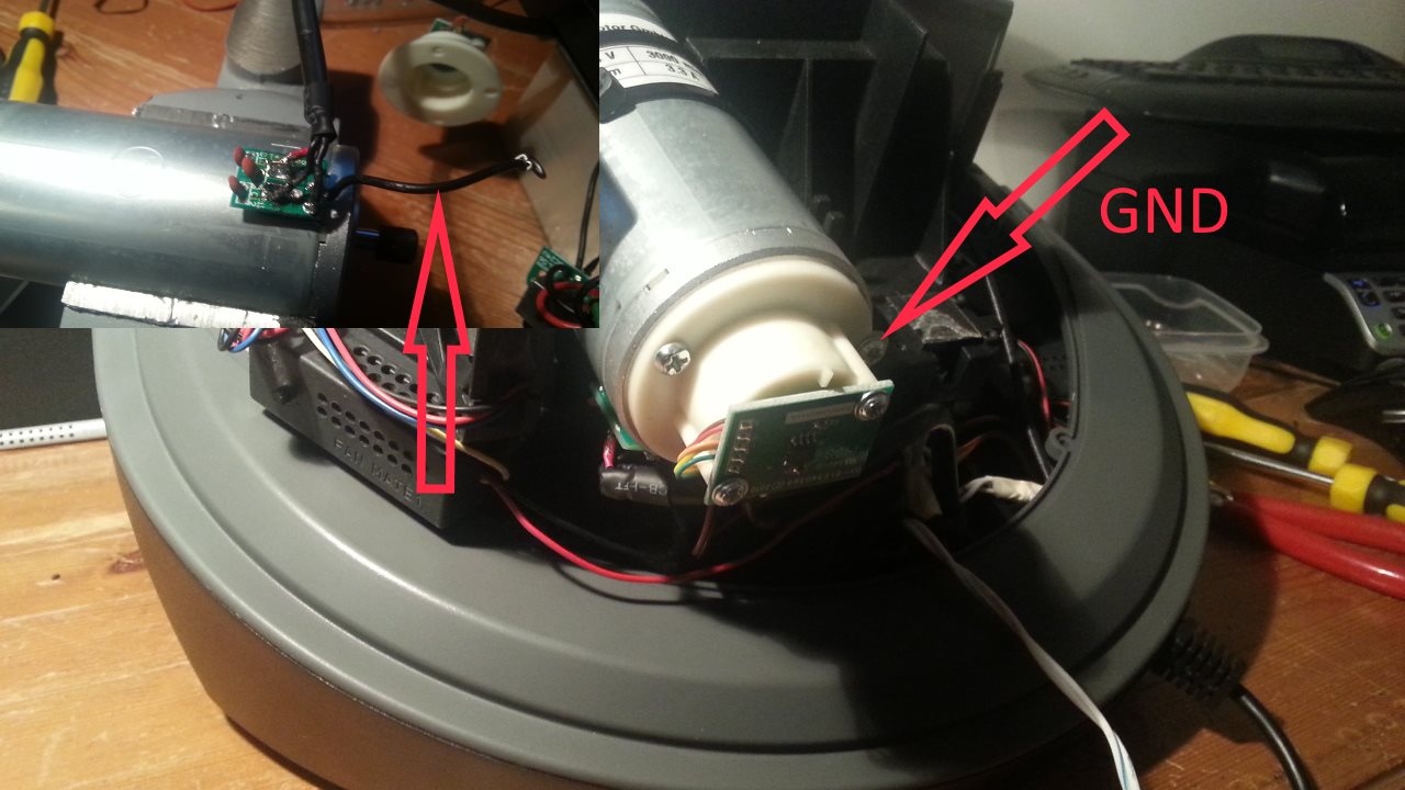

    Hi CHris, first of all I cannot understand why you have cut the wire, the existing wire/cable does the job very well. Second I hope you did not damage the little board stuck on the motor, there are some diodes / transistors which can be damaged easily. Thirdly are you sure about the polarity after replacing the wire to the motors? Last but hopefully least the DY-01E340369 mini board stuck at the back of the motor has to be turned by 180° and IMO you forgot to ground one of the screws of the motors as shown on the second picture.

    ADDENDUM ! ! ! Obviously the DY-01E340369 mini board is correct installed but w/o the GND?

    Thanks so much for your help I am such an idiot I had to replace the wires I stuffed
    them I am going to do what you said tonight thanks heaps.
    Chris Edwards.
    The ground wire I have put on 1 of the 3 screws at the back of Hall sensor holder does
    that matter or not ?

    Thanks so much for your help and diagrams all working now absolutely brilliant so much better feel all round even more power than the fanatec V2 which is way dearer.
