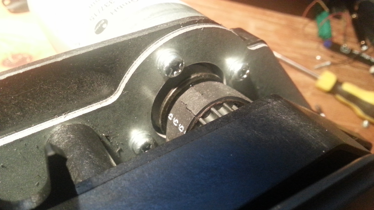

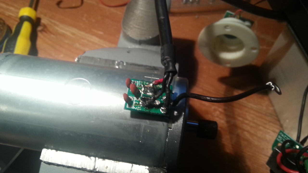

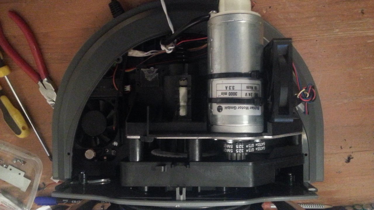

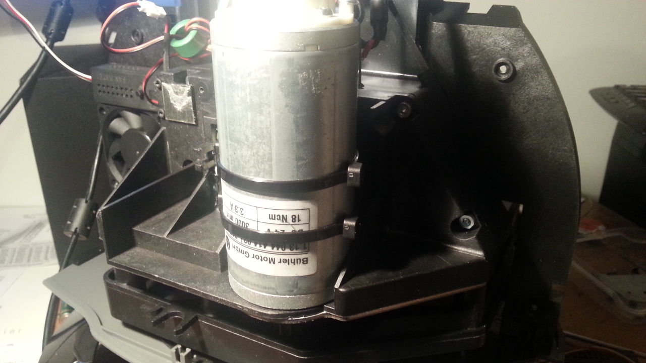

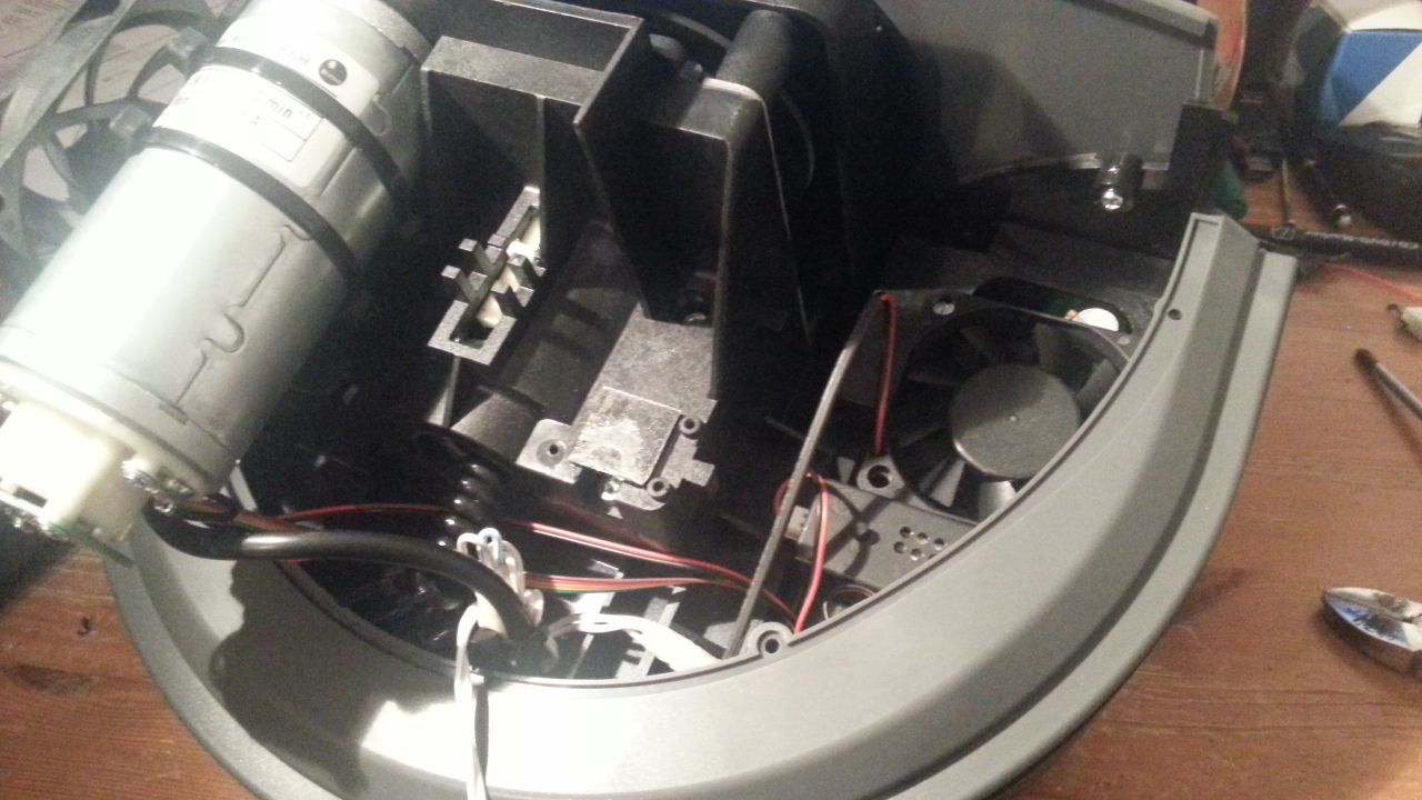

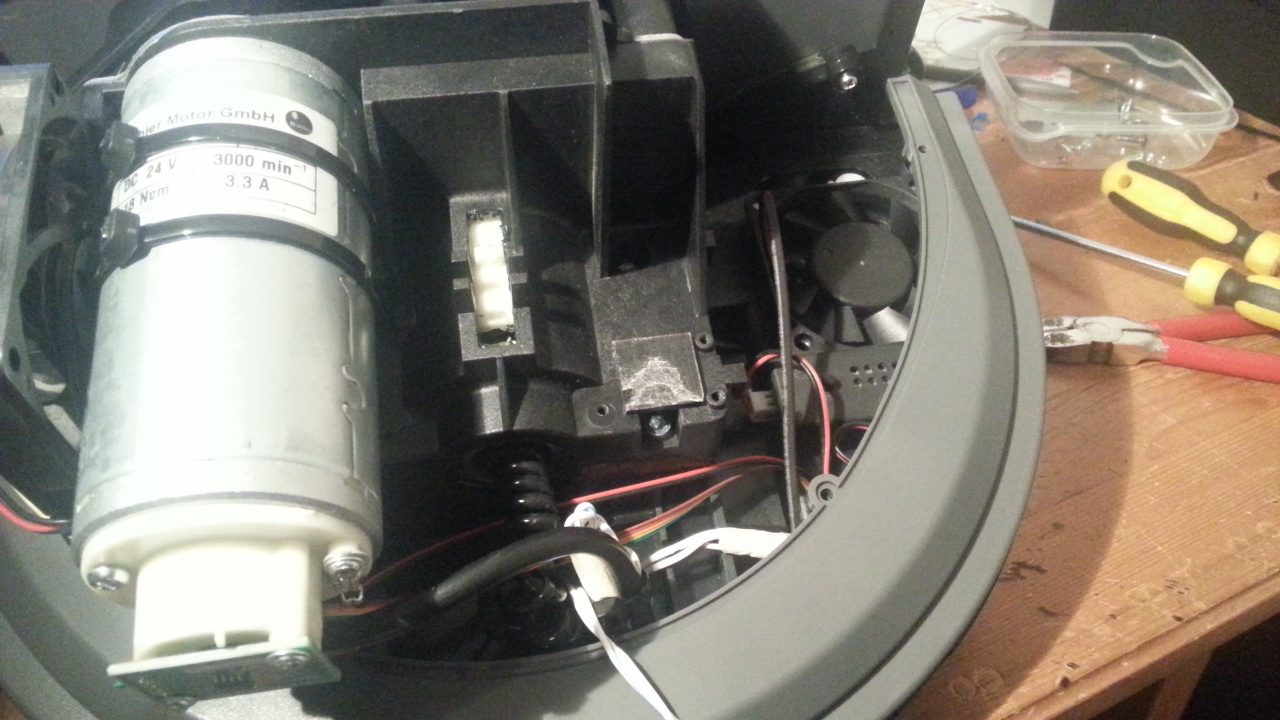

    All assembled - and it works so far. First tests on my office PC are very promising, have now to stick the wheel on the rig. Later this afternoon or latest on Sunday I will upload more information and a video. Until then some pictures from the progress today:

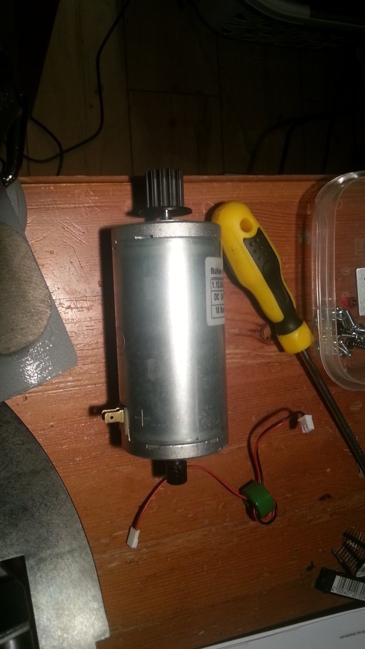

    The pinion was easy to stick using a Bunsen burner (same name in German ;) )
    Soldering the mini board on the motor, was tricky, I had to drill out the old solder before.
    eieiei - what a bother, this is an issue for sure and all T500RS are affected...

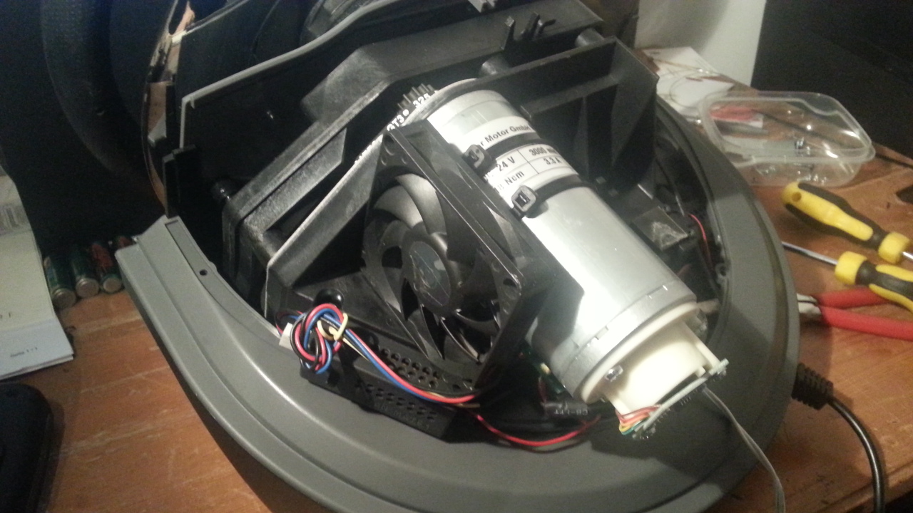

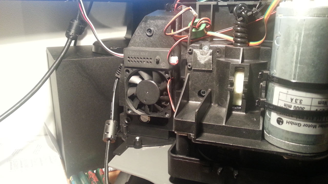

    separate fan for the electric parts
    The thermal sensor is sticked but not needed any more
    An other view
    A bigger fan but low noisy. The original fan is at the right side due to space constrains of the case

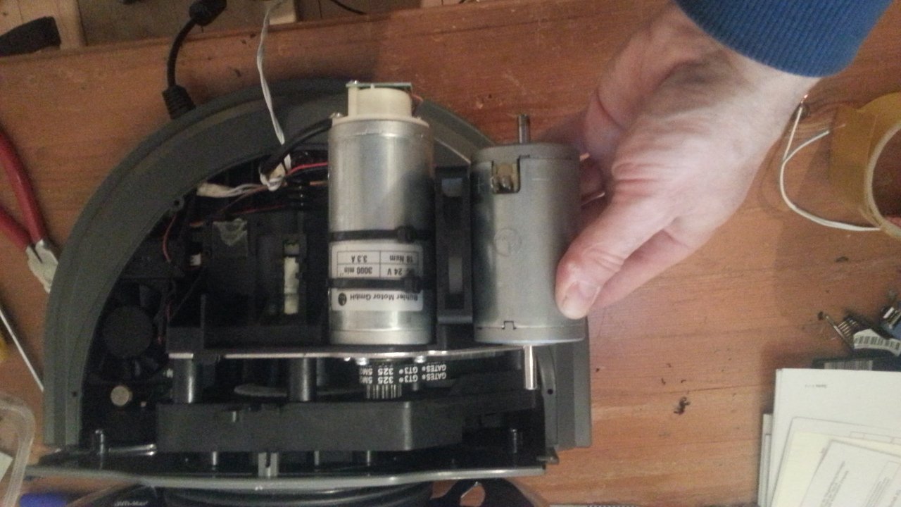

    The old and the new motor again in comparison

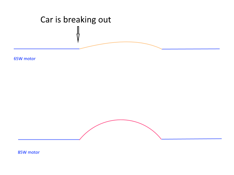

    1. A very new impression is coming from the breaking out of the car in AC - if this happens, the wheel rotates into the opposite directions as usual. Now with the stronger motor the amplitude of the force is significant stronger, short said you feel the breaking out of the car earlier then before which makes the car better to control (one of the big advantages of the DD wheels). braking out.png

    Great interest in your project. As the upgraded motor is quite a bit longer will this prevent the top cover from being re-fitted, or perhaps could be refitted if part of it was removed ?

    I suggest to have a look at http://www.oem.co.uk/, ask there for more information. The cover does not fit anymore, either you drill a hole into the cover or you let it off as I did. IMO better for cooling.
