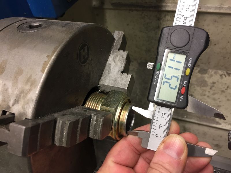

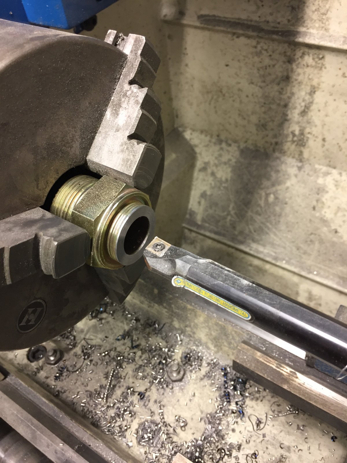

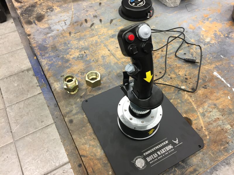

    Hello, wanna show you my first steps for the new sim`s I use.
    After I get my oculus rift last year, my fire burns a second time :)
    ( 18 years ago I also make my own cockpit with pedals ( there are none to buy , no one use this before I think) ...
    and programming some scenery for MS FS98 ...funny ! ! ... how this looks nearly 20 years ago :) :)
    https://web.archive.org/web/20000929044427/http://www.higgy.de/flusi.shtml#top
    Now I want to start a new step incl. motion platform (later) , first is to optimized my joystick , betters ( real ways ) for a good cockpit feeling with oculus rift.

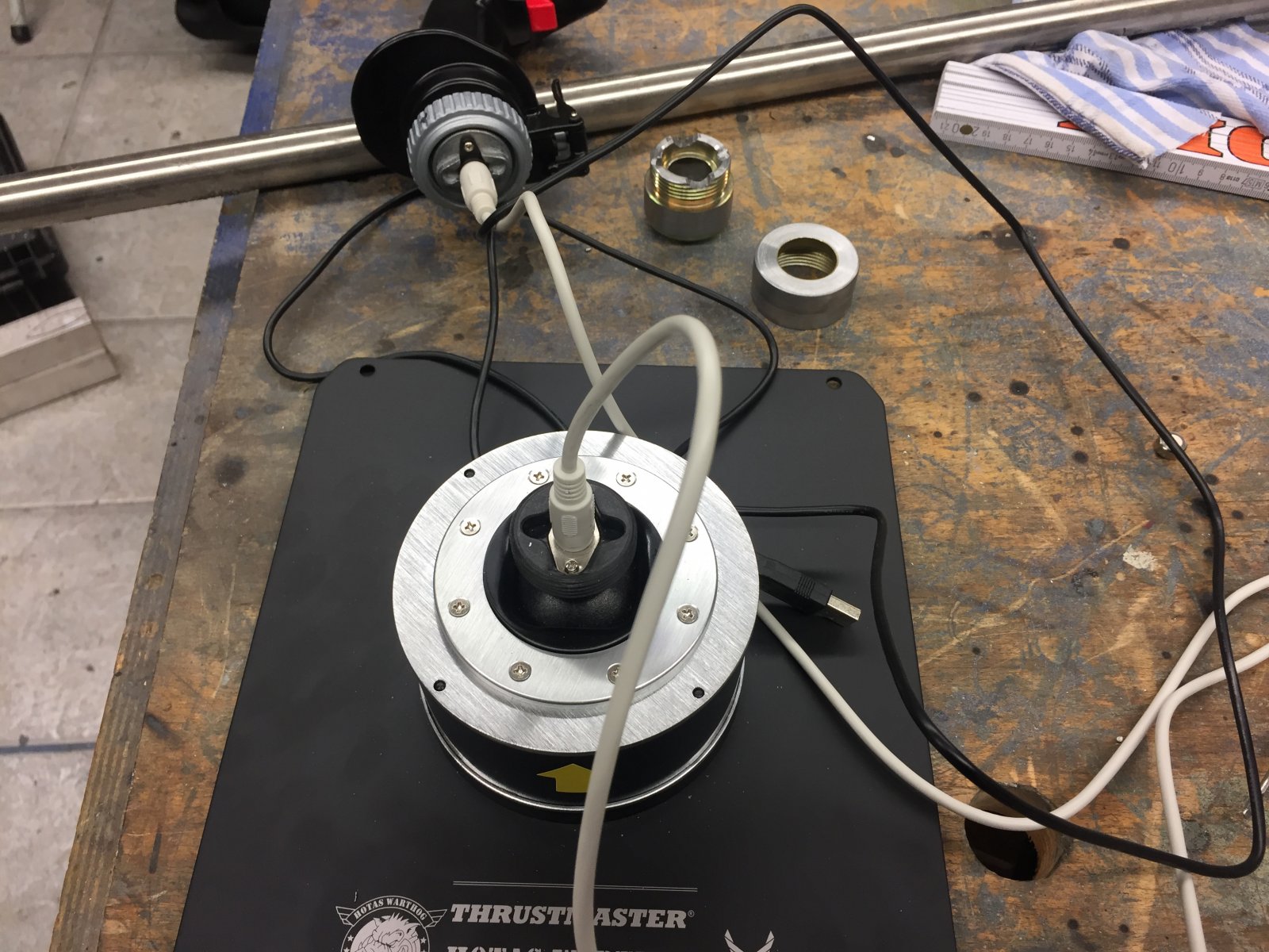

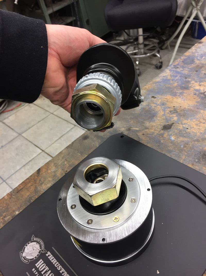

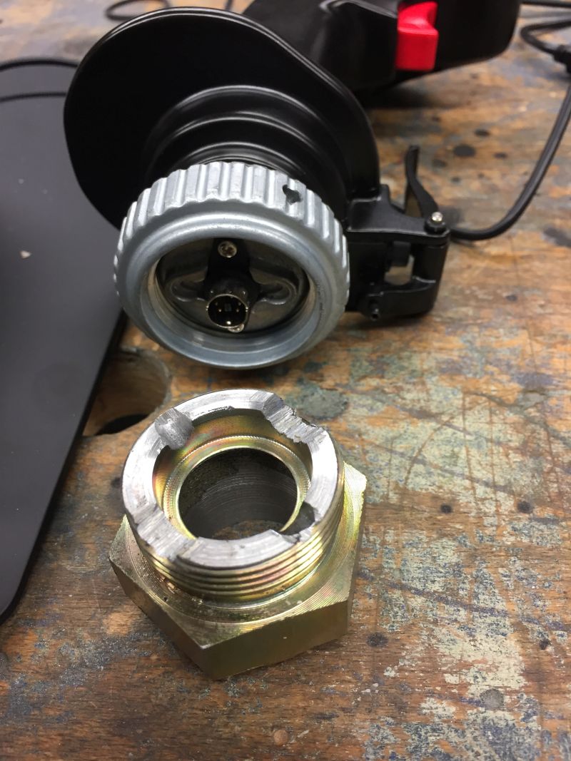

    So I use a hydraulic screw connection , which I found here in my stuff, and change it a little bit . ( M36 x 2 ) You can buy it locally for 5-10 bucks, when you dont have it at home.
    See Pictures.
    Next is to bend a 25x1.5 stainless steel tube and welding it between in the correct lenght for real moving-ways. Keep you informed.
    After this make the platform ( when I know which motors / system (I think DC 800 watt 3DOF moving... ) with seat and everything on it... BFF shaker and holder for collective pitch , rudder pedals and yoke

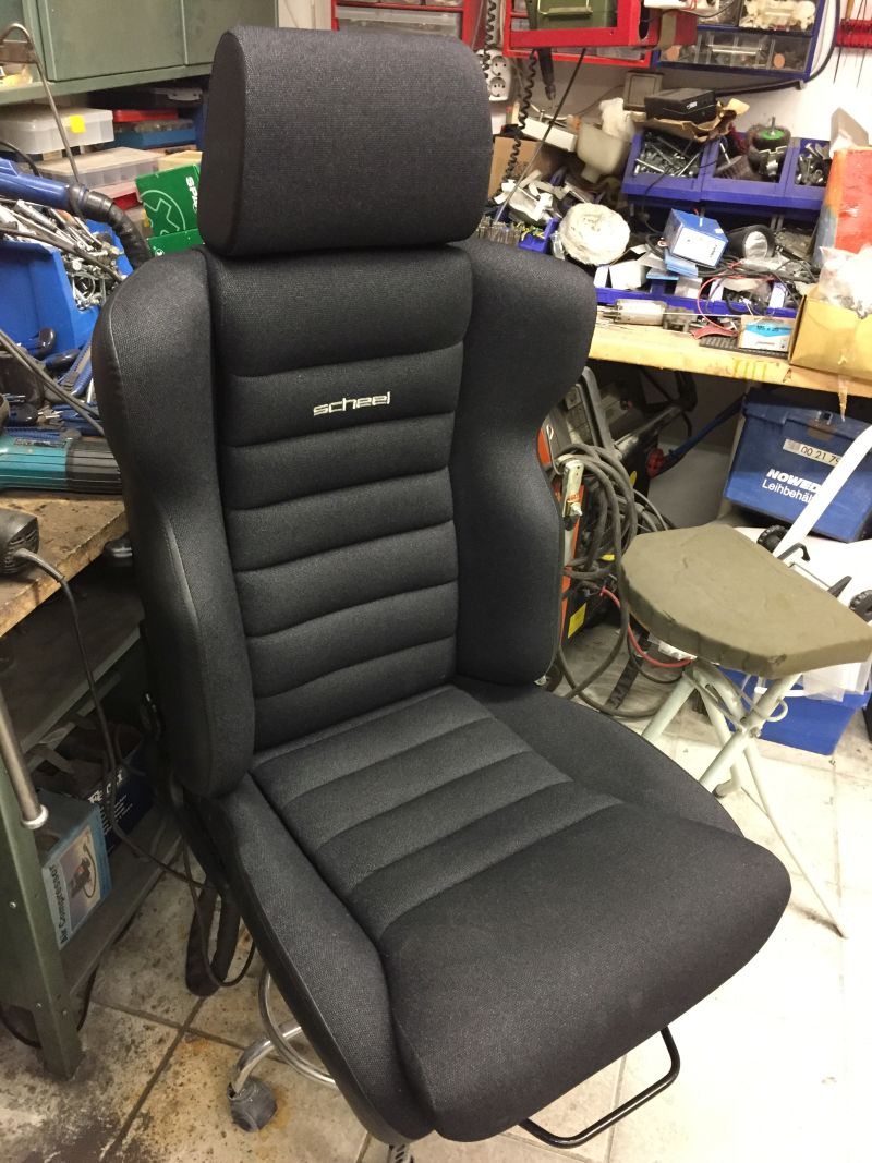

    Here i get a nice seat, also good Feeling when you weight more than 70 kg)
    The seat is not really lightweight :( , but for a really good price 45 € ebay ...

    nice seat
    not lightweight but comfortable

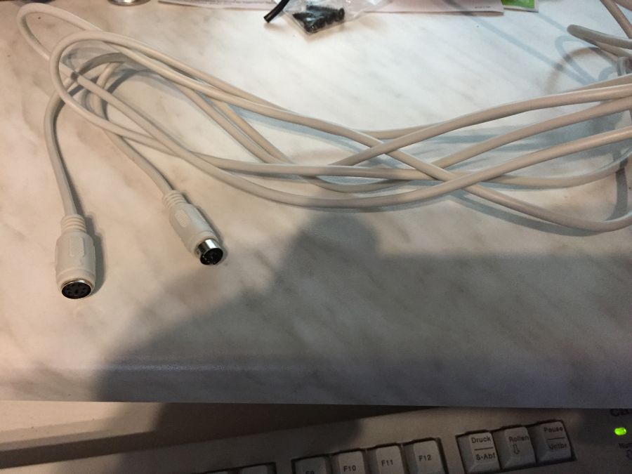

    Your warthog mod is an extension correct? What exact plugs are you using to extend the wiring? I have looked at this myself. The threads are pretty easy (hose threads match up from what I have read) but finding the correct wiring plugs seem to be the difficulty. I have four simpits; one for driving and the other three for flying. A Viper pit (F-16) using a Thrustmaster Cougar HOTAS, an F/A-18C using a Warthog and an A-10C also using a warthog. I have thought about adding extensions to both of the warthog pits. My pits are actually modular, one base with removable sides and center. Conversion take about 5 minutes.

    Hello, yes, i want to use a keyboard PS2 kabel extension, you can buy it for 2 euro for 2m ( had to cut it and sold it in your matching lenght)
    in a computer store or online.

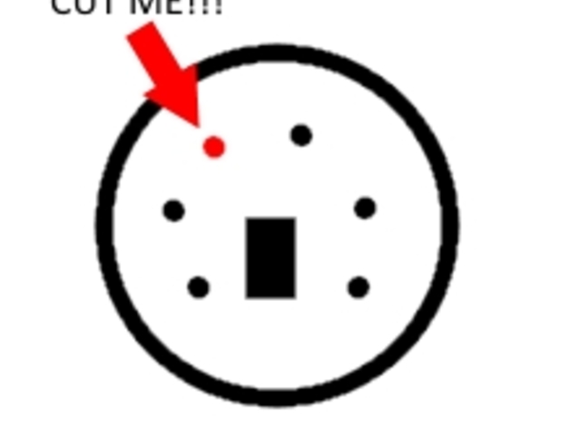

    I read several pages, there they show there is one connector pin which you had to cut off ... so easy to do.

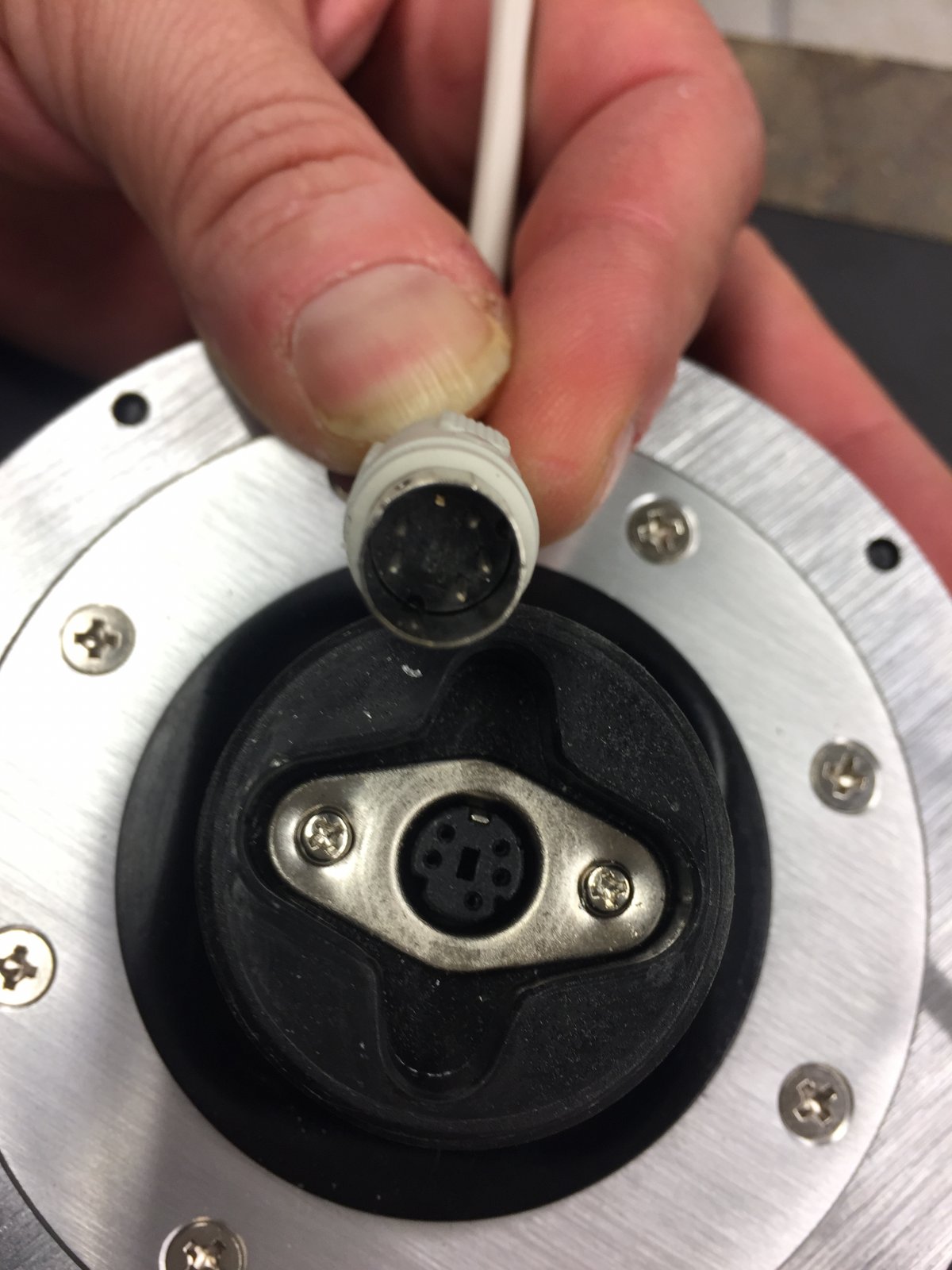

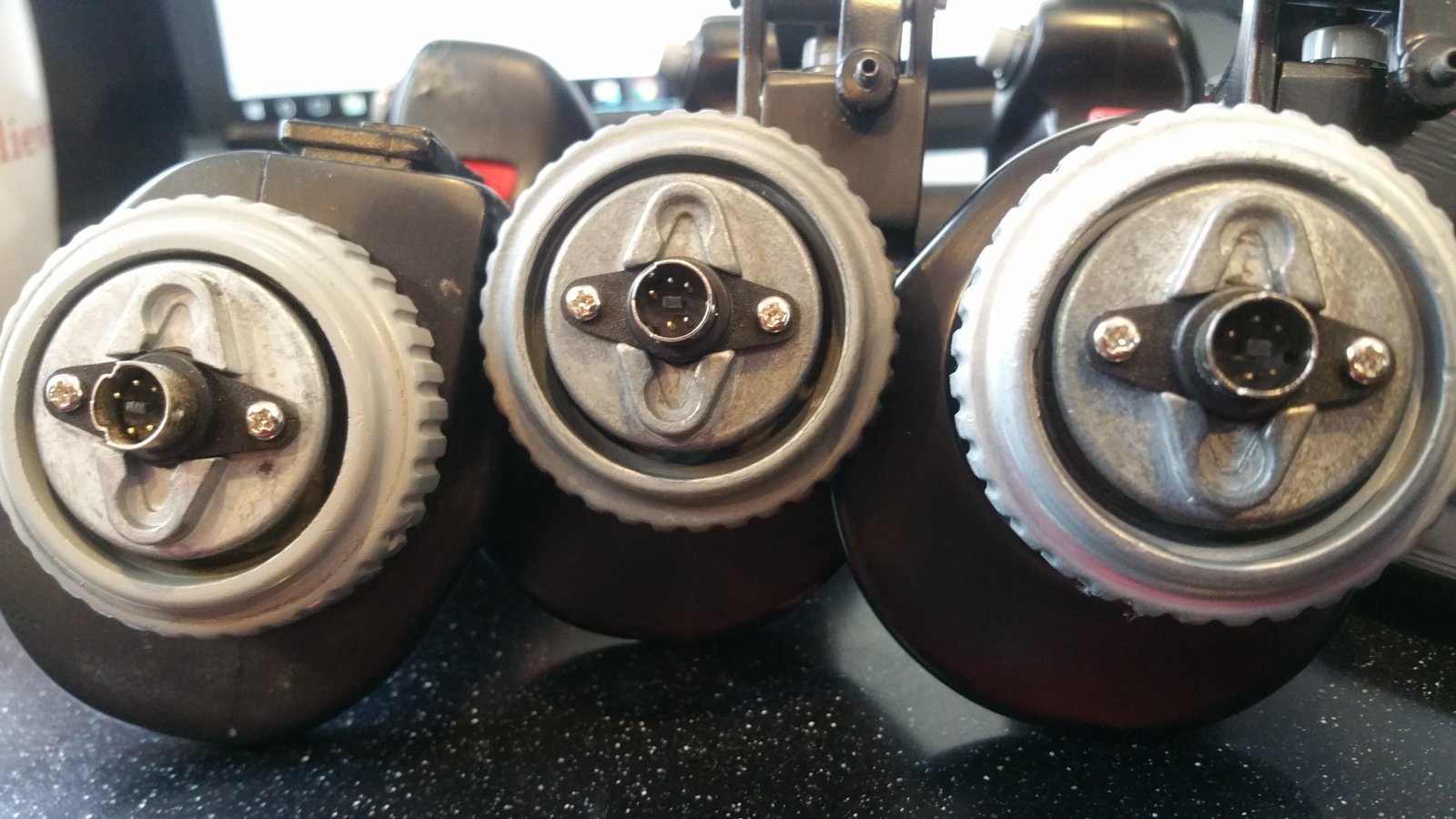

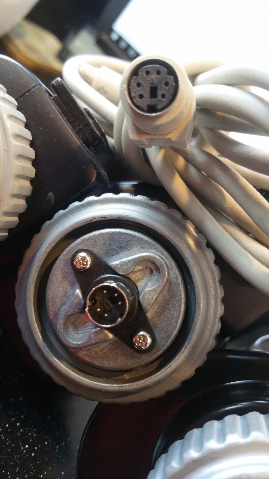

    I have several PS2 extensions but the plugs are slightly different. Have you test fit yours to verify?

    no, because i have to bend my stainless steel tube ...tomorrow i think i have it and after this i can cut the ps2 cable for the right lenght and cut of the pin ( like in the link before ) and test it :)

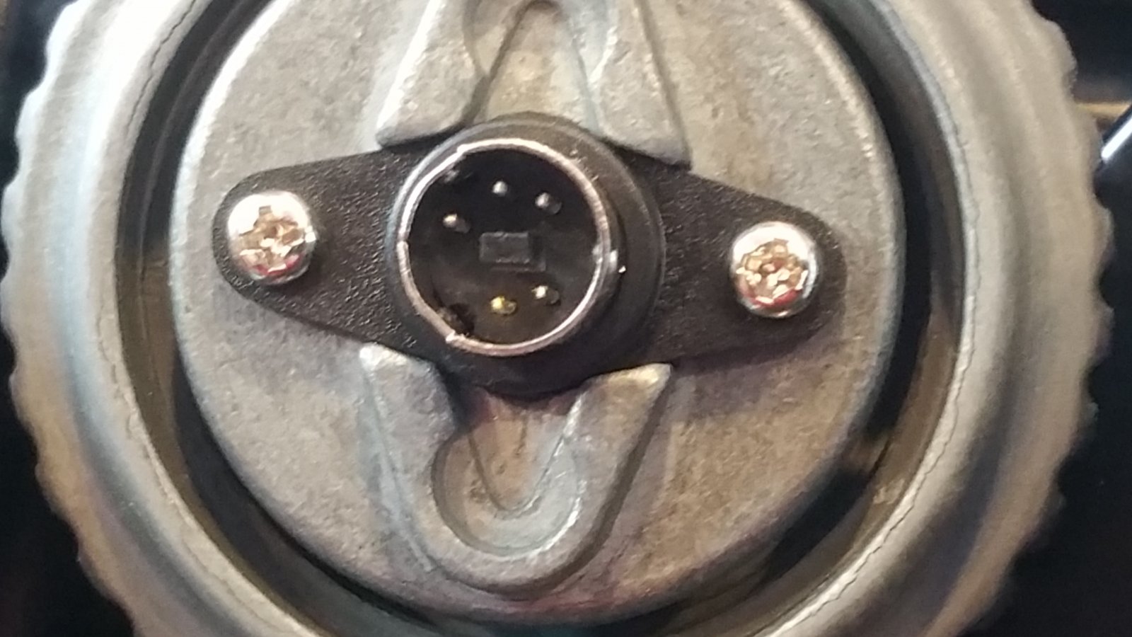

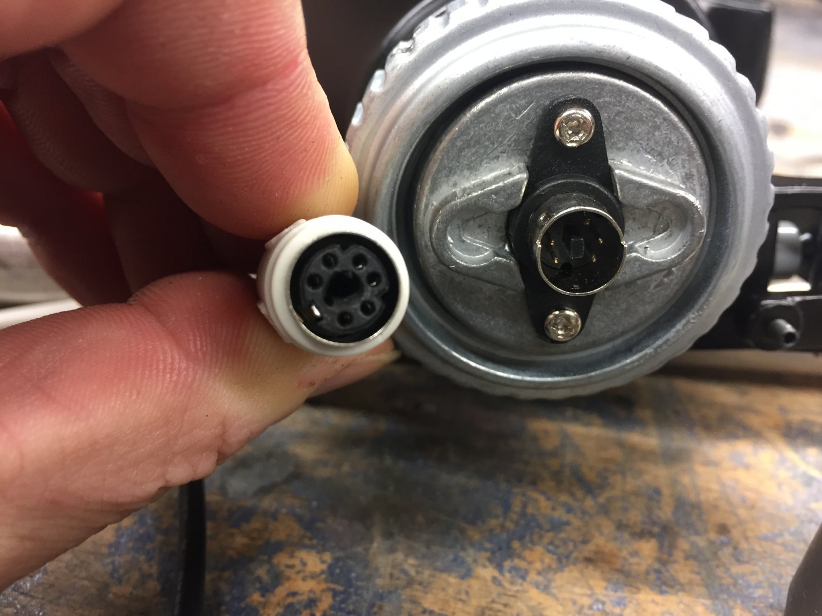

    Here are my sticks showing the type of plug and an added picture of a PS2 extension. The guide for the plug is in the middle for the sticks and closer to one side for the extension. You could of course either brake off the guide on the stick or drill out the center of the extension (preferred) but the pins themselves look to be slightly different as well (location).

    thanks for pictures ... today im not in my workshop, will check it
    tomorrow and write it here, but the Pins looks good, they dont look 100 % differently ?
    So i think it could be possible :)

    They look pretty close, I would try drilling out the extension plug. Would hate to alter my sticks though. I had just hoped that you knew of the exact model/style of the correct plug.

    yes, me also, dont want to Change in the Joystick, change cable is better :) :) i think this is no "standart cable" you can buy everywhere ...

    If you want to mod a plug then you need a PS/2 Extension Cable and cut 1 pin off its male side:

    The correct plugs are linked above :)

    Don't get the wiring wrong or you will have to bin your very expensive Warthog ;)

    no Problem for me with the cable
    1 min work :)

    Biggest problem is to fix the position, that the bendet "turn"
    is really in front and the grip-handle is ( forever) in the right Position ...
    with a straight extension no problem ...just have a little bit to think about it :)
    For the handle is no Problem, because ist a fixed Position, but not for the base screw ...
