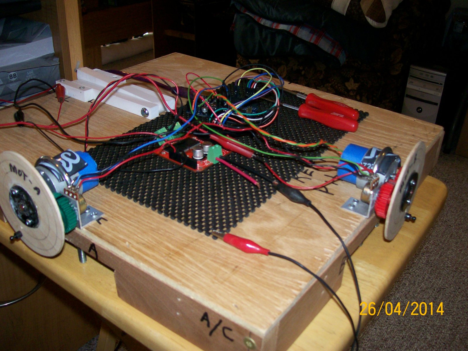

    Question! How do you invert the axis and what do I need to do to get "MORE" movement on my motors? (CW / CCW)

    Right now I am getting about 20 to 25 degrees of angle both ways. That probably is ok but I was looking for about 40 to 45 degrees both ways. I tried the uncheck and checked box in sims tools( Axes assignments) roll and pitch to see if that would work however nothing changed. Now keep in mind that I am checking this using the mouse in the Quick Start Guide under Checking the direction of movements. I wanted to make sure all was working before I download a Game Plugin. I will change my default like you said before I check it again. Thank You

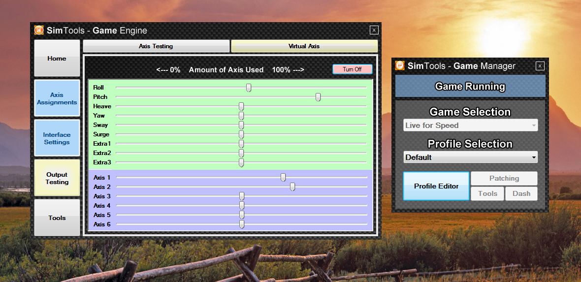

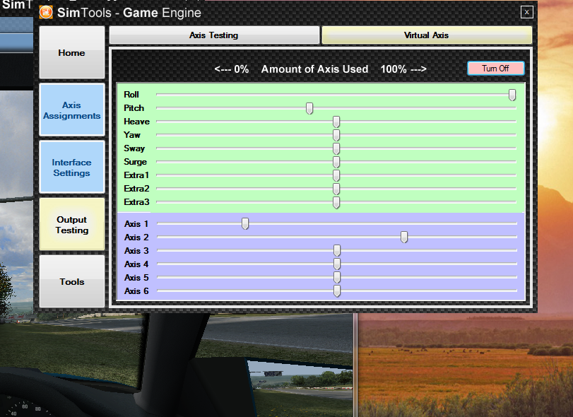

    I ran the game (LFS) with no power applied to see the movement on the virtual axis screen in Sims Tools and this is what I have. How do I get the sliders to the center position, and I tried to change dir by clicking in axis assignments but when I run the game the roll (left/right) is reversed.

    Hi Terry, you cannot manipulate the sliders on that page. They are only there to give you a graphical representation of what information the game is sending to simtools and where simtools is sending the axis. Great tool for tuning your rig.
    If you want to adjust the forces for each DoF while in game you can use the profile editor in game manager or adjust the min/max in tuning center.
    EDIT: The sliders represent the orientation of the car in the game at that moment. So the car is probably on a hill/incline. Not at all unusual for LFS as the track that you can use in the demo starts out on a hill side.

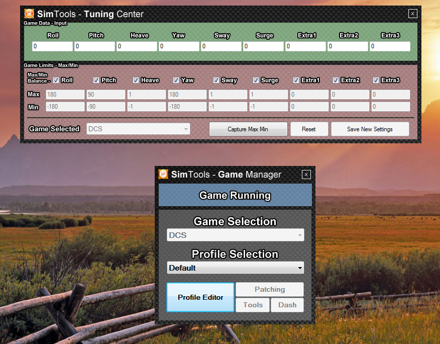

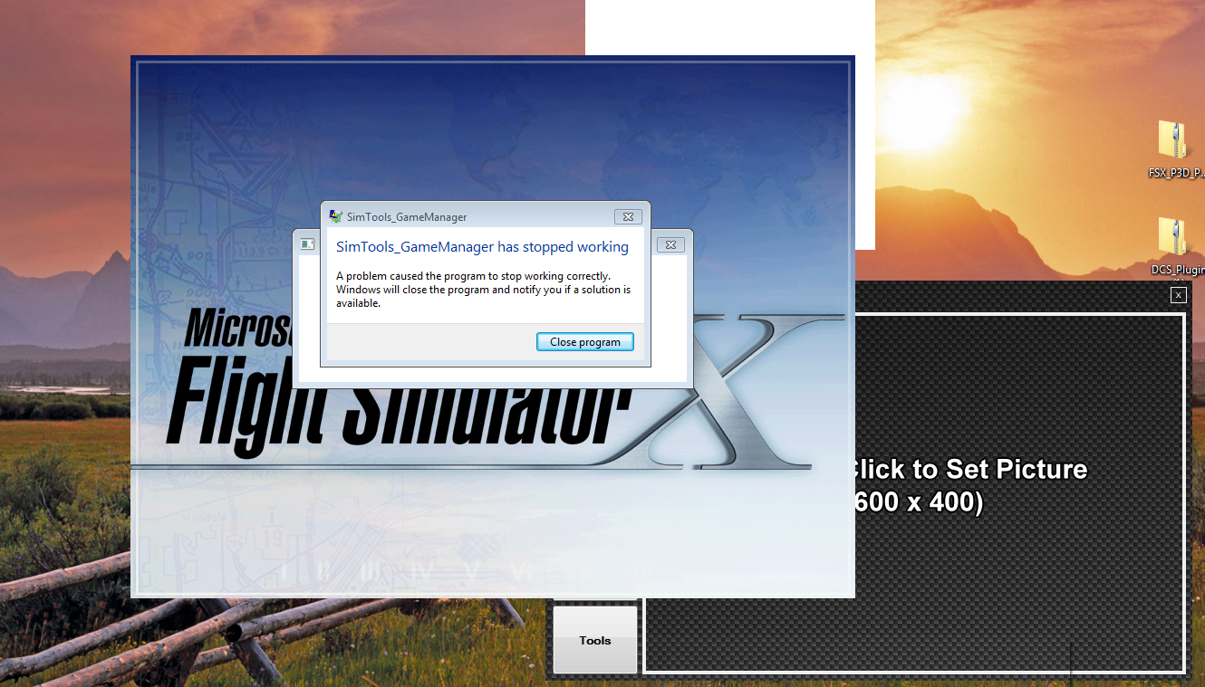

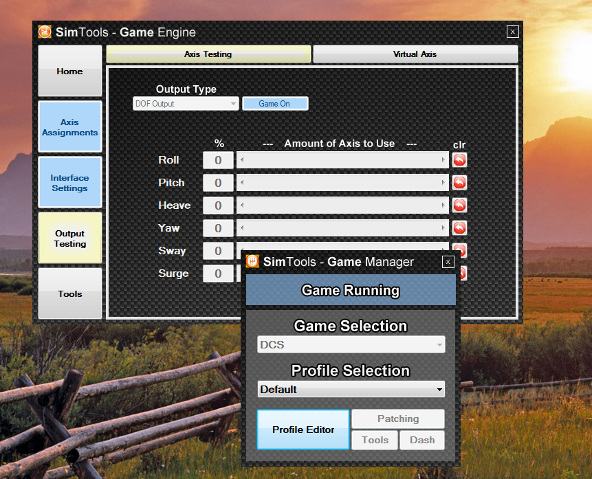

    I have a problem, I downloaded the game plugins today and tried my proto type platform. With DCS the game shows game connected (blue) on the game manager and on the game engine, but there is no movement on the platform what so ever. With FSX I get an error message, is shutting down. With LFS it is working, but I need to tweak some things to make the platform move in the direction of my joy stick. Why will it not work in the game plugins?

    i don't know if you already tried , run it as an administrator.

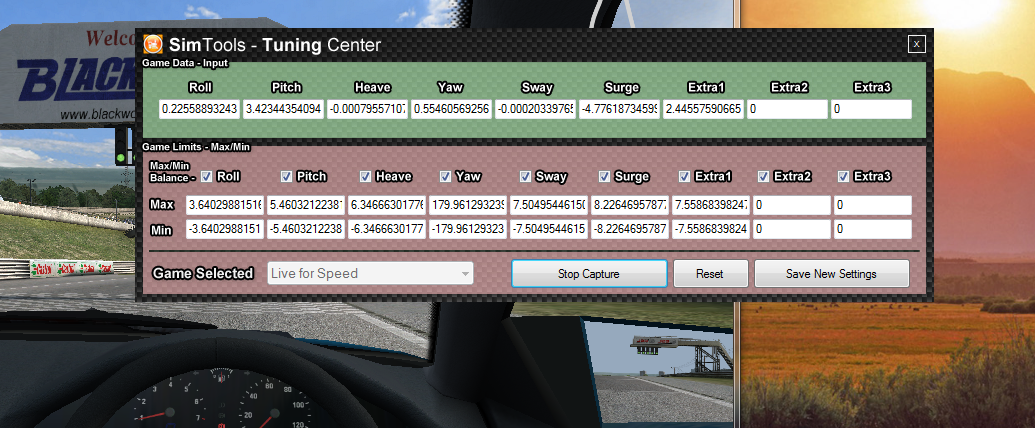

    I copied the file into sim tools and FSX seems to be working however I do need to a lot of tweaking because there is hardly no movement to my platform when moving my joy stick" but" it is working. I have input and output in the tuning center. Now as for DCS I am getting nothing. I have everything setup the same for FSX and DCS. what can I do to make this work? Terry W.

    Hi @terry wells, the values shown in the Tuning Centre are too high. The lower the value, the more intense the motion.
    Try reducing the values to 20 and go down from there until you have the amount of movement you want.

    The only numbers/values that I can change in the tuning center are the game data input and they are all "0". What numbers/values should I lower? OK I figured it out, I can change the values however the game is not getting any input into the tuning center. I did a repatch but that did not work
