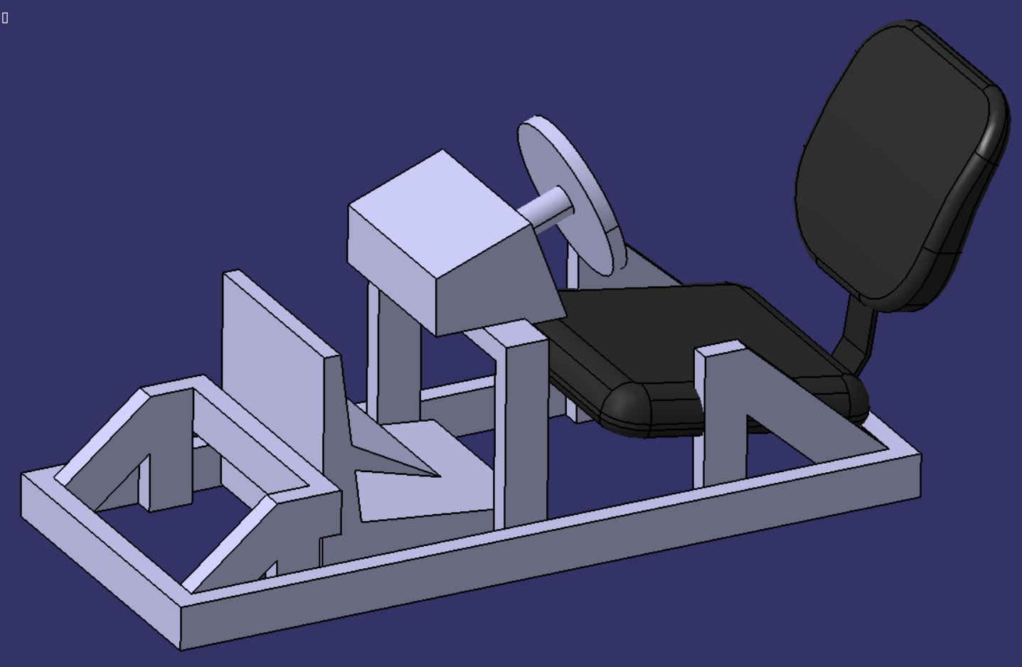

    The first edition was just made with scrap lumber my parents had sitting around and cost a grand total of something like $5 for the few bolts I didn't have to mount the wheel and pedals. I used a karting seat I had sitting around and eventually added some Aura bass shakers to add a little more immersion. It was likely way overbuilt from a strength standpoint and was hard to get in and out of, but worked great. I pulled the general dimensions from my car (a 2004 Viper), so it actually felt pretty natural when seated (first attachment below, shows the wrong kind of seat, but I don't have a model of my kart seat).
    It was fairly unwieldy though and hard to move around and fit through doors, so I later cut off the pedal portion and revised it where it could slide backward between the main outside rails toward the seat. I also removed some of the extra bracing as I thought it was a bit overkill.

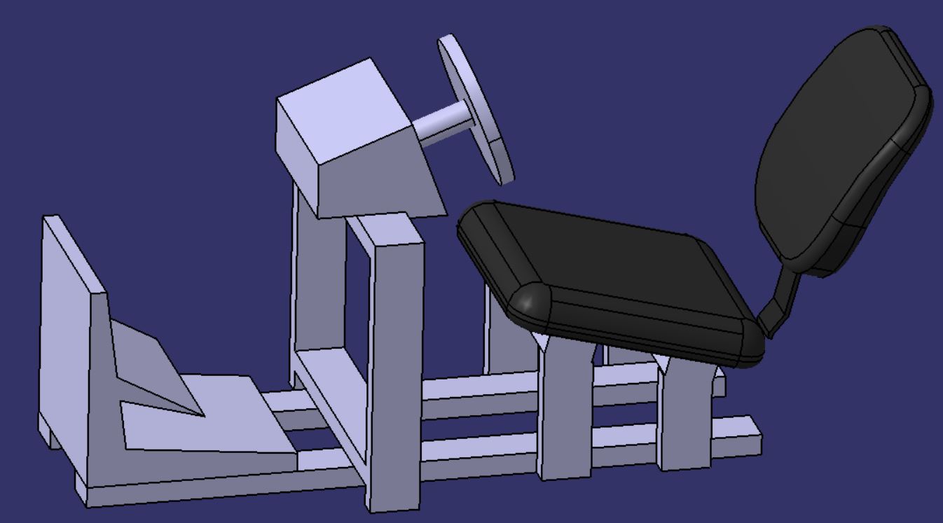

    Then I stumbled on the DOF Reality website and got to thinking about the design some more. My wife also complained that it was hard to get in and out of the few times she tried it, and I didn't disagree one bit, so I worked up a new design that was more of a central spine (the idea I got from the DOF Reality design). I also switched to an old office chair as a seat as it is way easier to get in and out of, more comfortable, and accepts drivers of various sizes much easier. The wheel "hoop" is a bit flimsy, but works fine for the wheel I have and otherwise feels pretty solid (next attachment).

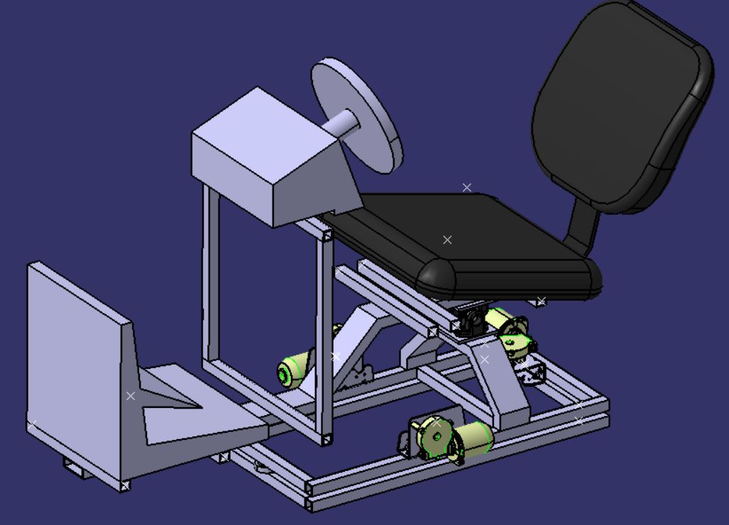

    Having found the DOF Reality website, I was really considering just going the commercial "plug and play" route, but there were a few things that kept hanging me up. Initially I wasn't sure if I wanted to go the full 6 DOF route, but the more I read on it the more I think a 2 DOF with traction loss probably made more sense for me with the VR setup. That being said, seeing as I already a handful of motors, that was another reason I was hesitant to buy "more", even though the commercial ones might be a bit better suited for it (mine are plastic gears and maybe a touch slow). I also don't know that I was a huge fan of the Arduino and MM setup. It's a bit ironic since I consider myself the tinkerer and like to have a lot of control over stuff, but the failure rate of MM cards put me off a bit and I really like the idea of JRKs better, though that added to the cost. That led to the next design I had put together, which is basically a DOF Reality clone, but using the motors I have already and maybe a tweak here and there based on some ideas I had.

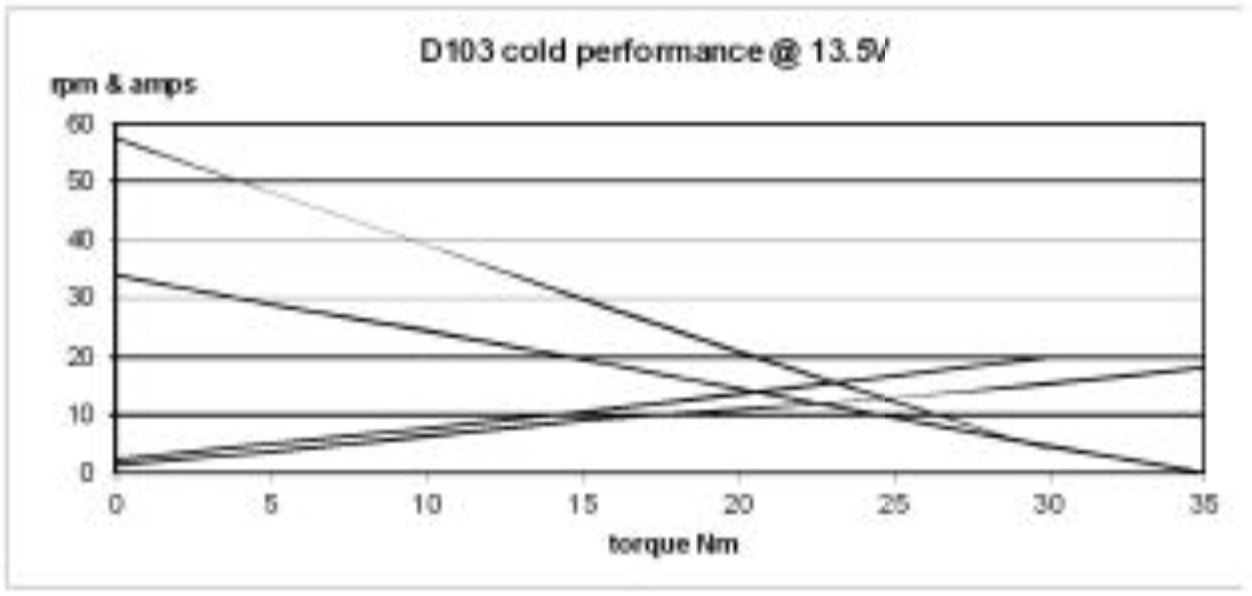

    So this leads me to my main questions. I think my motors are up to the task. They are ~35 Nm stall torque and 60 rpm unloaded speed (see curve below). The two lines are for the two different speeds, so basically ignore the bottom line in each pair. One line is amp draw per torque, the other is rpm per torque. They cap out around 20 amps, so should be well within the capabilities of a JRK and it puts them around 240W each. Lever arms are going to be a bit trickier as they are a tapered splined shaft, so not as easy to make new arms and the ones already on them are pretty short (~1 inch). I might just take the existing arms off, cut off just the tapered end, and weld a longer section to that as I need the offset kink to clear hardware.
    The layout I have uses 1.5" CTC arms and gives around 7.5 degrees of front to back tilt and ~8.5 degrees of side to side with my current estimated pivot points. They are about 8" forward of the pivot point and roughly 7" to the side of the pivot. I've estimated the top frame weight with me at around 270 lbs, which should give some overhead for either a heavier driver or faster movements to return from full tilt. Do those numbers sound reasonable to people? The frame is mostly 1" x 1" x 0.085" square tube with the center spine being 1" x 3" x 0.120". The same goes for the bottom sections. I did some very simple FEA work on it and it appears to be fairly safely within the yield limit of the metal for sure and hopefully also under fatigue limit.

    I had looked at SimCalc some, though I'm not sure it plays with my setup quite as friendly. It seems more built around the shoulder mount actuators as I'm not getting any roll response out of it when I try to put in my values. It does give me forces though, and I think they seem to line up with what I was expecting.

    Use the Sim Geometry tab in SimCalc to match the design you have in mind.

    So I just opened and ran SimCalc again and it worked, so I must have put in some number wrong or misinterpreted some measurement before. Have also tried running a simulation on some dynamic motion software (ADAMS if anyone is interested). It's easy enough to build a generic model with main linkage and pivot points, but I'm not super confident on incorporating a motor in the software. I have something in there now with the speed and torque curve I have to try to better understand the motion of the platform through the whole travel range, but I think the motor controllers themselves play a big part in it and that's not something I have any experience trying to simulate.
    So basically I can run a simulation with my motor properties from a starting static position, but it will just ramp the motors up to their max rpm and keep going. I'm not the most experienced user with the software either, but I don't think I can necessarily make a stopping point, I just limit the simulation time frame to the angle sweep on the motor arms that I'm interested in. The reality is a PID controller is going to target a set angle movement and will ramp the motors up and down accordingly to reach it and even reverse torque on them to hold the position. I think ADAMS actually has the ability to simulate control systems, but that's way over my head at this point.
    Long story short, for a random interesting number of the day, it takes my motors approximately 0.12 seconds to hit max rpm when doing a full side tilt from the static zero position. The platform starts off with 0 deg/s movement and ramps up to just under 70 deg/s. Not sure if any of this is useful or relevant, but I find it a bit interesting at least. It at least helps reinforce the fact that max speed and torque of motors really doesn't tell the whole story.
