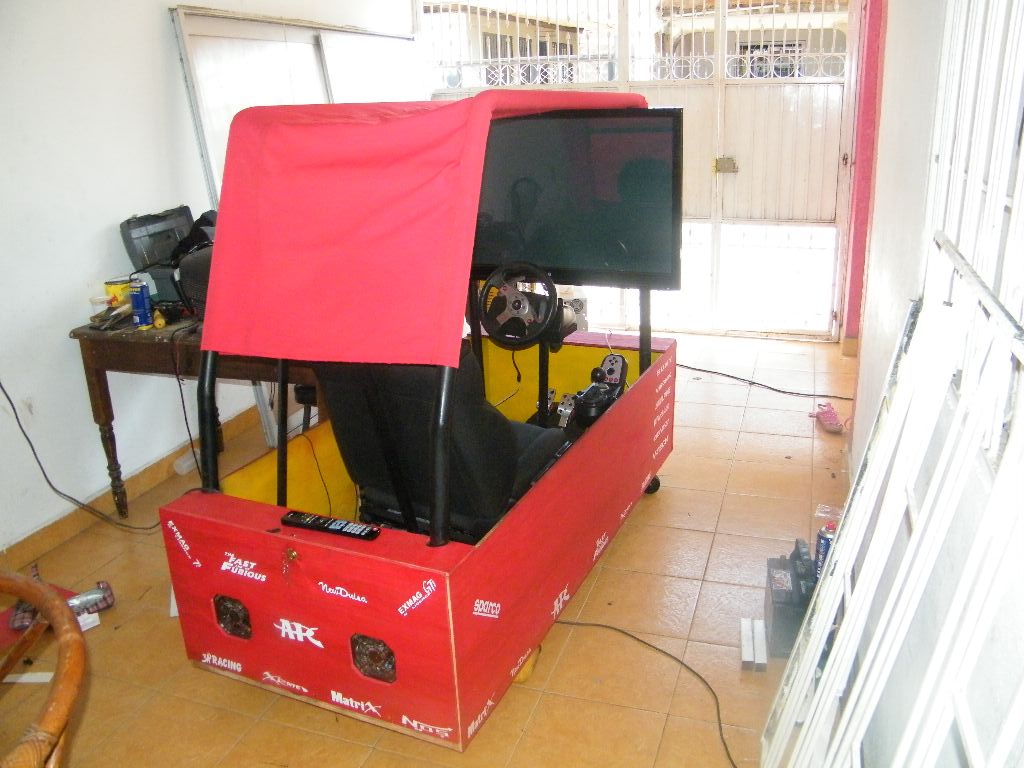

    Hello to all the community!
    This is the second simulator that I built, I did not post the first one because my PC does not pass through customs on the way to my new home here in Mexico but, I promise to publish it as soon as the recovery. 8)
    My hardware:
    PC:
    965 x4 Phenom 3.4 GHz
    4 Gb Ddr Ram Ghz March 1333
    Monster Power 800w
    Nvidia GeForce GTS250
    Gigabyte Ga-M68m-S2 Socket Am3
    Parts and accessories
    Toyota Corolla Seat
    Logitech g25 with some modifications made by me
    LG Full HD Display 42
    Analog handbrake
    E-Dimencional glasses
    Motion control:
    85 w 2 wiper motors
    Dual Motor Driver Carrier MD03A VNH2SP30
    Pololu Micro Serial Servo Controller
    4 Power HD Micro Servo HD-1800A
    Monster Power 800w atx
    I've used a single PC for both the game to control.

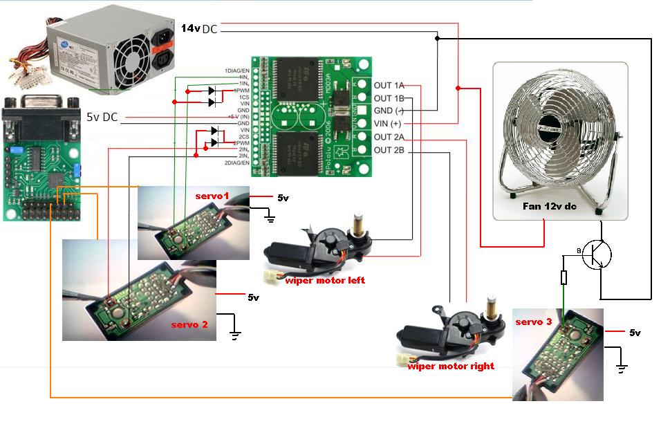

    Here is the simple diagram:

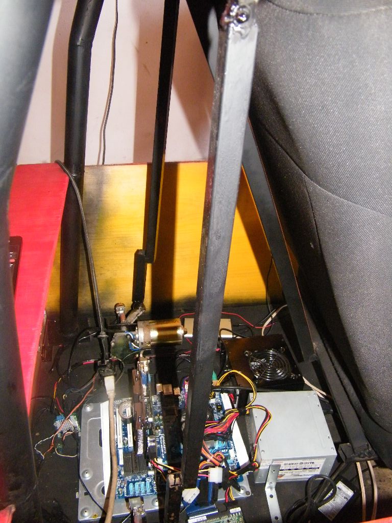

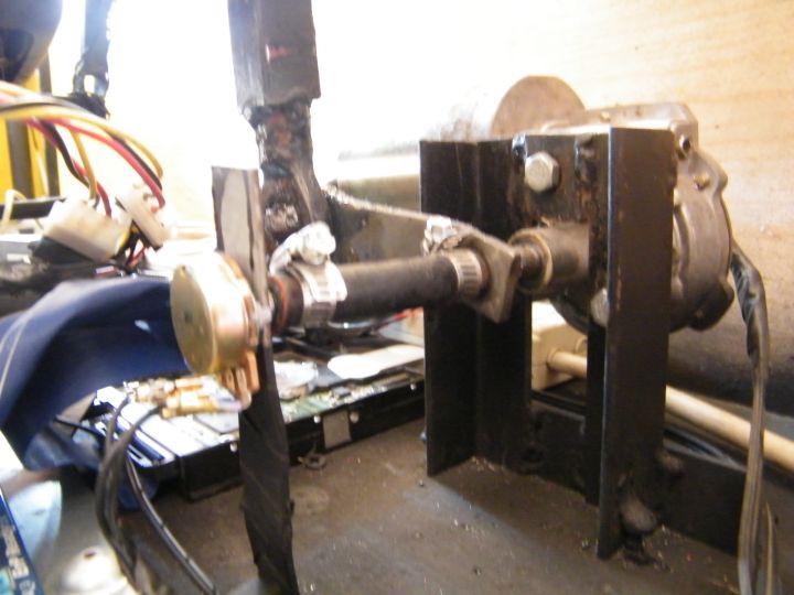

    Works simple, the X-SIM software is compatible with RS-232 interface, then connect the servo controller through the serial port and servos to this and should move with the correct configuration in PROFILER. Disarmed after the servos to extract the PMW signals that will be amplified by the motor controller VNH2SP30 and sent to the wiper motor, and just stay attach the pots to the motors.

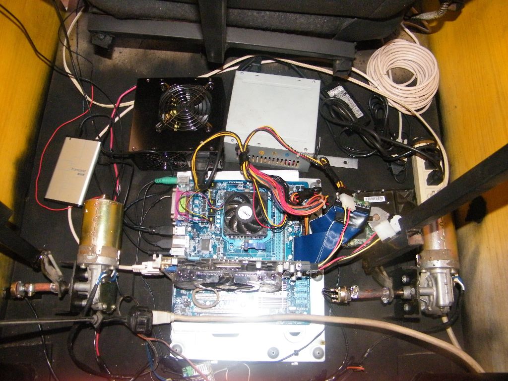

    I've used a 800w ATX power supply, 80A on the 12V output according to the brochures and I made some internal changes, including:
    * Cancel the protection against over voltage.
    * Raise the tension of 12v to 14v.
    * regulated the output of 14 volts.
    Typically these sources only regulate the 5v voltage by the error amplifier within the IC then, we must send the same intention but since the ouput of 12v, so when the voltage drop will increase the output IC to replace the voltage drop, We do this with a pot and turn the shaft to get about 14 or 13 volts regulated.
    In this source power vast with remove the leg of the IC shoot protection according to its data-sheet number 4
    This will be different for each power supply according to its inner workings.

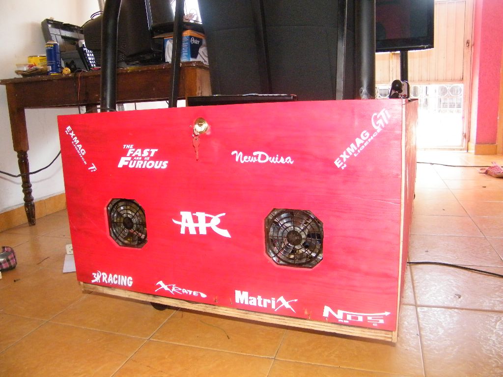

    As for the simulation of the wind, it creates another axis with the values of the wind and used the output of the other servo PMW placing the pot in a stable position and taking advantage of the margin of error for controlling the fans. A very inusuable to do but gives very good results.

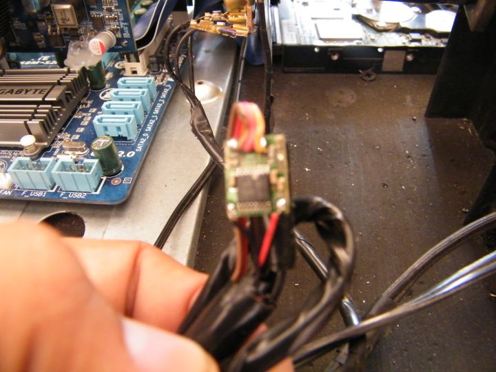

    Good job! But where do you take the feedback for positioning? And how does that board convert RC signals to PWM?

    I saw the pots in one of his pics. Looks like regular motor shaft mounting, so ... :)
  6. theboemio
    theboemio New Member
    Feb 5, 2010
    24
    1Coins
    disassemble the servo motors, I replaced the original Pots for a few pots of equal value and connect the outputs of small motor to pins INA and INB of Pololu motor controller for feeding direction of the motors and pull them into the input pin PMW with diodes to prevent a short circuit, so only receive the PWM signals. :hi:

    So you are using the circuit from RC servos for position control... That is very smart! I never thought about that. :D
