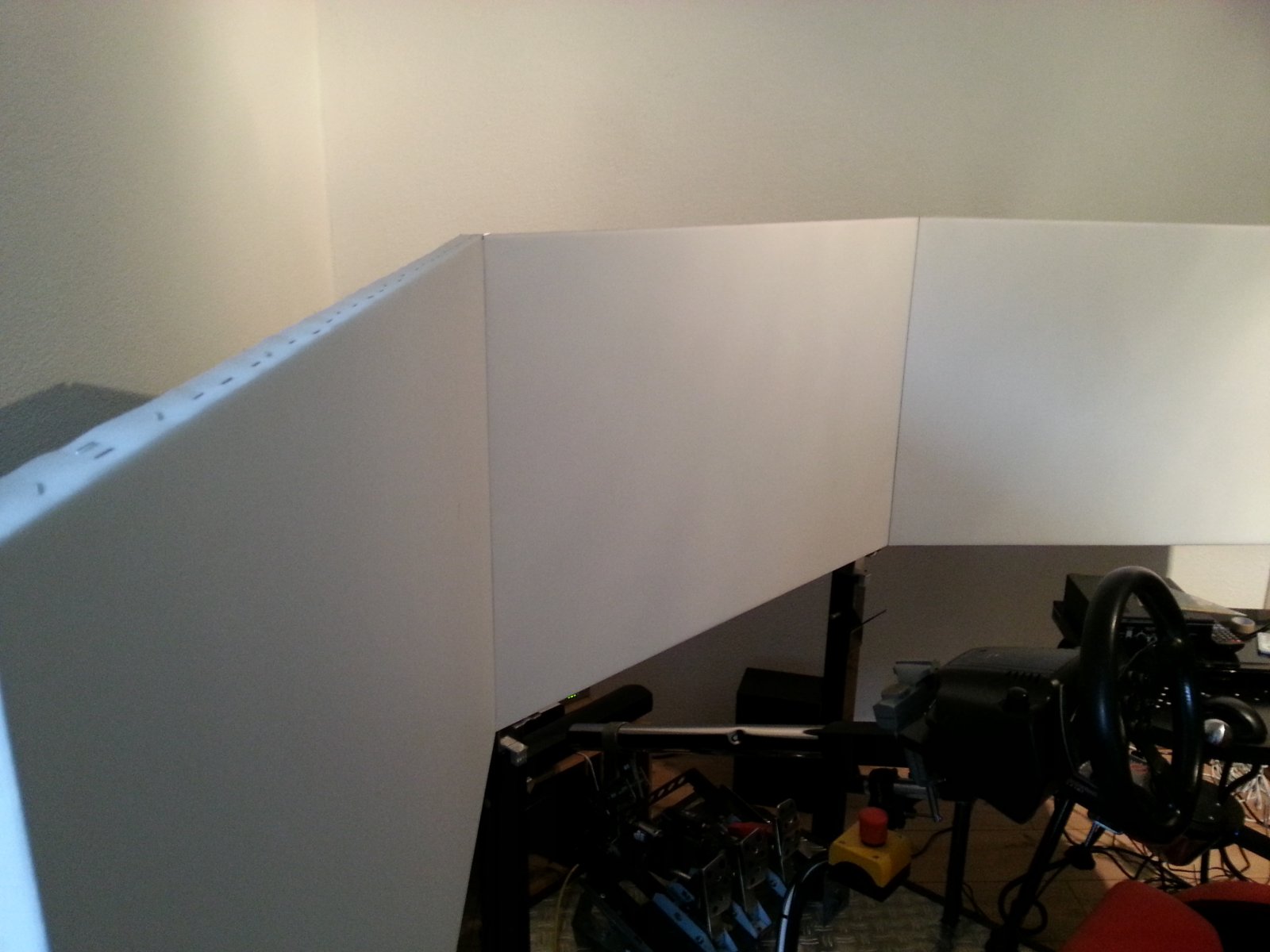

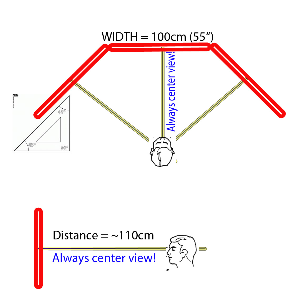

    Hi guys I want to share my experience and feelings about the view point, angels and position of the head between the screens.
    IMO to get the best reality I spend some bucks buying three LED projectors to avoid any bars from any LED screens. One screen correlates a 55" display (width = 100cm = 3.28 feet). The view distance is ~110cm (3.6 feet).
    The view to the middle screen always must be centered (vertical and horizontal)
    3D is an option using the nVidia 3D Vision 2, unfortunately my glasses delivered last week and already w/o function are returned to the support (there seems to be a battery issue). I will review any experience about that later.
    The skratch:

    I prefer a curved screen, apps to curve the graphics are becoming very cheap now, like 40euro.
    The blend line is not so obvious with a curve, Hence I will be upgrading my sim to 3x 32" screens , bevels suck but price comparison about 1/3 here in Aust. , Projectors are expensive here if you want quality, I would buy them 2nd Hand either.
    And yes POV is very important in racing games for sure.
