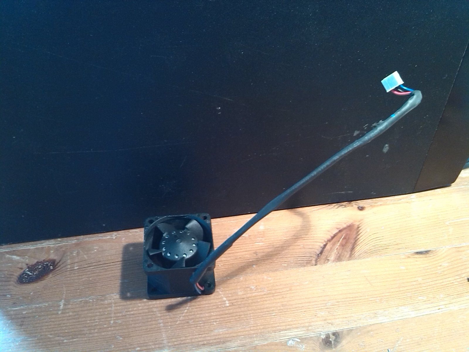

    Artesyn 7001138-Y000 - 835W
    1. Manufacturer: Delta DPS-835AB, Artesyn 7001138-Y000, IBM x3650 3655
    2. Label and/or name/number: 7001138-Y000
    3. Revision: F
    4. Max watt output: 835W
    5. 12.1V line = 69 A
    6. Pinout available: yes
    7. Pinout easy to implement: soldering is needed. For this purpose you have to open the case.
    8. Instructions of pinout: http://www.rcgroups.com/forums/showpost.php?p=20400391&postcount=1114
    9. Noise: very noisy. The fan will ramp up automatically with load. The Venitlator can be unplugged (do not cut the wire!). It will also run without the fan, a seperate fan cooling is mandatory) . IMG_20150419_135549.jpg
    10. Ventilator existing: yes, small and high sound producing :)
    11. ? - - ?
    12. Final thoughts and comments (the goods/the bads)
    The Pros:
    Really dump but very effective PSU. Dump means high peaks demanding from the motors does not influence the PSU, worth the money, small case. Tested for months w/o issues.
    THe cons: way too loud, ventilator mod is required.

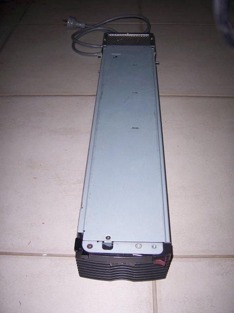

    ATSN - 7000956 - Y000 - 700W
    1. Manufacturer: HP
    2. Label and/or name/number: ATSN - 7000956 - Y000
    3. Revision: H
    4. Max watt output: 700
    5. 12V line = 56 A
    7. Pinout easy to implement: yes, soldering needed
    9. Noise= no
    10. Ventilator existing? No, ventilator mod is recommended!!
    11. ? - - ?
    The Goods: cheap and solid. Easy modification.
    The bads: none,

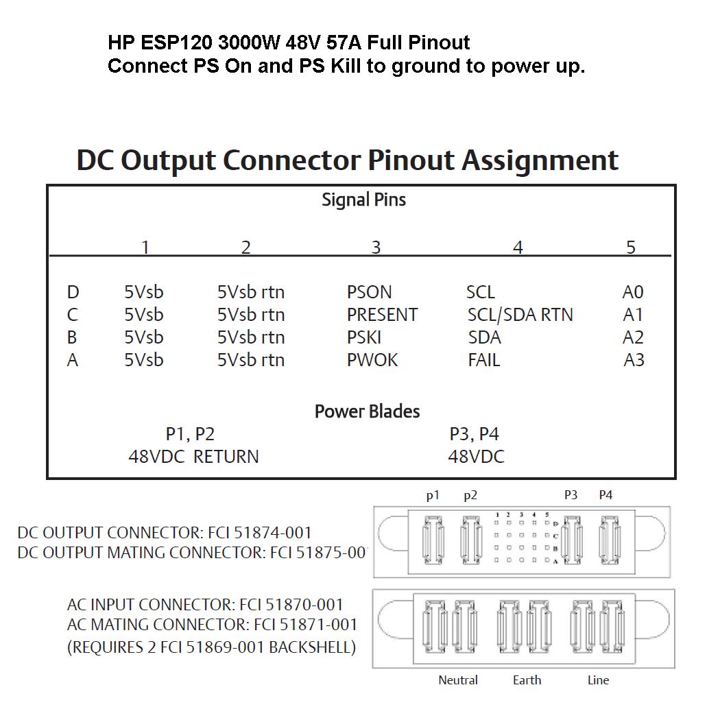

    1. Manufacturer: Hewlett Packard
    2. Label and/or name/number: ESP-120
    3. Revision:r3
    4. Max watt output: 2950W
    5. 28-62V line = A (maximal): 57A
    6. Pinout available: yes...
    8. Instruction of pinout : attatched pdf
    9. Noise= noisy but can be changed by communicating via i2c
    10. Ventilator existing? it has a noisy fan..
    11. ? - - ?
    12. Final thoughts and comments (the goods/the bads:
    This psu runs at 51volts as standard but can easily be modified by replacing a resistor to run between 28 end 62 volts.
    Pros:
    Also supports load-sharing with two or 4 units for 6 and 12KW operation. ( look for the original rack enclosure)
    Its a popular unit and different hacked firmwares are available. The communication protocol has been reversed engineered to give one absolute control of the PSUs.
    I have three of these and they have been wonderful and very robust. haven't lost one yet and i have had a few oopsies :) - i have load tested these PSUs @ 2200w/45V continous.
    Cons:
    noisy
    large

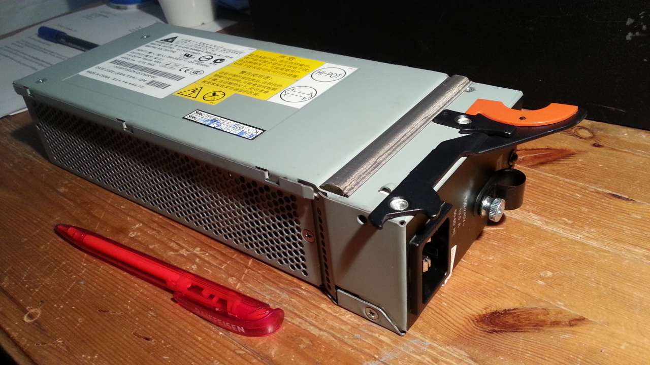

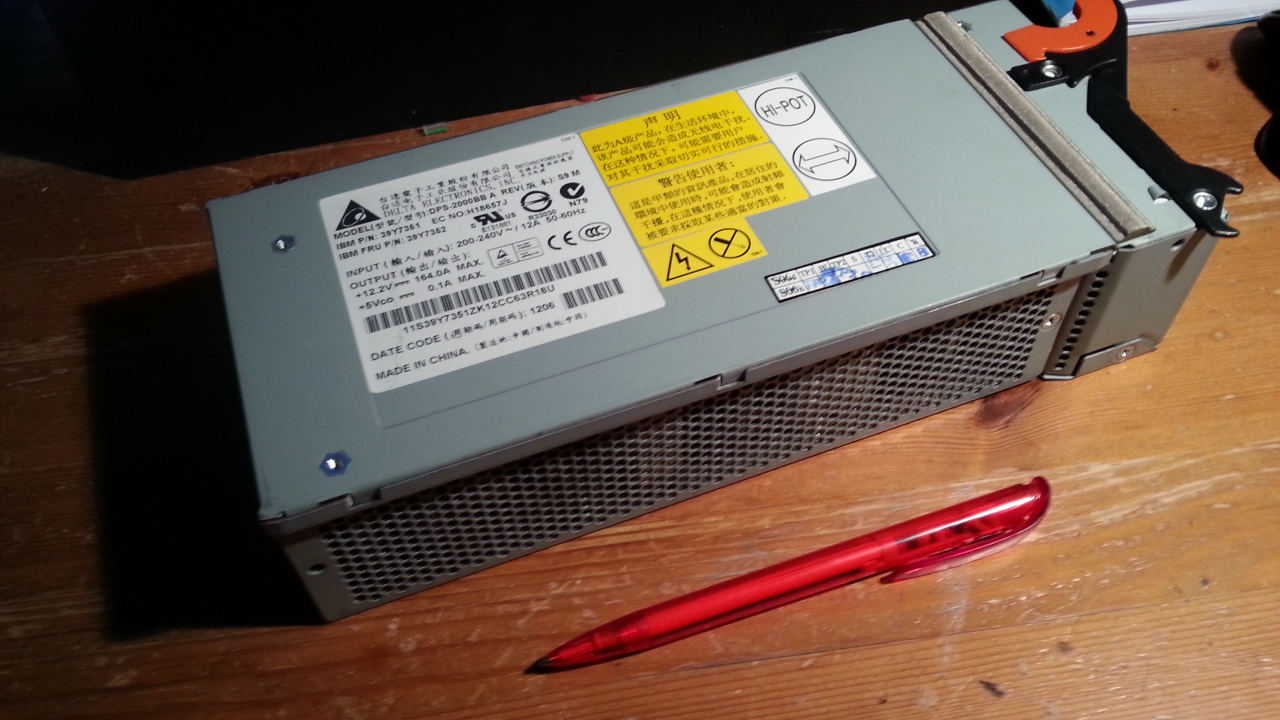

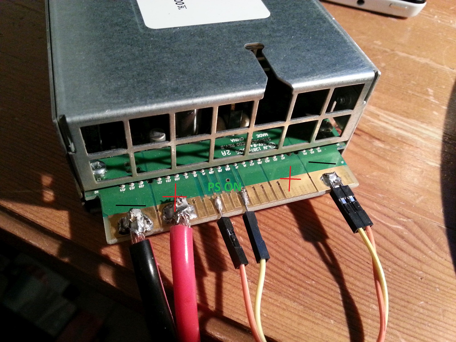

    DPS-2000BB
    1. Manufacturer:IBM
    2. Label and/or name/number: 39Y7361
    3. Revision: S9M
    4. Max watt output: 2000 !
    5. 12.2V line = 164 A (maximal):
    7. Pinout easy to implement: very easy, no soldering needed
    8. Instructions of pinout here
    9. Noise= NO, no fan
    10. Ventilator mod is recommended!!
    The goods
    In most cases two motors can be driven by one PSU (up to 400W motors). Way too high current peaks will result in a shut down of the PSU (using two motors way over 400W each and one PSU).
    The bads
    Not the cheapest PSU.
    Please read:
    The PSU needs much power on the 220V line due to their IEC C19 standard (16A). To fire it up up you need an IEC C19 power cable which is not compatible with a standard 10A wall socket and has to be modified. Two PSUs under full load (two 750W winches firing up) are drawing up to 6A current and up to 9A peak (Assetto Corsa, Nordschleife, Pagani Zonda R)

    could you elaborate on the pinout please (Instructions of pinout:
    21152 )
  11. kif
    kif New Member
    Jun 7, 2024
    22Coins
    oh those wires are looped? couldn't see, its cropped out of the picture
  12. noorbeast
    21,592
    151,215Coins
    @Pit still pops in from time to time, as life obligations allow, but has not done so since October 23.
    Hence it is worth clarifying with other members what is not clear about the pin out:
