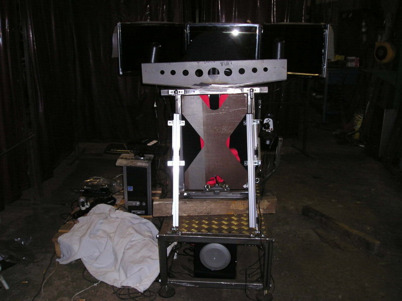

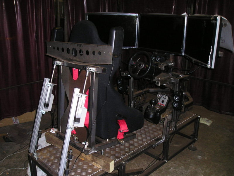

    Hi all

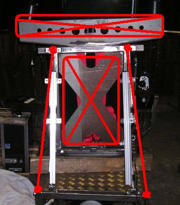

    Finally with enormous delay i have finished my simulator rig, where i have mounted scn5 actuators. ( very frex style )
    I know that the x-sim2 is near at end of development. ( i think )
    Is it still possible for me to enter in the x-sim2 beta groups, for move my rig or must i wait the final release ?
    Please if it possible i am impatient to test my mechanic.
    Thank you for your response.

  2. egoexpress
    egoexpress Active Member
    Dec 13, 2006
    3,839
    Germany - Frankfurt/M
    421Coins
    +10 / 1 / -0
    Your frame looks impressive, but I think you added too much weight to the moving part of your simulator. I think the SCN5, which have only 10kgf each actually, will have much trouble to move this steelframe, and wear out way faster due to the additional load most likely.
    As well the actuator arms are not well placed.
    I'd suggest you following:
    - Place the actuator-arm joints on the botton as far towards the frame edges as possible to increase the momentum
    - Remove unnecessary weight (steelplate behind the seat, and upper steelplate)
    Regards
    Chrisitan

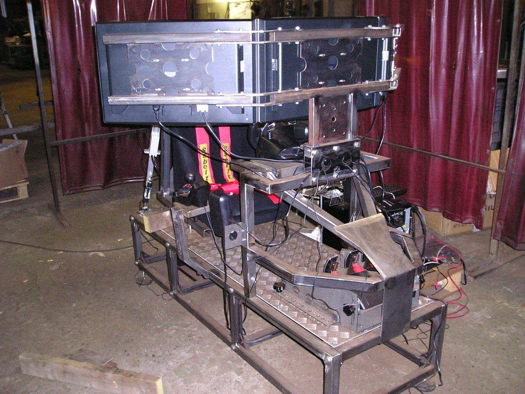

  3. bvillersjr
    bvillersjr Active Member
    Oct 11, 2008
    1,174
    Ohio, USA
    438Coins
    +23 / 1 / -0
    In my experience, egoexpress is correct. This will definitely cause actuator failure. To be honest, you may even have to replace the angle iron under the seat with something lighter. Sorry to chime in with bad news, but I'd hate to see you destroy an actuator.
  4. SUPERSLOT
    SUPERSLOT New Member
    Apr 24, 2008
    24
    9Coins
    Thank you very much for your suggestion.
    Probably what you say is correct, But i have placed the mass exactly on the center of the gravity When a person sits on the seat, and the steel that you see is thin and the weight of the frame is much less than the weight of a person.
    Certainly the design of egoexpress improves the mechanical momentum.
    My actuator are 100 mm. stroke.
    Now i ask, is it possible for me to enter in betatestergroup to try the actuators or not ?
    Thank you for your response in any case
  5. egoexpress
    Dec 13, 2006
    3,839
    421Coins
    +10 / 1 / -0
    However, the increased mass inertia due to additional weight will take effect for sure Imo, even if it is ballanced.
    Try it out, but if your SCN5 start to make whining noises, or you have the feeling that they have to work hard, then you should replace some weight.
    regards

    Just try it, but as ego said, dont ignor the noise which is coming out of em when they are screaming !
    If you have everything you need you should send a pic with everything mounted to sirnoname i think and you can get a beta key
  7. bvillersjr
    Oct 11, 2008
    1,174
    Ohio, USA
    438Coins
    +23 / 1 / -0
    Not to keep beating on you about this, but I am convinced that you are likely to damage your actuator. Here is my final word of caution:
    Balancing properly is a good start, but to understand what egoexpress is saying, try having someone sit on your seat (without the actuators connected). Try holding them with your arms by the back of the seat. You can feel how easy it is to move them in small increments while their weight is mostly supported by the U-joint or whatever you used as your balancing point. However, move them a couple more inches so that their weight is hanging out over the center point, and feel how much more force is required to bring them back up to the centered balance point. This is where your actuators are likely to run into problems, in high g-force corners where your weight is hanging to the left or right of the balancing point and the actuators have to try to lift you back up. In this scenario, how well centered it is has no impact on the amount of weight that the actuators must lift. You will be surprised how little weight an SCN5 can handle in this scenario.
    If you still insist on trying this, please do not strap yourself into the seat for the first test, and be ready to hop out quickly when your actuator collapses down, or is unable to lift you back up.
    I am working on a video that demonstrates how to test the stress on SCN5 actuators before driving in game for the first time. I hope to get it finished this weekend.
    Best of luck,

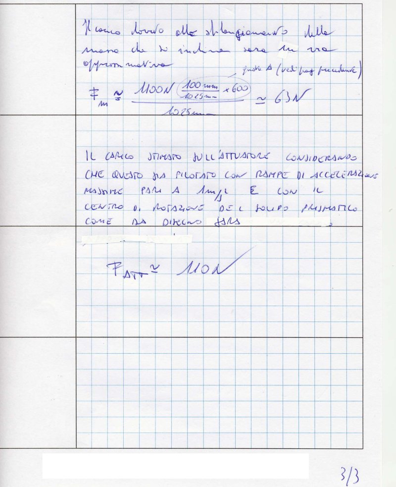

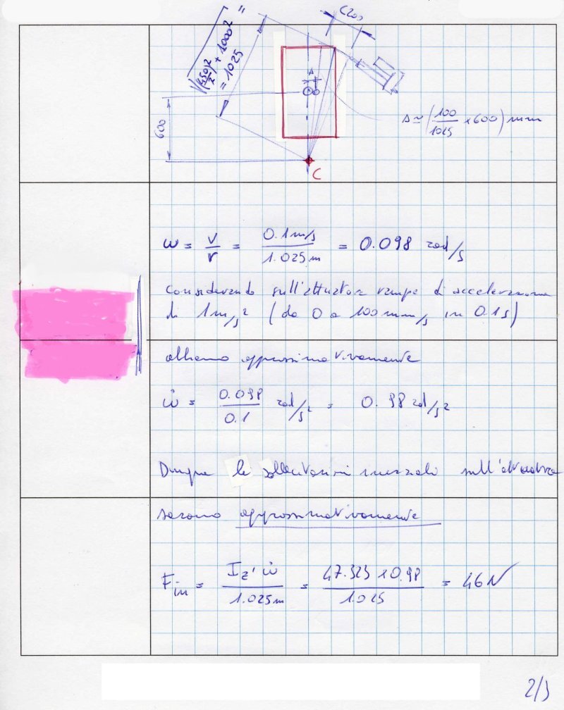

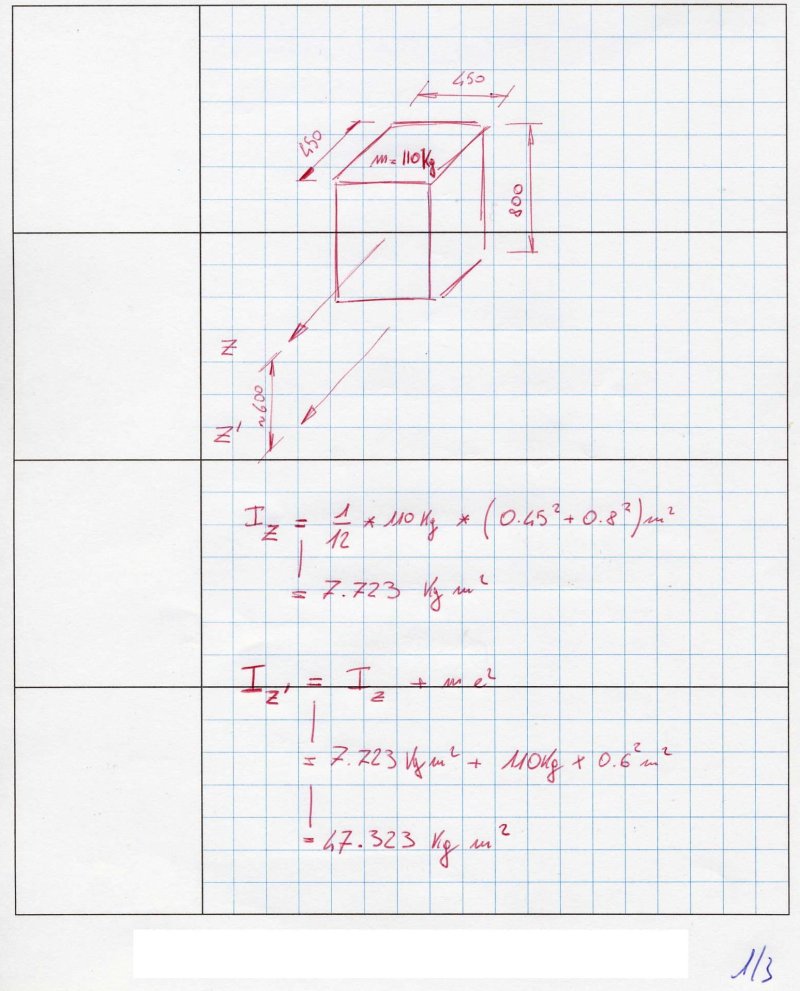

  8. SUPERSLOT
    Apr 24, 2008
    24
    9Coins
    Hi all
    Thank you for your suggestion. and is possible that what you say is true.
    But i have calculated the system mechanic ( i attached ), and i have semplified the system as a cube with load of the seat and the driver. Because my weigth is 80 kg, the seat 10 kg, and the steel frame of the seats is 13,125 kg = 103,125 is the total weight.
    In my dinamic calculation the stroke is 200 mm, but really the stroke is 100 mm ( more positive situation )
    My result ( with 110 kg weight ) is 110 newton ( 11 kg about) the total force to move the system, with an actuator of 200 mm. stroke and factor of security.
    But i have appreciated your comment and i will have the maximum safety when i will move the actuators for first time.
    if my calculations are wrong I will change the iron frame of the seat with one in aluminum.
    Thank you very much
