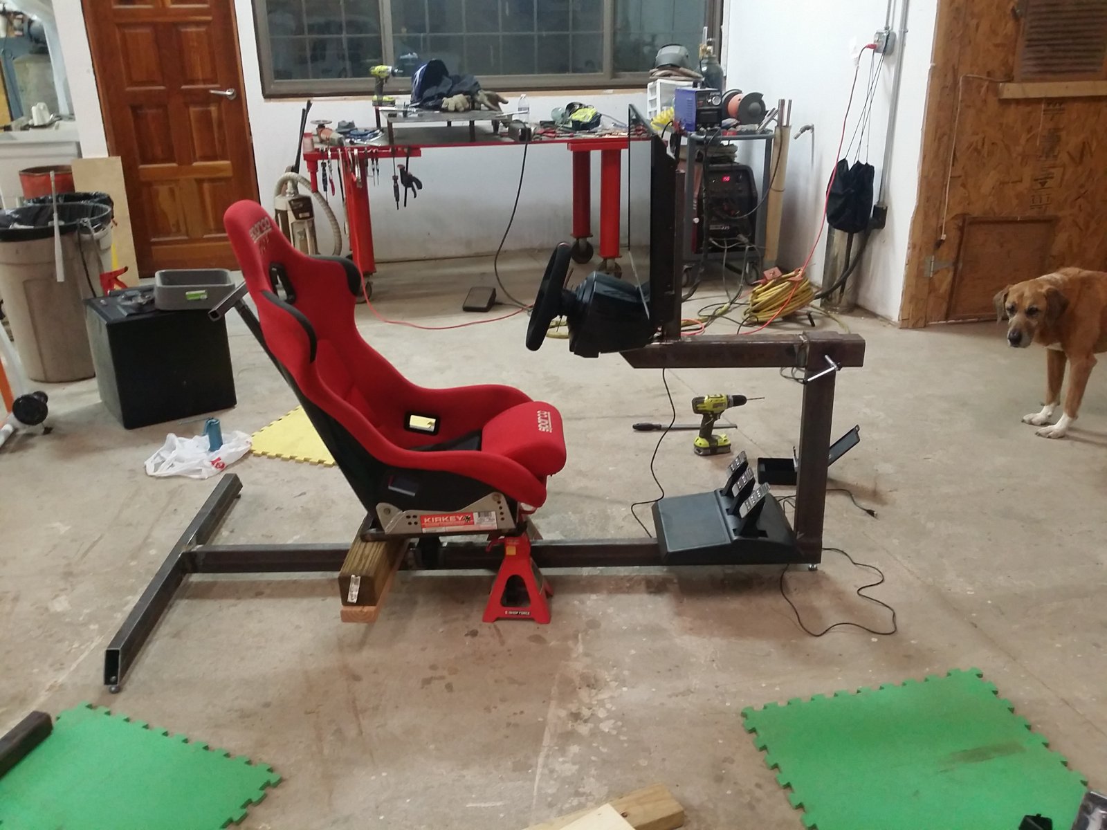

    I've finally made enough progress to share that I've been working on a motion rig. I started last year with some steel and a cross joint I had lying around my shop.

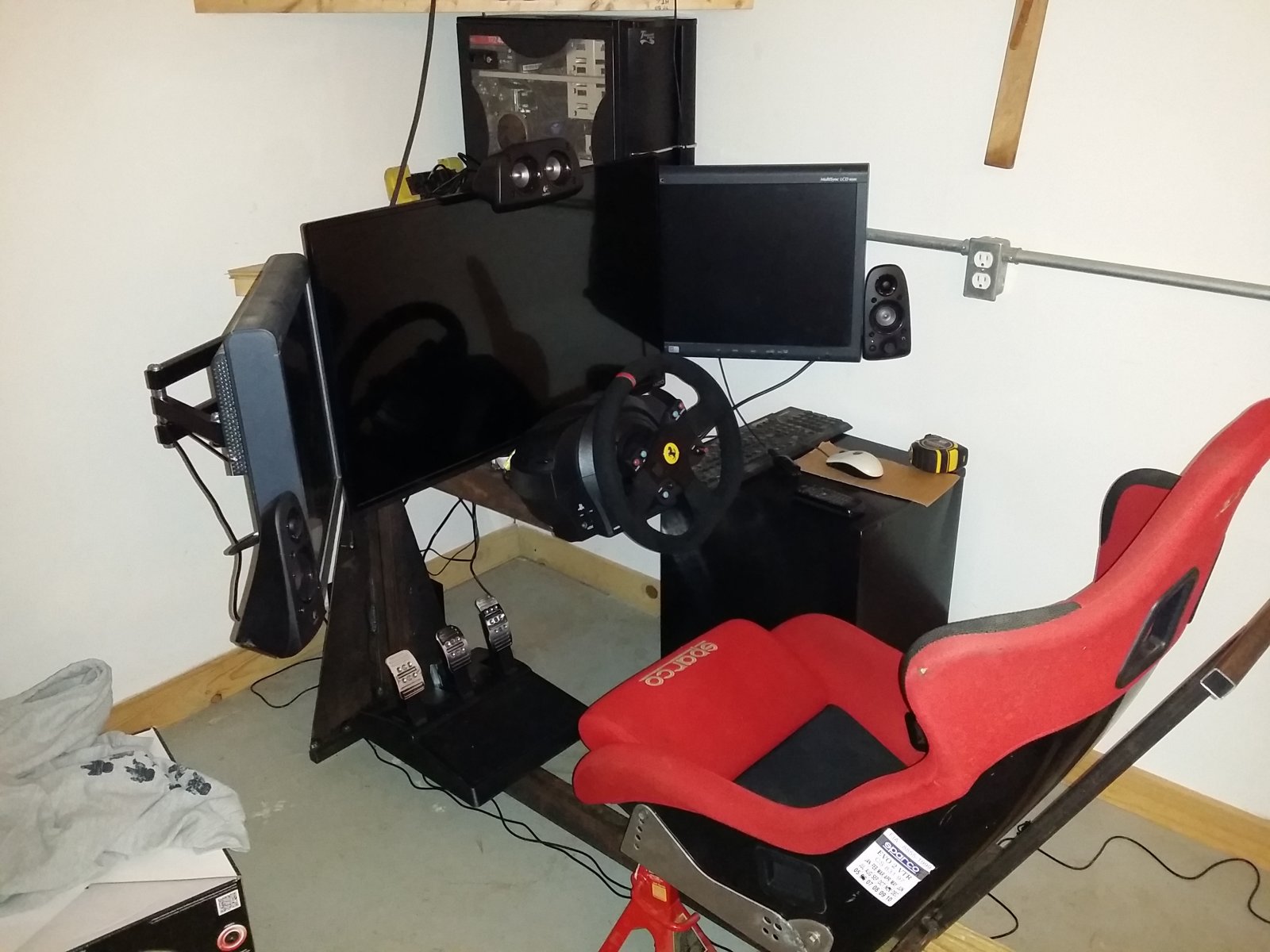

    I used the passenger seat from my car, and got a t300 Alcantara with the t3pa pedals. I used a TV and two old 18" monitors to make a cheapie triple screen setup:

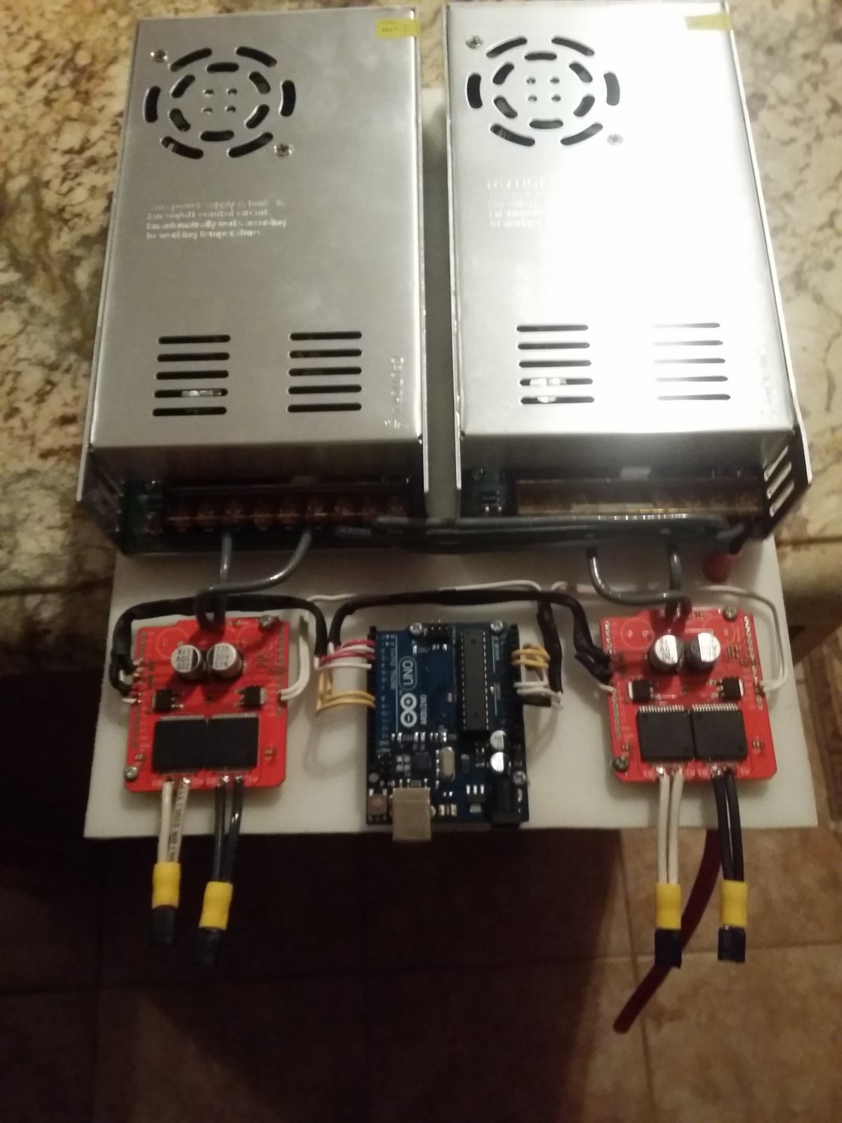

    That with a DIY h pattern shinter kept me entertained for most of a year. Then I stayed down the rabbit hole. I picked up an Oculus Rift and started ordering motion components: power supplies, knockoff Arduino Uno, a couple of knockoff Motor Monsters, and some 25:1 DC motors from pgsaw.

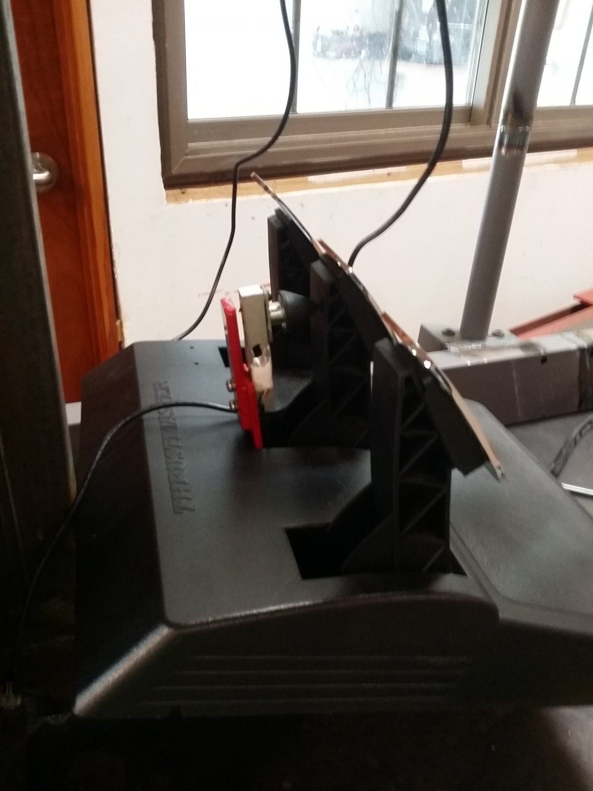

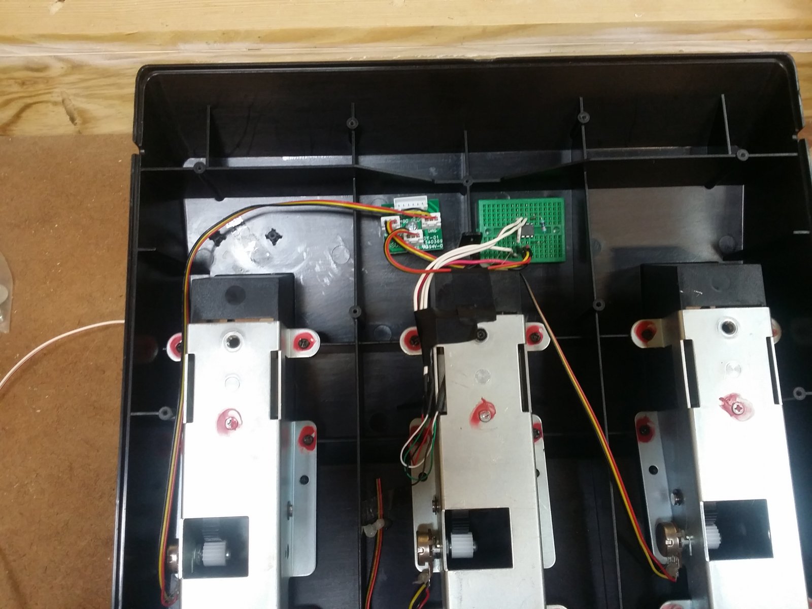

    I used some information from RacingMat to convert my brake pedal to a load cell:
    Pretty awesome upgrade for less than $10.

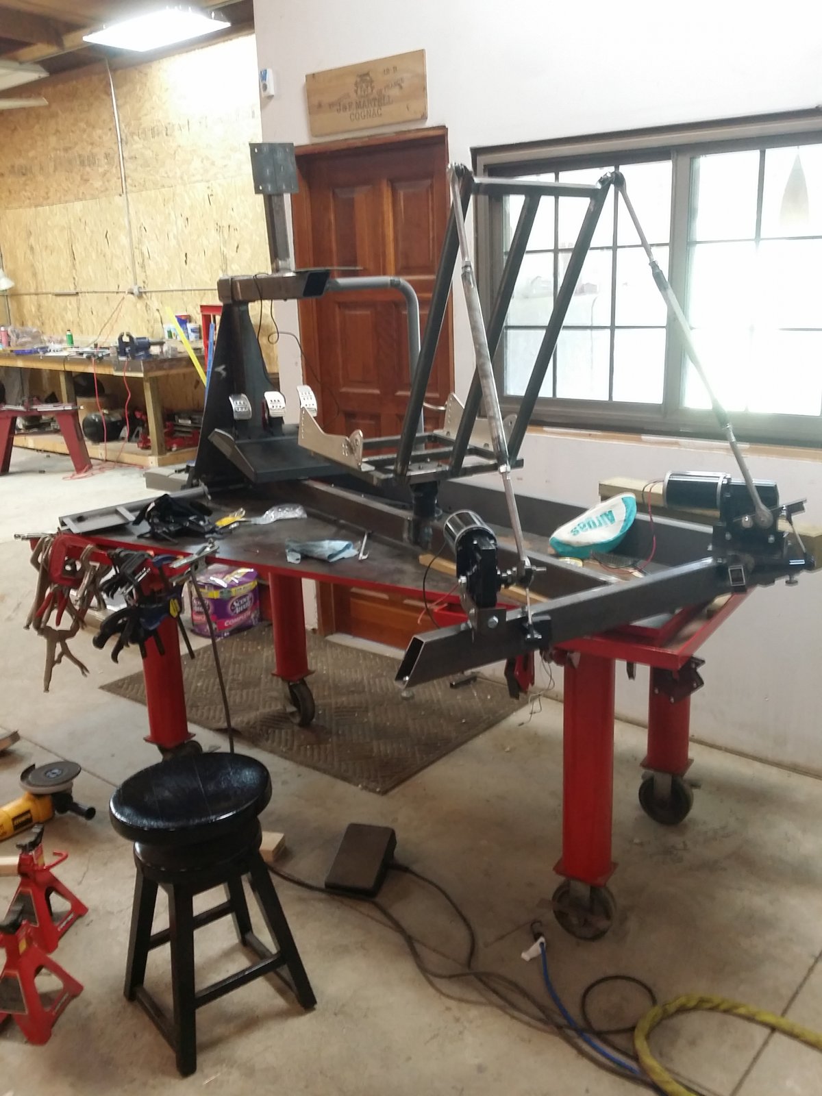

    I then stiffened up the seat frame and welded up the motor mounts:
    The only thing I've done that's out of the ordinary is that I used ride height sensors for my position feedback rather than pots or rotary hall effect sensors. The have a 5v signal that is pretty stable and is designed to cover only a 90 degree sweep. Also means I don't have to add couplers or make a linkage since they're already there.

    ...and a bad Arduino and a few bad Motor Monster Shields later it holds up the seat and responds to smc3 utils commands.
    I did put copper RAM heat sinks and an 8" fan on the MM Shields, and they seem to stay pretty cool. We'll see if that's still the case when I'm hammering around Sebring in a GT3 car :grin
